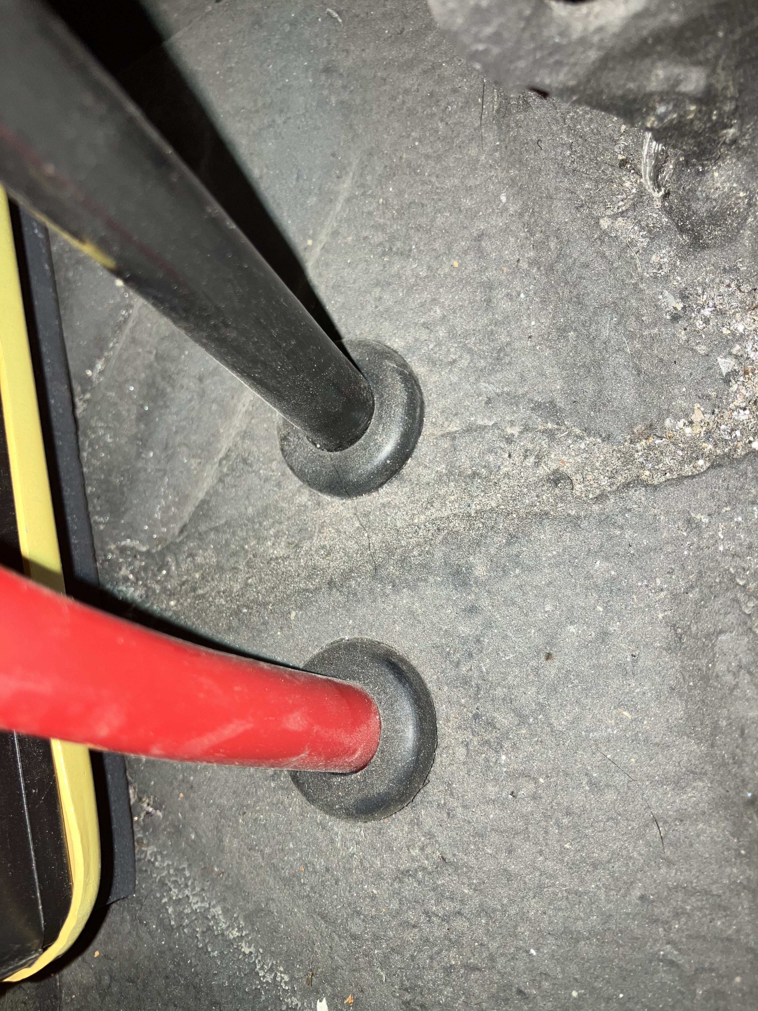

I use welding cable , very flexable & heavily insulated .
I always run the neg cable up to the trans so the engine is the main ground rather than connect to the body with the main cable , I still use a lighter cable from the engine to the body . I route the positive cable through the rocker with the other body wiring & connect to the starter .
I would definitely run the main up to the engine. How well does welding cable fit on the rocker channel with the rest of the wiring? Did you put both on the driver side? Thanks for the pics!

It will fit in the rocker ok , , I went under the seat & cut a small hole in the floor & attach to the trans
