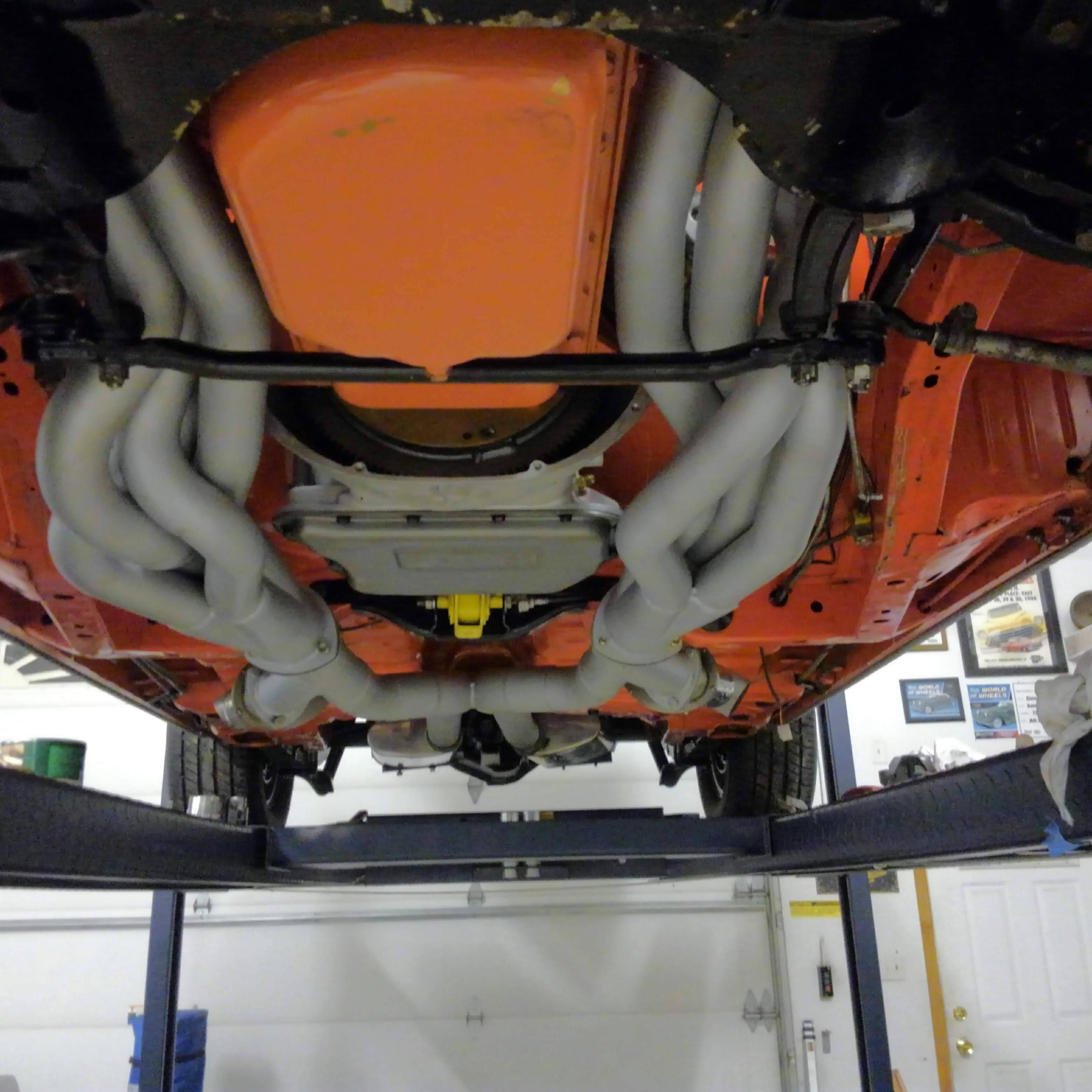

Here is a older pic before the radiator and all was installed

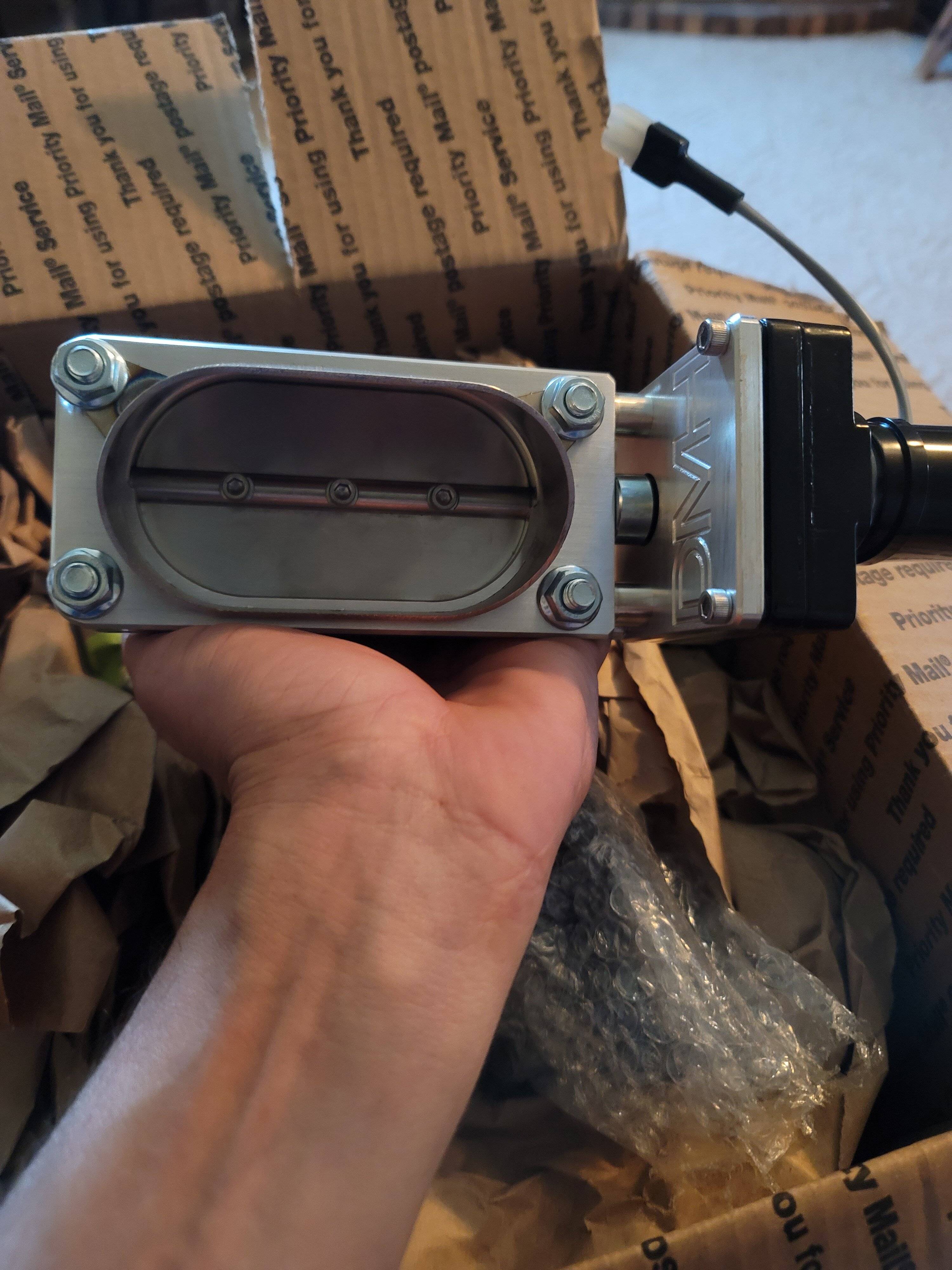

There are two styles, Direct Drive and gear reduction. The gear reduction motors are more powerful and can still close tightly even with a little bit of carbon build up.
We're partial to the Pypes Cutouts:

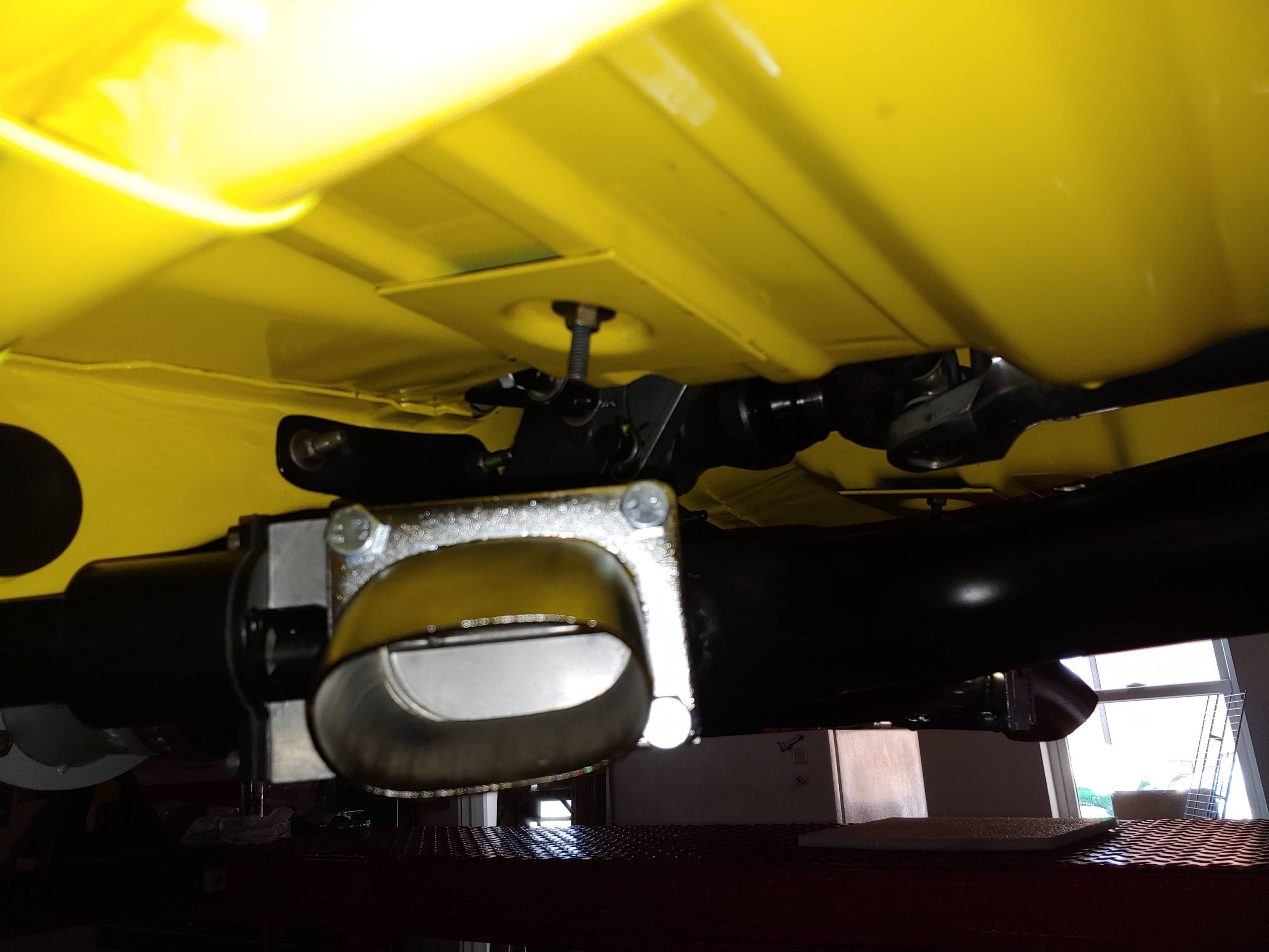

I'm running some. I ordered mine from Kindig-it. They don't make them but, they are their own design. I picked their product as they are pretty low profile and they put them on most of their builds and, I doubt they want somebody bringing their high dollar built car back over some flakey cut outs. I put them on this spring and so far they have been great and problem free.

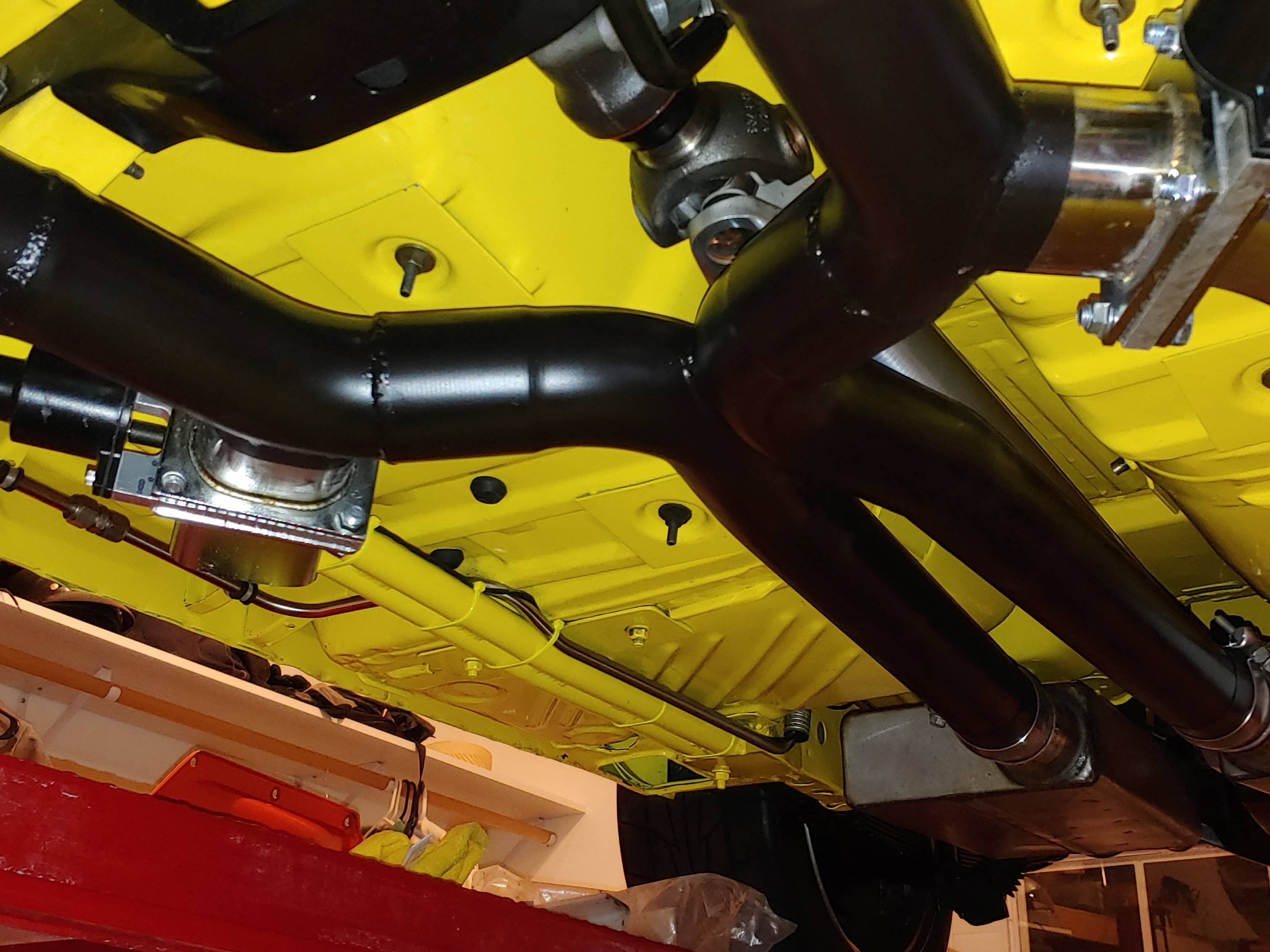

I used Quick Time ovals. Splicing them into the 3" TTI X pipe was really just a dry fitting exercise. I wanted them symmetrical and max clearance both ground and heat on surrounding area.
Now the wiring routing and getting the interior switch location and appearance is another deal. (I couldn't use the radio shack switch QTP supplied.)
