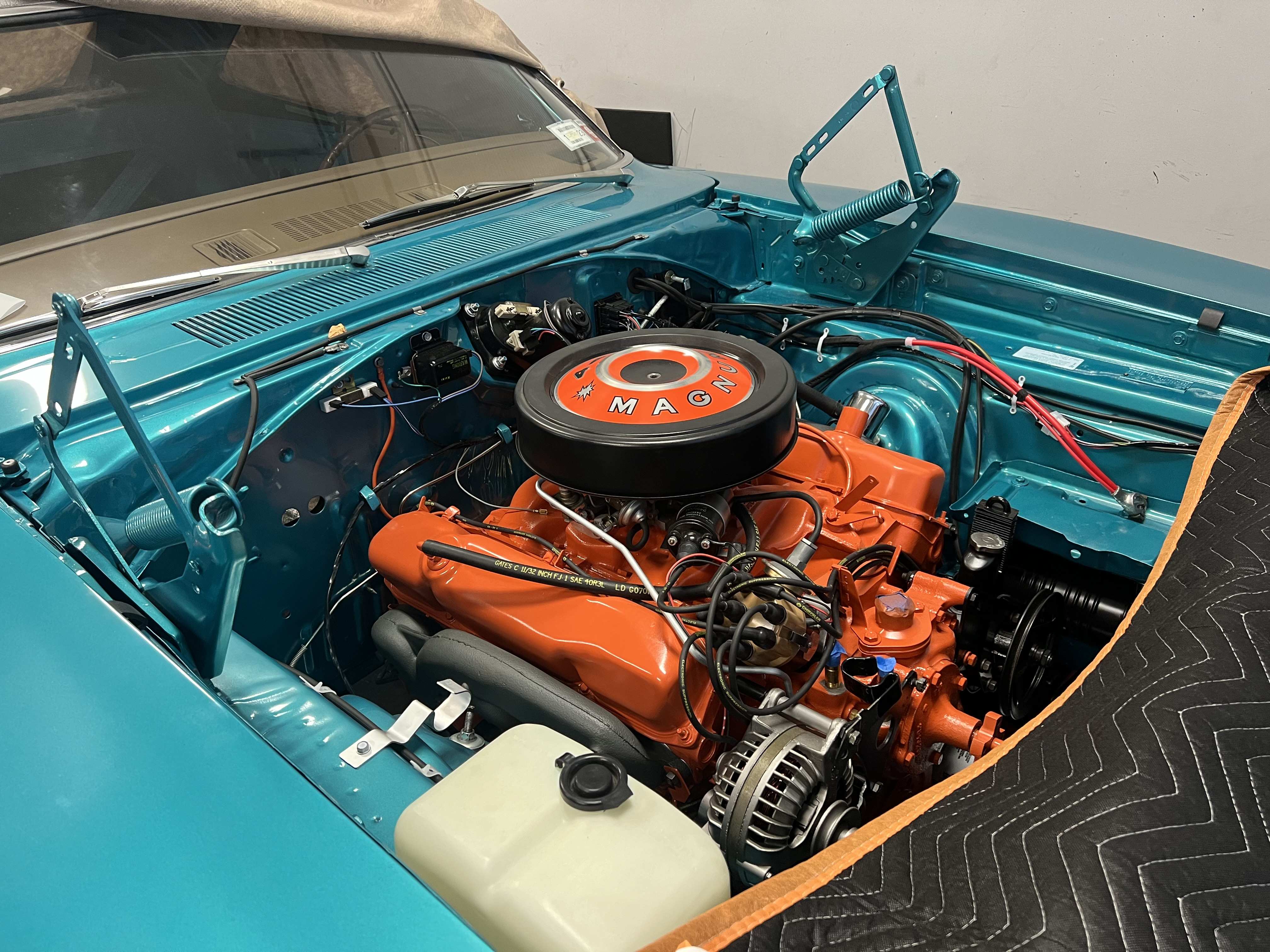

Just rebuild 1969 440 engine. Stock Setup.
I understand that zinc should be in oil for break-in period and possibly longer.
I purchased Castrol GTX SEA 10w-40 Oil
Does this have zinc in it? Doesn state on bottle. And if it does is it enough for break in?
If not i did purchase Lucas Zinc additive. Would it hurt to add this additive anyway? Its says one bottle of additive per oil change.

I'm assuming you meant Castrol GTX "SAE" 10w-40. Regardless, it doesn't appear to have extra zinc and phosphorous. It would have some kind of warning like "Not for use on some pollution controlled vehicles". But all this doesn't matter as you have the additive and you can add it to the Castrol GTX and be good. You did use the special camshaft lube on the camshaft lines and lifter bottoms on assembly, right? The absolute main thing is the engine starts up quickly, no excessive cranking! Best of luck my brother! It's going to be a nice restoration!

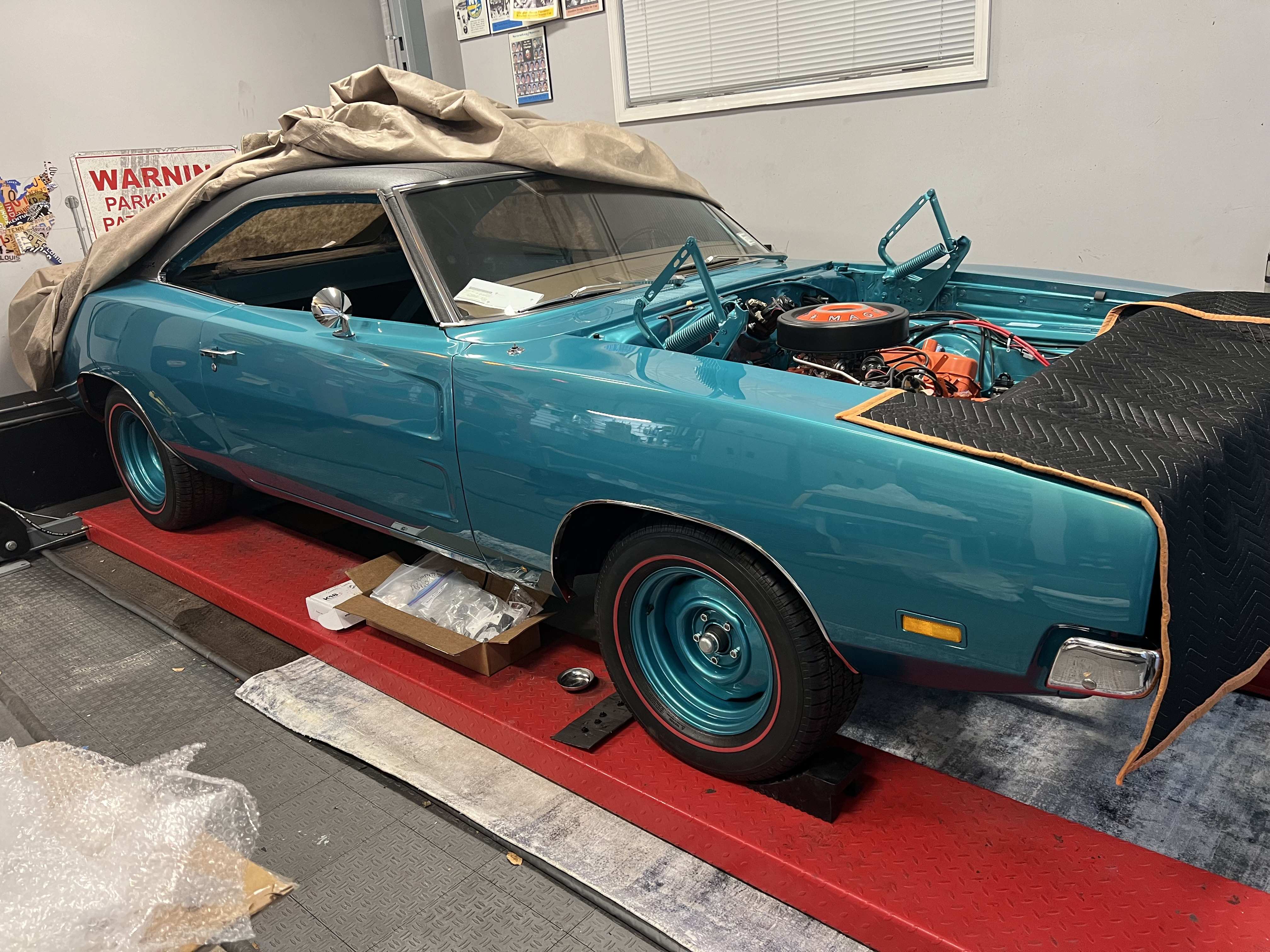

Here are some updates on my b body.
