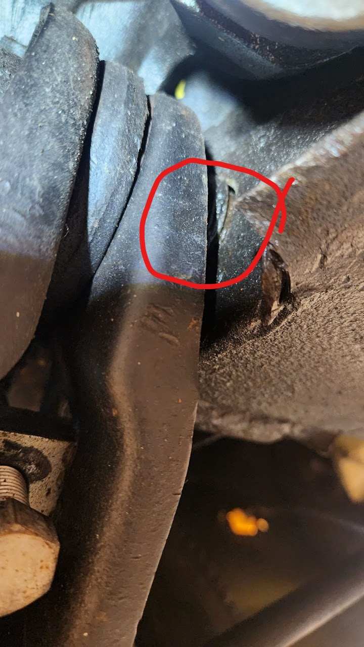

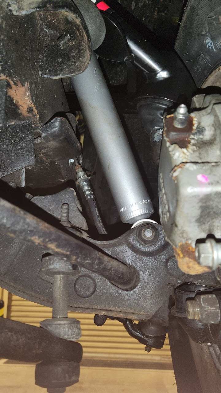

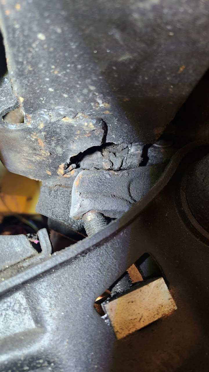

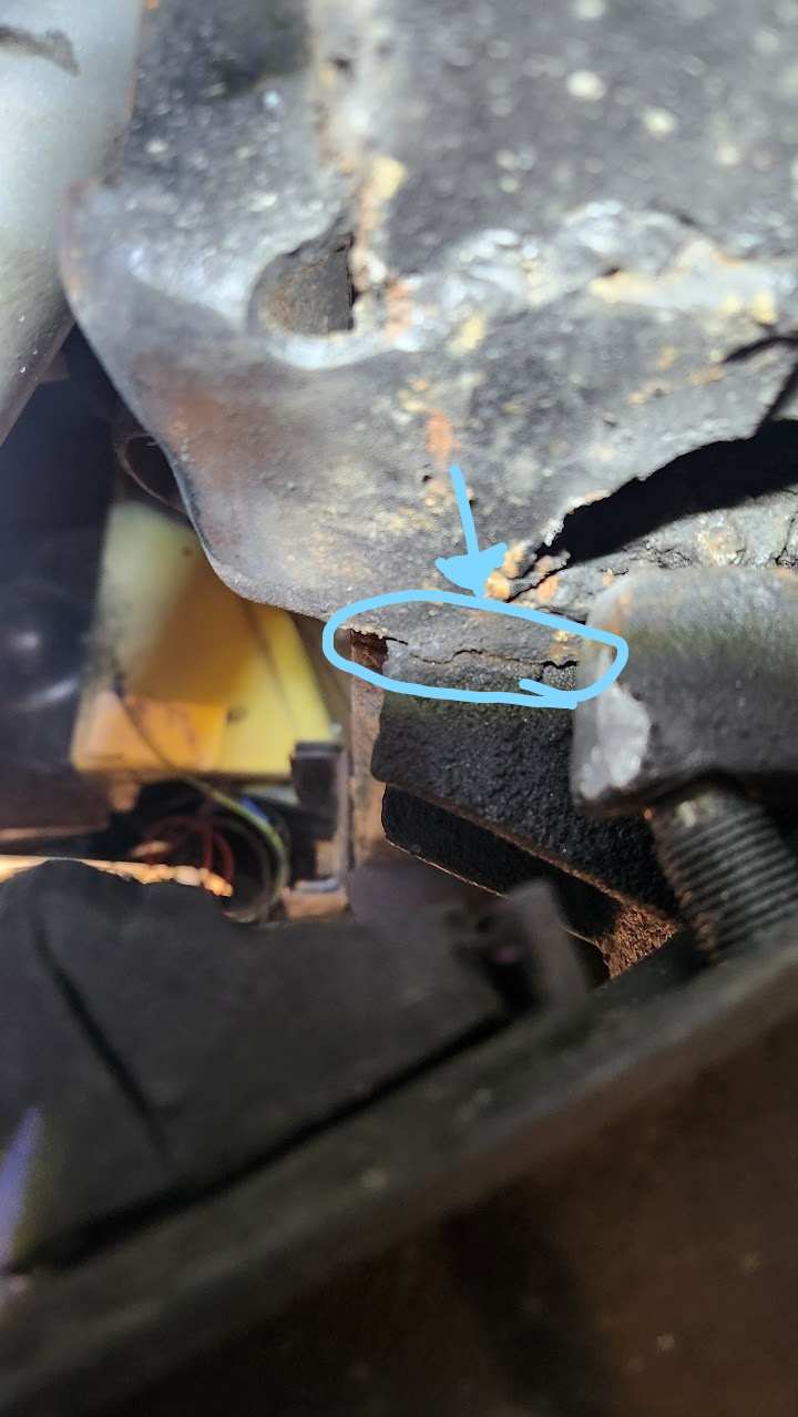

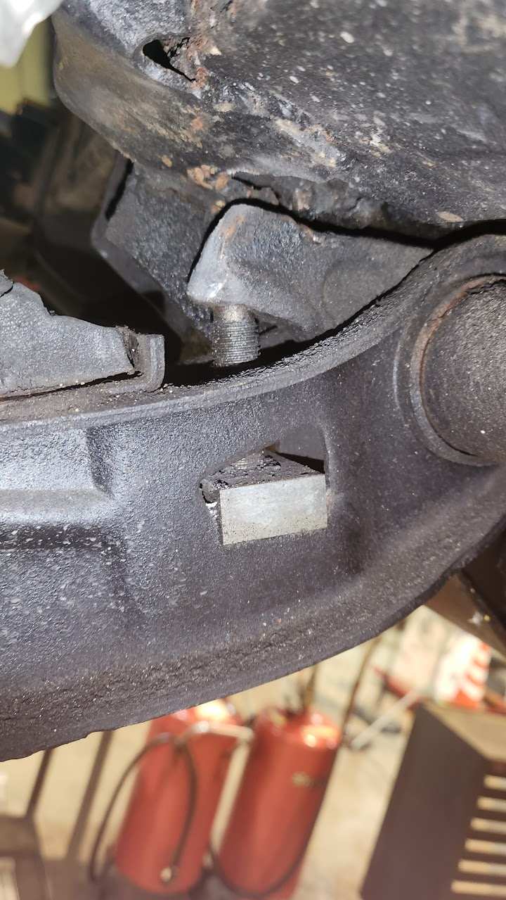

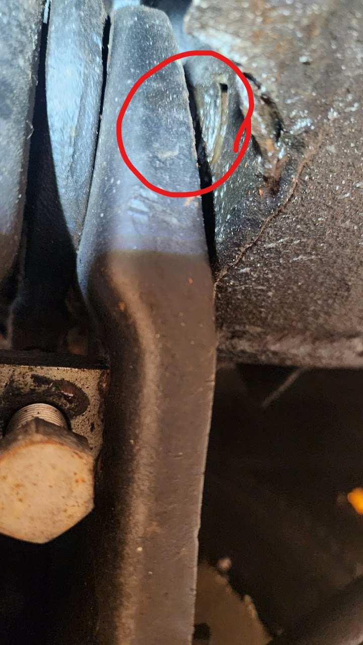

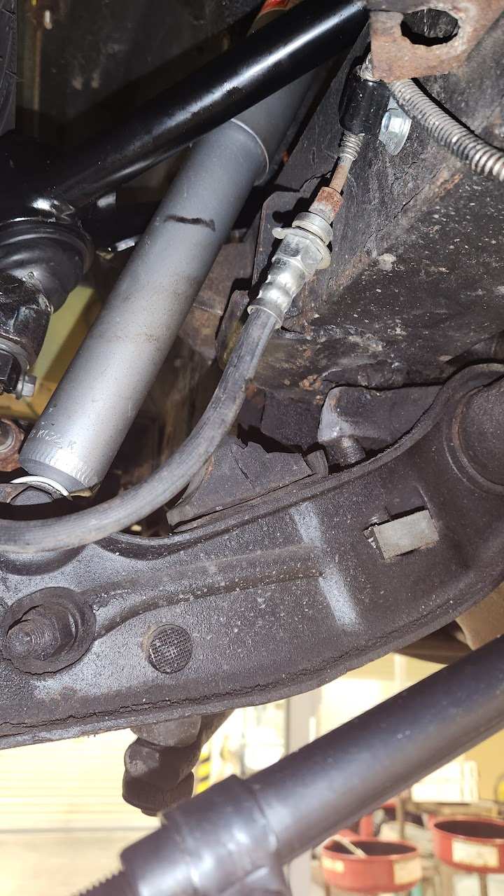

I've recently been working through an issue where my drivers side wheel had a lot of negative camber. I ended up swapping all the ball joints and Upper Arm, only for it to stay the same. Got it on a lift and realized whats going on. The area where the torsion bar meets with the k-member seems to be broken and the frame itself is separating at a seam. I'm no expert so I'm here for advice. I'm thinking based on the damage, I need to weld up the hole and split in the frame, and replace/repair the k-member? I'm thinking of just swapping it for a qa1 but would like some input. Ive attached pictures to hopefully add some insight.

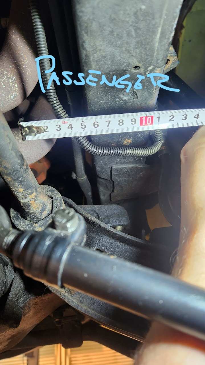

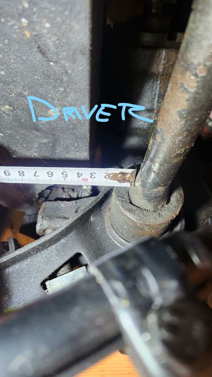

Basically if you get a crowbar between the lower arm and the frame, you can pull that crack apart and flex the entire k member. the lower arm is hitting the frame and is sticking out about 2cm more on the drivers side than the passengers because the damage.

You need to drop the k-frame then cut out the rotted frame rail and section in new frame rail.
4,472
2,121
I agree the K frame is not right & needs repair or replacement , QA1 is a good option

It looks as if it was welded before. The nut will brake loose before the bolt will come out. Just cut the nut area out and go from there. Save the nut and bolt if need be.
That's what it looks like to me.
What bolt and nut are you referring to? I'm replacing the entire k member and lower arms, do I need to worry about that still?

Kuruton, from the photos you attached it looks like you have k-member and frame rail damage. The nut welded inside the frame rail that the k-member bolts to, may be fubar.
