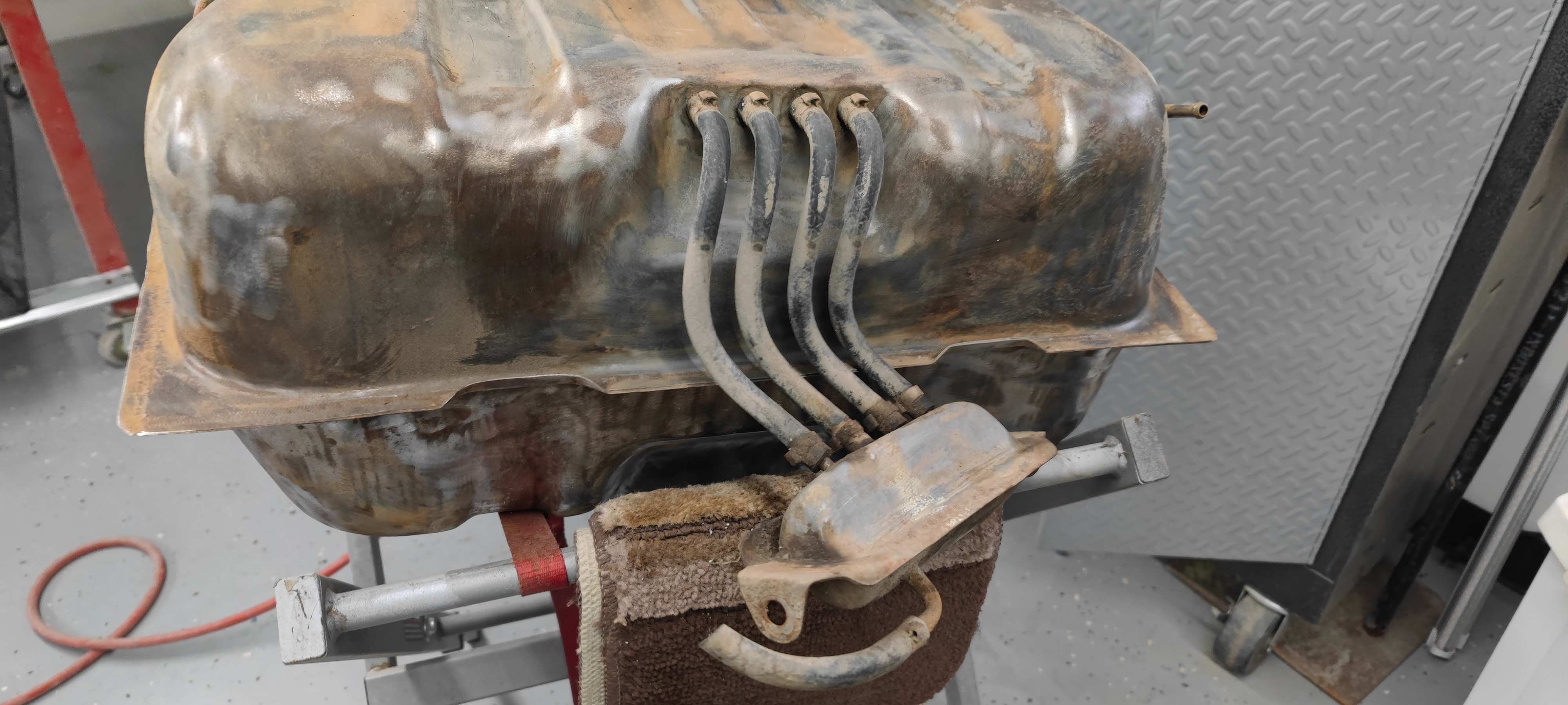

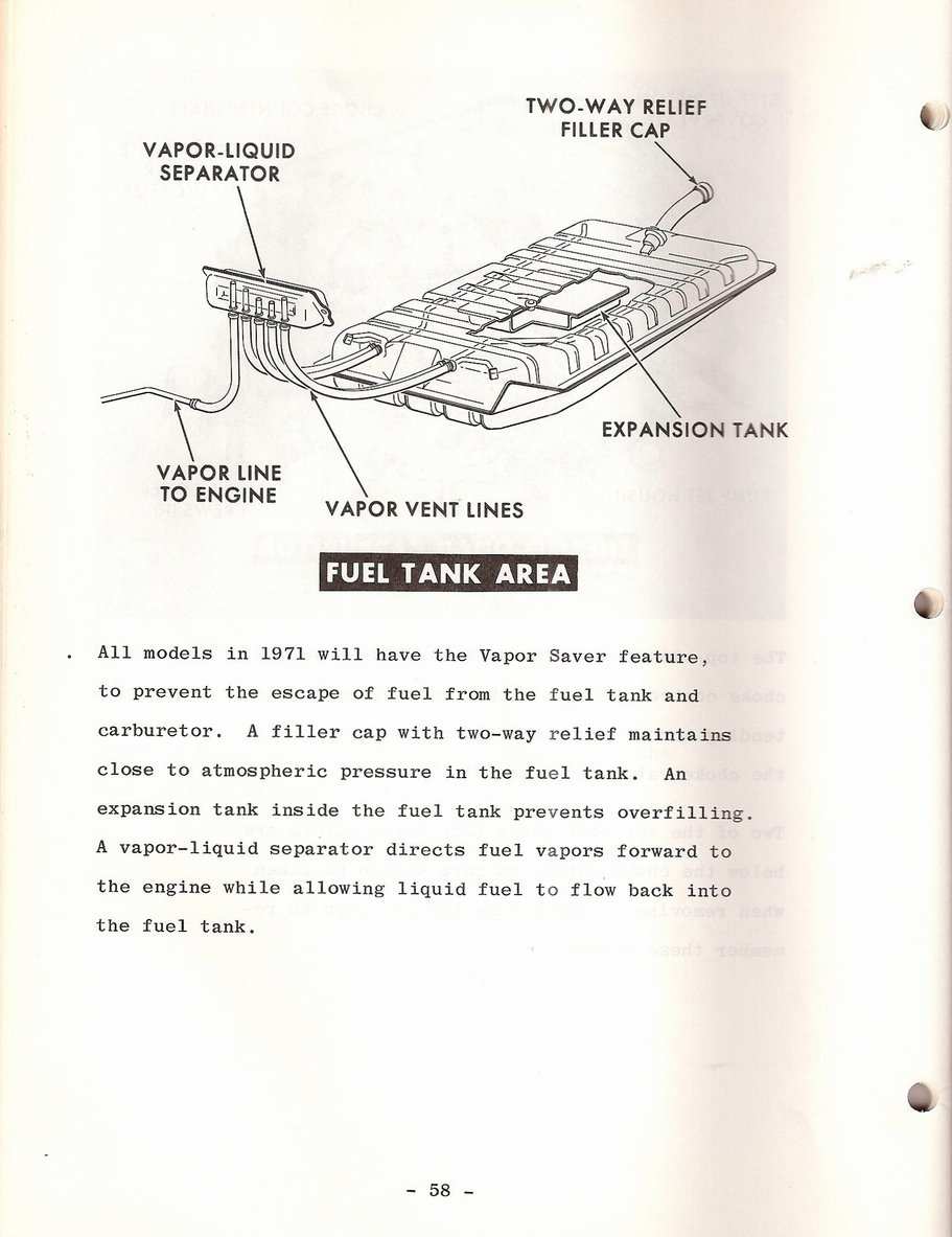

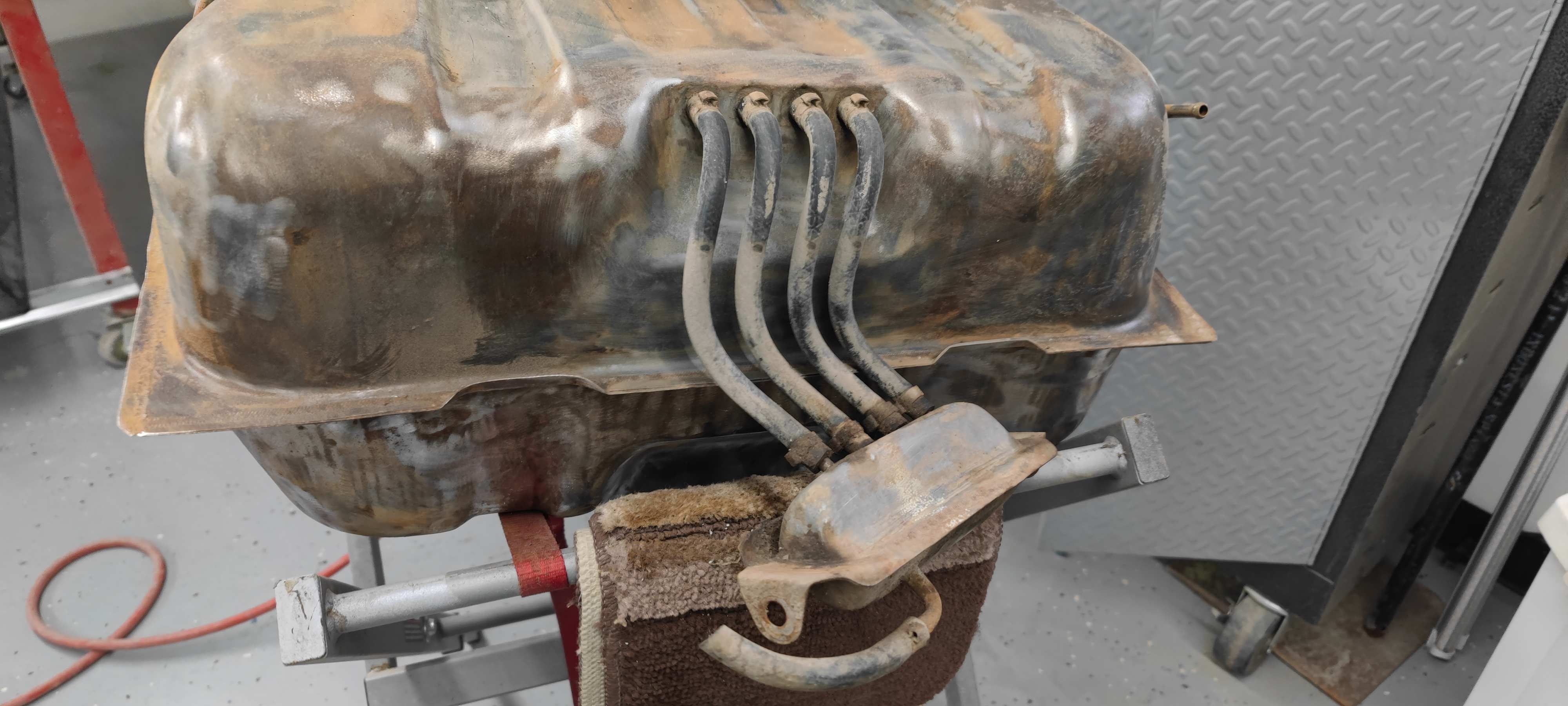

I'm going to be installing an inbtank fuel pump to run EFI. Can anyone tell me what this canister assembly is at the back of the tank and will I need to use it with an in tank pump?
Thank you.

Fuel vapor cannister.

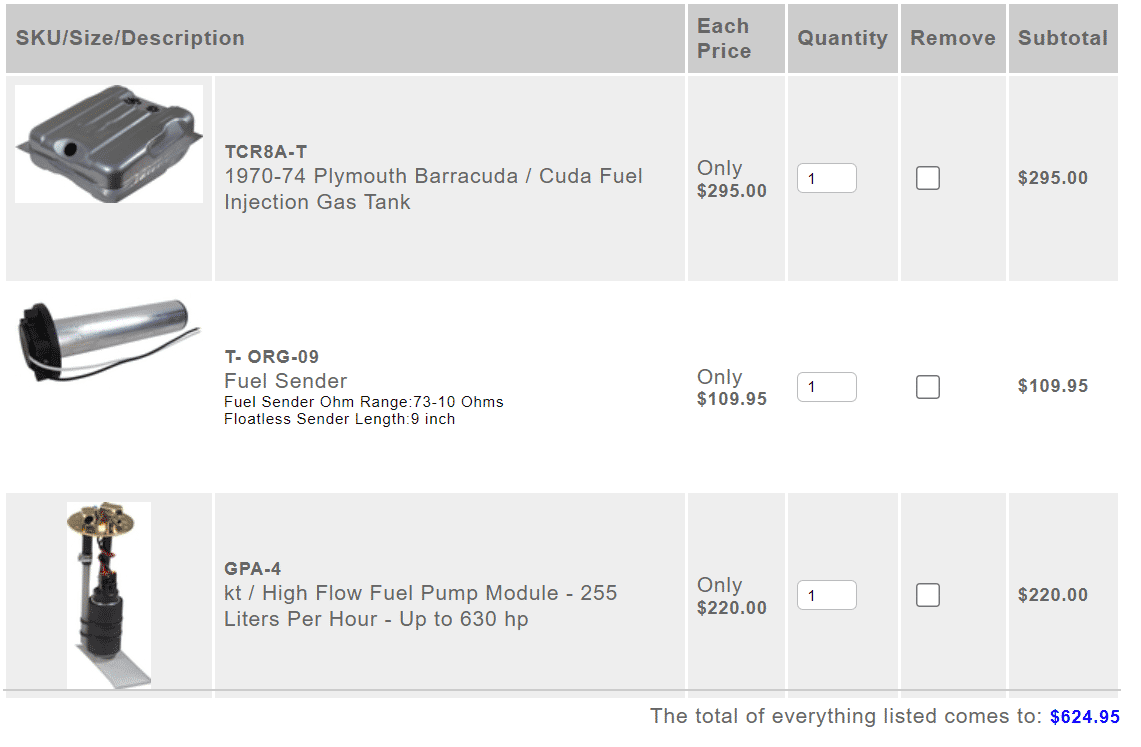

If you are going for a new, EFI designed fuel tank,( which is recommended) parts like these are valuable to restorers as they don't make them anymore and most are very rusty.
Complete new tank with internal fuel pump runs between $600- $700.
Just a stock tank conversion runs about $400. And that is with using your old tank.

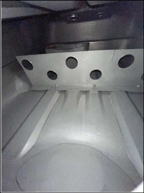

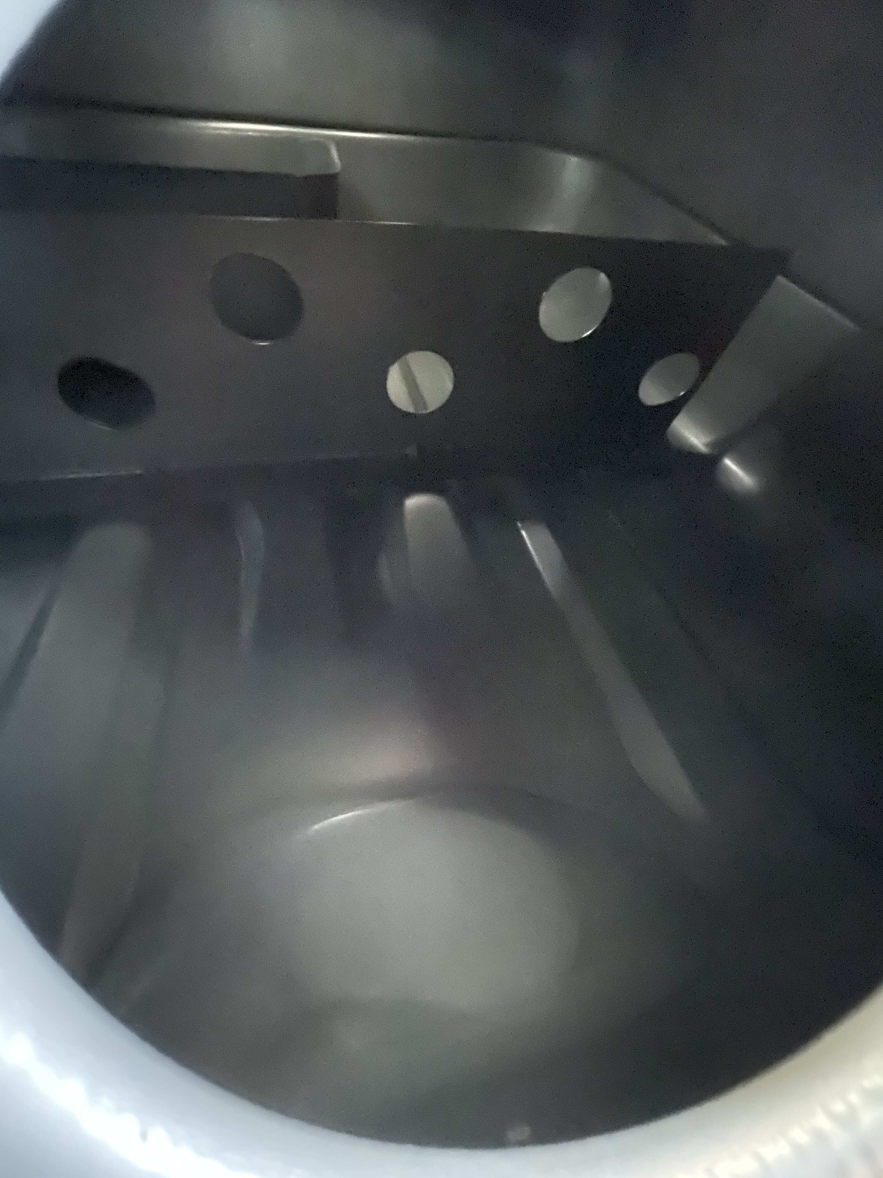

The tank is actually insanely clean inside.....I was absolutely shocked as I'm positive that it has never been previously removed. I was expecting to have to clean and coat it but it literally looks like new inside an very solid on the outside. A friend of mine who has been a mechanic for 45 years has installed a few of the Fitech EFI systems and will give me a hand. He has had good luck with Fitech despite a few bad reviews I have read.

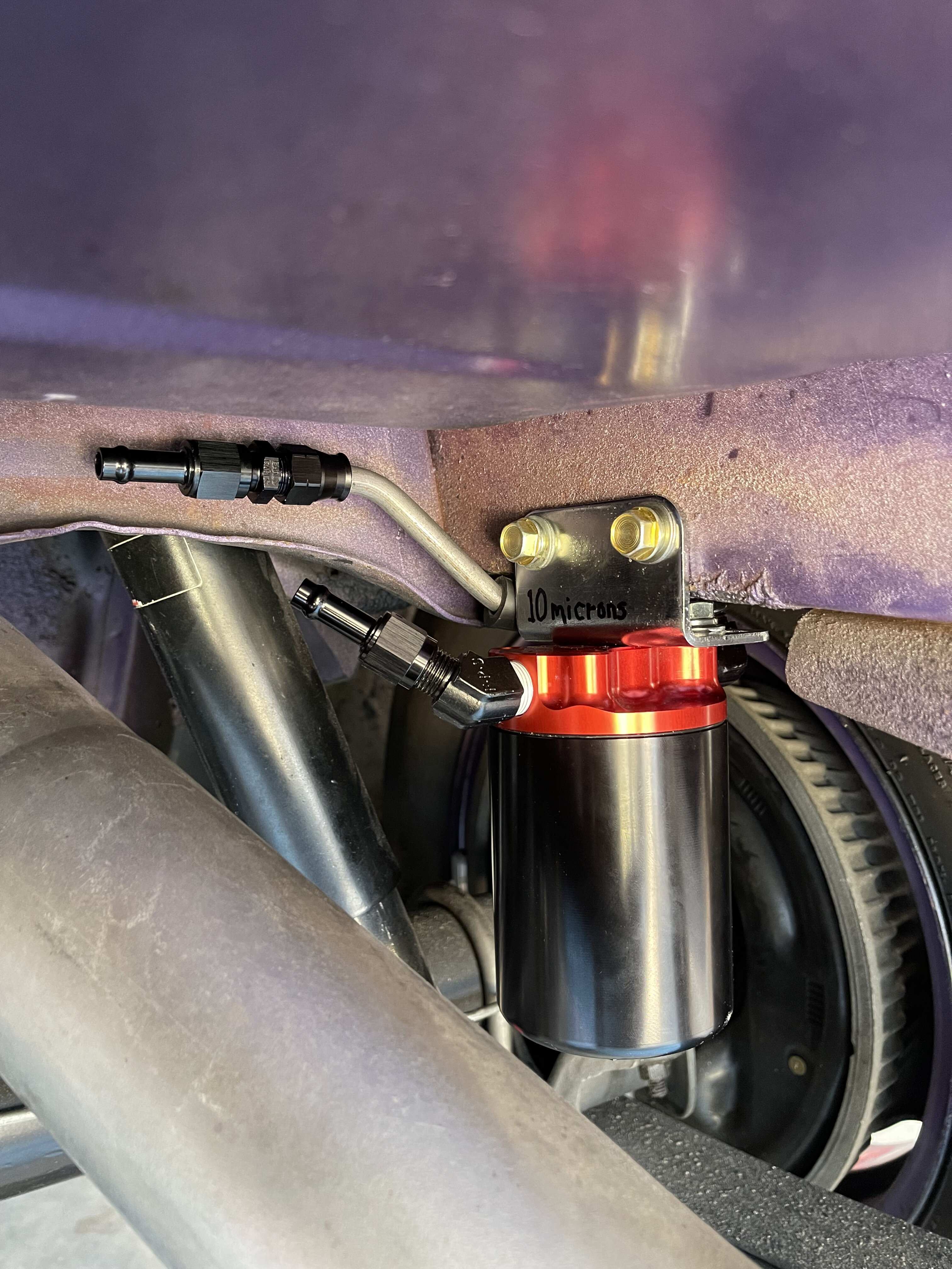

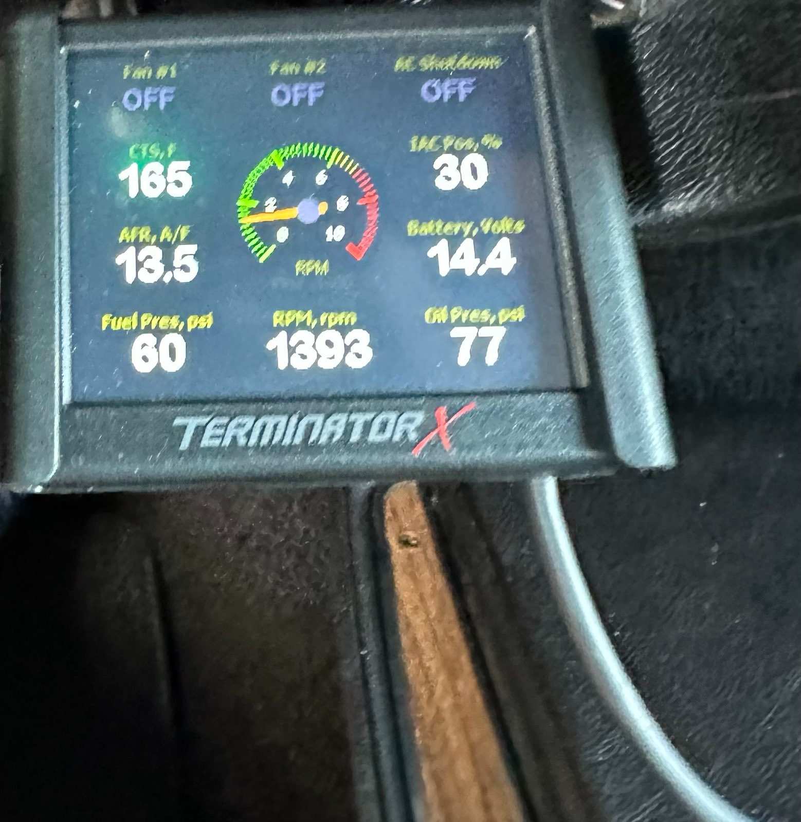

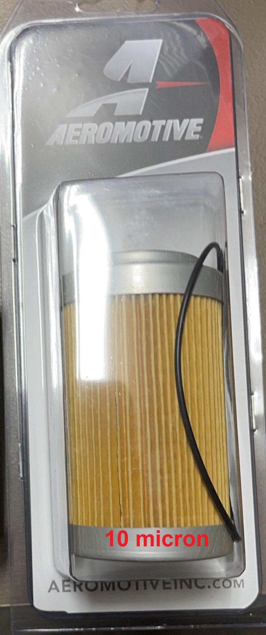

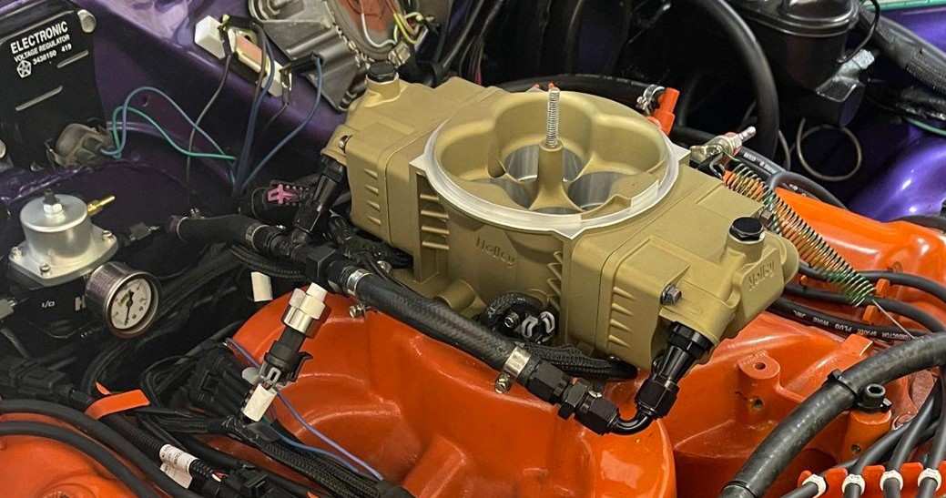

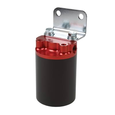

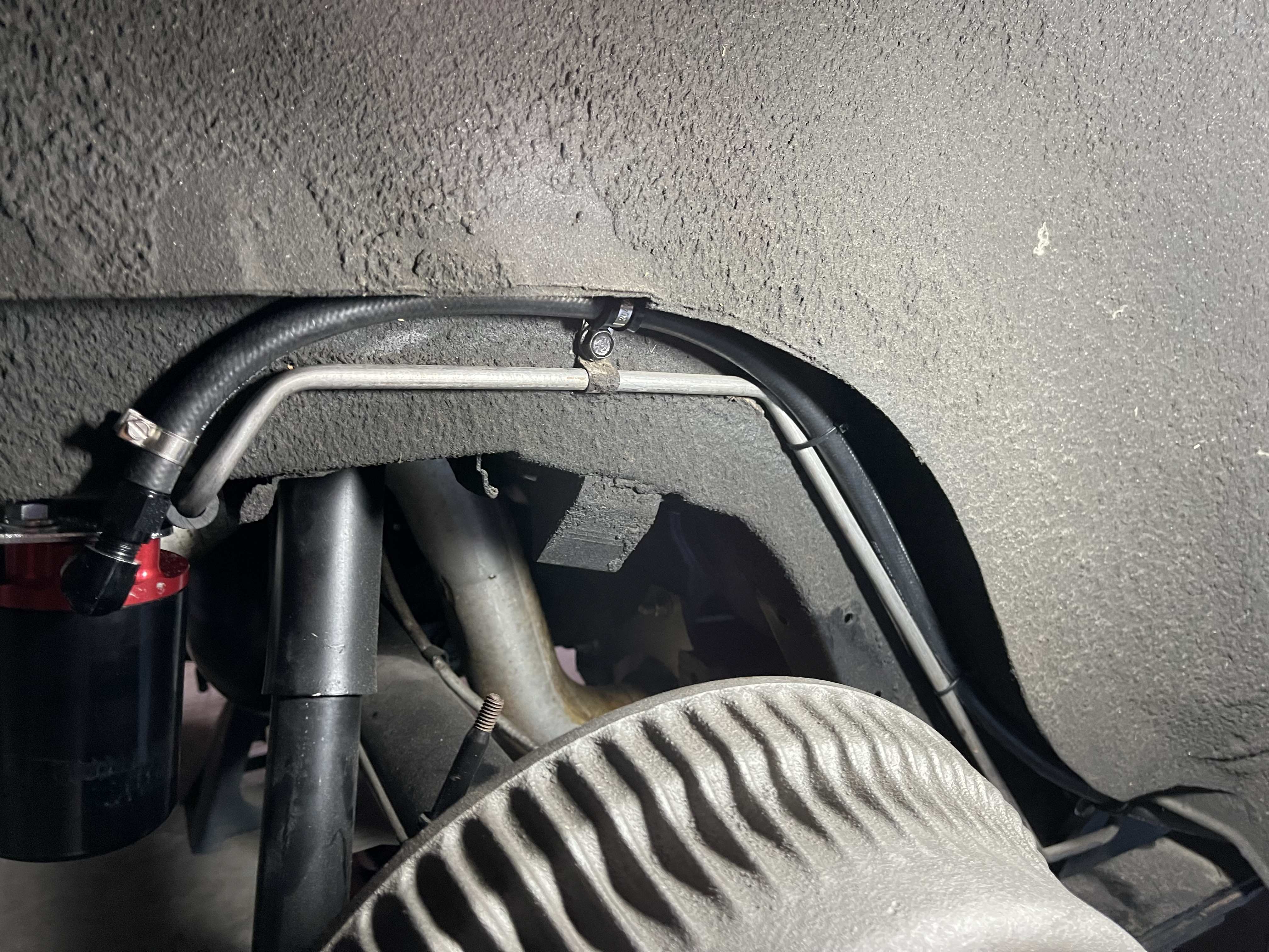

Agree with @Bigblue73, filtration is critical. I am running the Terminator X Stealth EFI and chose the Aeromotive SS Series Canister-Style Fuel Filter 12317. The 12317 comes with the 10 micron filter. My Holley Pro Billet regulator is firewall-mounted. The factory 3/8" steel line is repurposed as a return line.
I also installed a fuel pressure transducer from Holley in the fuel line to monitor pressure on the handheld EFI display.
