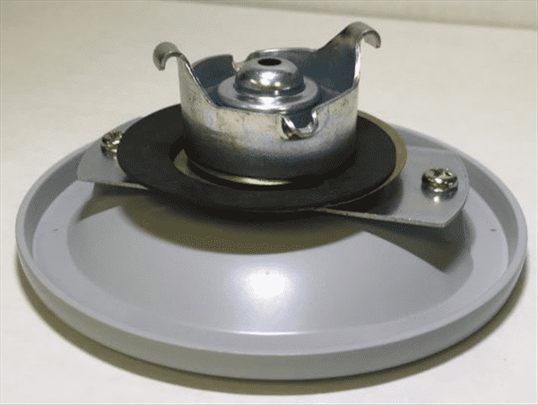

The rubber gasket on my 72 Challenger gas cap fell apart. The cap is painted and in nice shape so I don't want to replace it. Is there such a thing as a replacement gasket for these caps?
They said the gasket is installed as the cap is assembled so cannot just replace it. Ugh. Looks like YearOne for a new (repop) one.
Yeah. The one pictured in Year One has a gasket that looks kinda cheesy. Just look at the loose gasket!Be careful with a year one repop. I bought one not long ago and when I went to install it the spot weld broke and all the parts went down the filler tube. I would look for a good used one on ebay and just swap out the internals...two phillips screws and you're good to go.
The gasket that was on there fell apart when I took the cap off. It was all gooey. Guessing the gas ate it. Is neoprene stable around fuel?Looking at that picture just make a new gasket out of a sheet of neoprene.
Thanks. Looks like our US mass market store Walmart sells it in a 1/8" Thick x 4" Wide x 60" Long for a little less than $16. May be the ticket.Yes I have made fuel cap gaskets out of it before - worked fine. Relatively cheap and easy to get.
It won't handle complete immersion in fuel but splash is OK - not many rubber type materials can handle fuel.
Make a few and when they give out just put a spare on. From what I remember it swells a small amount but it doesn't fall apart.
Thinking about it a material called BUNA-N may be better. They make o-rings out of it not sure if you can get it as a sheet.
