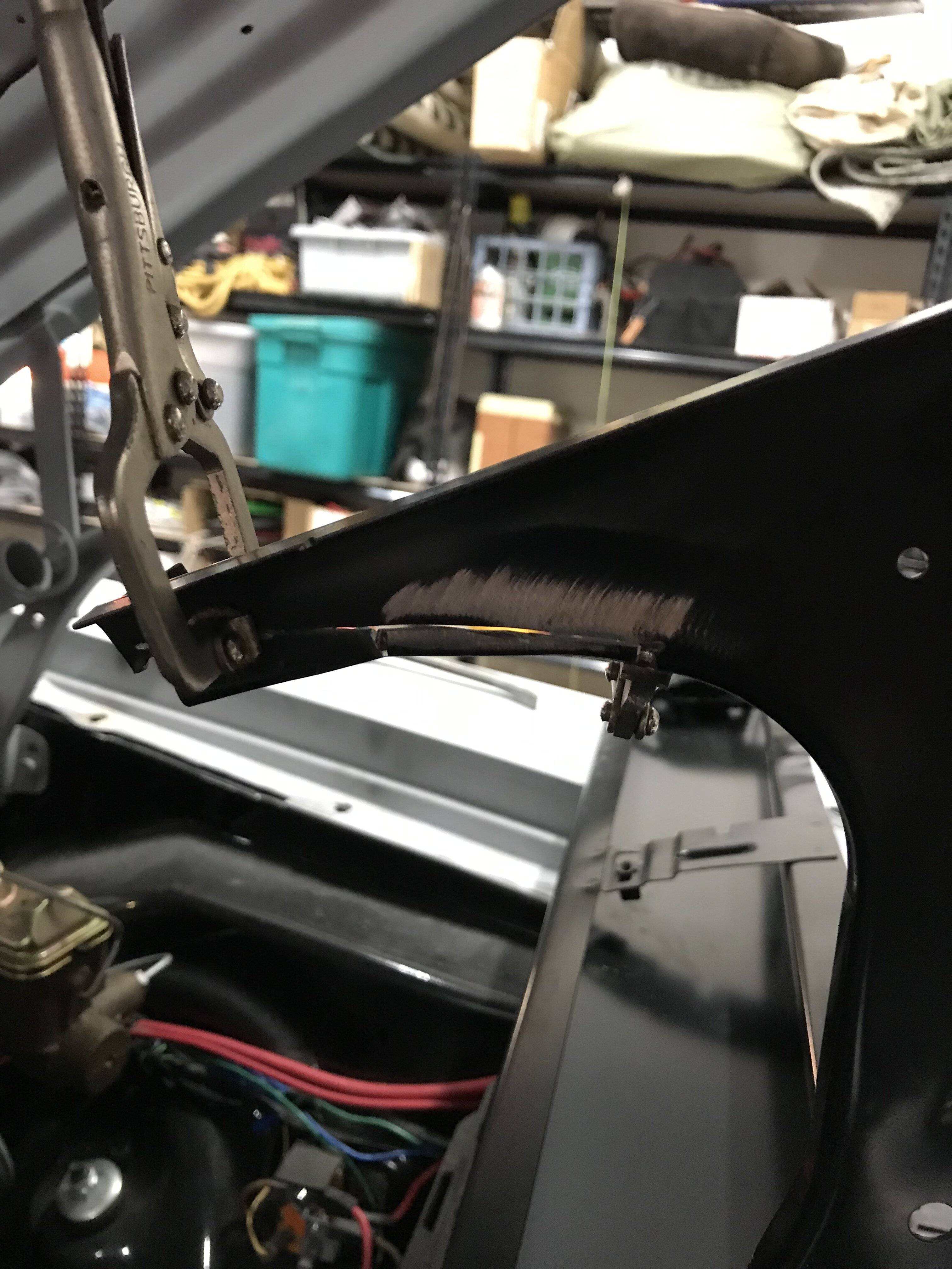

Dec 23, 2021 #1 rklein71 Well-Known Member Joined Feb 27, 2015 Messages 1,165 Reaction score 529 Location Amarillo Texas The lower middle bracket for the grill was off quite a bit. I need to tack it and reinstall and see if I got it right.
Dec 23, 2021 #2 Pepe70 Well-Known Member Joined Nov 28, 2018 Messages 119 Reaction score 10 Location San diego california That happened with me before some sheet metal part also from AMD do not fit like the original ones
Dec 23, 2021 #3 70chall440 Well-Known Member Joined Dec 11, 2010 Messages 1,260 Reaction score 981 Location Western Washington Yeah that happens, good job
Dec 24, 2021 #4 Challenger RTA Well-Known Member Joined Oct 28, 2018 Messages 2,755 Reaction score 1,374 Location PA Flood city I LIVE IN A PERFECT WORLD! NOT! Good job! The devil is in the detail.

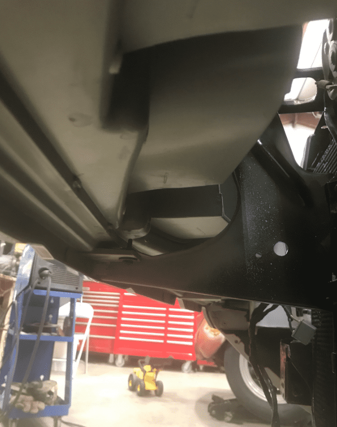

Dec 24, 2021 #5 rklein71 Well-Known Member Joined Feb 27, 2015 Messages 1,165 Reaction score 529 Location Amarillo Texas Mod is done, I had to take out about 3/8 inch to get tab to lay nicely against the grill plastic tab. Fits really nice now. Last edited: Dec 24, 2021
