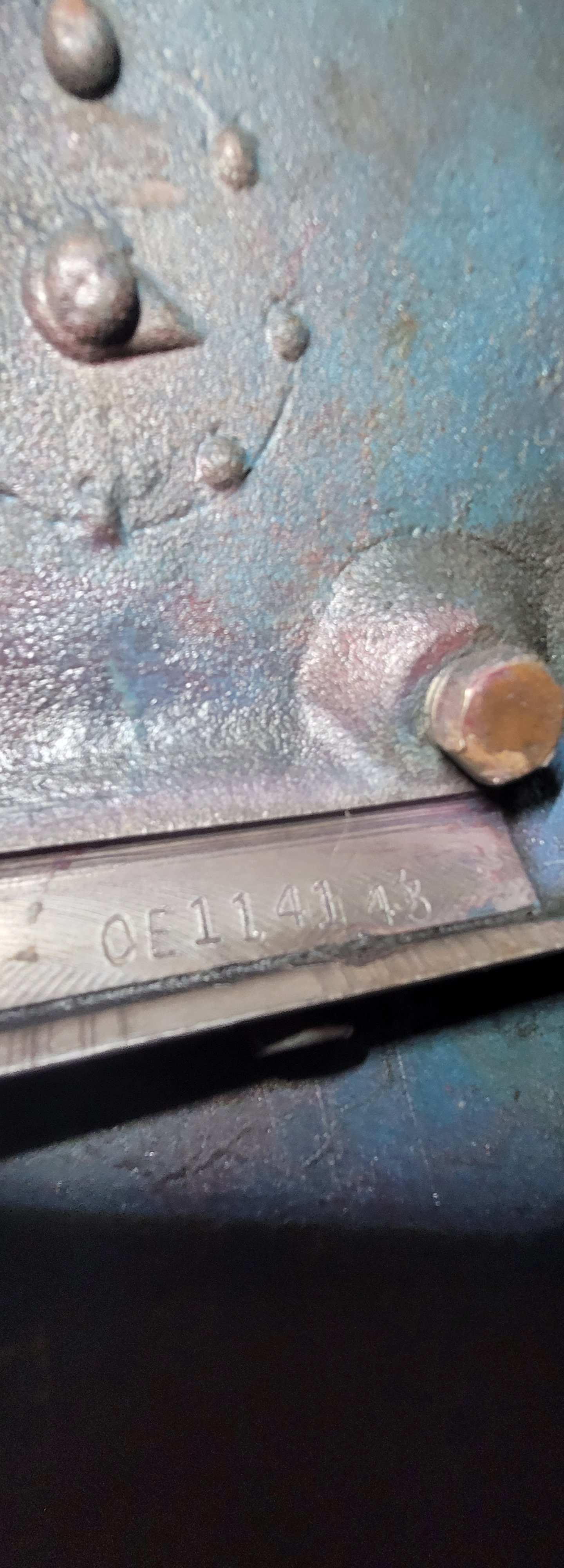

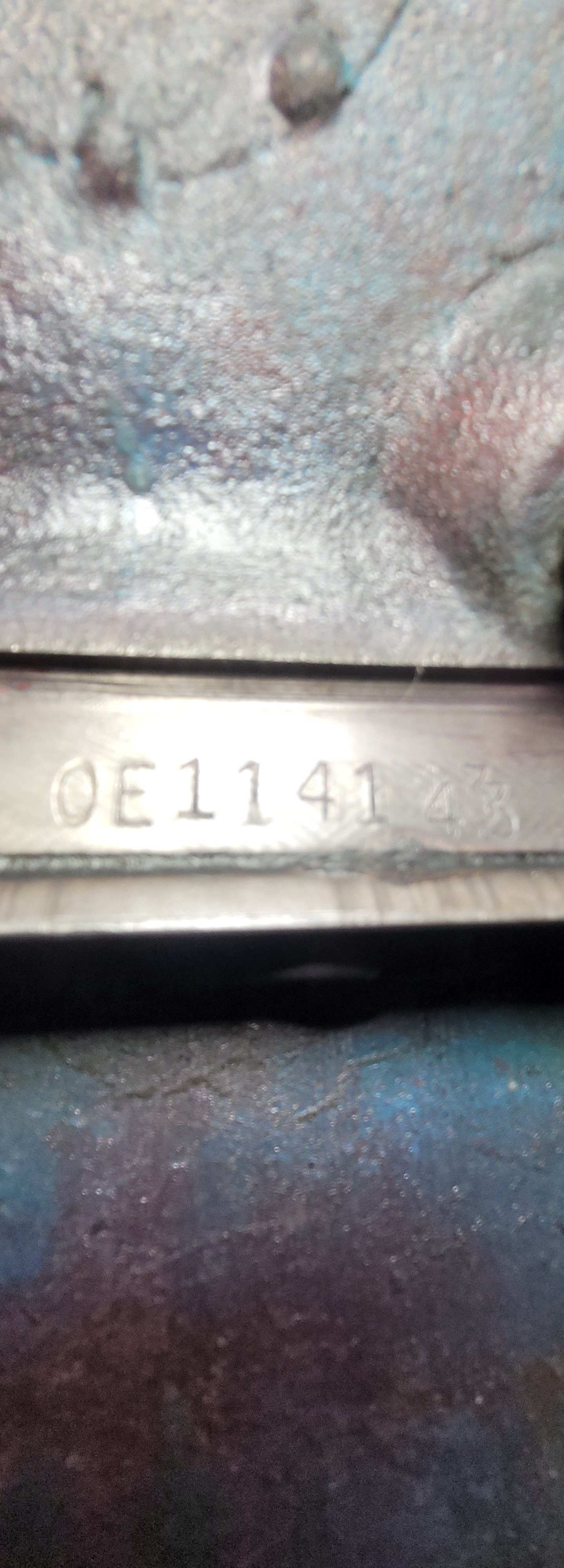

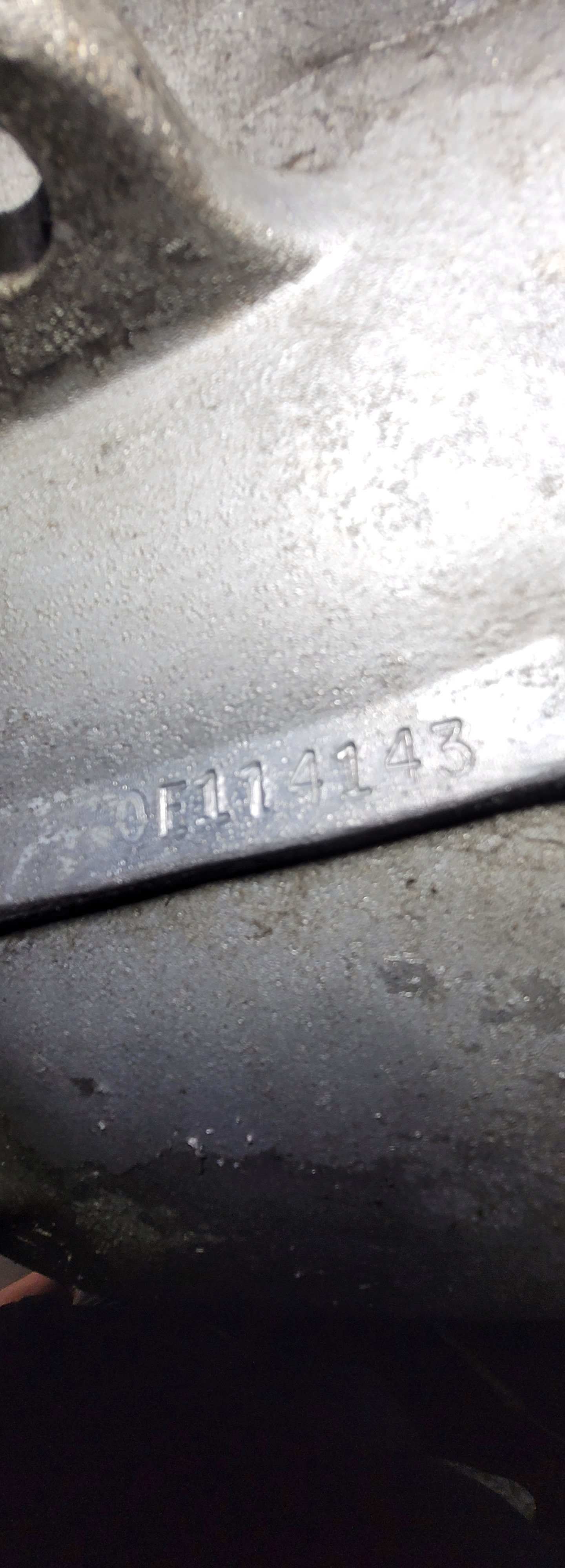

Hello all, can anyone help me identify if these stamps are legit. The only one I'm really questioning is the engine block stamp. It looks as though the last digit (3) was stamped twice. Other than that everything matches from what I can tell. I don't have the build tag on the fender as the car was painted and lost at some point from what I was told. Is there any way to check the history of the car? Carfax doesn't go that far back does it? How can I break down my vin to check the factory options?

Yes, it's a numbers matching car and typical of LA to switch the "0" and "E" on the radiator support and cowl body stampings. And the double strike on the engine block is common because that high nickel cast iron is hard material! It's also helpful to have the door sticker that lists the VIN, but these were painted over/removed quite often on 50 year old cars.

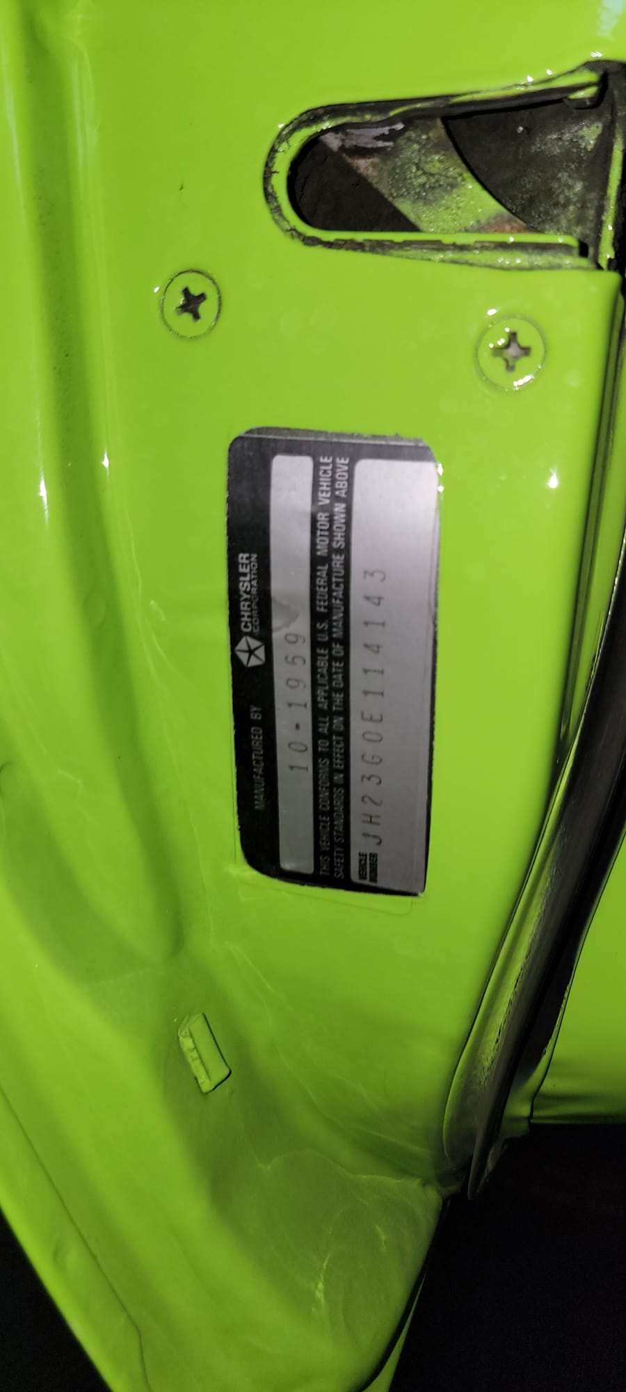

I have the door sticker too.

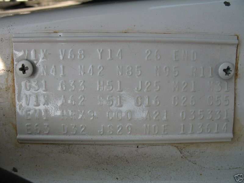

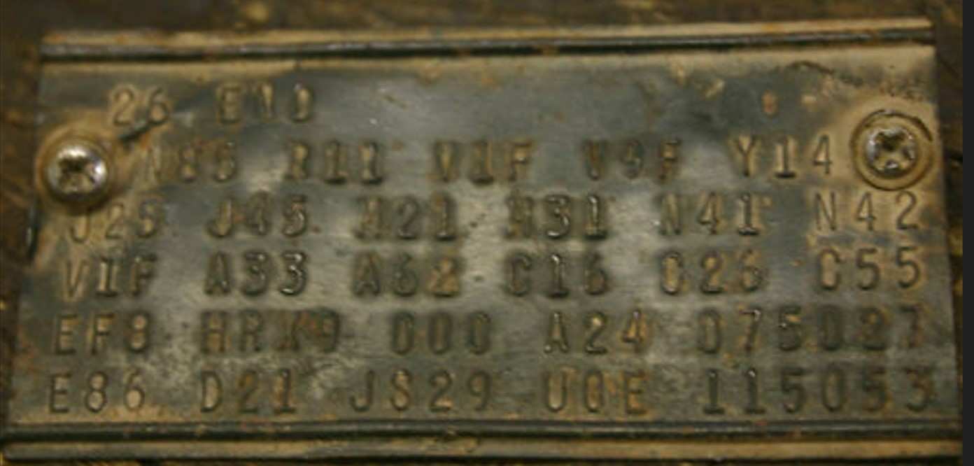

Your VIN of JH23G0E114143 for an LA-built Challenger would ballpark your Scheduled Production Date (SPD) as late-October. SPD would be approximately A23 (October 23rd, 1969). Below are the closest fender tags to your VIN sequential number 114143 that I have in my collection of images. Others on this forum may have an LA tag closer to yours to assist in narrowing it down further.
We can assist with configuring a repro fender tag if by some miracle you find a Broadcast Sheet somewhere in the car's interior. Search inside the springs of the rear seatback, passenger seat backs, above your glovebox insert, and even under the carpet.
Your decision on whether it is worth it to go to the trouble of configuring and getting a repro fender tag made.
