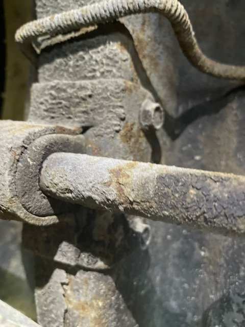

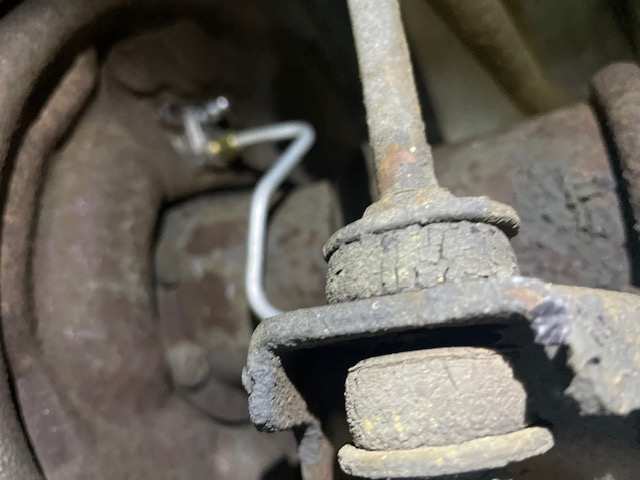

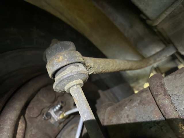

Thx for all the advice..I ordered (& received) a set of replacement leaf springs(w front bushings installed), as well as a new set of rear shackles/bolts/bushings from General Spring. They had everything in stock and the total price was ~$420 (along with add'l $95 for shipping and $30 taxes) which seemed pretty reasonable to me. I also ordered a set of Mancini front mounting brackets & bolts for the springs (I saw these referenced on a youtube video), So....onto Sway Bar bushings??
My car has the original rear sway bar offered on Ralleye cars with, what looks like, the original bushings/hardware (see pics). I confirmed the dia. is 19mm(.75") but when searching online, I have not yet been able to find a source for replacement bushings/brackets/hardware. I have found various sources for bushings/hardware for the front sway bar, which is larger and was offered on nearly all the early challengers(I believe?)..
ANYONE know of a parts source to help me restore the rear sway bar components????
THX
TeeScott
Juan Veldez
Jan 1, 2011
746
298
Nampa, Idaho
For all those bushings, I went with rubber ones from PST (see link to the right side while looking at "forums"). The poly ones will last longer, but give a little stiffer ride. I'm fine with replacing them if I have to in a couple dozen years or so. Just my 2 cents.
