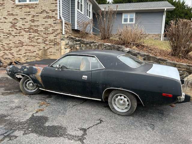

Greetings from Western North Carolina! Growing up I heard so many people say they wish they still had their first car. I actually listened and have owned my 74 Cuda since I was 15. In a world of mini trucks and CRXs, I had the most unique and signature ride in the parking lot. After sitting dormant for 30 years and too many people pestering to sell it to them to count, I recently made a horse trade that now has it in a shop being torn down for a long overdue rebuild. I plan to replace the anemic drivetrain with a 392 and upgrade the suspension for improved performance. The goal is to have the classic Cuda styling on the outside with modern amenities underneath. My motivation for joining this group is to glean ideas and insights from the E Body community. I look forward to reading and learning from those of you who are miles ahead of me with your cars and your knowledge. Wish me luck!

Welcome to FEBO from the desert! Lots of folks have done similar swaps you're doing, so you're definitely in the right place! Cuda looks pretty solid! What's the current drive train?

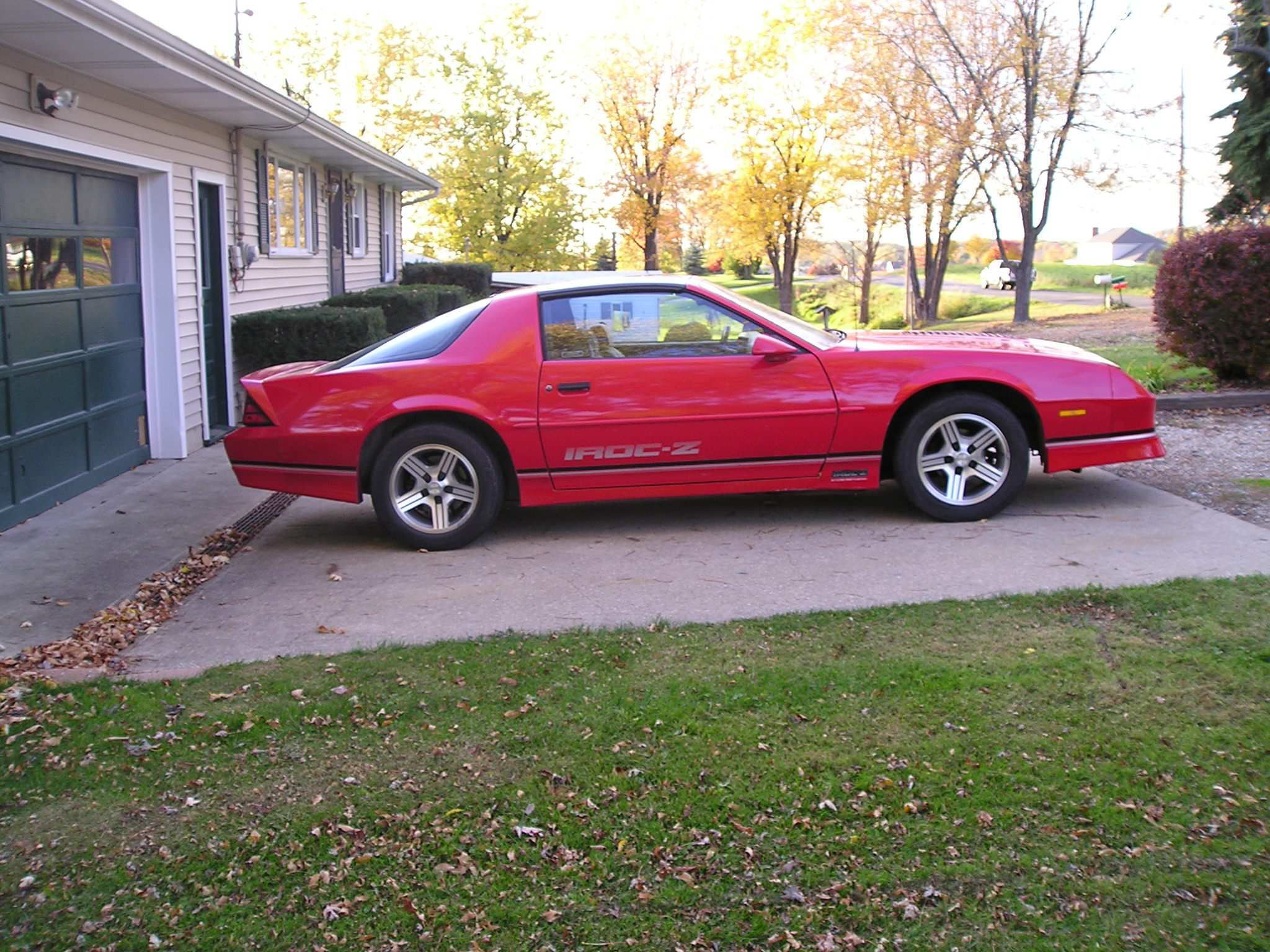

I can't say I have my first car, which was a 1974 also, but mine was a 74 Duster. However, I still have the first new car that I bought when I was 21 years old. Unfortunately in 1989 Mopar didn't have much in the way of muscle cars, if i remember correctly, they had a hatchback Daytona, so i bought this instead:

Cool that you hung on to the Cuda , I would be careful with suspension upgrades , many are at best a sideways move eating $$ for little or no gain .
Ehrenberg did a valiant corning at over 1 g just improving the stock suspension components without changing the design .

Thanks for the welcome! Car still has the 318/727 combo that was in it when I bought it. Still runs like a sewing machine even after sitting for almost 30 years. Trying to decide on suspension upgrades while the motor is out of the car.

Thanks for the welcome and the tip. Thinking about a QA1 K member to have more room for a Gen III Hemi swap. Exploring all options at the moment but want to do something since the motor is out of the car and things are easy to access.

Big torsion bars & sub frame stiffening with good shocks will go a long way to getting you there.....from Boone.

Hey neighbor! I live in Candler and just joined here myself. I've been on FABO for years, but have 2 E bodies and figured it was long past time to sign up here also. I sold a 74 Cuda 360 a few years ago, triple black automatic car with AC. You could just beef up the front suspension you have and be just as well off as getting aftermarket stuff. Weld the k frame seam solid, reinforce the lower control arms, add a bigger sway bar and torsion bars, add torque boxes and frame connectors, then a little bigger rear sway bar than it has from the factory. A Gen 3 Hemi swap is much easier in and E body than an A body, but think long and hard before you go down that rabbit hole. I got started on a 5.7 swap into my 70 Duster. I had a nice 6K mile motor I bought from a guy in Etowah, TTI headers and mounts and a 545RFE transmission. I started checking on wiring, and that's when I threw the brakes on. I just couldn't make myself pay $2500 for a harness and ECM. Sold all that junk and went back to my original 340 4 speed plan. Anyway....good to see someone else close by on here.
