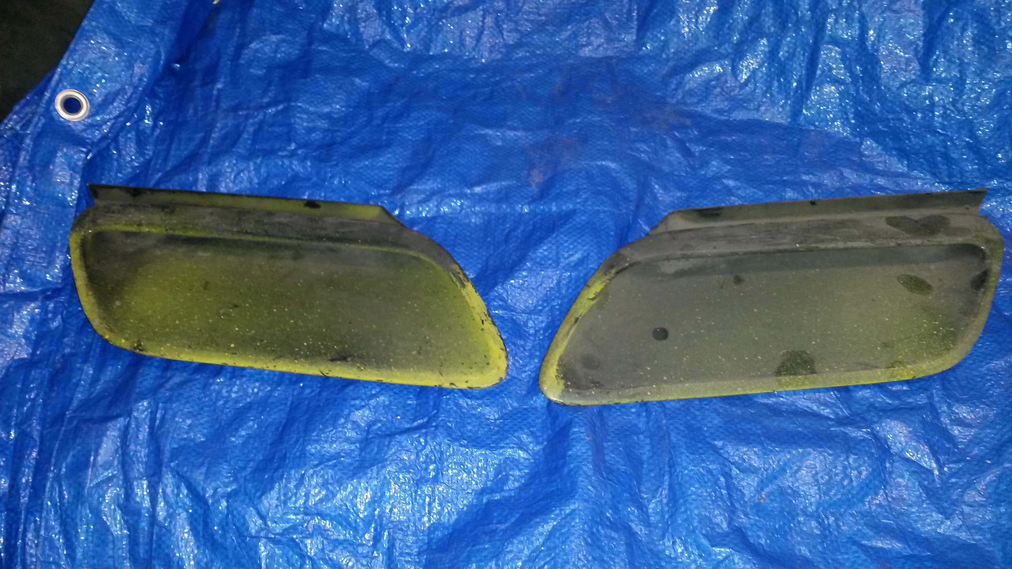

The hood scoops on my 72 Challenger are blocked with the original black plates. Is there any benefit to opening those to let hot air out while sitting in traffic? I know my newer 2021 Challenger has several hood vents to let hot air out. Just wondering.

I would think opening them up like you suggest would let some hot air out. Any amount of hot air coming out has to be better than none. Try and see if you notice a difference.

I never noticed any difference after I did it to my first 70 Cuda. I didn't even mess with them on the Cuda I have now, I regard it as a wasted effort. BTW, I live in the desert southwest.

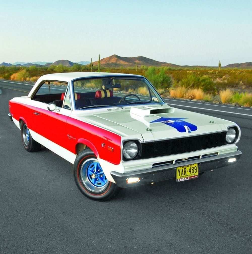

Back in the day, this was considered one of the better factory hoodscoops!

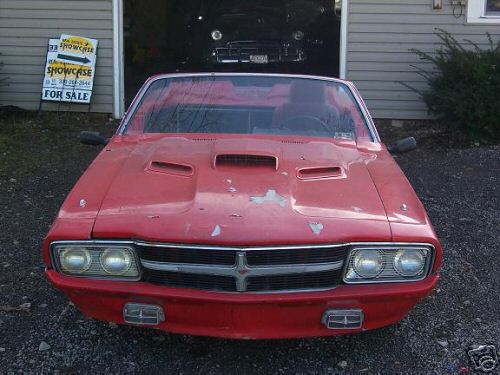

While were kinda on the subject. This is someones idea.I think it was in OHIO. I think a air grabber would have been a better choice. See if you can identify the other parts.
