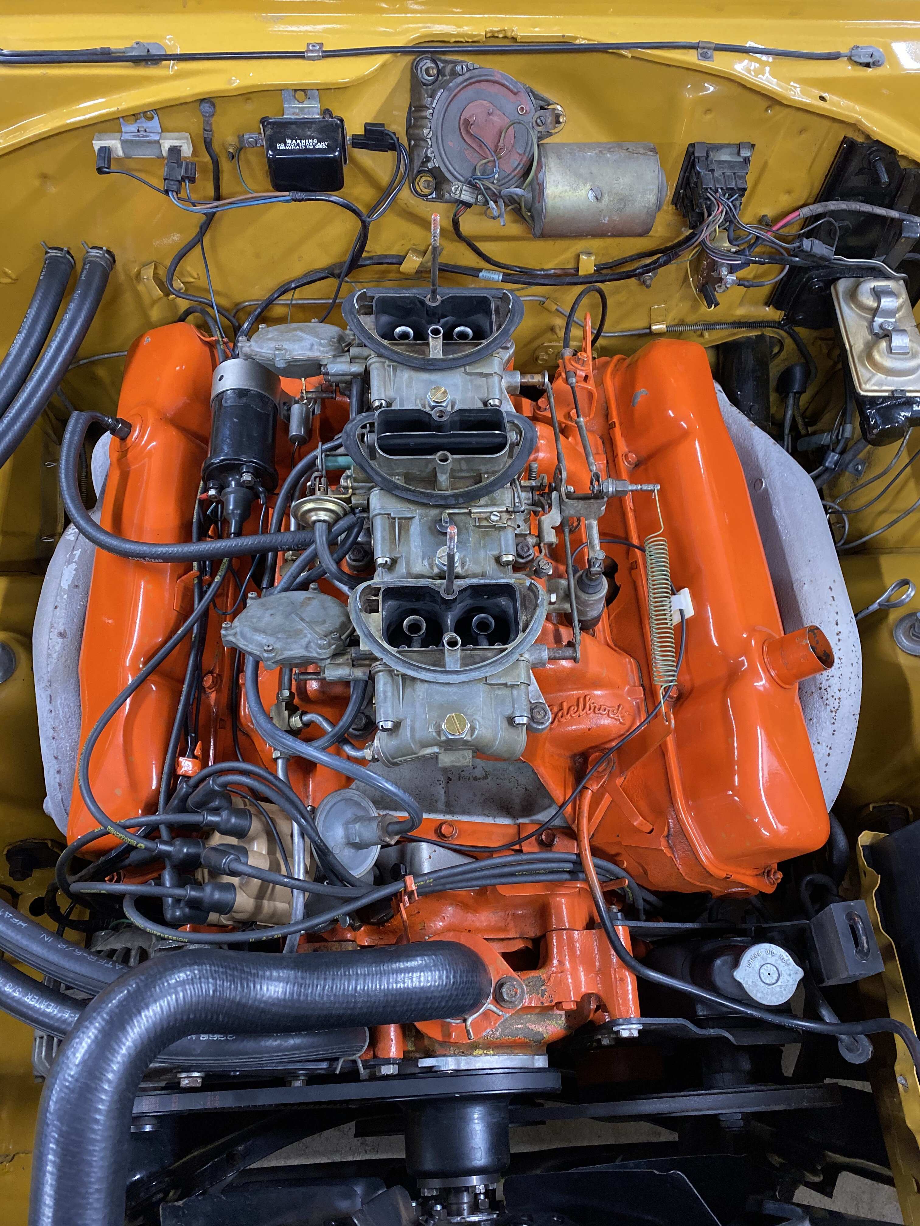

Here's my factory set up. Zoom to the right of the center carb, between the linkage and the spring. There you will find the solenoid that will cure your run on condition. Good luck.
