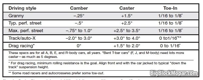

I bought adjustable upper control arms from BAC so I could get more caster. I had the alignment tech go to +4.5. Really helped with the stability of the car. No longer does it follow every rut in the road. Next time you get an alignment, have the tech use the max street/performance settings from the skosh chart. Your car will thank you.

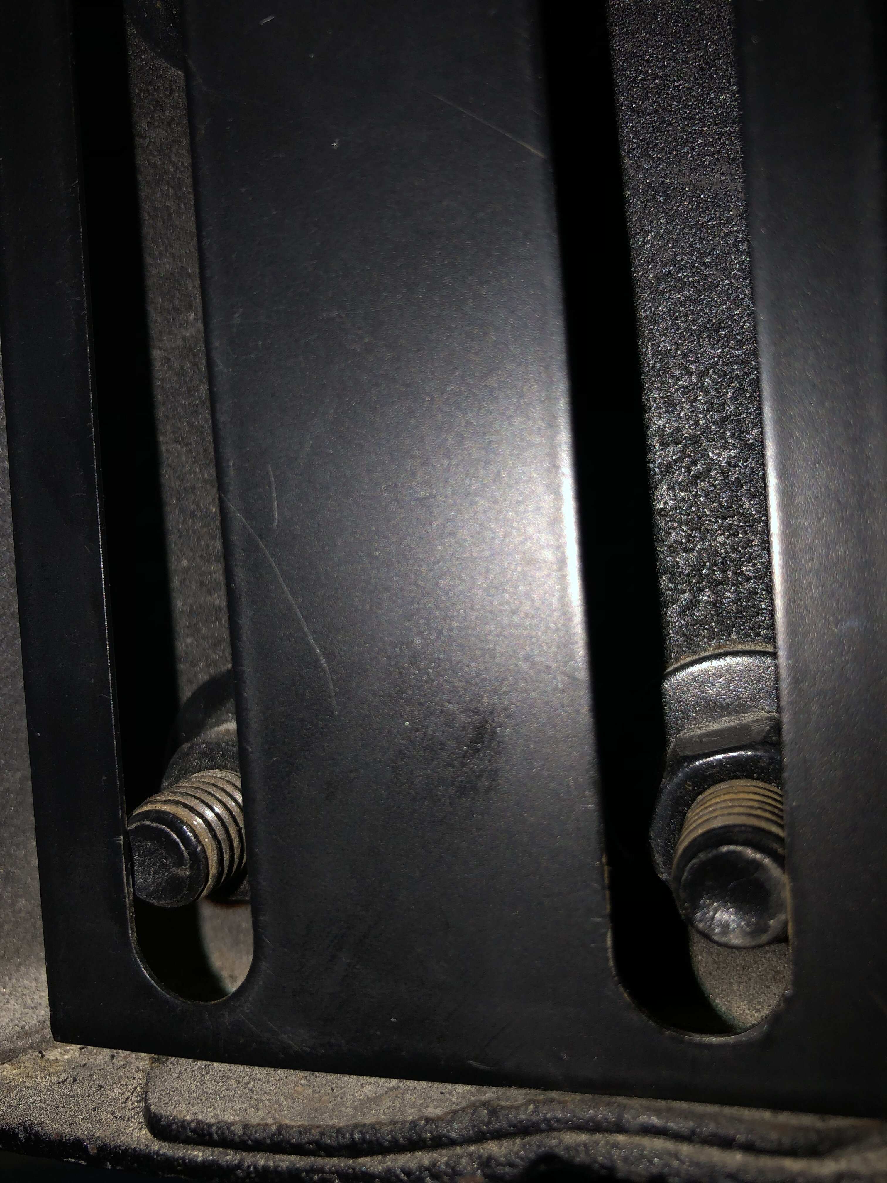

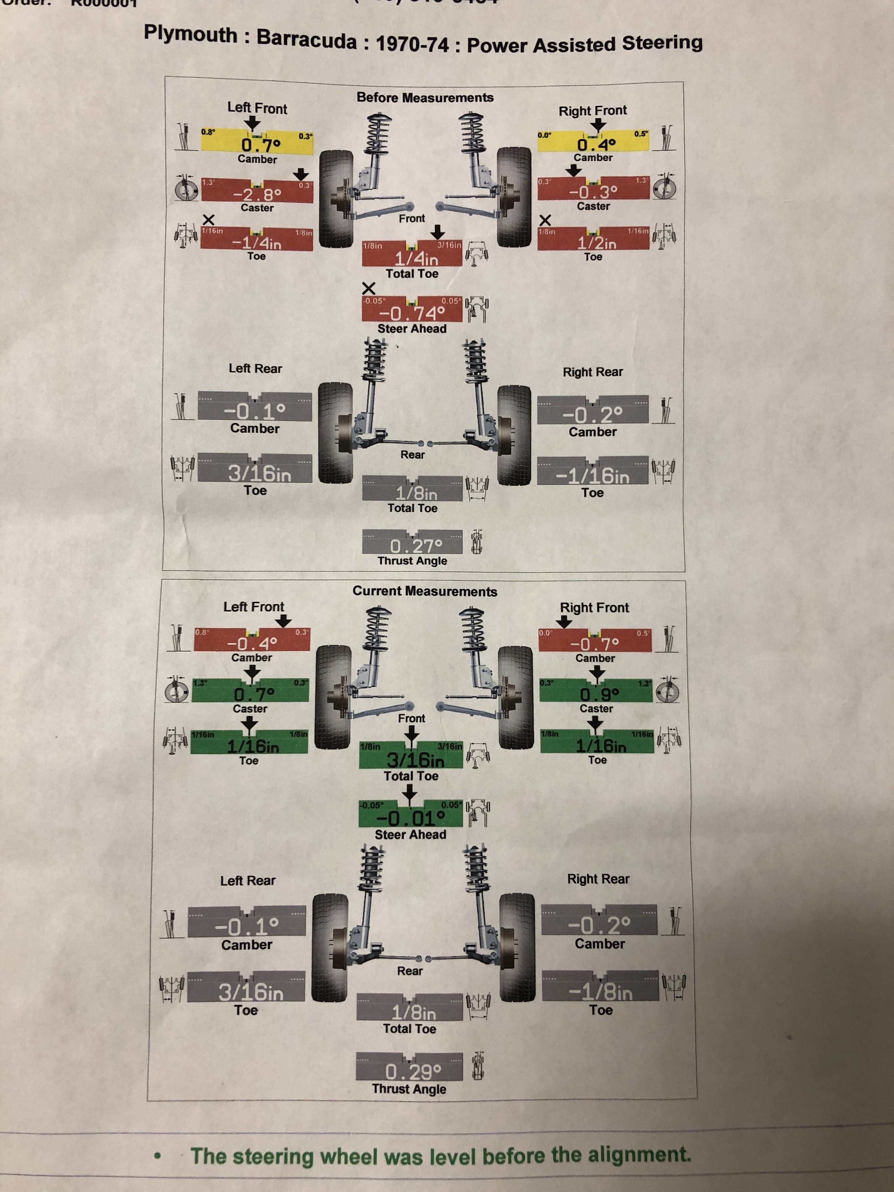

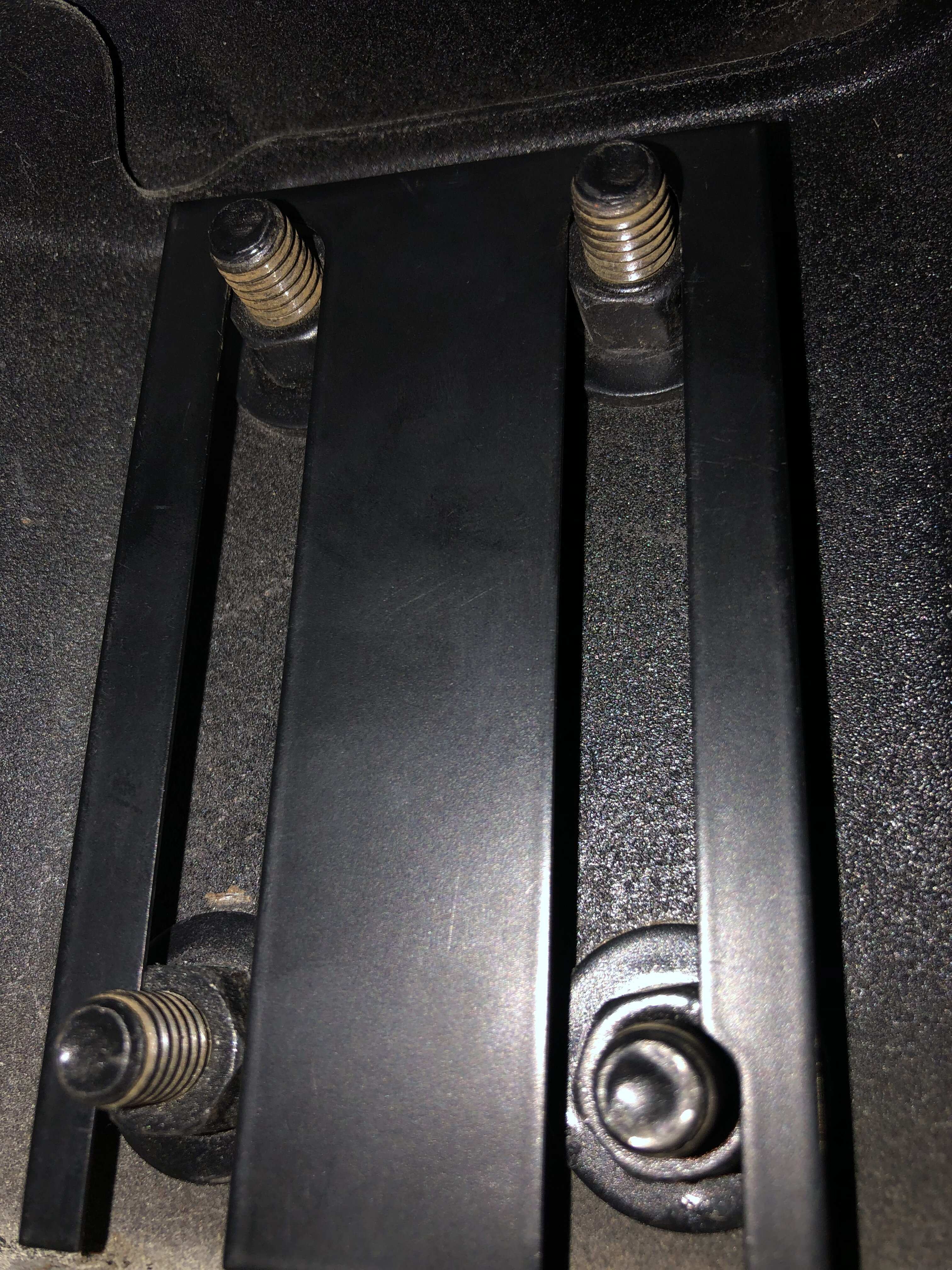

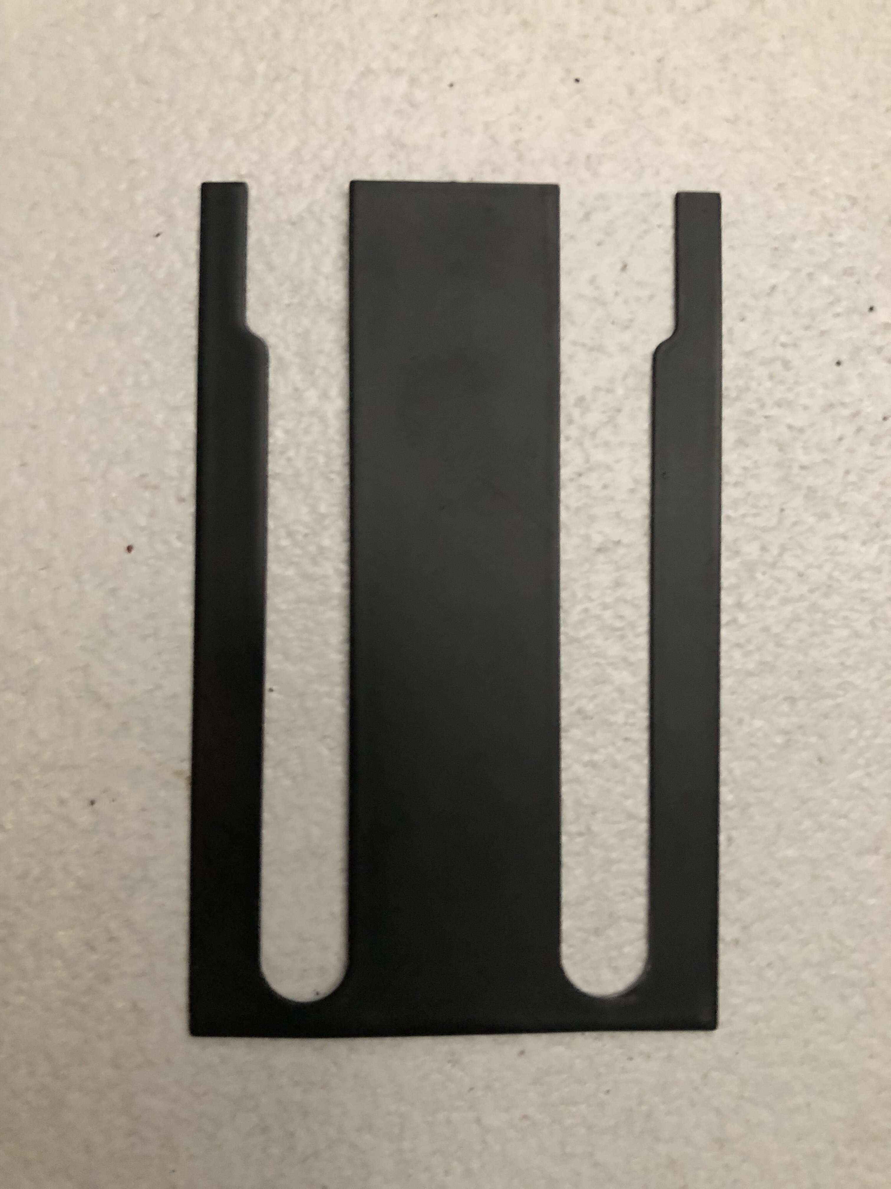

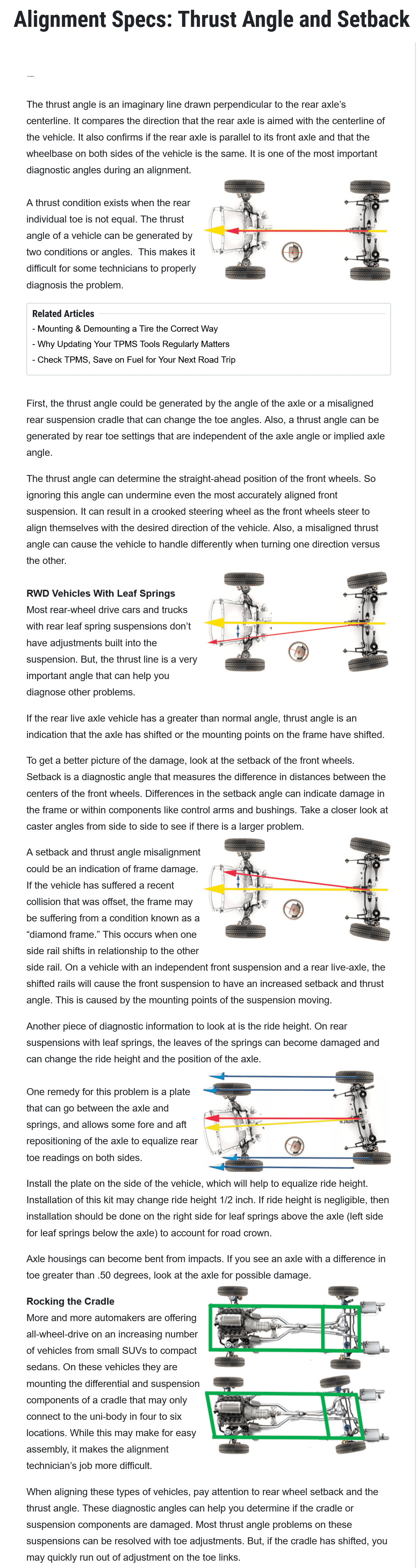

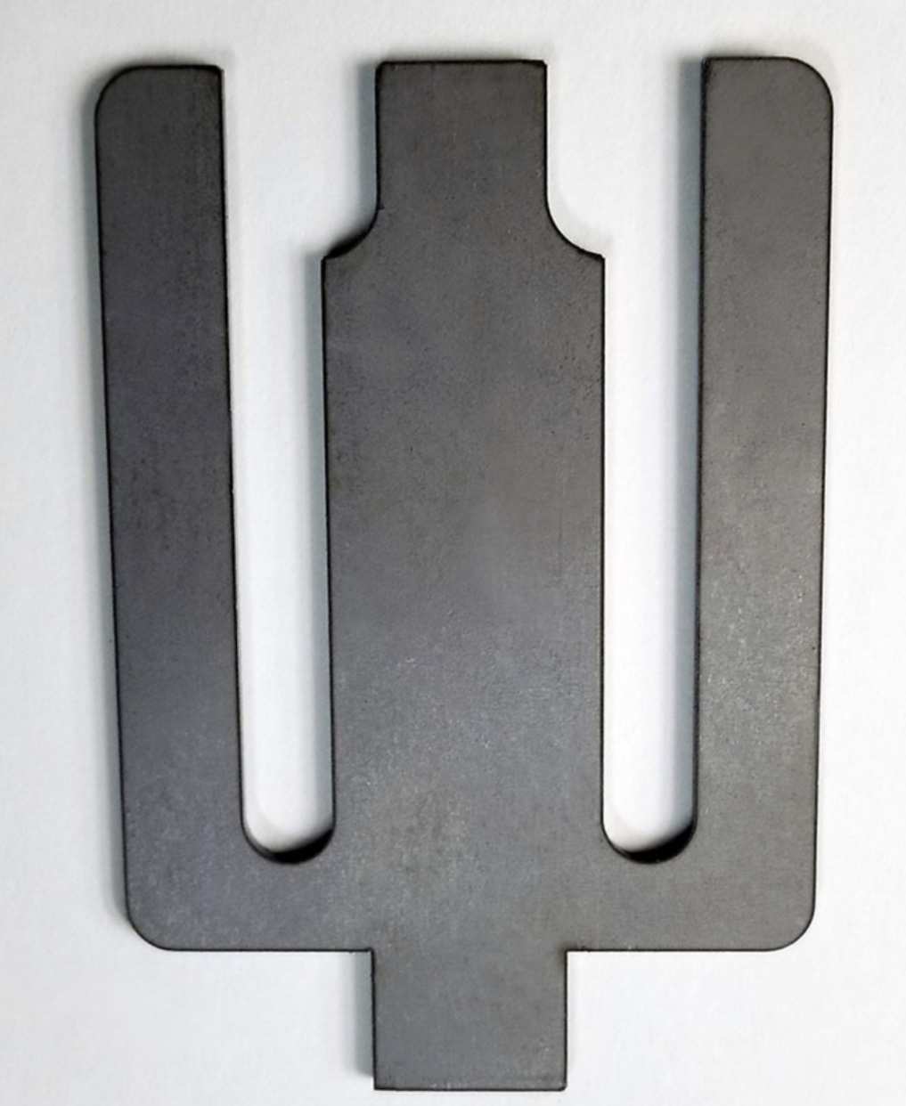

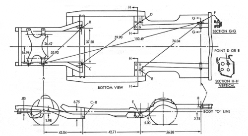

After reading the article, I chose to buy some from Summit Racing. A pack of (6) 1/32 shims #3003 cost me over $70 with tax and shipping. Picture #1 below is a picture of the shim (supposedly for a 70-74 E body)) from the installation instructions. Picture #2 is the actual shim that comes in the kit and according to HOTCHKIS, the only one they produce. Picture #3 shows how the shim would fit (or NOT fit) if you were to attempt to “slide” them in from the bottom AS IS NECESSARY unless you remove the spring mounts from the car! Picture #4 shows that they might actually fit if installed upside down; as in REMOVING THE SPRINGS. Bottom line…. They don’t work and will NEVER work on a 70-74 E-body with stock spring mounts and the corresponding factory spring mount hole location in the perch bracket. When I talked to the tech/sales rep at HOTCHKIS he said: “Yes, I see how they won’t work. They must be for our spring mounts.” Uh, I don’t think so unless you want to drill new holes in the perch plates. So, I don’t understand how they worked on that 69 Dart in the article above. Are 69 Dart spring hangers different than the ones an E-body? Moving on…. Picture #5 is of ones I bought from BERGMAN AUTO CRAFT here in (Hempstead) NC. I bought (4) 1/8” shims (the only size he has) for about $39. Yes, they look like the ones in picture #1 below. These actually work PERFECTLY.

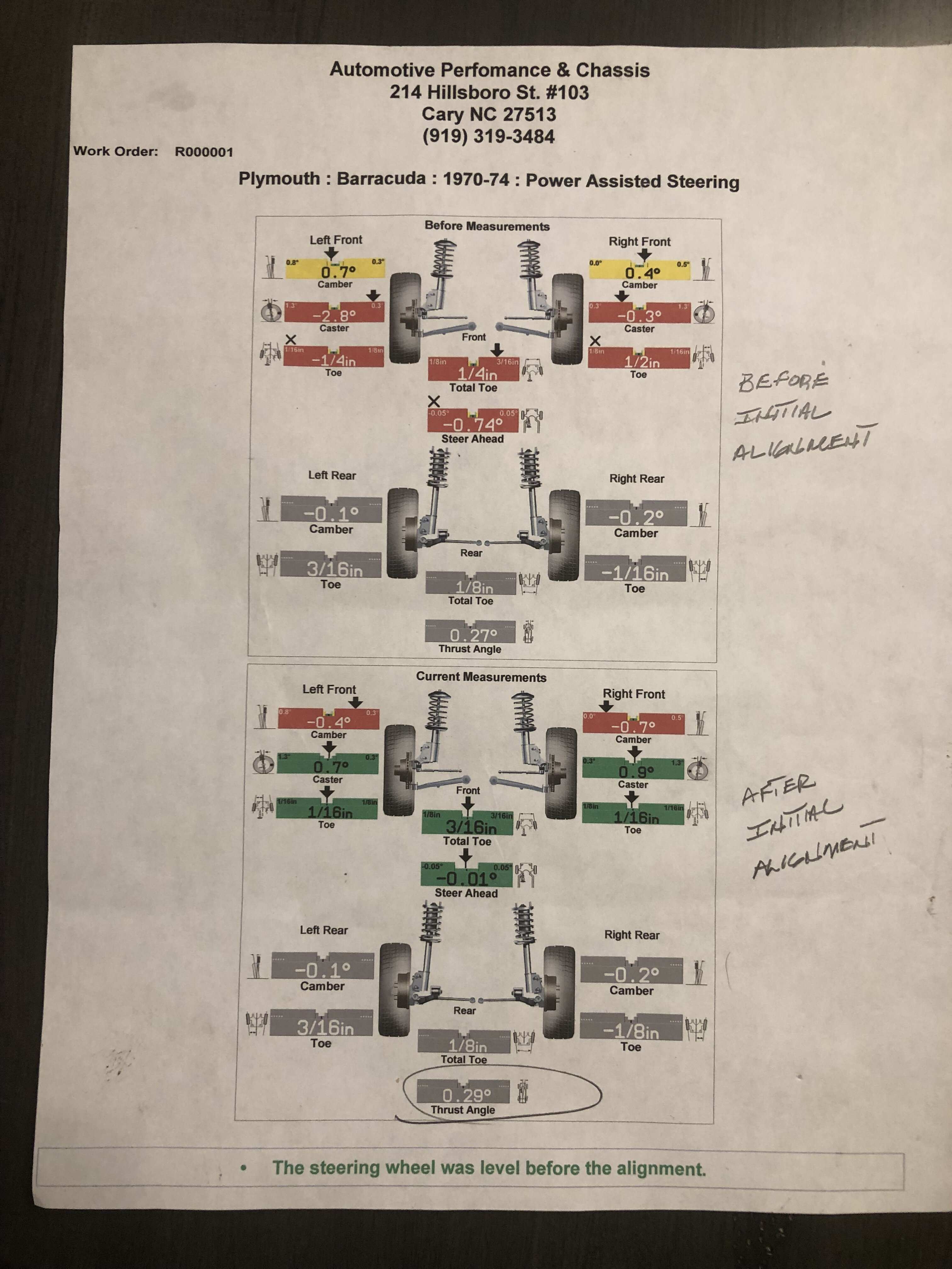

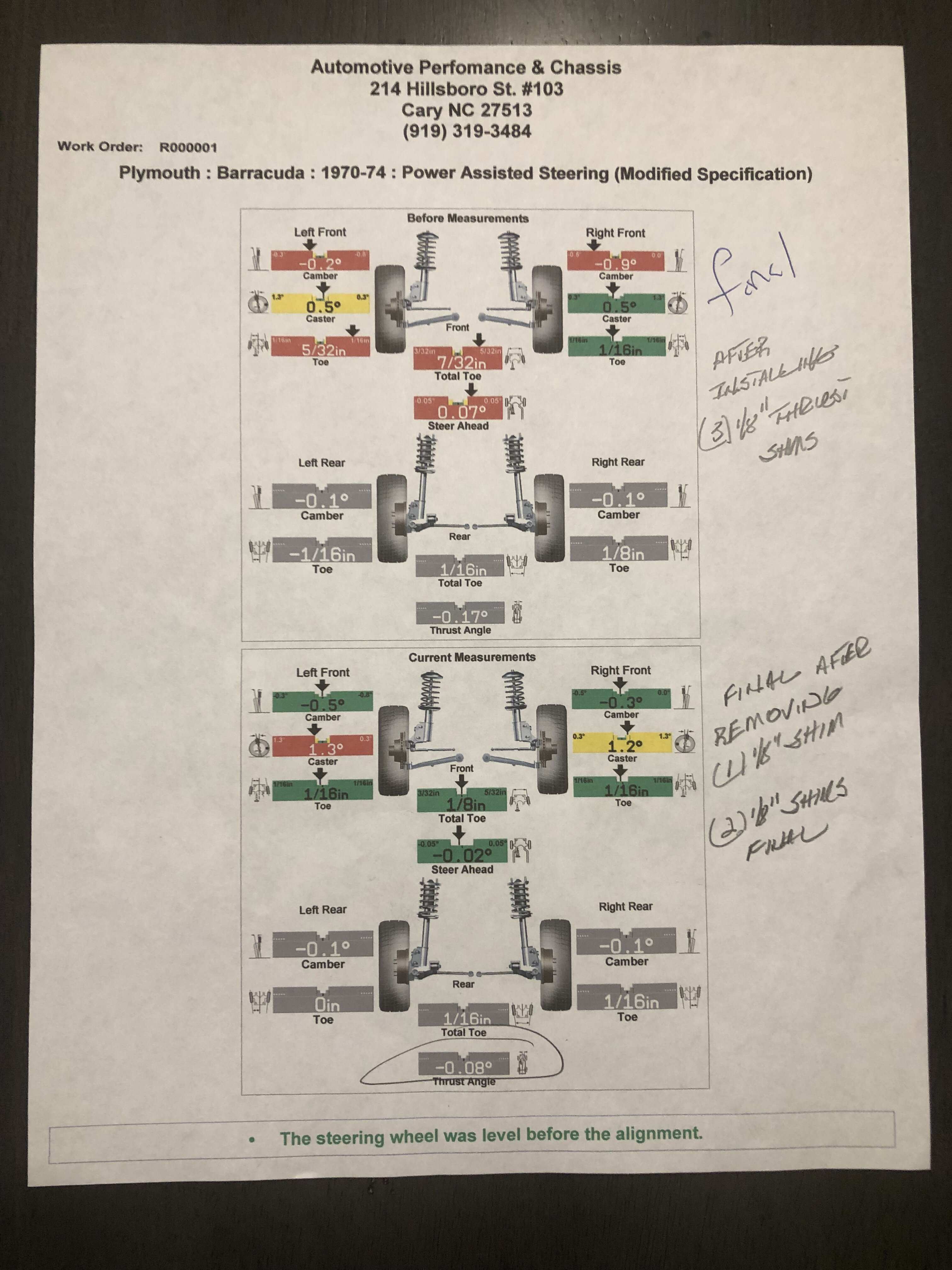

Returned to alignment shop. Picture #6 is of the original attempt at alignment. Picture # 7 is the second alignment. As you can see, the 3/8” shims moved the thrust angle from .29 to -.17. So, we pulled out one 1/8” shim for a final thrust angle of -.08 with 1/4” of shim.
THE BOTTOM LINE:
Now the car drives nice and straight, no pull, steering wheel nicely centered, and returns to center fairly good even though we could achieve only about 1 1/2* of positive caster and still have some negative camber. Front and rear toe is nearly optimal.
