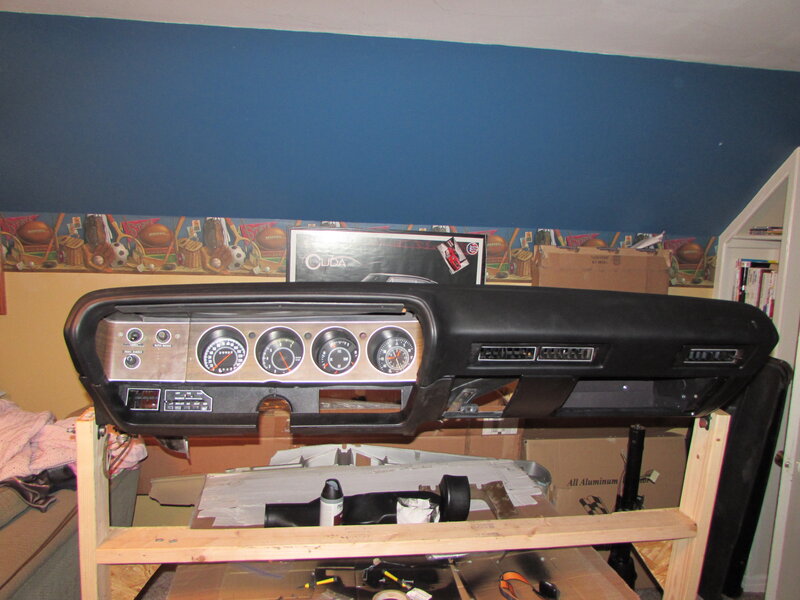

I have a 70 Cuda with a non factory AC dash. Can I cut holes in my dash frame for AC vents?

You can but then your problem is finding the vents and under dash ductwork. Not reproduced and expensive to buy used if you can find them. Put the feelers out to see if some one is doing the opposite of you and wants to sell a complete a/c dash setup.
Good luck.
Look in the 1970 Plymouth Service Manual for pictures.

Really just vent openings, registers, control head, duct work, different heater box. I would think it would a bit difficult to cut the openings but, sure it can be done. As Leo said, look for one already set up for a/c. Can also consider vintage air system.

The area where the vents go are depressed a little for the bezels of the air vents. If you cut the vent holes your vents will stick out further than they are supposed to.

After reading the replies again and taking my factory heat only dash pad off the frame it looks like the frames are all the same with holes for vents. It's the dash pad that has the holes for the AC vents or not.
I'm going to paint the dash frame, buy a AC dash pad and an aftermarket AC system.

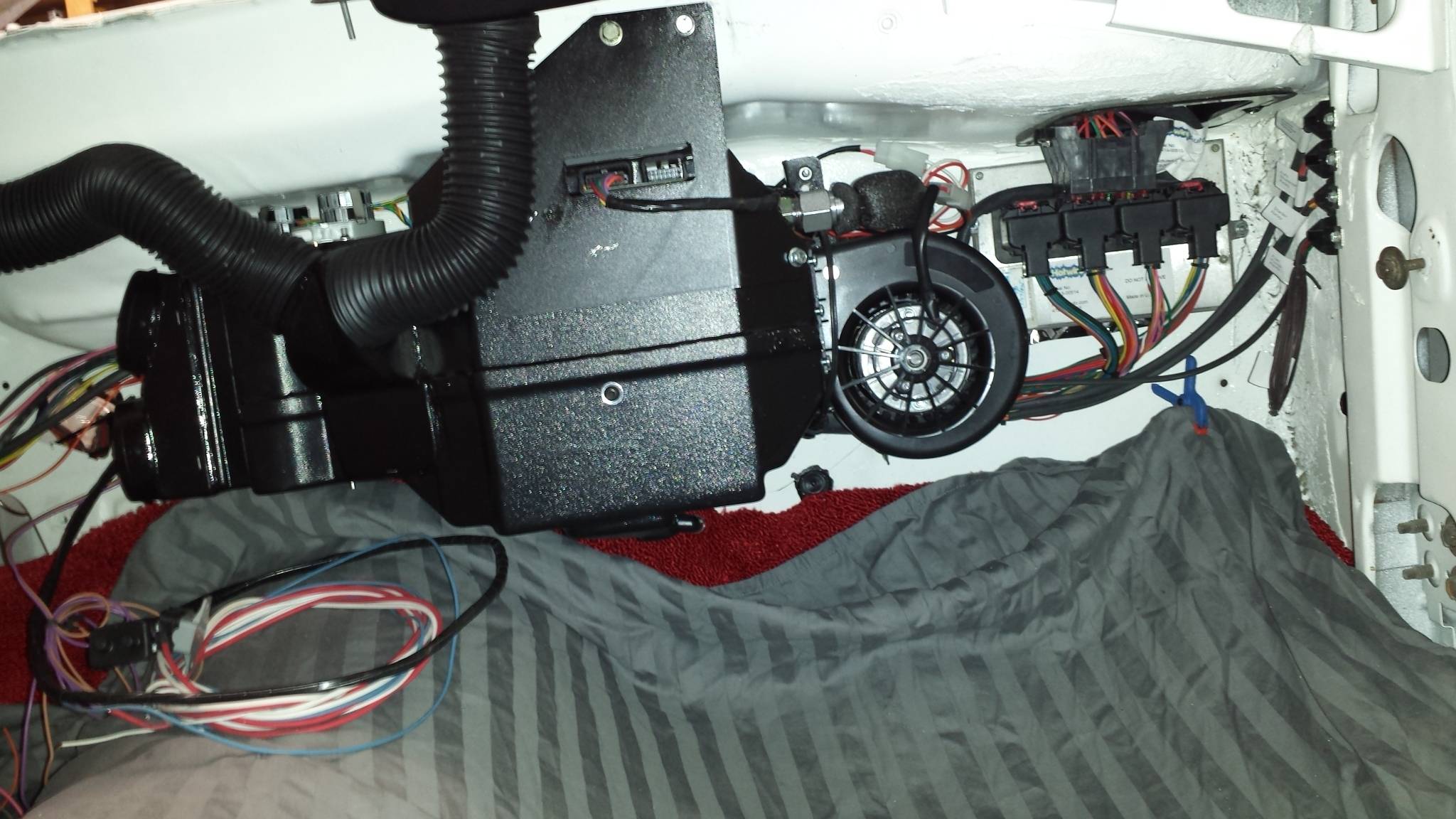

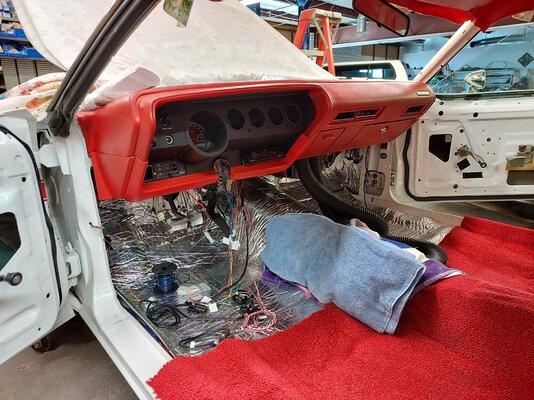

I've done both the Classic and the Vintage setups in E bodies and Vintage is the better setup. Doing a Vintage now in a 72. They have adapters to connect their flex hose to the factory a/c vents.
