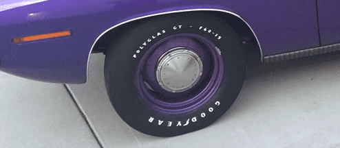

I am looking for what I believe is called 15” steel wheels. They come black but usually painted body color with a dogdish center hubcap. My car came with 14” ralley wheels with trim rings and centers like the second photo.
I actually like both styles and wouldn’t mind having a second set to use when I want to change the look up. So I’m wouldn’t mind getting a set of both in 15” even though my original inquiry was about the 15” painted “Steel” wheels.

If you’re looking for correct appearing 1970-71 15X7 steelies s check with Tony’s Mopar Parts. He made repro “450” wheels that are pretty spot on. Third item down:

Summit Racing has Chrysler steel wheels which will accept the factor "dog-dish" hubcaps. Paint `em and you are good to go.
I have heard that some people find that the dog dish hubcap doesn’t stay on this brand wheel as you drive. Most are disappointed. Does anyone one else have an opinion on how good the dogdish stays on? I don’t want to spend the money if the caps don’t stay on. I want the dogdish look.
Any other suggestions?
