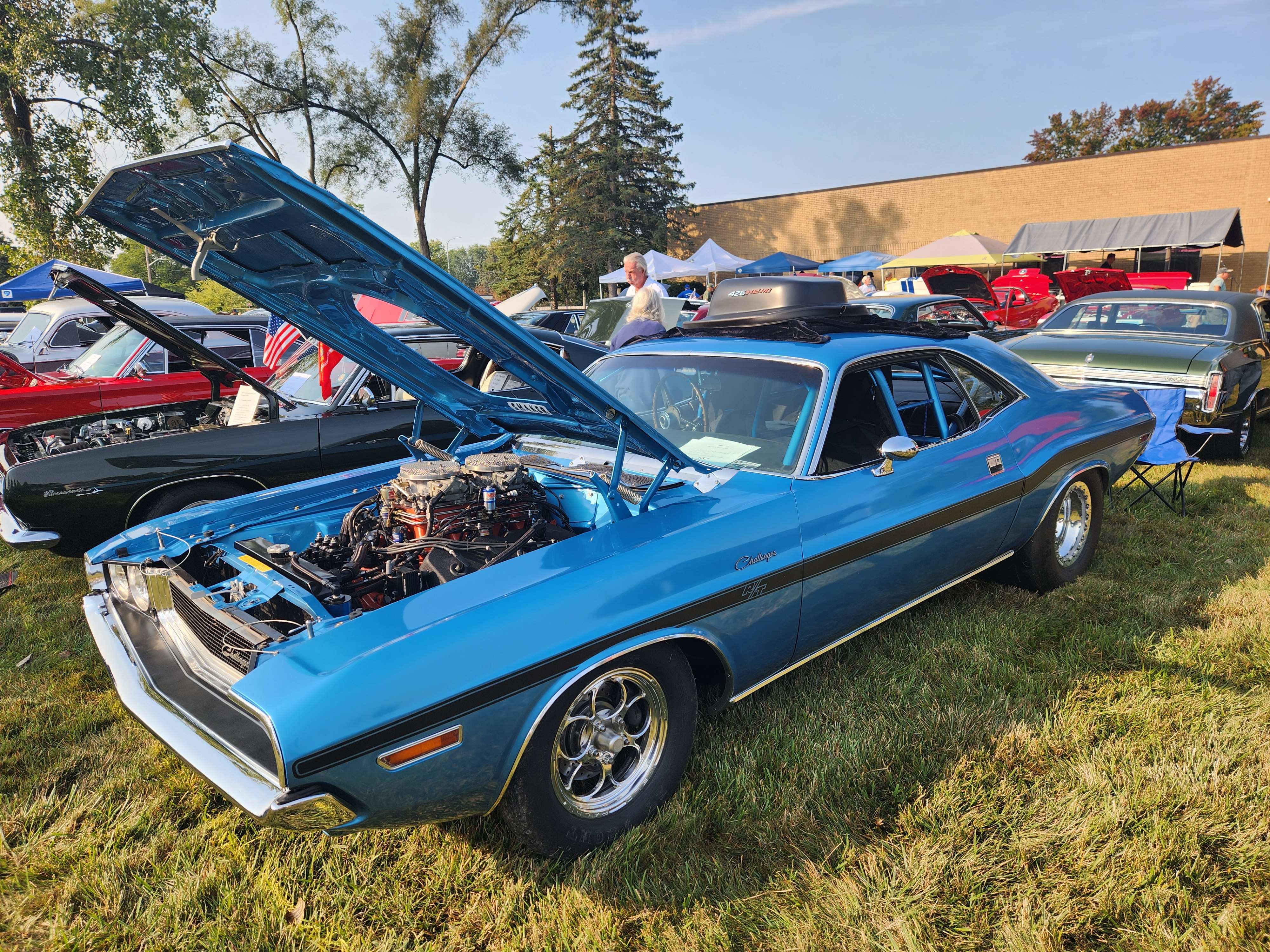

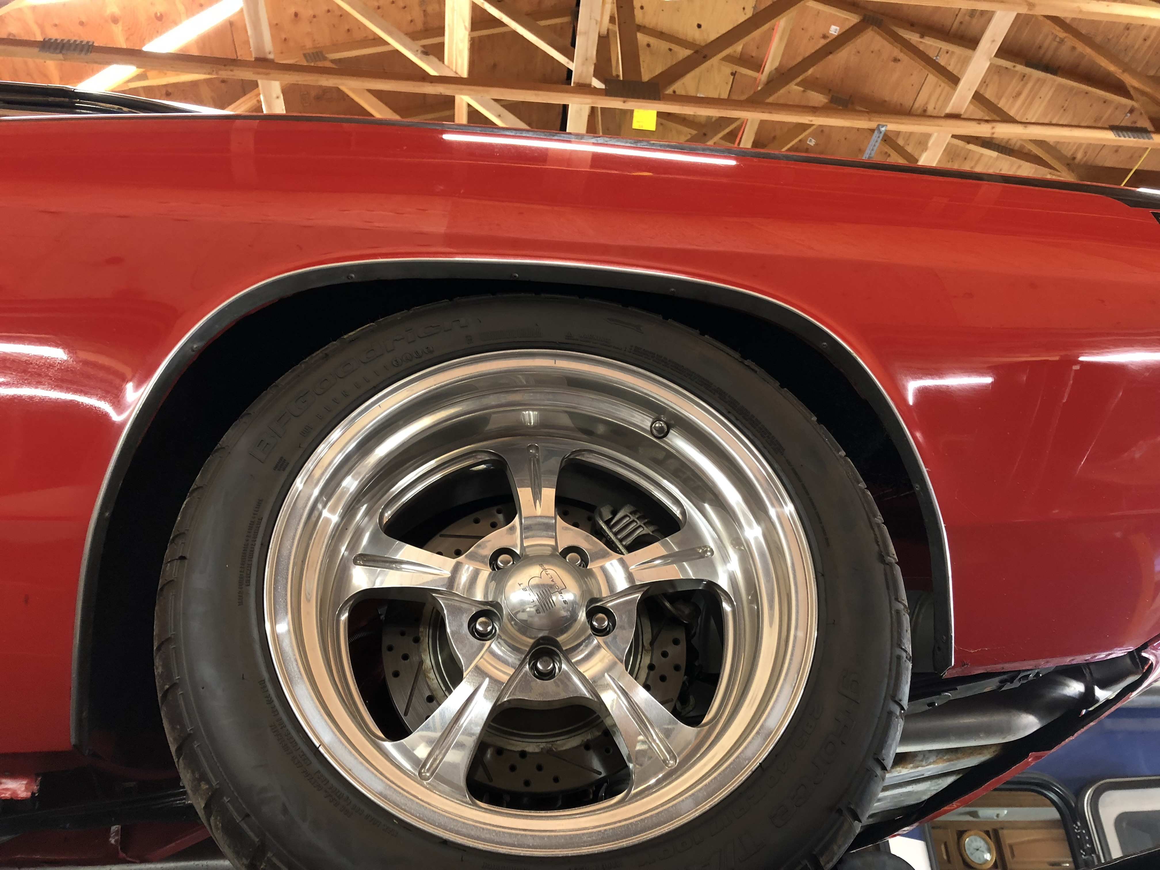

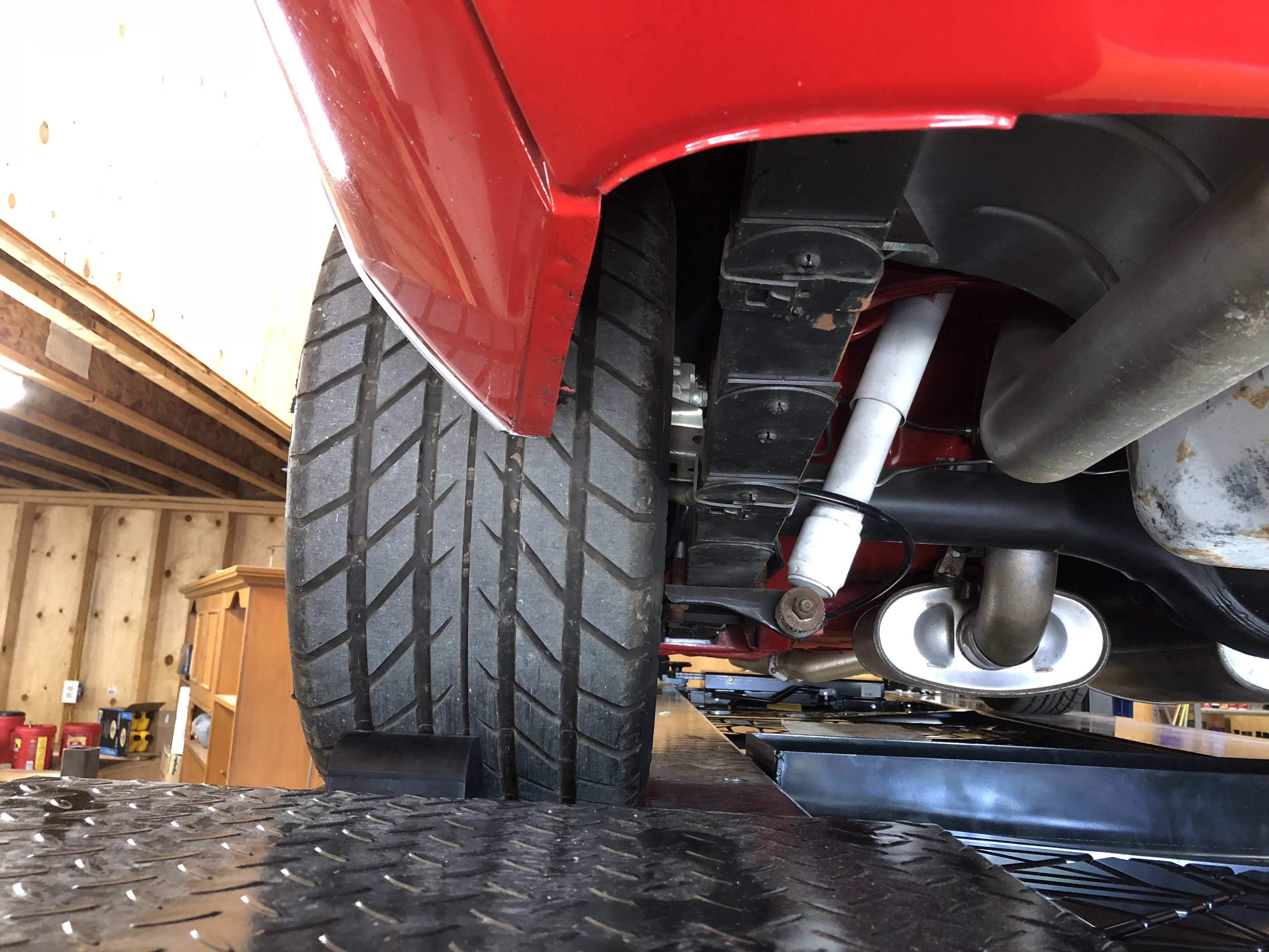

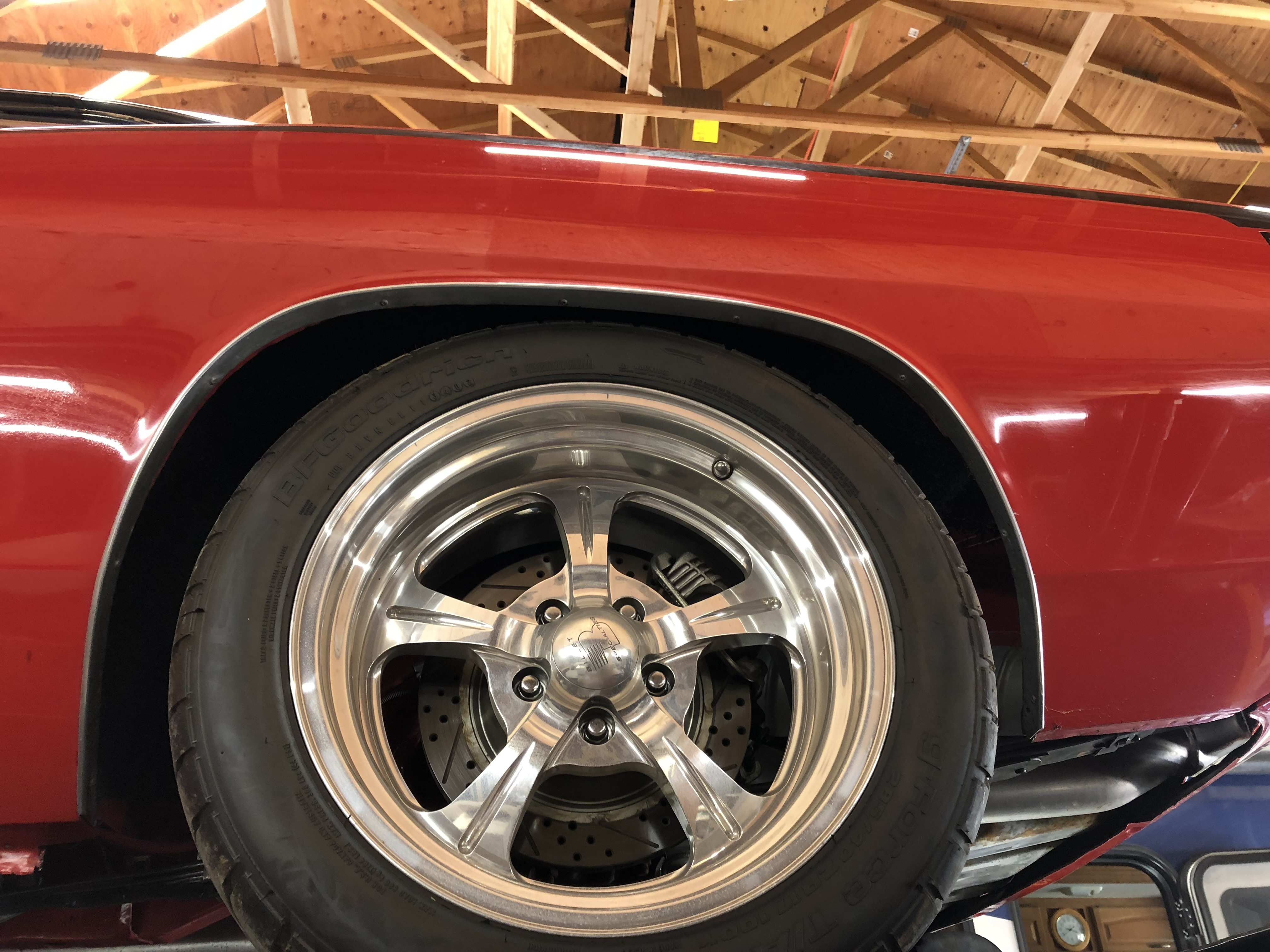

I think you are close to the max size, but you should be able to go with a 285. I tried to max mine out with basically stock components (I did go with rear disc though) and I run a 285/40-17. The 17 was to allow for brake clearance and a little lower profile tire.

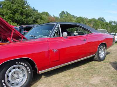

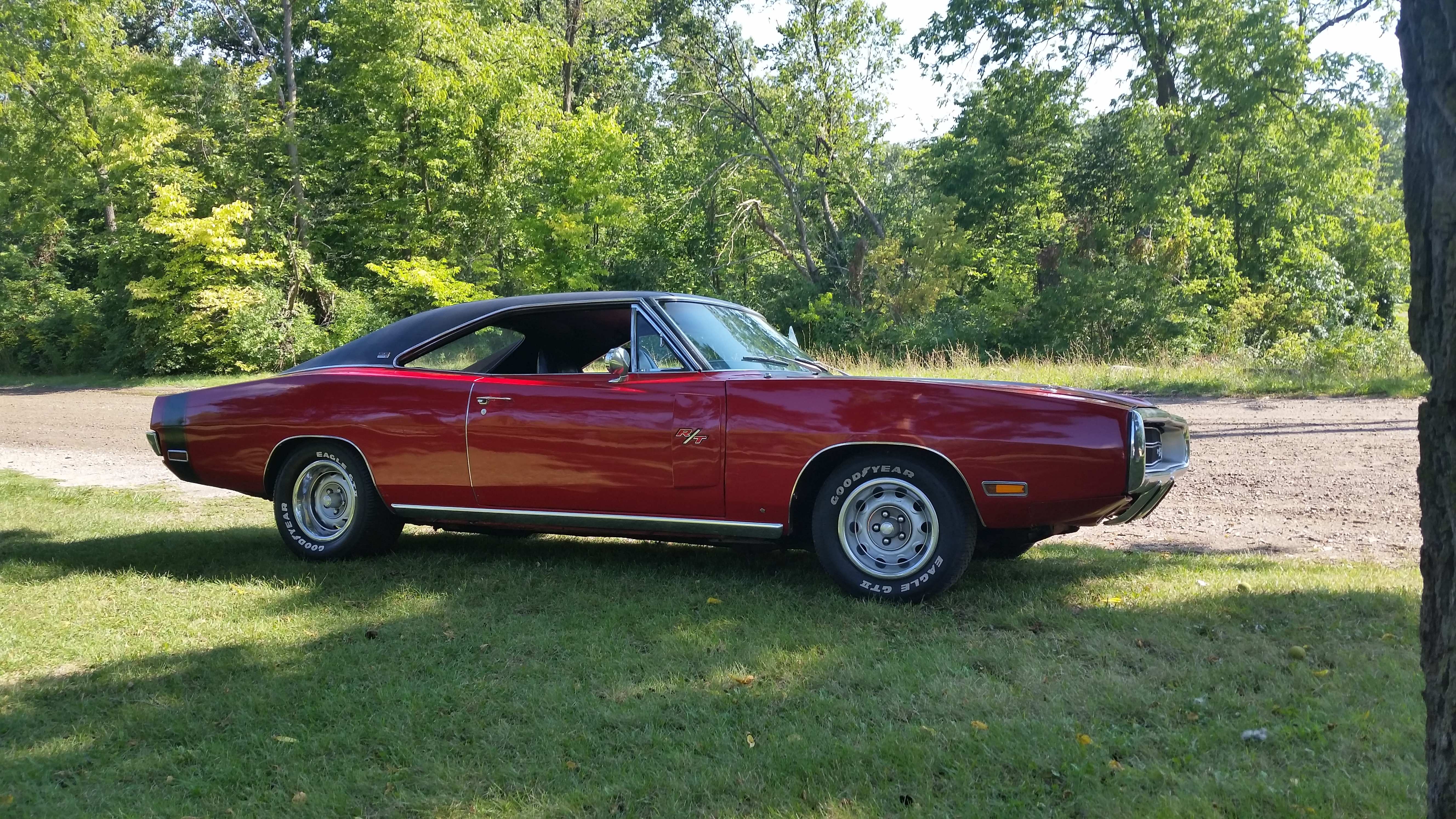

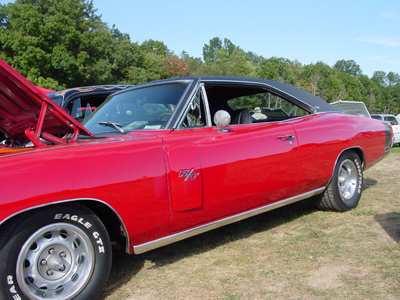

I ran 295/50/15's on the rear of my Challenger with 15x8 Rallye's with 4-1/2" b.s. before I mini tubbed my Challenger. These same wheels and tires are now on my Charger. Yes, these are a shorter tire but I didn't want the jacked up look.
Hello 6PHRTSE, I'm at the stage of needing tires and maybe rims for my car. I was wondering if the 295/50/15's rubbed the wheel well, leaf spring or anything at all when you were running them on your Challenger? Because the Charger looks great with those big meats under there.

No, no issues or rubbing on either car. In fact one of my buddies liked my combo so much we tried them on his 70 Cuda. No issues on his car, so he bought the same Rallye wheels and same size tires.

They are standard factory 7" trim rings. It does leave a gap. No has ever commented or criticized the look.
