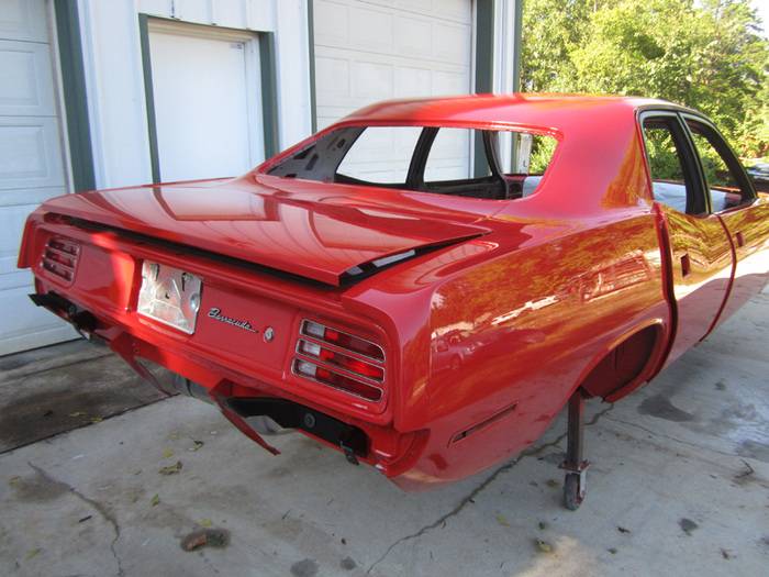

Now here is a "posterior" that sure looks nice! (lol)

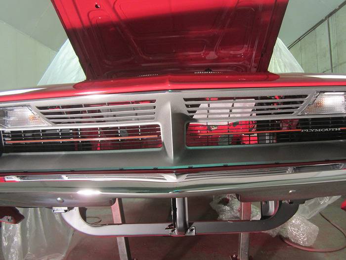

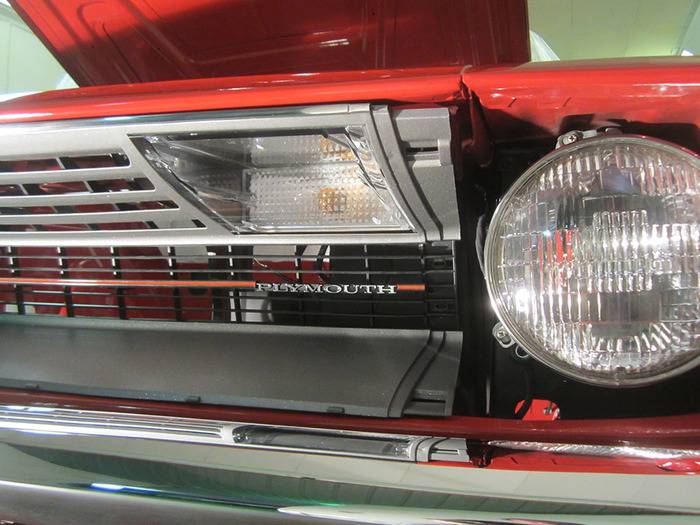

Thanks! The project has not been without its fair share of problems. We have discovered that using just about ANY reproduction part is a mistake. They just don't fit correctly or have an acceptable Factory look. For example, consider the reproduction stainless trim that surrounds the front Grille. It does not fit or look like the original examples. The areas that overlap are not as tight and firmly fitting as the Factory versions and they do not mesh together correctly. The areas that bend around the Head Lights are not crisp and sharply formed. They have a "bubbled" look to them. We removed the reproductions and are replacing them with Factory originals to obtain a proper look & fit.

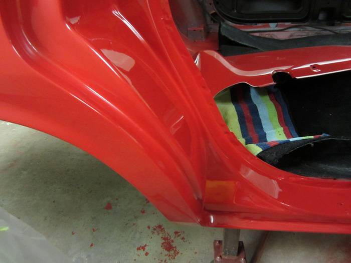

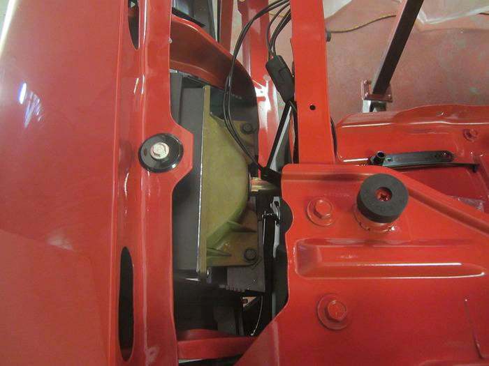

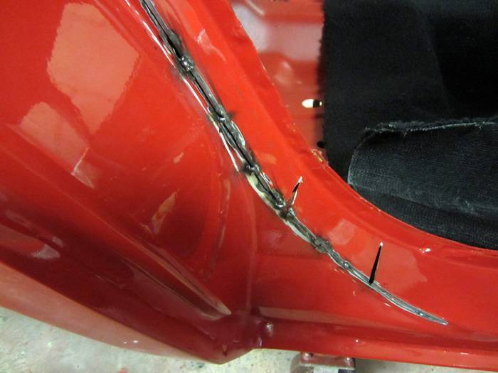

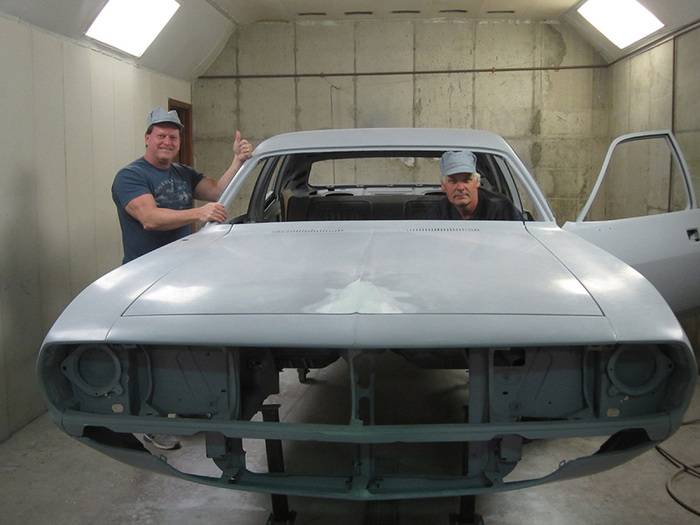

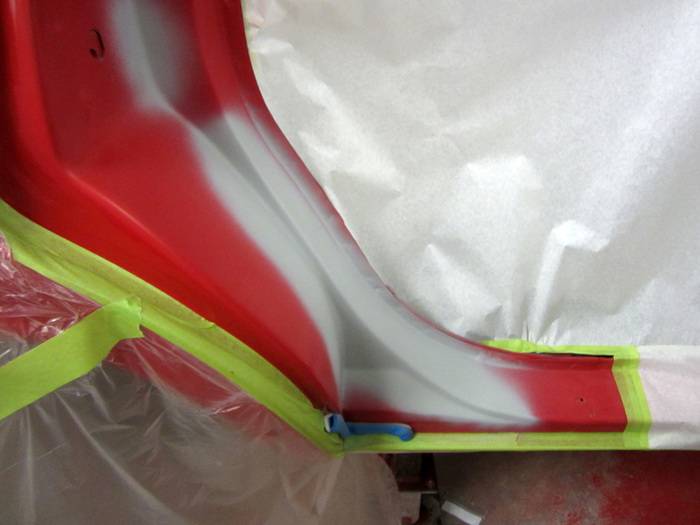

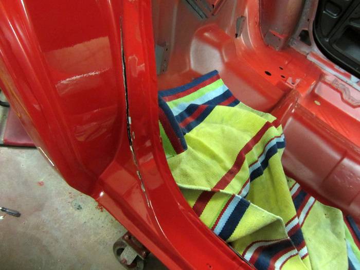

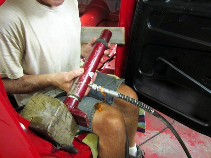

Here was the only problem we experienced with the Doors fitting correctly. After the Body was painted, we noticed that there was a 1/8" issue with the opening of the rear Passenger side Door frame. We had to cut the inner frame and use a Porta-Power to expand the opening. Steve is pictured here doing the adjustment necessary to make the Door fit properly. Also shown is the repaired section after it was completed. Steve blended the paint perfectly and you cannot tell a repair was ever done in that area.

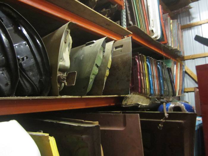

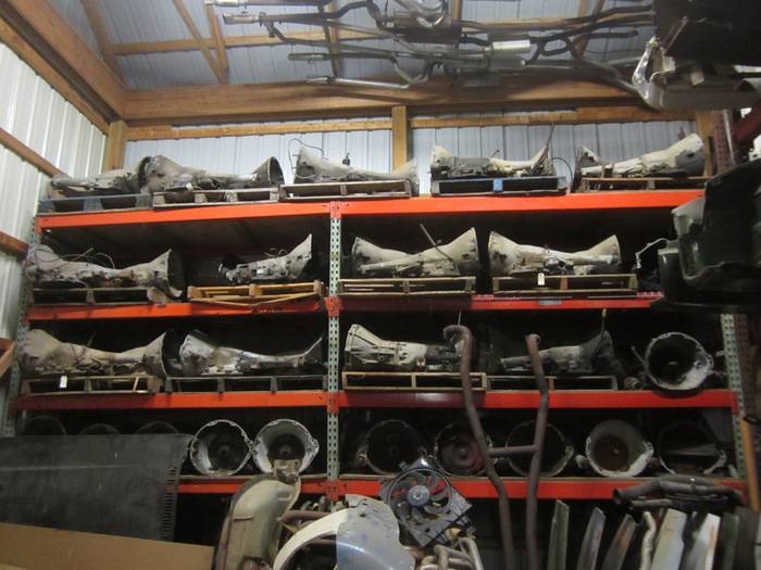

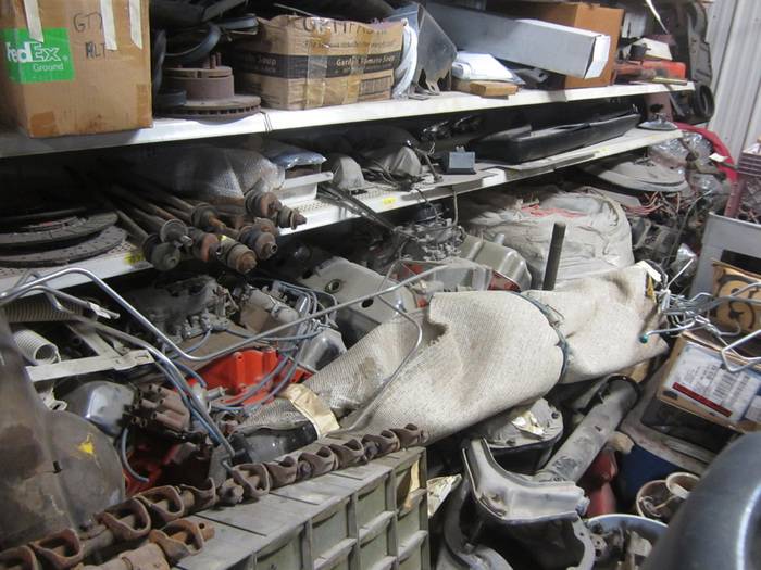

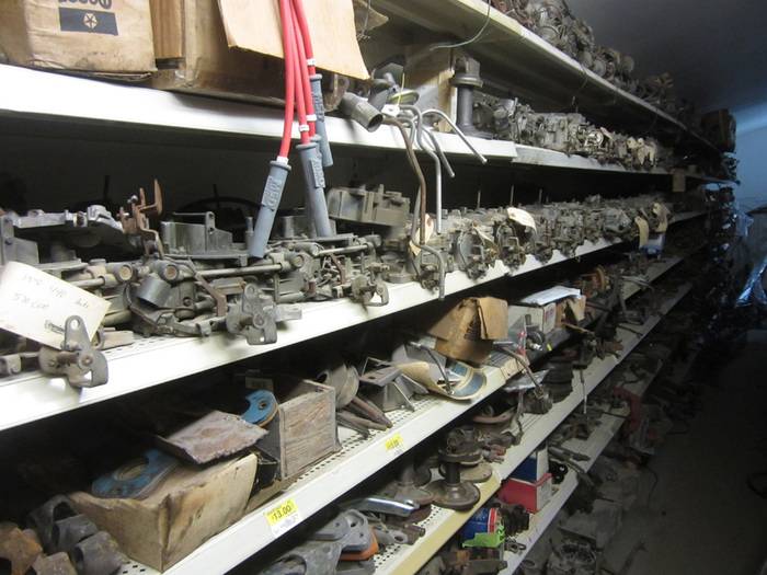

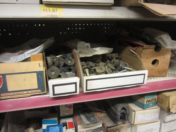

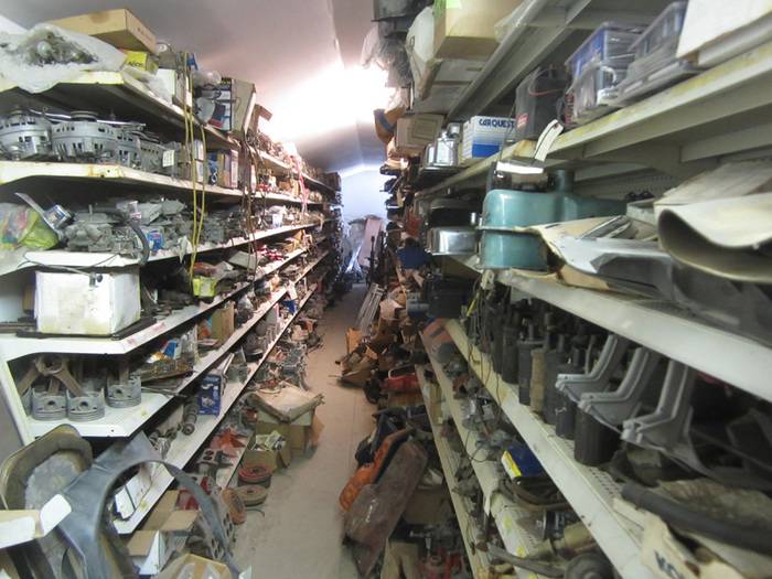

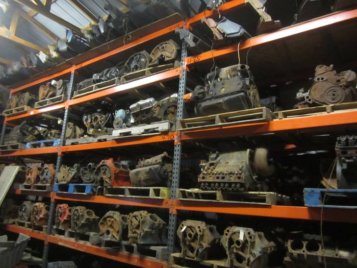

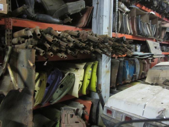

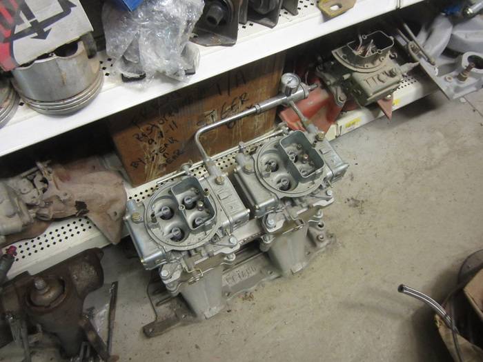

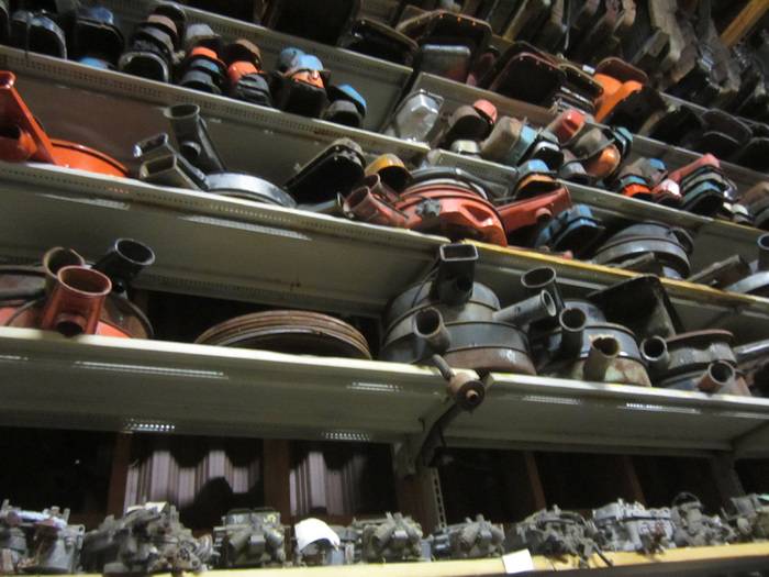

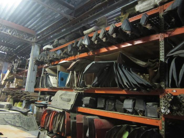

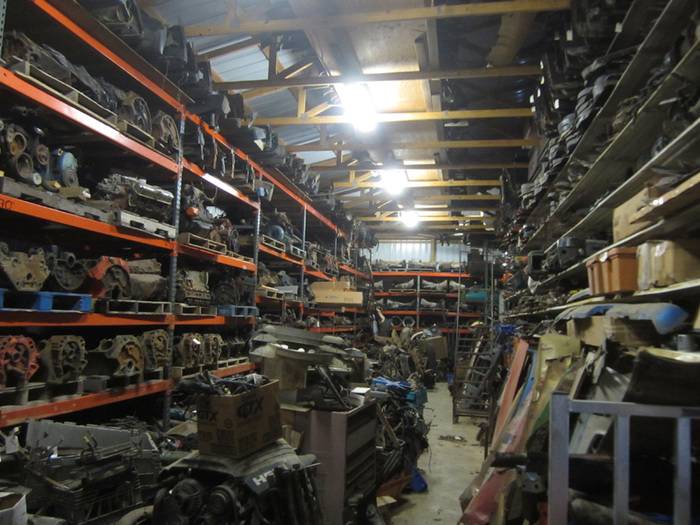

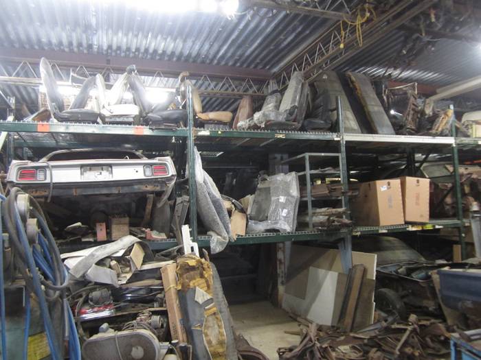

For the unique & hard to find original stuff, I have a Friend that has helped with my project parts for the past 12 years. This place is a Mopar Meca for ANYTHING that is rare and hard to find. I'm not talking about a few tidbits here and there, I'm talking about DOZENS & DOZENS of hard to find Chrysler parts. Row after row of Engines, Transmissions, complete HEMIS, Doors, Rear Ends, Glass, Fenders, Shaker & Rally Hoods, Trunks, Suspension Parts, Carburetors, Six Pack setups, etc...... Complete cars stacked and inventoried on shelves! You could spend a month trying to go through everything and not scratch the surface.. When I first went there a few years ago and saw NOS boxed Trunk Mats for just about every type of car, I knew it was a "special" place. (Sorry but I cannot disclose who or its whereabouts.) Below are a few photos from 4 buildings.

:angel8: I think I died and went to heaven ! Dave, I think you hit the jack pot of all places. That guy has a gold mine there. I'm sure every Mopar and car guy owner on the planet has to be jealous of him. I can't blame you for him wanting to remain un-named as I'm sure he would have people lined up from his door to the end of the state just wanting to get in there. Plus I'm sure his phone would be ringing off of the hook non stop. Words can't start to describe the awe I am in after just looking at those pics. I'm sure those pics just scratch the surface of what else he might have.

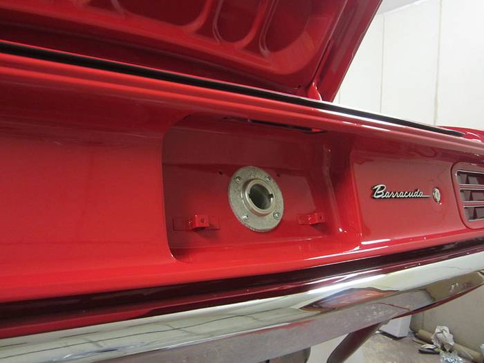

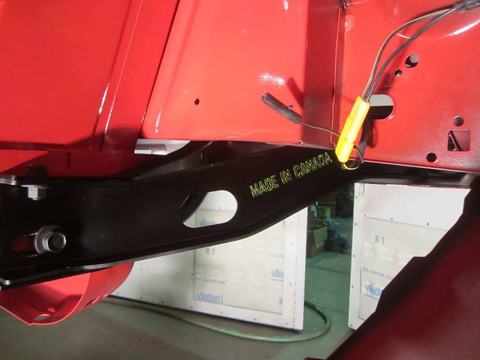

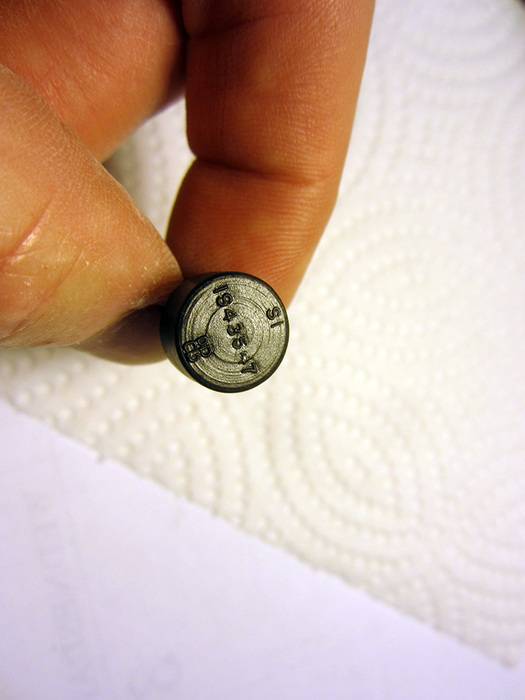

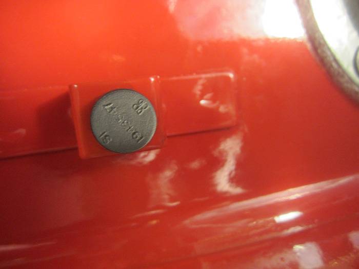

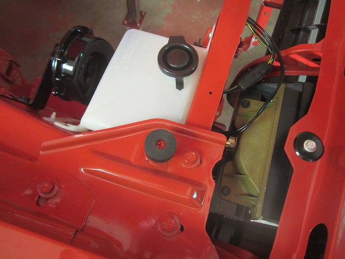

We decided to go overboard with the smallest of "correct" pieces. Here are pictures of the License Plate Bumpers and a few other build details. Notice the small numbers that are molded into the rubber. They are Factory original examples.
