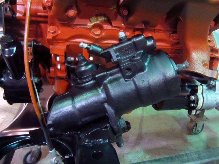

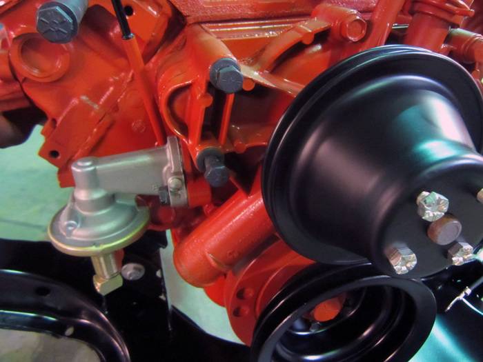

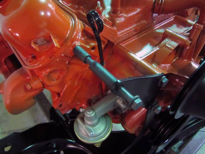

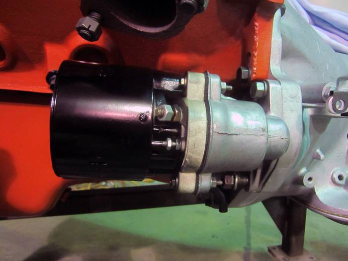

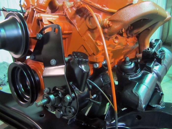

Here are a few photos showing the details of the Engine components. The entire assembly should be installed in the Car within the next week. After that, the Interior will follow and then the small details will complete the vehicle. Stay tuned........

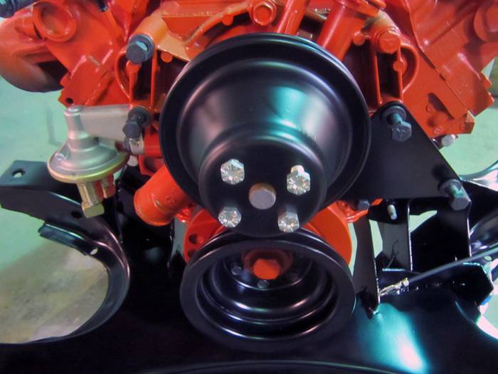

Here are a few additional pictures of the Engine with some of the attached accessories.

I concur with moparlee, those are great engine pictures with great detail
I have a long way before my 340 looks that good!

Dave, thanks for the great engine pics. I am using them as reference for my 71 340.
You're quite welcome. We have to change the Pulleys to make them correct for a 1970. We thought that a nice set from 1973 would work but they are different in design. I want to let everyone know that we are NOT attempting a true OE car as an objective here. While the appearance and processes are correct with what we are doing, some of our parts may not be correctly dated for the time frame of the car. We used an imaginary build date of 7/30/1969.
I want every component to be as new as possible so unlike my other OE projects, I will not be incorporating "used" components for things like the Suspension. The Lower Ball Joints (for example) are NOS Chrysler units that are dated for a late 70 or 71 vehicle. The fit and function are are correct but the date is not. No one would ever know unless they were specifically looking for the correct dates on the parts but I wanted to make you aware of this. For those items that we are able to find that a correct date, we use it when it's NOS. Thanks for your comment!

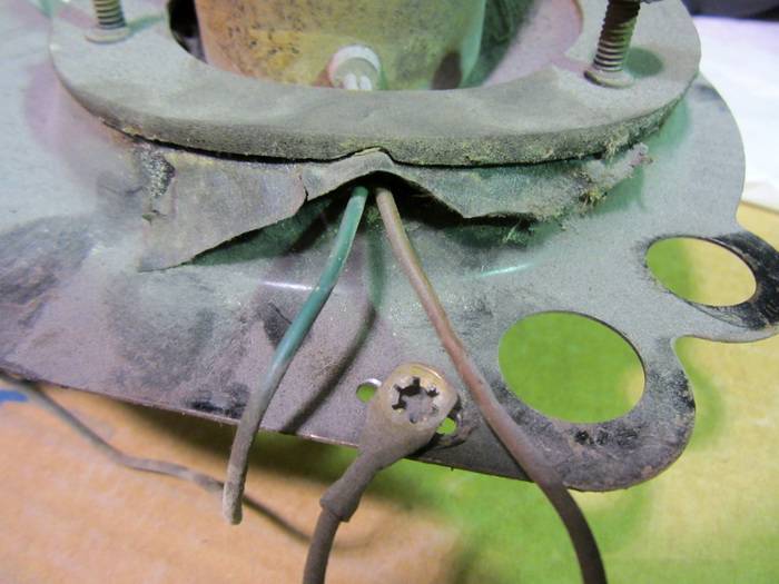

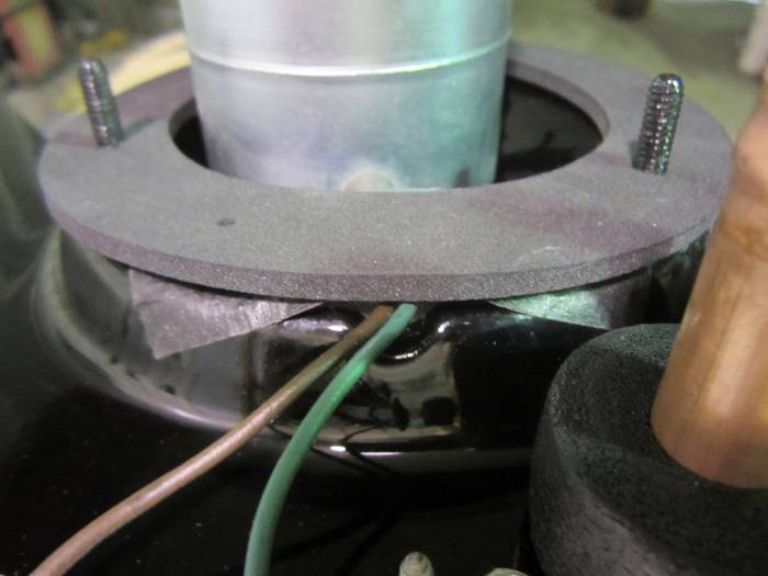

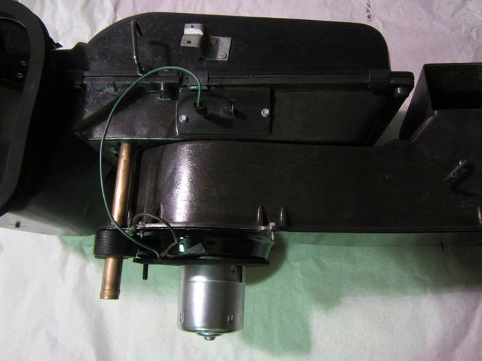

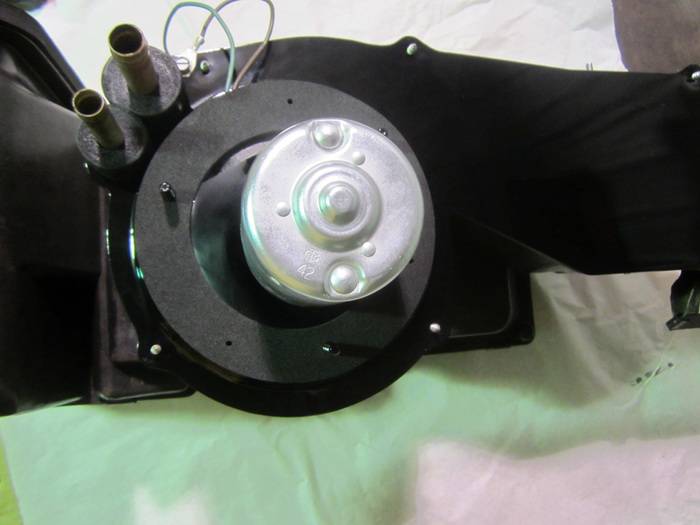

Here are a few pictures of the Heater Box. I took pictures of an old unit to show the comparison of how they originally came. The old UN-restored unit in the first picture is NOT the unit in the following photos. It was just used to show some of the details of the Motor Assembly Wiring and Insulation.

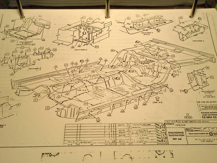

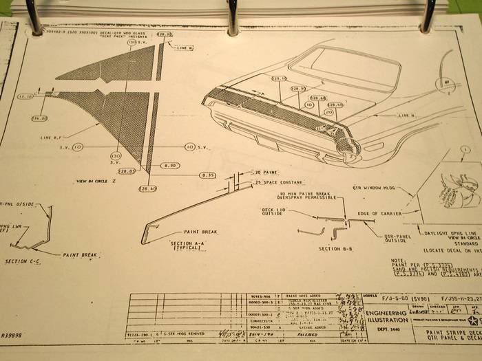

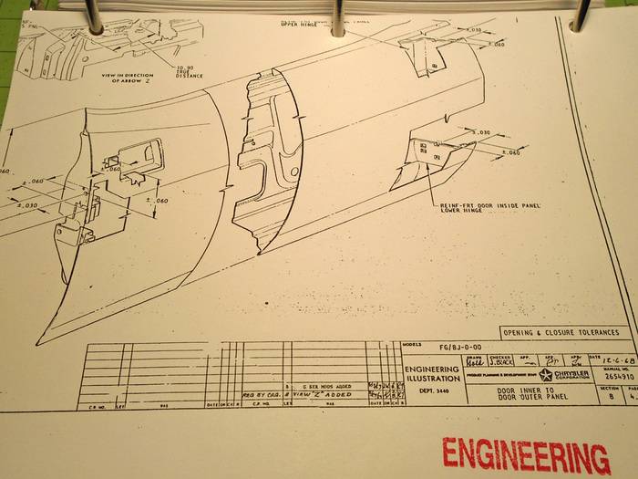

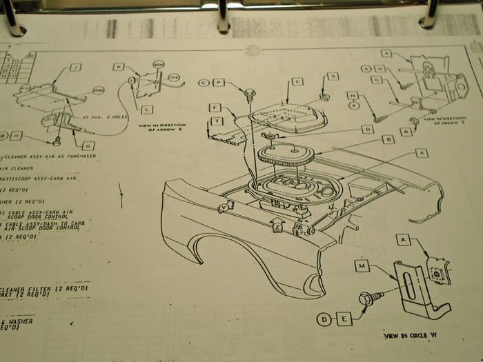

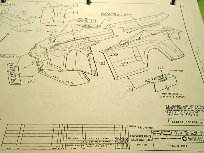

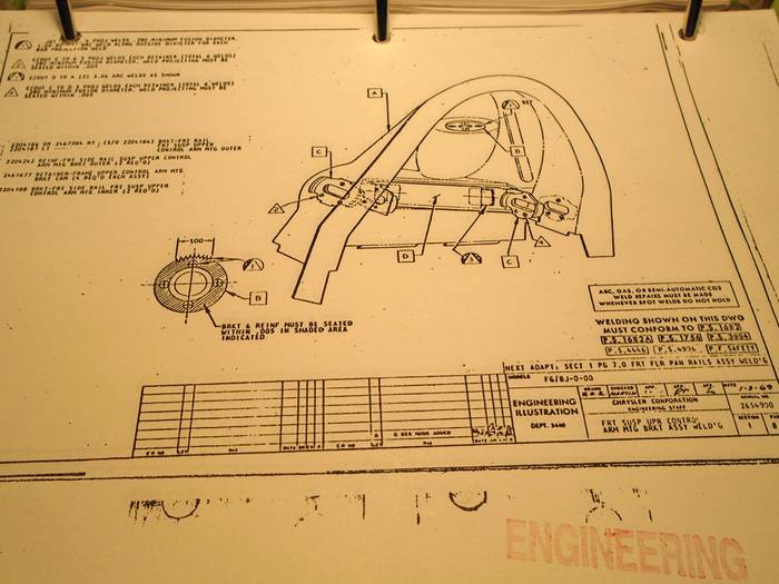

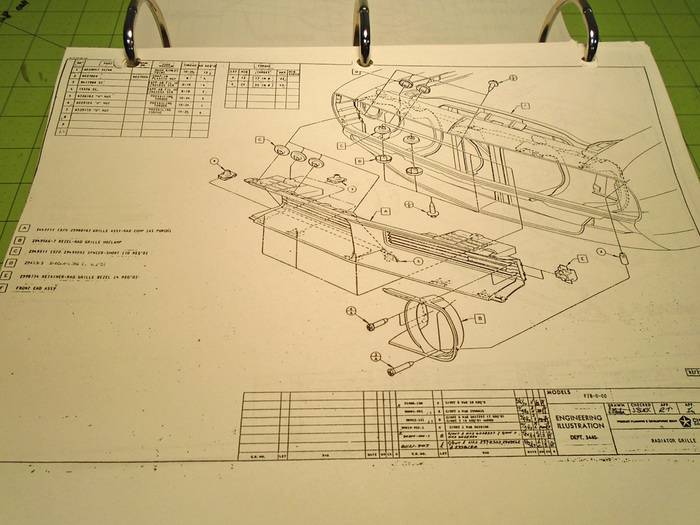

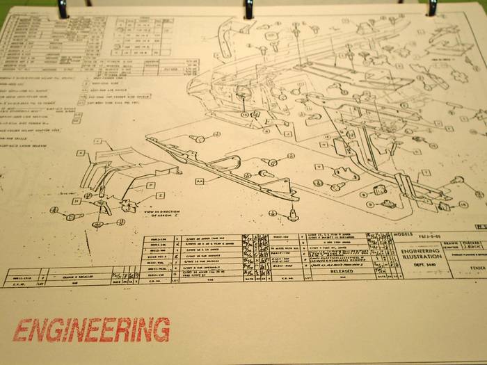

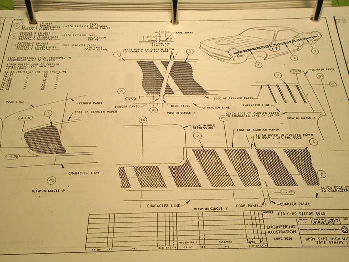

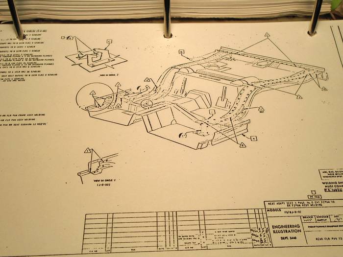

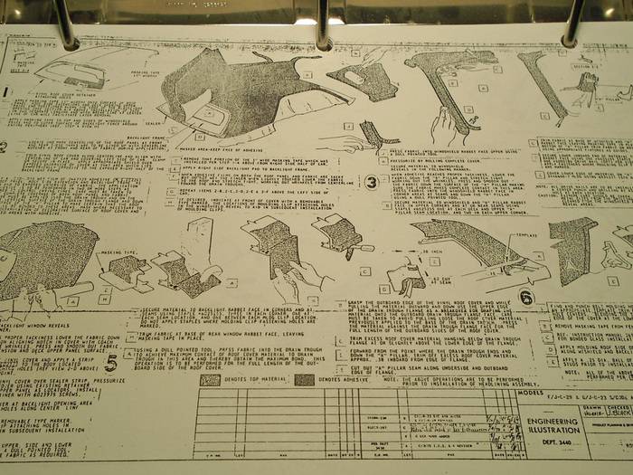

Here are a few random build specifications I took some pictures of. I have used this source as a guideline for many aspects of my project(s). It covers things like the exact number of Welds on a particular Body Panel, correct Stripe placement, Brazing & Soldering specs, Sealer specs, Tolerance configurations, specs for installing a Convertible or Vinyl Tops, etc......

Especially like the engineering specs showing the floor pan/trunk pan welds.
Interesting how it shows both the Cuda and Challenger gas tank filler hole openings.
Awesome really helps restorers will you be releasing a set of build drawings
