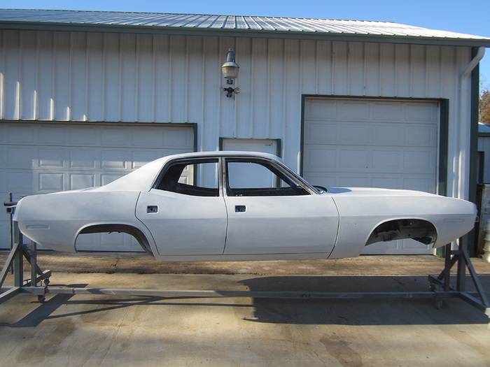

Pictures of the front and rear really don't show how many doors it could have. A side view would nail it.

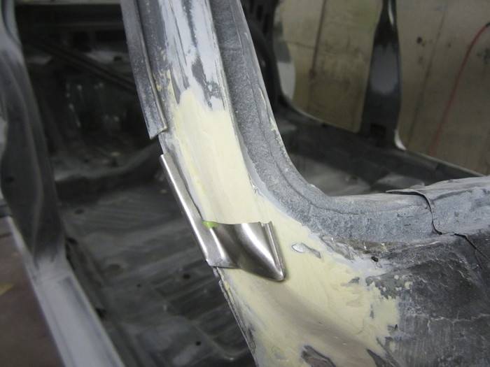

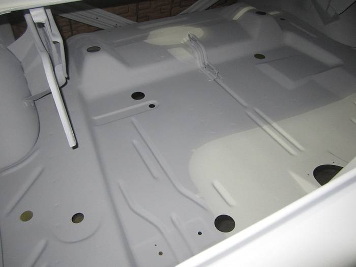

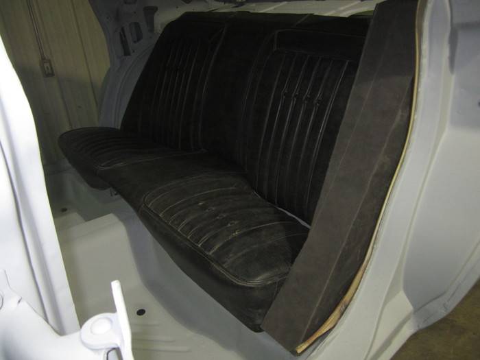

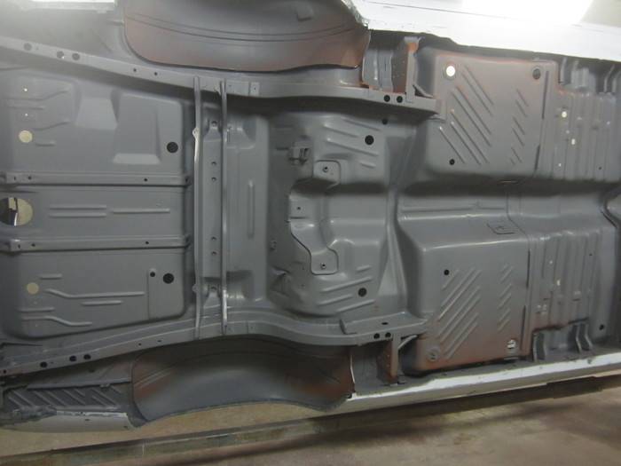

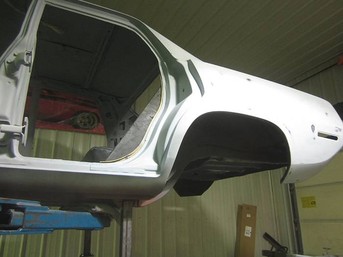

Here are a few pictures of the first primer stages of the underside and the "custom" Interior pads we are making to fill the voids next to the rear seats. I had dense foam glued together that will be shaped to fill those bare pockets of space. Ignore how it sticks out in the picture below. We are in the very early stages of sculpting their correct shapes. Once the back side is shaped to fit the rear Fender, the front side of the Pad will be shaped to run along the side edge of the Rear Seat. They will be covered with the same vinyl material that matches the rest of the Interior. One of the pictures also shows the custom A Pillar ending that had to be formed for the Vinyl Top Trim.
I have a ton of updates and will post them as the photos are processed. We will also have a blog (coming next week) for those who want to see the work on a daily basis. Stay tuned!

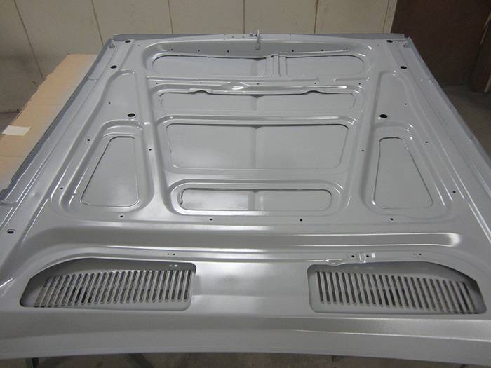

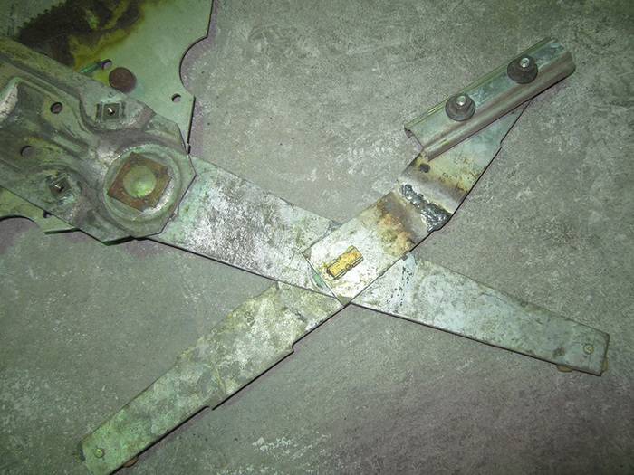

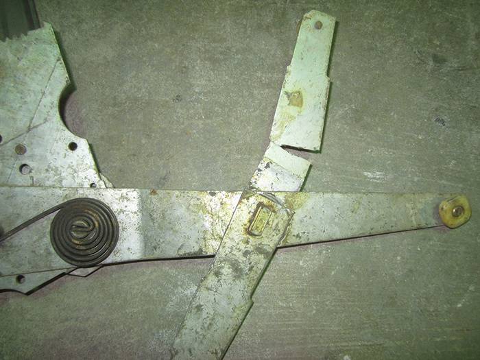

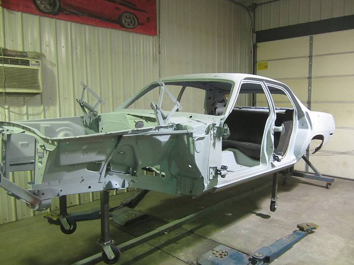

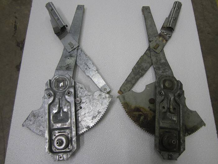

Here are additional pictures showing various things that had to be altered in building this car. All of the Window/Door Mechanisms had to be cut, reconfigured and re-welded to work properly within the new Door configurations. (I included a "BEFORE & AFTER" photo one particular example.) The car was then completely disassembled and reworked to make sure that all of the Body Panels were as perfect as could be. This included the front, sides, back and every area that will never be seen once the Car is assembled for the final time.

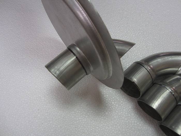

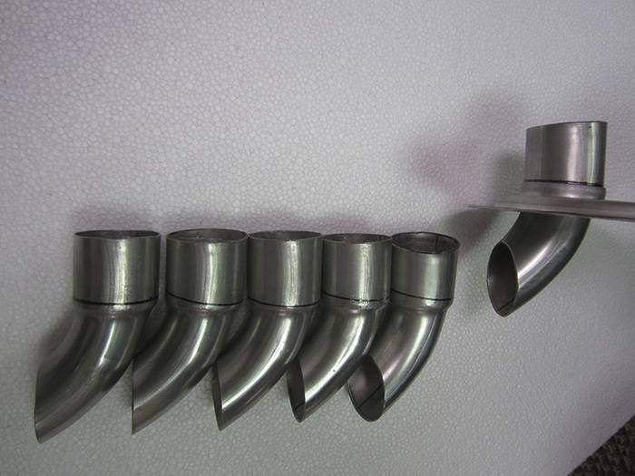

I also had Factory Exact California "Turn Down" Mufflers made for the car at a pretty hefty cost. (Pictures of the first few prototype End Caps are pictured below.) The plus side of having this done is that I am manufacturing enough units to offer them to the Chrysler Restoration Market. This style of Muffler will be one of the "new" products that is a direct result from the building of this Concept vehicle. Here are some random photos showing some of these aspects & features.

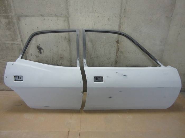

Looks like 71 -up B-body door hinges. Did you use B-body door frames ?
If you go back to the first 2 pages of the thread, most of that information was covered in greater detail. The Doors are "B Body" frames that had to be cut apart and re-shaped to work with the E Body outer skins.

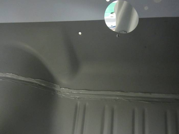

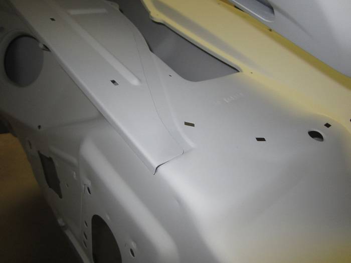

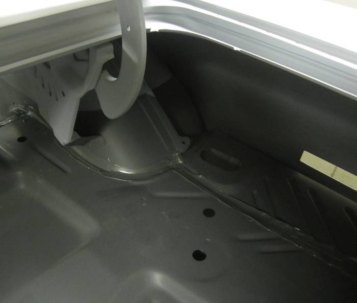

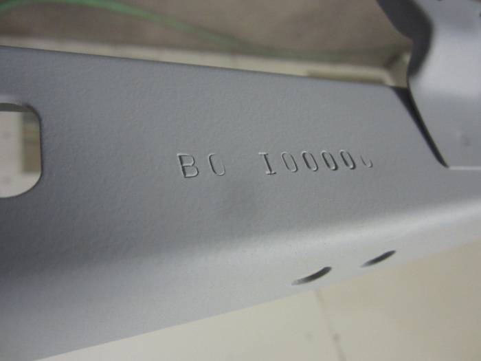

Below are a few photos showing where Steve put the Body VIN stampings and the dip process of the priming/Seam Sealing. Even thought this car was never actually manufactured, we are building it with all of the Factory nuances and details that you would expect to find on a Assembly Line vehicle.

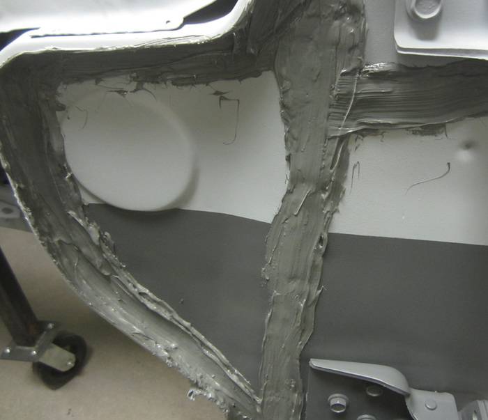

Boy, you sure didn't skimp on the seam sealer. Wow.
That "ugly" look was exactly the amount that we have documented on other vehicles. We could have easily made it look nicer and smoother but that would have not mimicked the Factory appearance that we were trying to match. They did the Seam Sealing step fairly quickly on the Assembly Line and it wasn't very pretty! (lol)

I am with Leo on the seam sealer. Wow. I guess when all is painted and same color it will minimize the visual stand off appearance.
