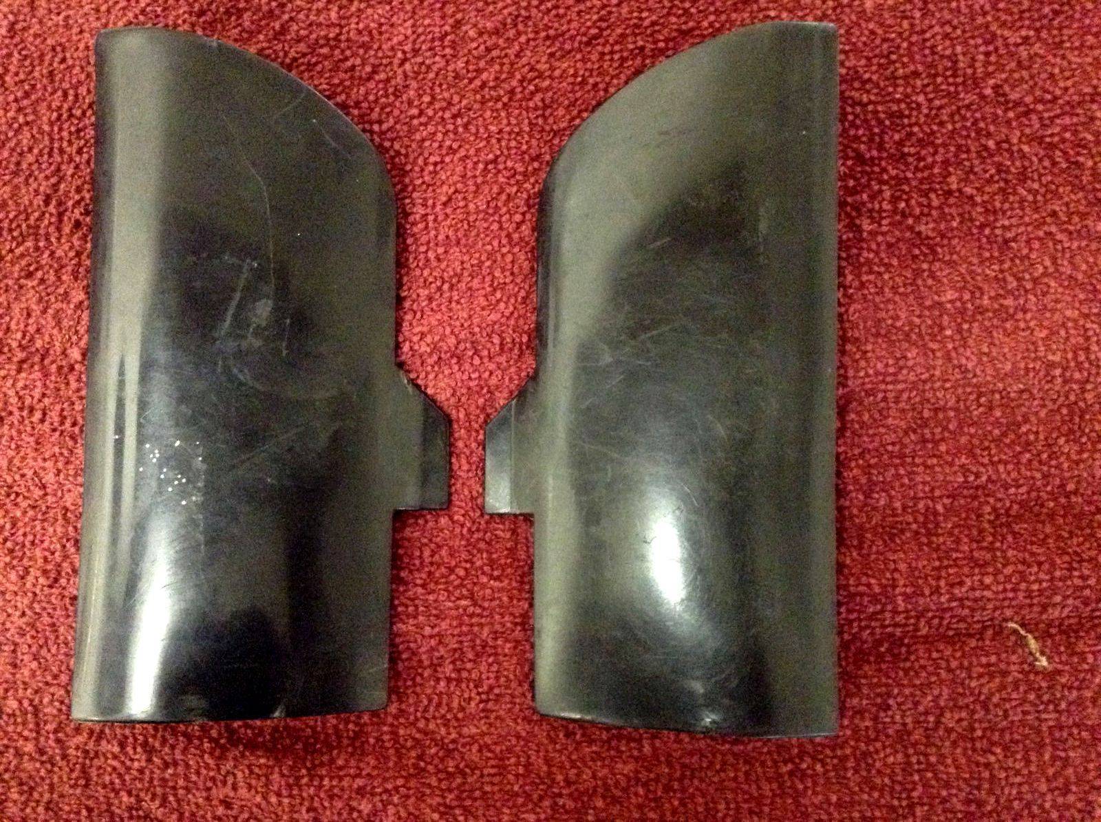

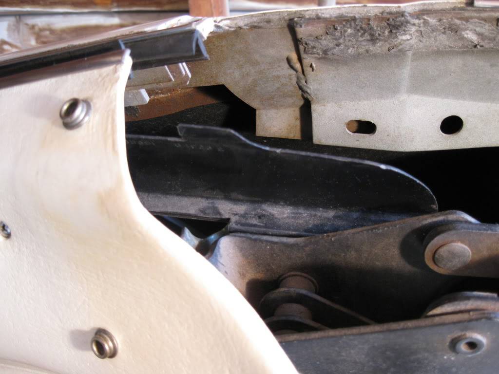

I was totally wrong on where this part goes. (I found mine wedged at the bottom of the quarter and upside down) It apparently fell off and down into the quarter a long time ago!
Further research found on a sister mopar site:
"They are black plastic and clip on the metal structure on the inside of the 1/4 windows. They are just ahead of the top frame in front of the 1/4 glass."
I also had the part upside down, the u shaped channel is on the metal frame and deflects water.
Always something new to learn!

You must not have seen the link from Norwayduster...
Sorry, did not seem to have his link?
Oddly, I found the left side unit in the same place; wedged in against the bottom quarter panel wall like they were placed there?
Even if they fell down in there, they were wedged in tightly and pushed down/deep.
2nd had a clean part #3505350 w the rt side 351
A pair just sold on ebay this month for 150. Ouch
Always good to learn something new!
Thanks to all.

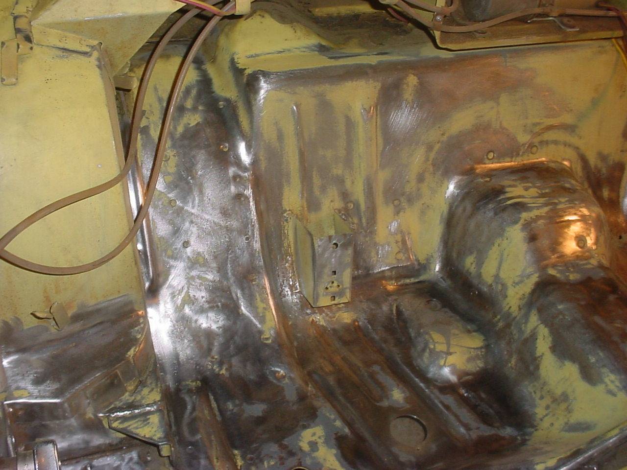

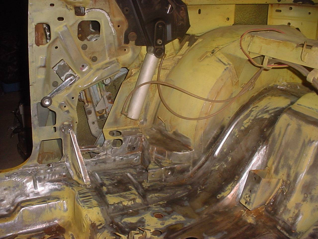

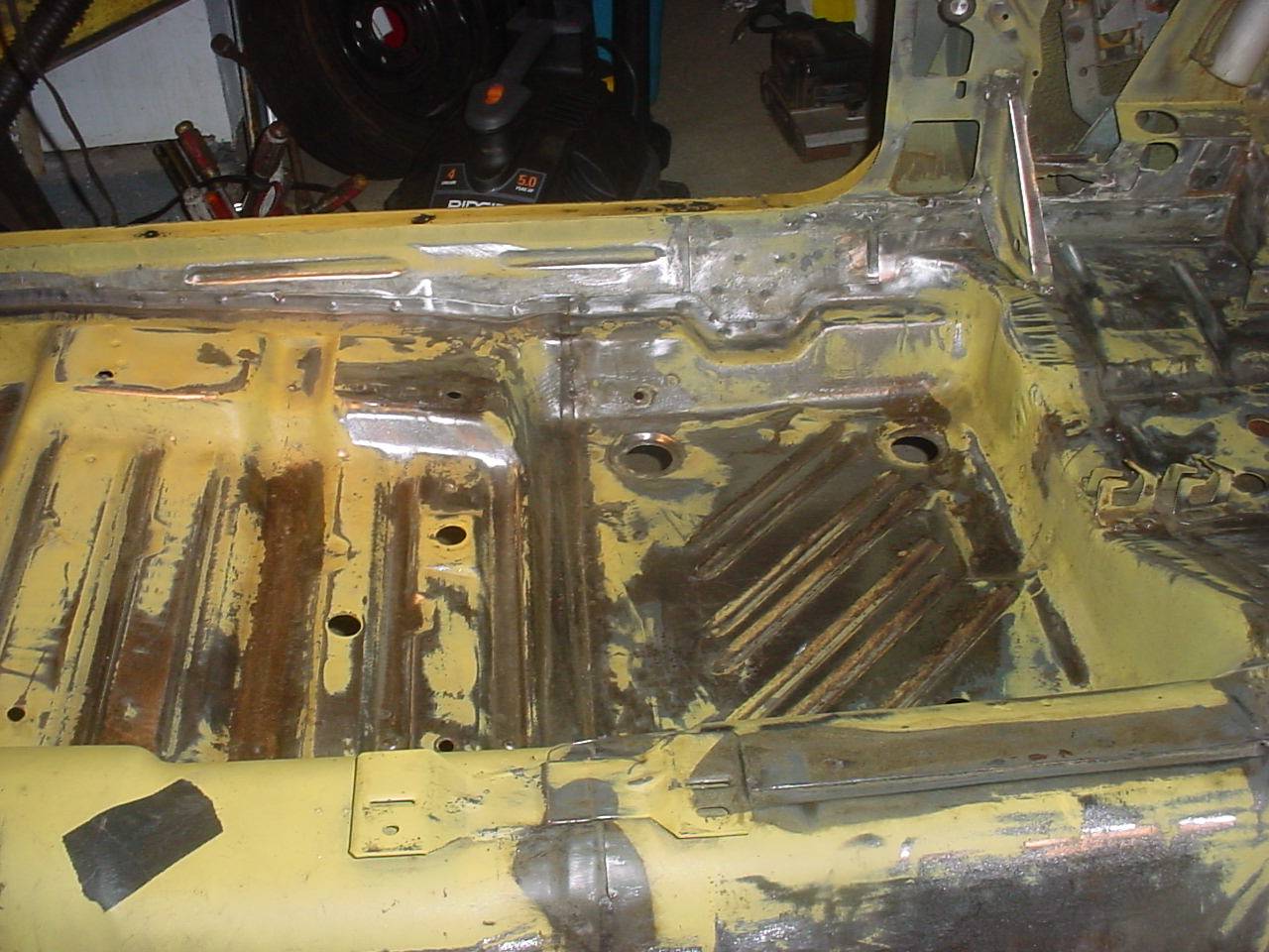

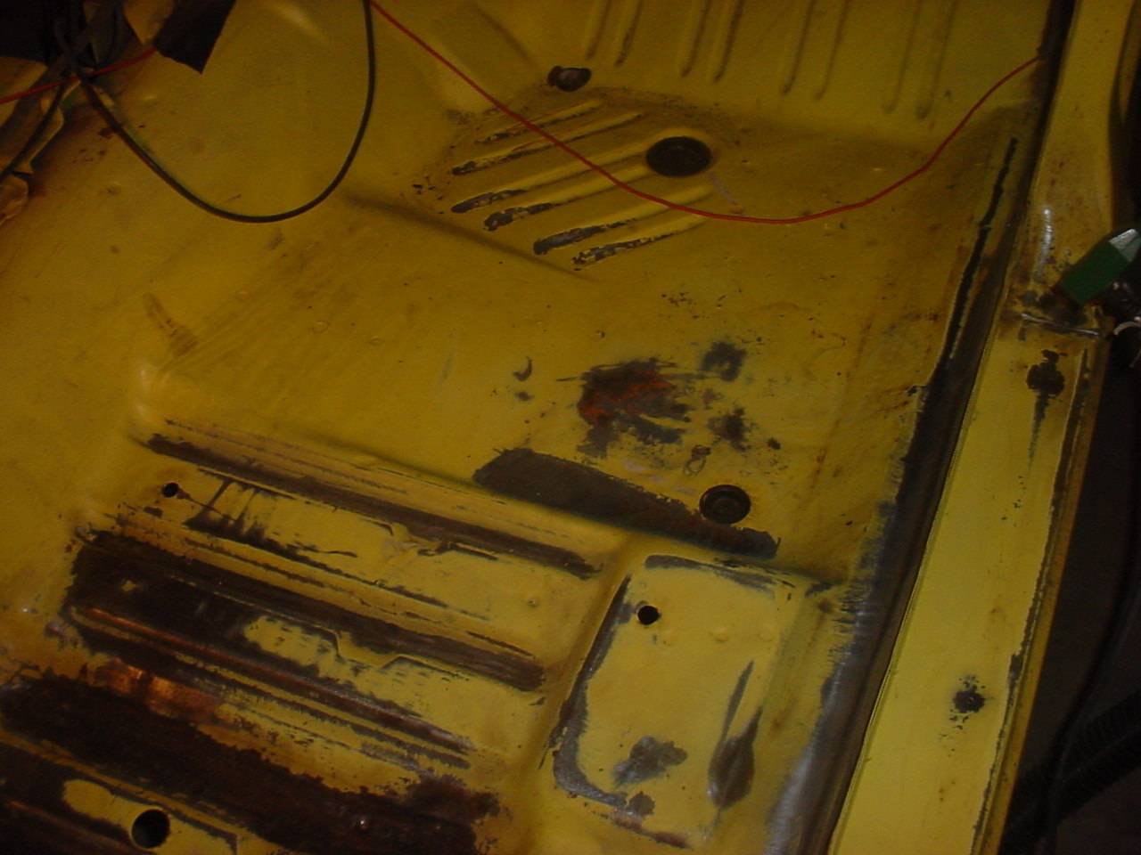

Interior Floor Metal Clean-up
Using a combination of a belt sander, DA, Wire brushes in a drill and hand sanding.
80 100 and 120 Grit
bottom of first photo showing inside bottom of quarter is where I removed all of the "white" sealer.
Lots of labor but happy with the results!
