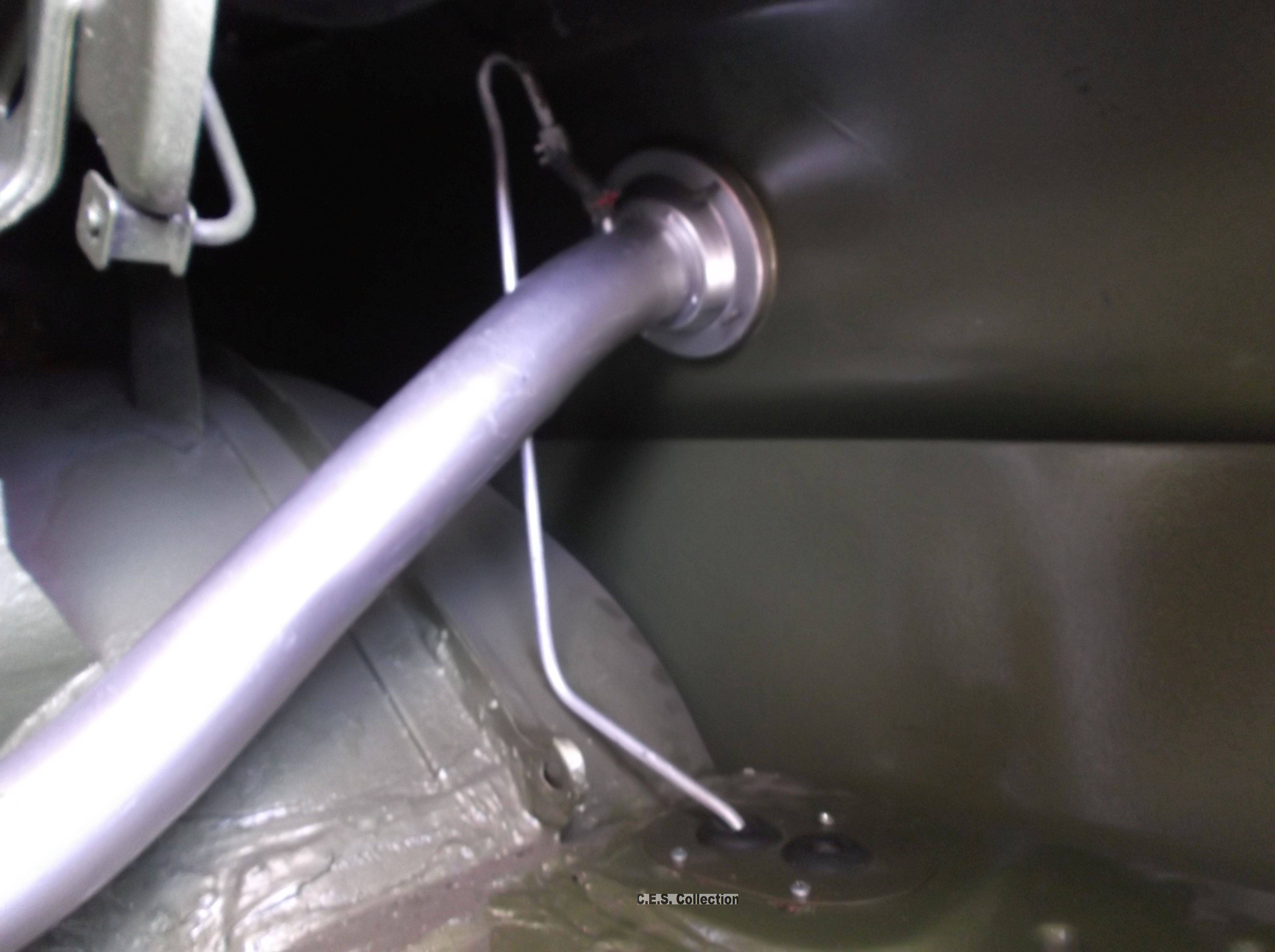

The vent tube is on the filler neck , it ges through the trunk floor & vents into the frame rail .

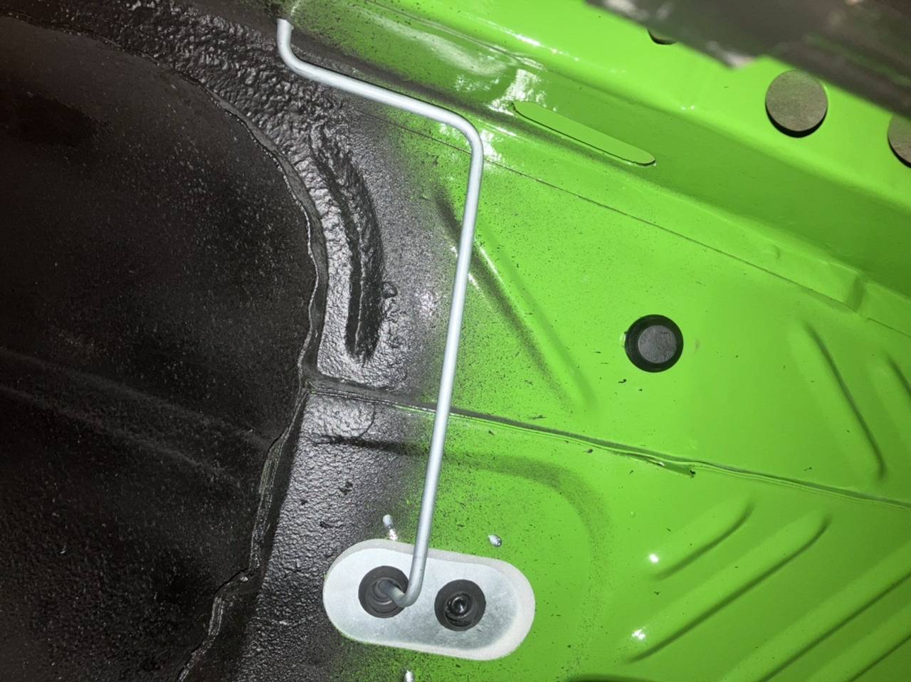

August 1969 Build....70 Challenger fuel vent

The vent line runs into the frame rail on the underside.

No, but the repro tube fits well and I don’t think vibration will be a problem(car isn’t done yet)
