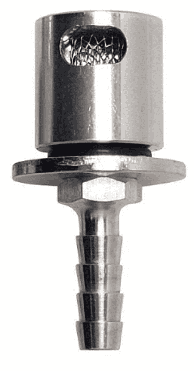

Usually when the tank isn't vented correctly the hard part is getting fuel into the tank. Weird that it would come out of a vent that's higher than the tank. The vent valve you're referring to is actually a roll over valve that's designed to vent the tank unless the car goes on it's top in which case it closes. Sounds like you're on the right path with what you've done, but maybe check these links from Tanks out. I've had good luck with their roll over valves.
Fuel Tank Venting
Remote Mount Rollover Vent Valve

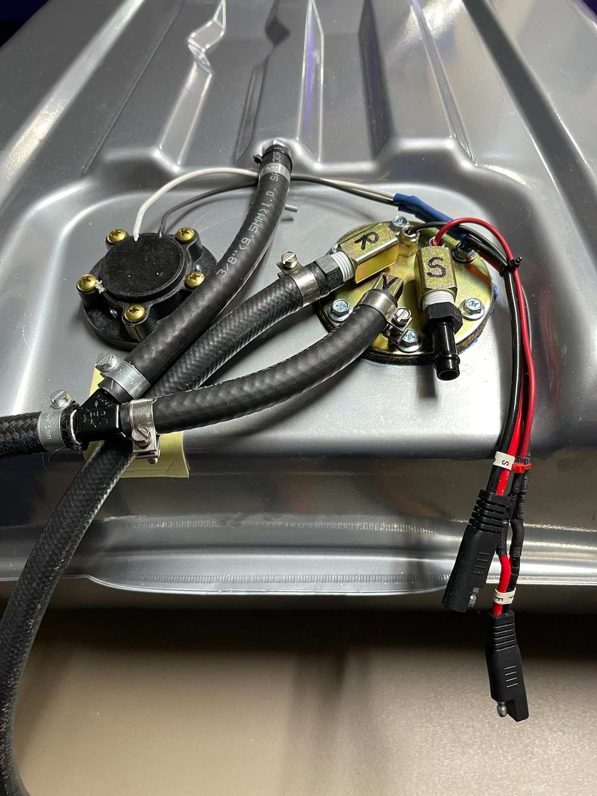

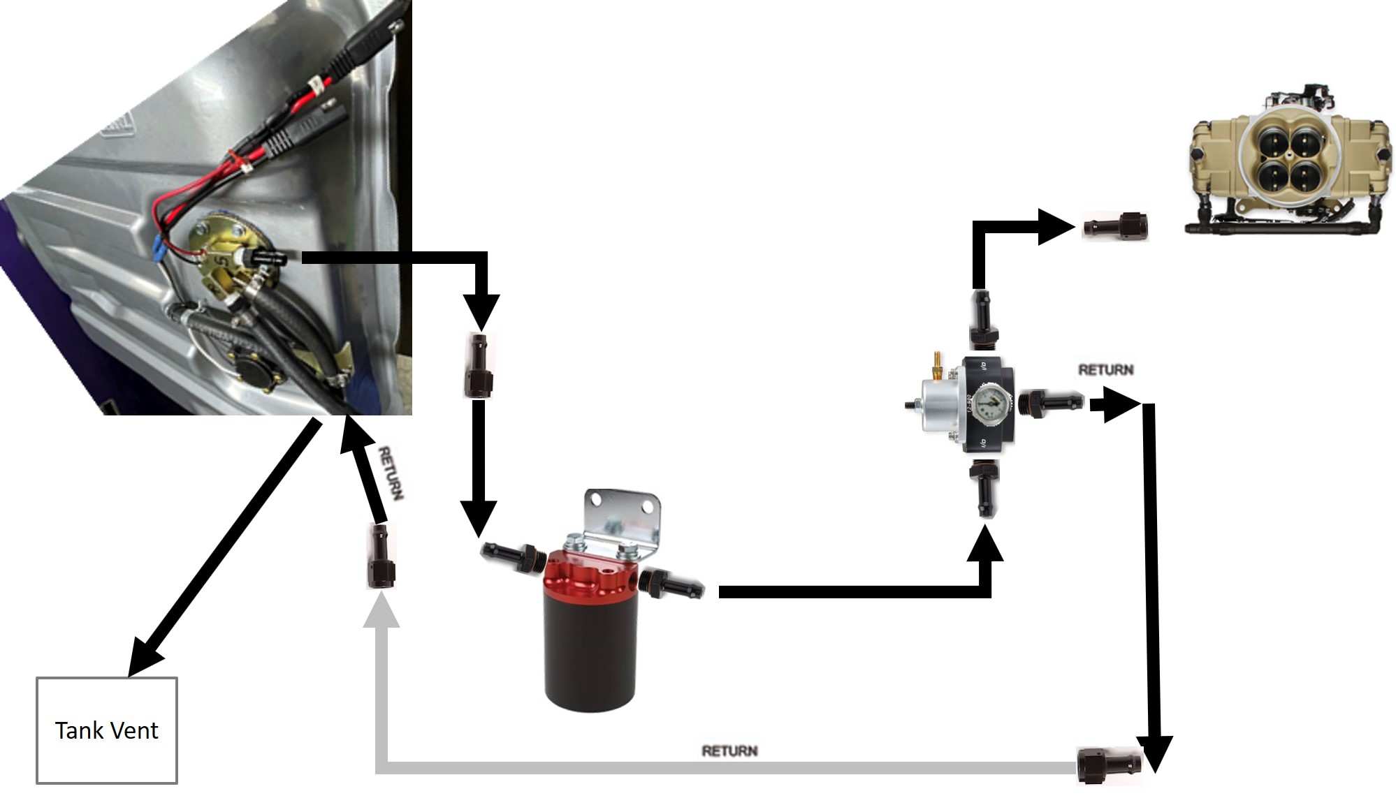

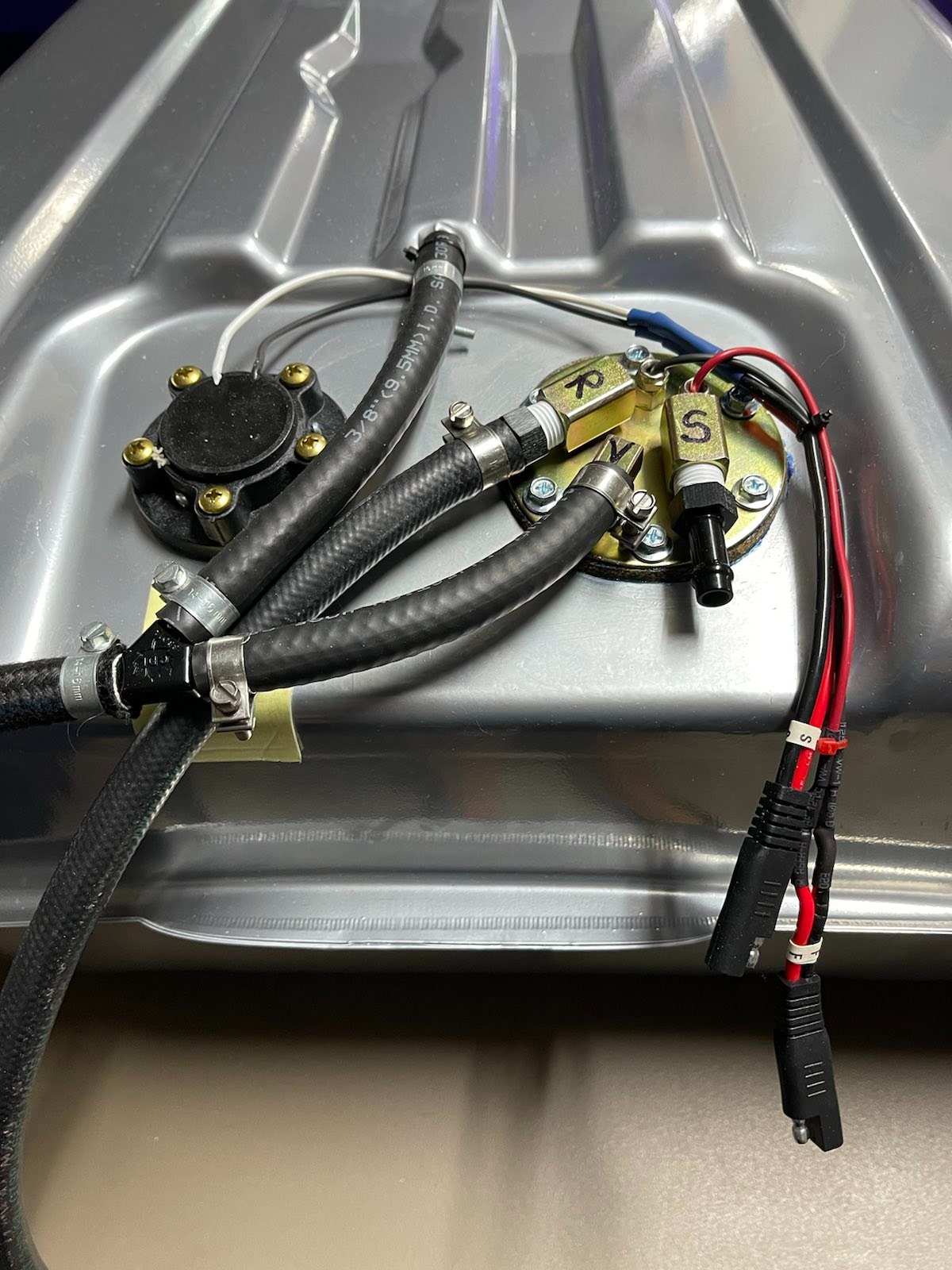

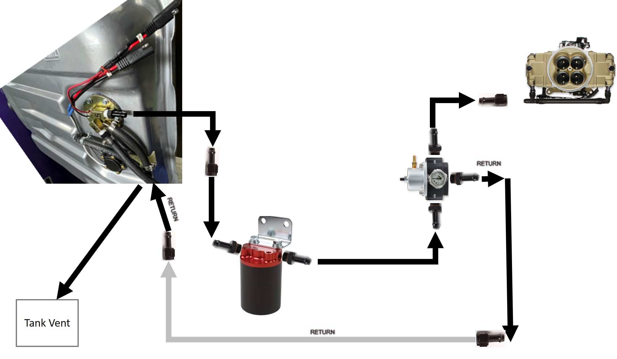

Please post some pictures of what you have for a vent line. The Holley EFI tank is sourced from Tanks, Inc.
There are two vents involved with these tanks. One on the tank and one on the fuel pump. Both of these vents can be tied together and then routed above the fuel tank to the factory fuel vent tubing.
This is what the top of my tank looks like before installation. R is the return line, V is the vent (combined with the tank vent line), and S is the supply to the external fuel filter and on to the fuel regulator and Stealth throttle body.

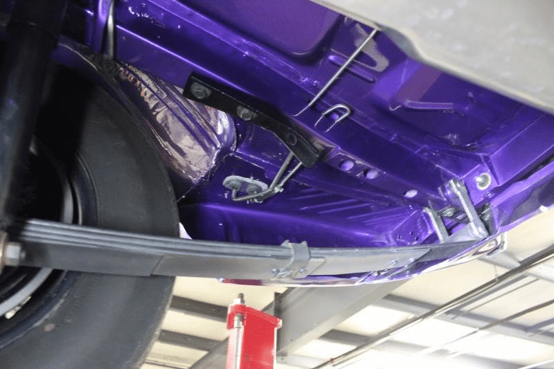

On the ‘cuda there is an in trunk fuel vent thing that mounts through the floor pan that puts the fuel vent way up above the tank. Does the challenger have this also? Maybe the vent needs to be even higher than where you have it mounted.
Maybe the fuel is possibly filling up high enough into the fuel neck, the the handle not cutting off soon enough, vent not high enough to accommodate this, and spilling fuel out the vent.
Also when the fuel spills out of the vent is the tank full?
MoparCarGuy
Jun 28, 2020
941
849
The fuel vent setup should look like this and puts the vent line way above the tank and trunk floor pan.
View attachment 116494 View attachment 116495
The venting problem is solved using this method in the photo. Holley was slow to respond but they finally did. The lady at "Tanks Inc" told me that there should have been a Y barb fitting (like in the photo) included in the hardware package of the Sniper system. She said this was so the vent lines could be consolidated into one. I asked why two vents? She said they added the vent tube on the tank because of previous problems with venting. Anyway, I am now hooked on to one line into the filler neck. Thank you all.
