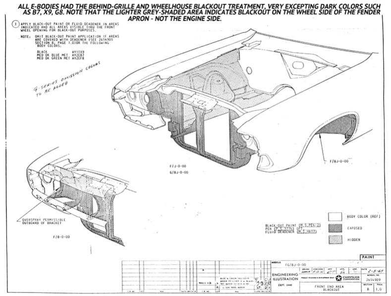

The only thing under the hood that should be painted black on a non-dark painted car is the top of the cowl and front of the radiator!

DetMatt1, you could be right. My 70 Challenger's cowl is definately black. My 71 Barracuda's cowl was FJ6, but there doesn't seem to be two shades of black now. In fact the black paint rubs off pretty easy and I don't think factory paint would do that.

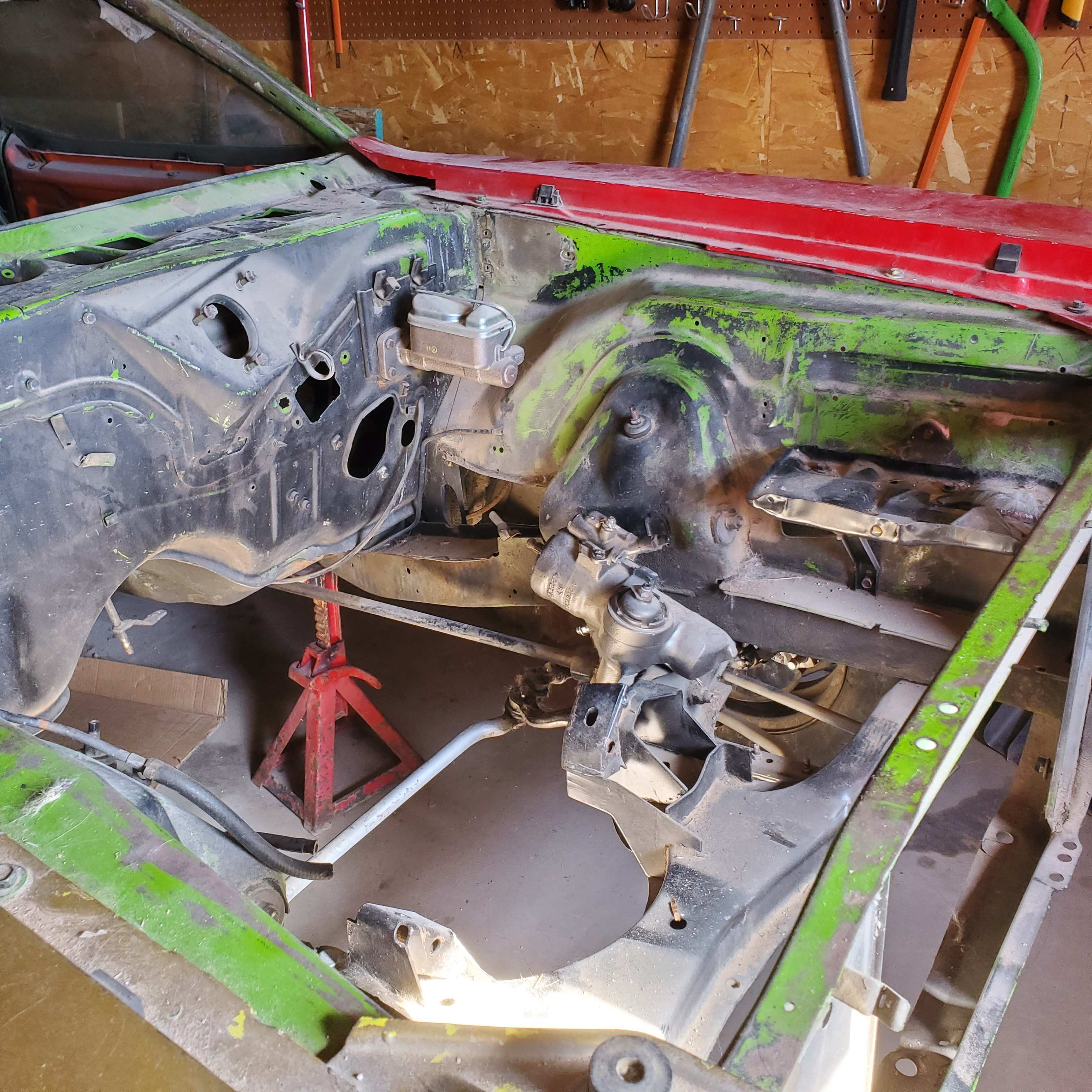

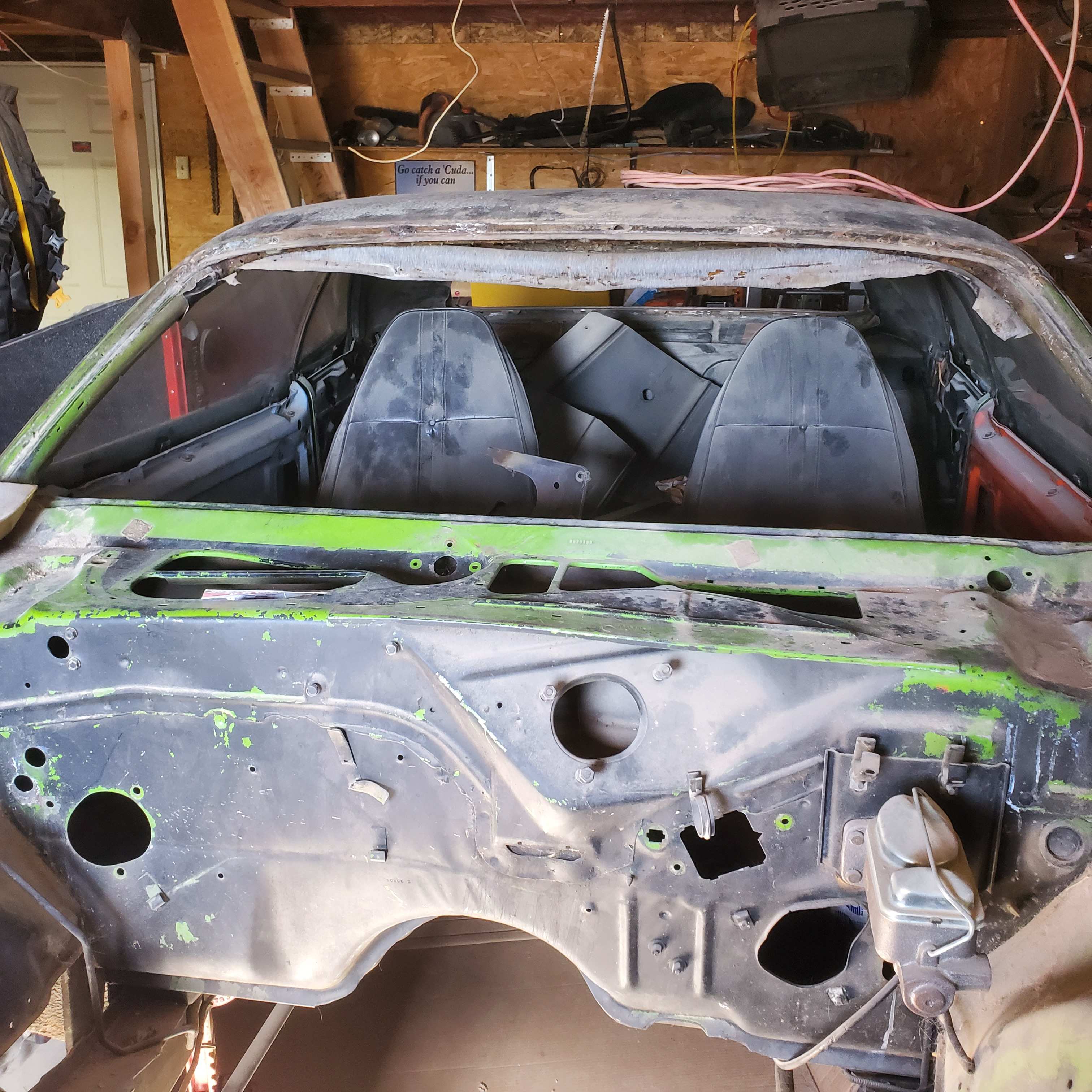

I did exactly that 23 or so years ago when I pulled the 318 out and put the 440 in. I knew eventually the car would be painted a different color but didn't know what, and wanted it to be clean under the hood so I prepped and sprayed it all in semi gloss black. 20 years later I finally decided on a body color and didn't pull the engine to respray under the hood. Probably should have but... *shrug*
I like to freak out the purists. 😁
