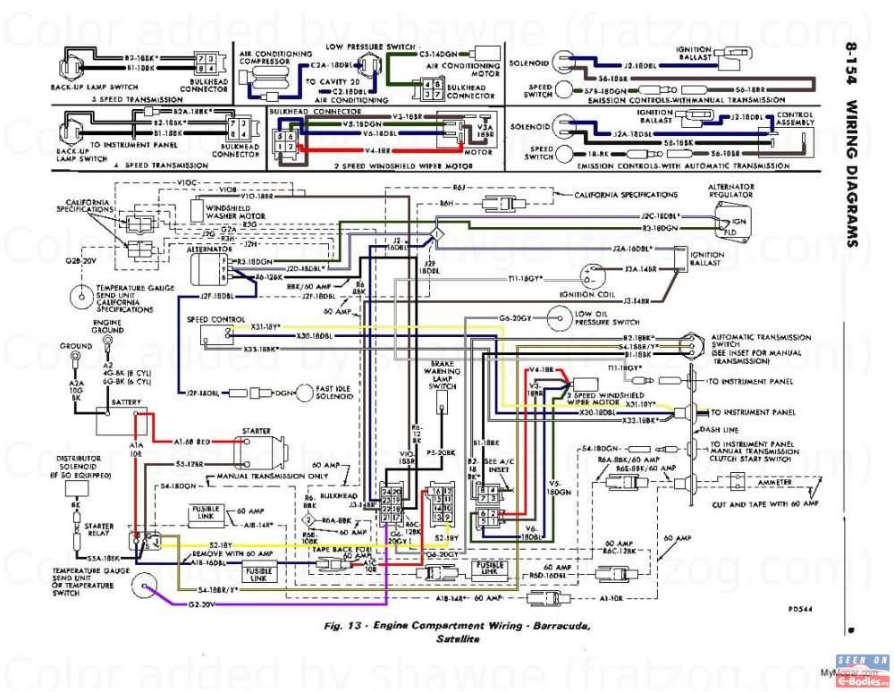

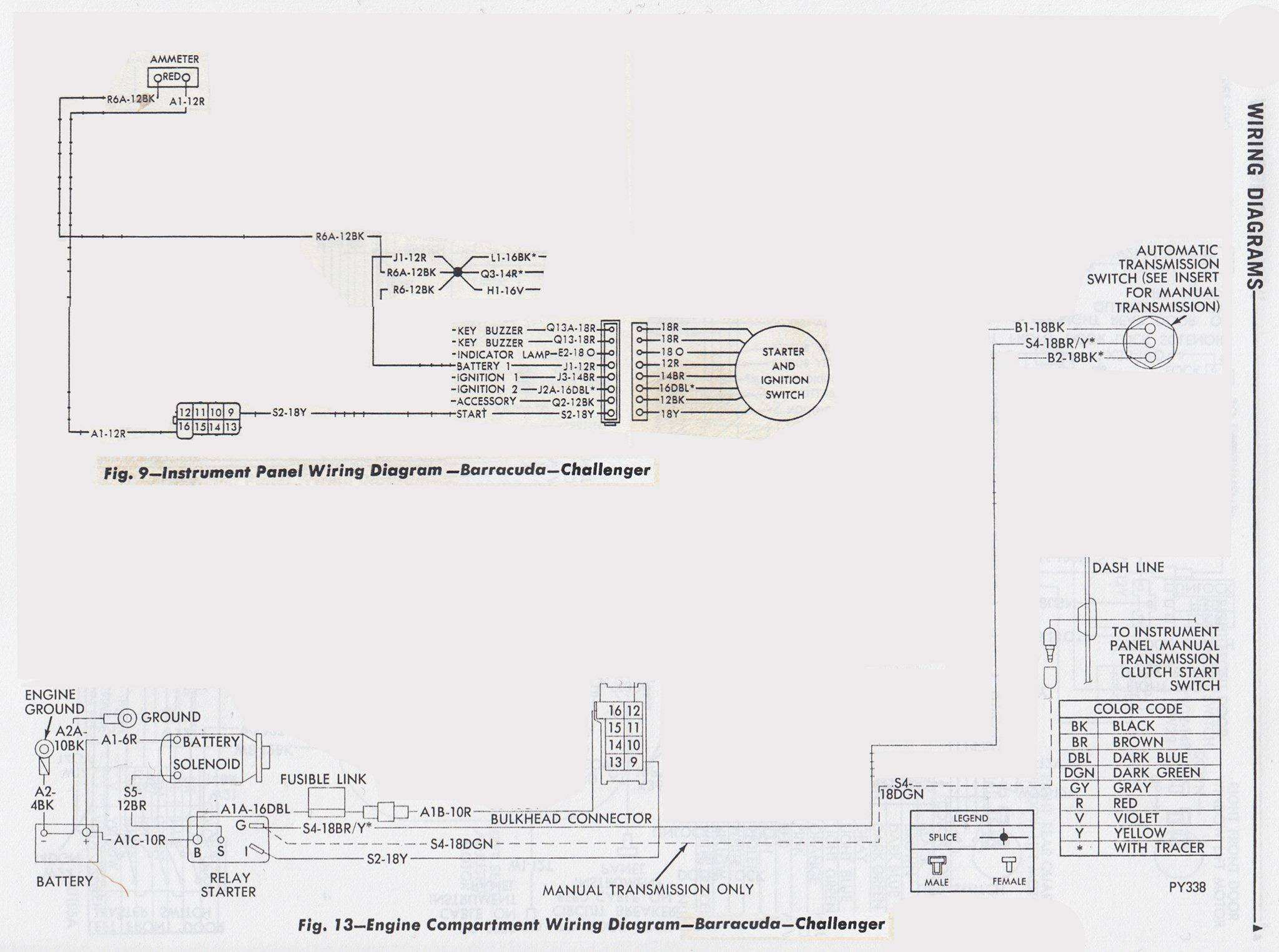

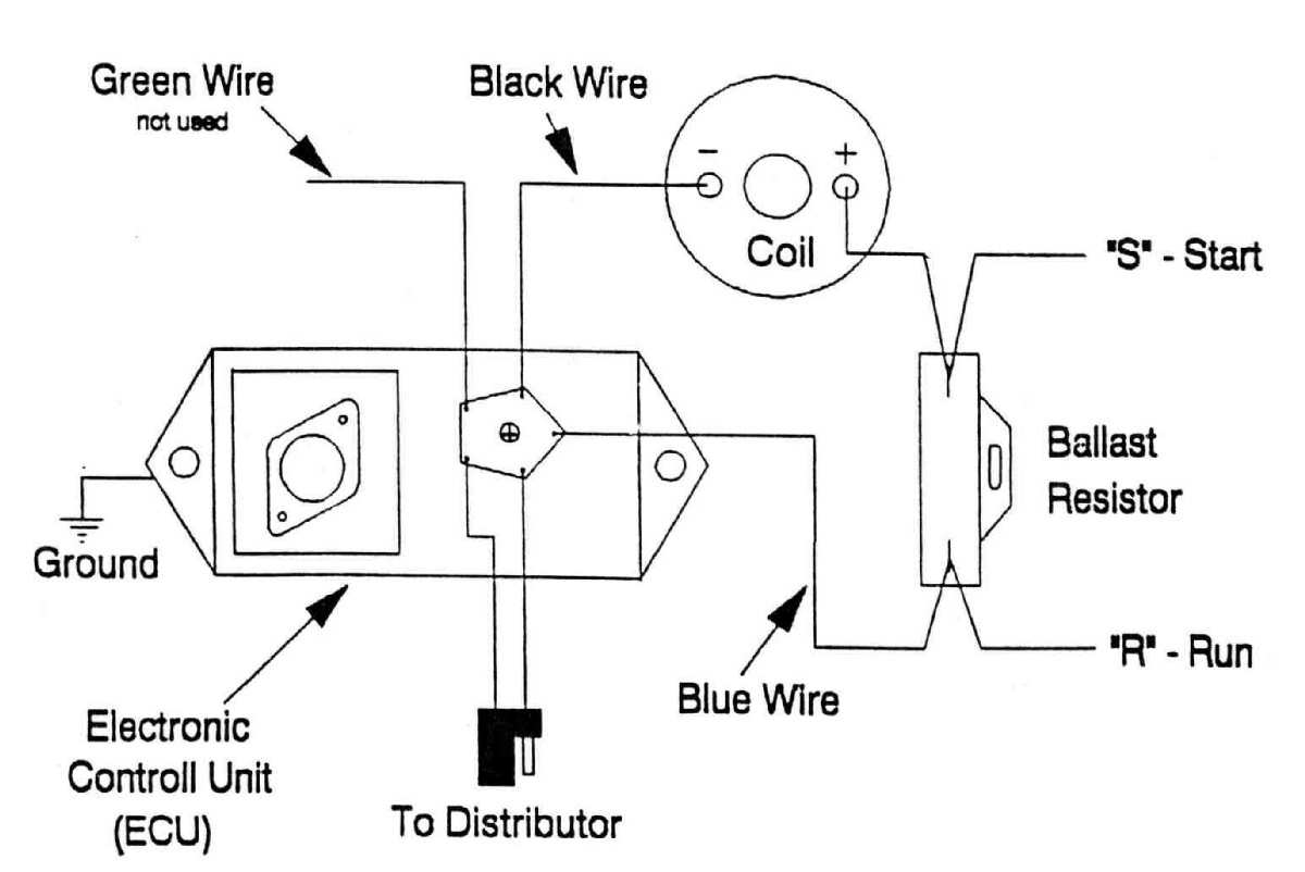

When you pull the plug off the NSS the light go out? Switch might be hanging up. Below are factory wiring if it helps. Turn ign sw to on. check if you have power to the ballast blue wire. If so connect test light to yellow wire on starter relay. turn sw to start if it lights. The ign sw is working. I would think the problem is the wires the NSS sw or the sw. Or the wring of the sw reversed.

When you pull the plug off the NSS the light go out? Switch might be hanging up. Below are factory wiring if it helps. Turn ign sw to on. check if you have power to the ballast blue wire. If so connect test light to yellow wire on starter relay. turn sw to start if it lights. The ign sw is working. I would think the problem is the wires the NSS sw or the sw. Or the wring of the sw reversed. View attachment 136144View attachment 136145View attachment 136143
You are a super stud! As I told Death, I am a firefighter. As soon as I get off shift, I'll do everything you suggested and follow up with you. Really appreciate you both!

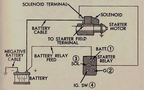

Check the yellow #4 on relay wire when key is in start position. It should be hot when in start position.
Then if you have power to the relay check the ground #4 on the relay. If it is not grounded your back to the NSS. A short ground the #2 ground terminal on to ground and it turn over. Pull the coil wire. BE ADVISED IF IN GEAR IT WILL START!!!! BE READY!!
