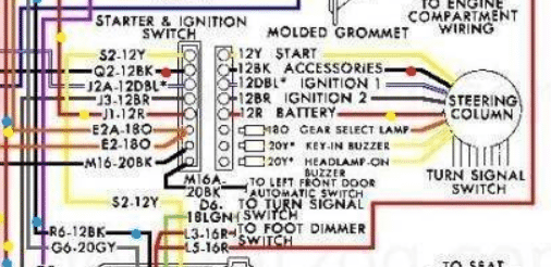

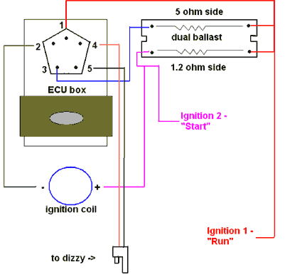

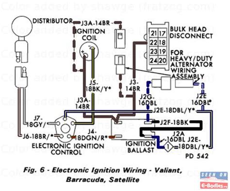

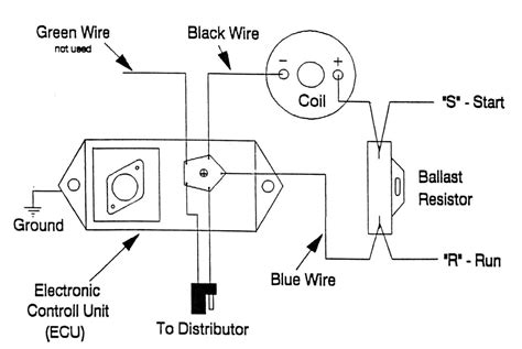

Ballast resistor. ign 1 wires that feed it or bulkhead connector. Be sure the pug under the steering column is clean and tight and bulkhead connector. With the ing sw on you should have power at the ballast blue wire same at the column plug blue / white. Blue wire is run. Brown is start.
