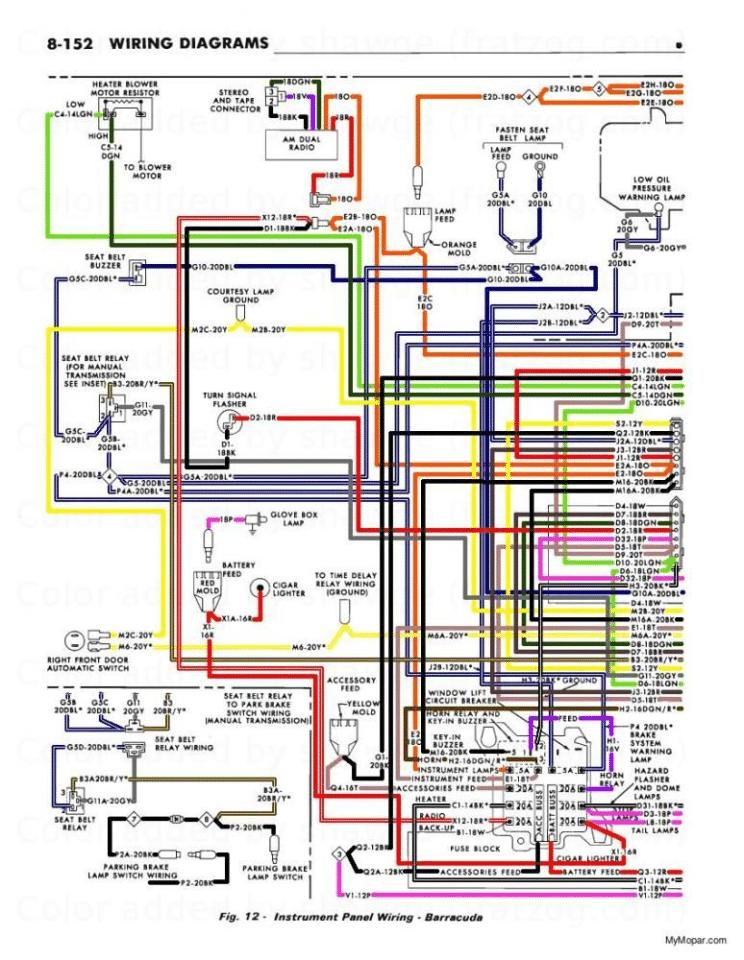

Does anybody have a wiring diagram for the seat belt harness for a 72 cuda. Most of the wires make sense again except for one red and green plug. Thanks

I have this saved, don't know if it'll help you though - bottom left.

Thanks for the wiring diagram. I figured out the extra plug was for a sensor that goes in the bottom of the passenger seat so that the buzzer doesn't go off if a non-existent passenger doesn't buckle up. LOL
