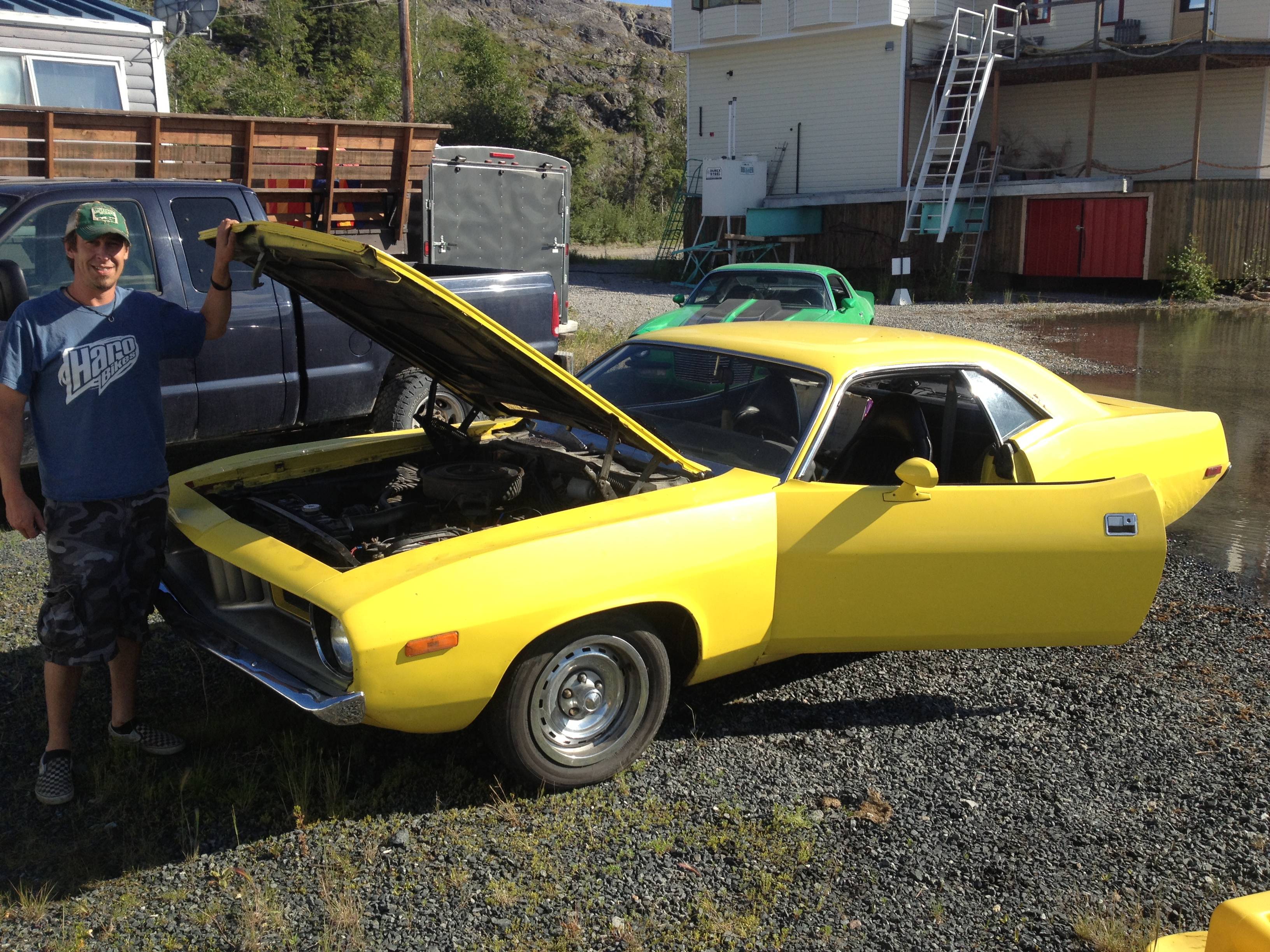

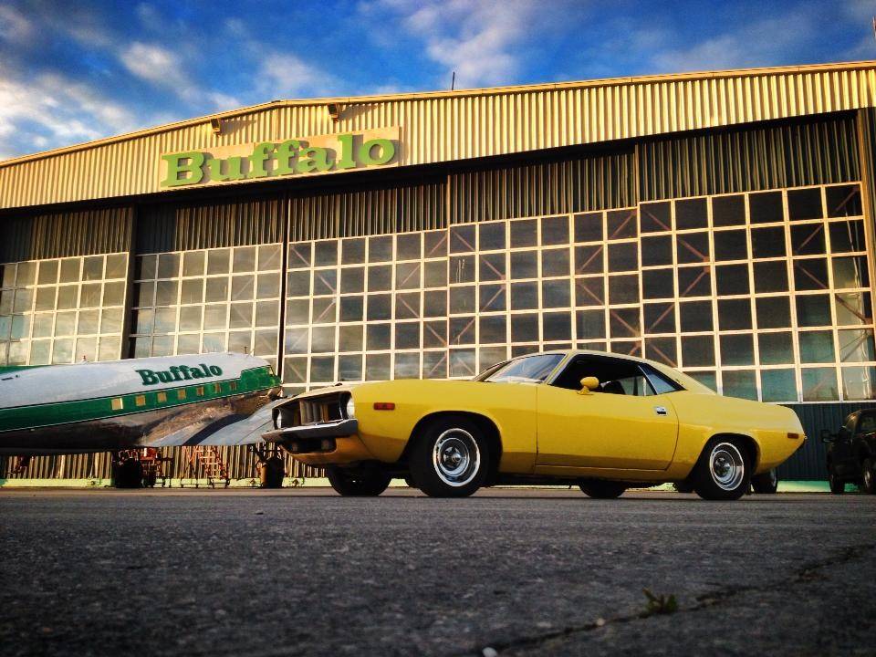

Hi All,
I'm very new to the site. I have a 73 Barracuda (318 Auto) that I'm swapping in a 6.1L/TR6060 from a 2010 SRT8 Challenger.
Need some advice about converting to a Hydraulic Clutch. I have an OEM E-body Pedal Set and I'm hoping to use the stock 2010 Challenger Throw Out Bearing (if possible?).
What is the best setup to buy from the firewall to the Tranny?
I see Full Hydraulic Conversion kits but because I have the pedal and an odd Tranny I was hoping you guys could help me with some part numbers so I can piece build a kit.
