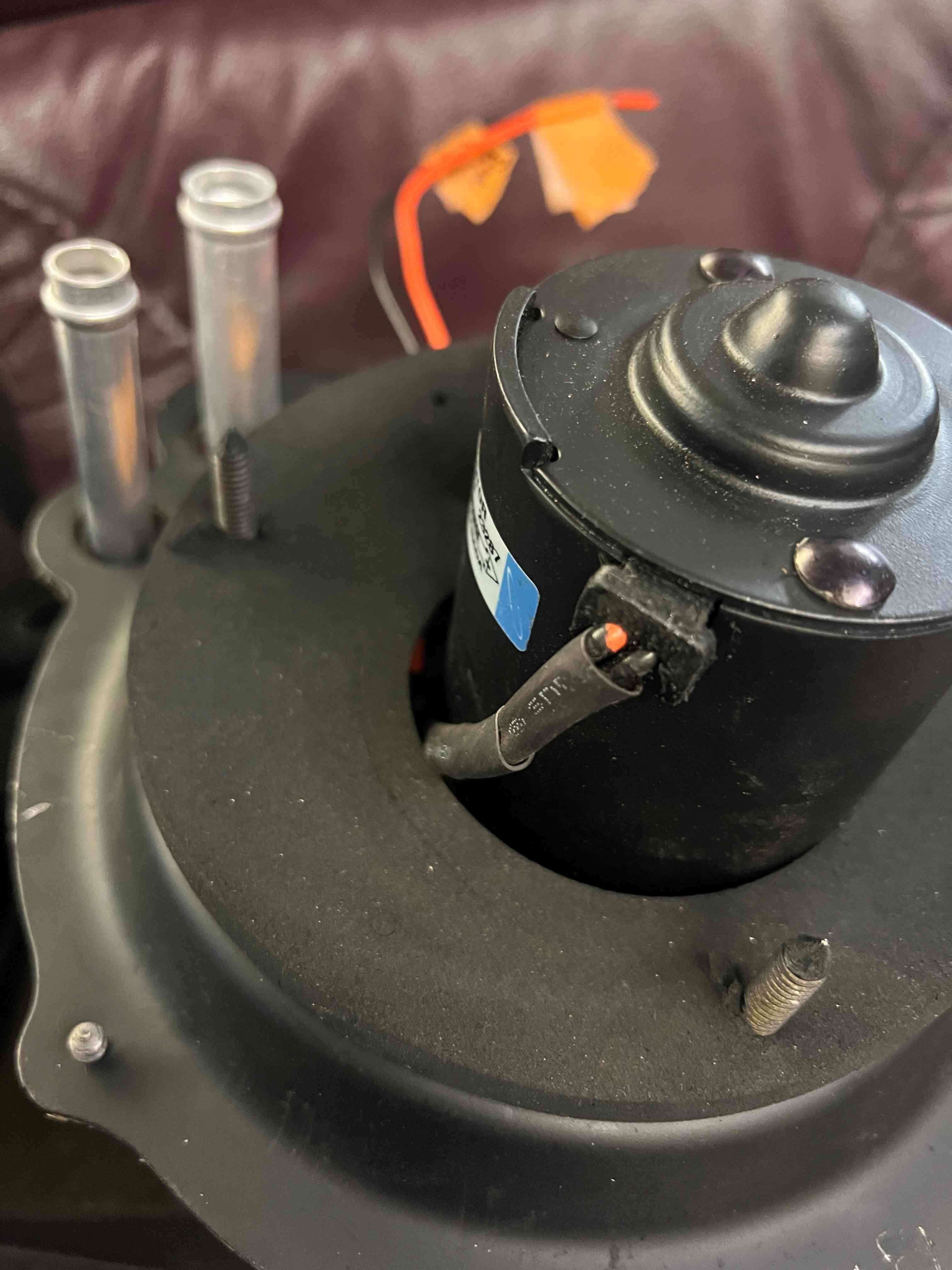

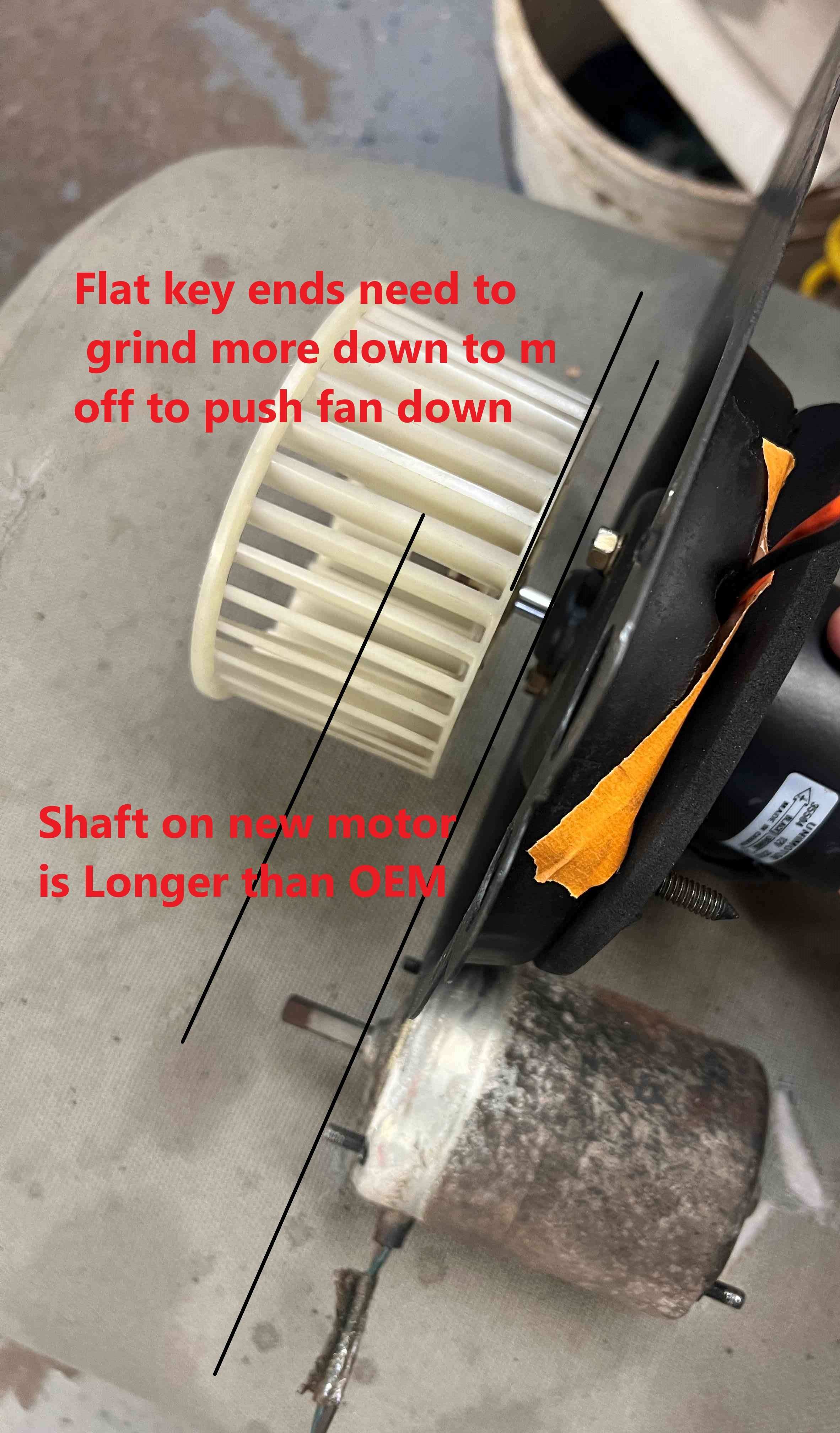

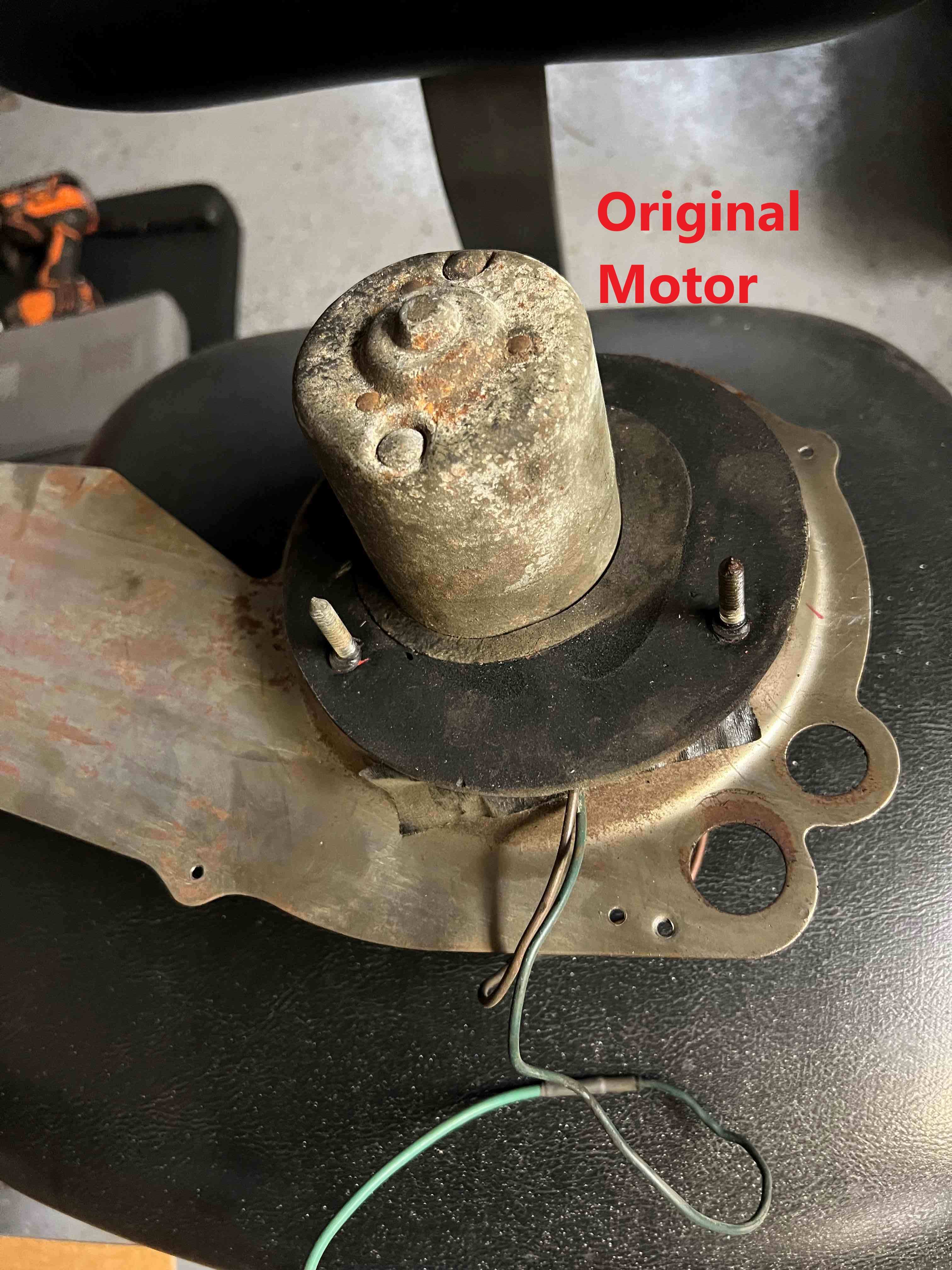

I think it's the water pump because the lower hose is not even warm. I am replacing all the hoses and rebuilding the heater core box. Replacing the heater core because it was leaking that was bypassed. The problem is looking for an OEM heater core fan motor, I found one on "Parts Geek" but the issue was the part pictured was not the part they sent! Note that the fan motor they send is not OEM and does not work without modifications.
1) The wires on the fan motor are on the end near the engine ( should be on the shaft end to tuck under firewall foam ).
2) That diameter of the motor is smaller than OEM ( gasket is not tight around motor )
3) The shaft is longer and the flat key cut into the shaft is not cut down to the motor so your fan wheel cage hits inside the heater core
box and will not spin when you put it together. ( You have to grind down the shaft key flat to the motor to make it fit )
I think "Parts Geek" should remove this part that tells you it fits 1970 -1974 Cuda. Yeah it does if you modify the heck out of it.
Hope this helps!
