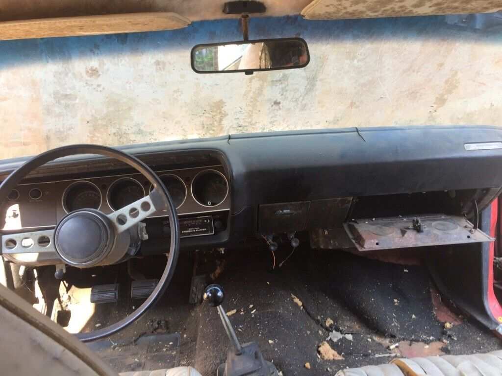

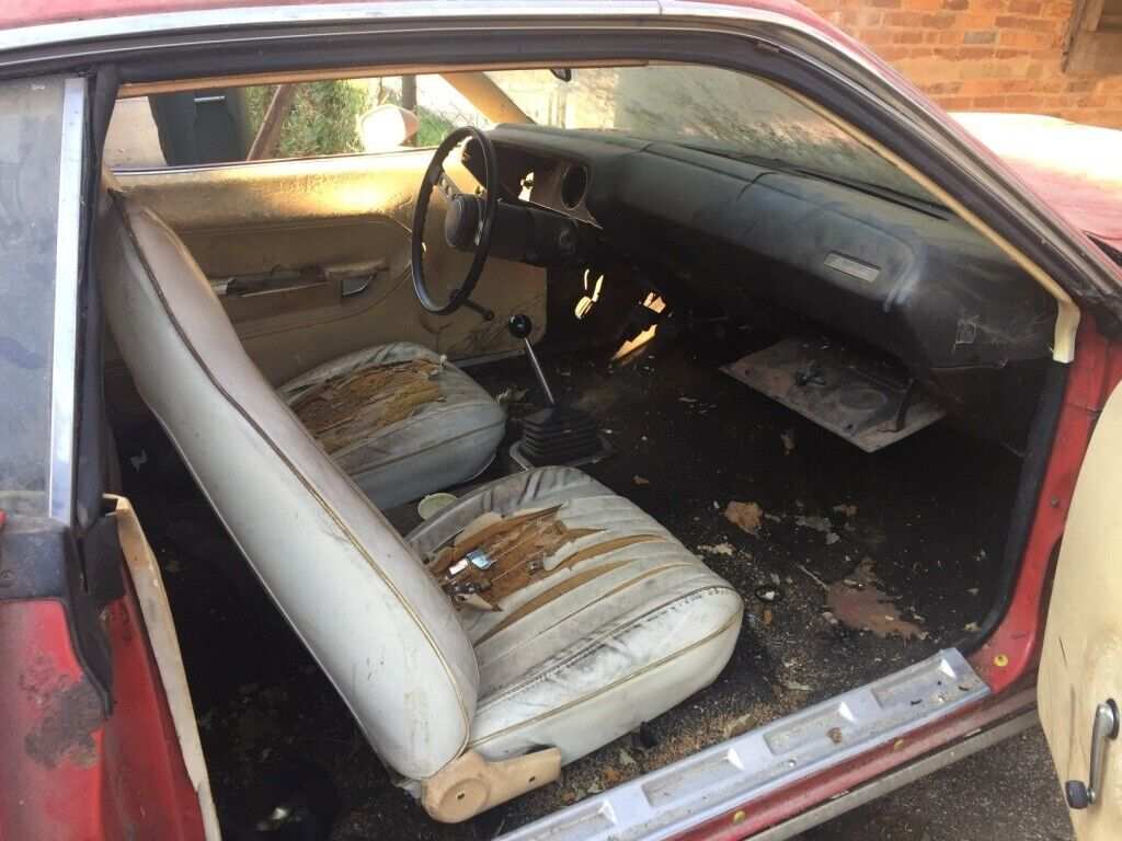

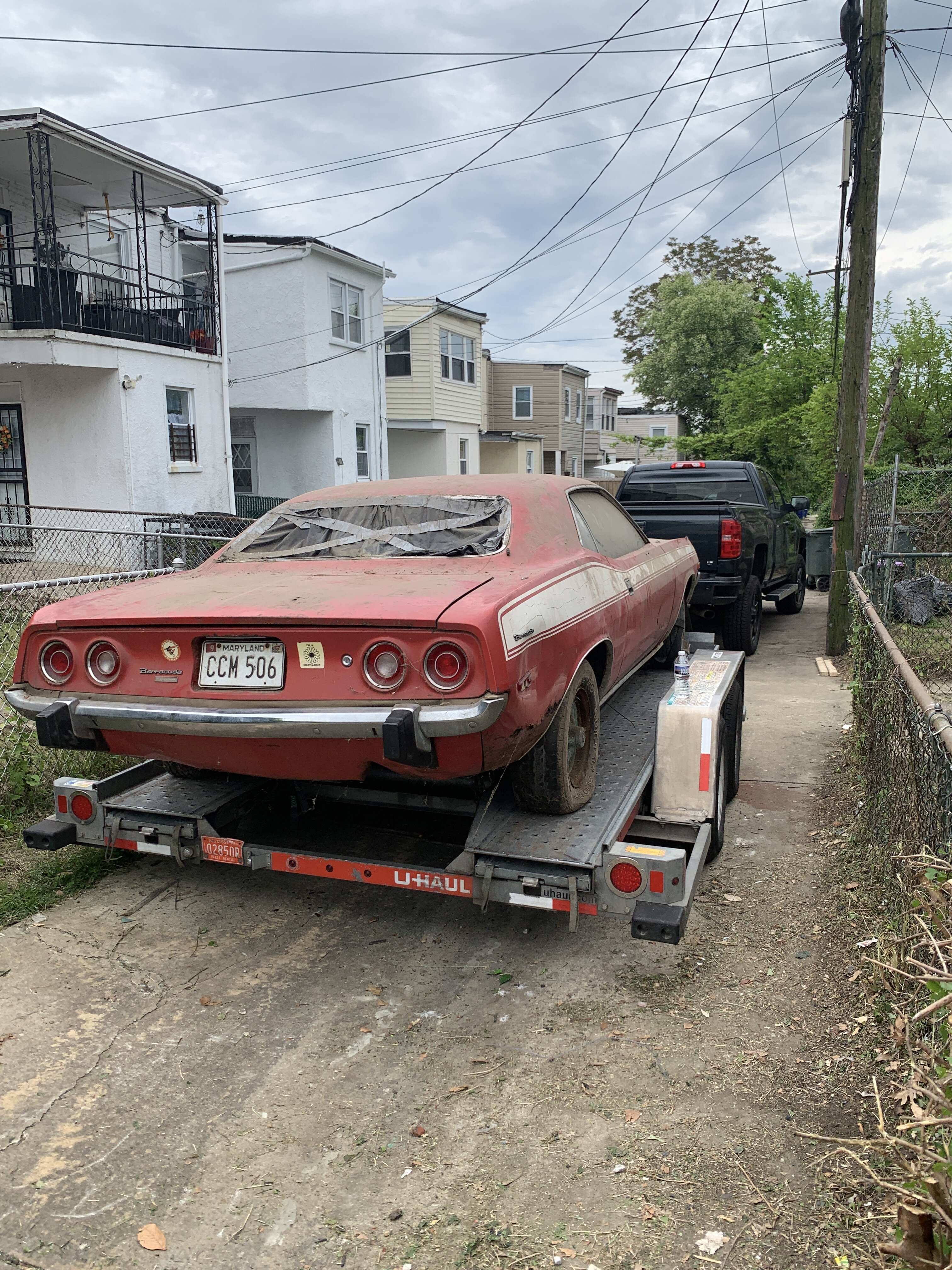

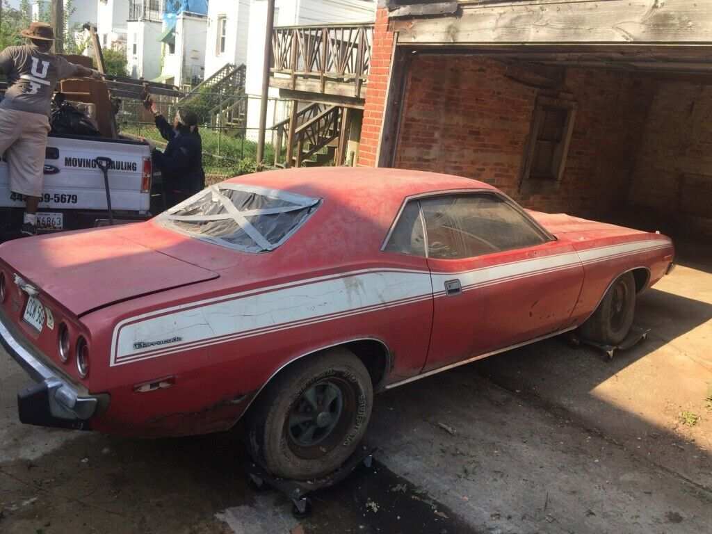

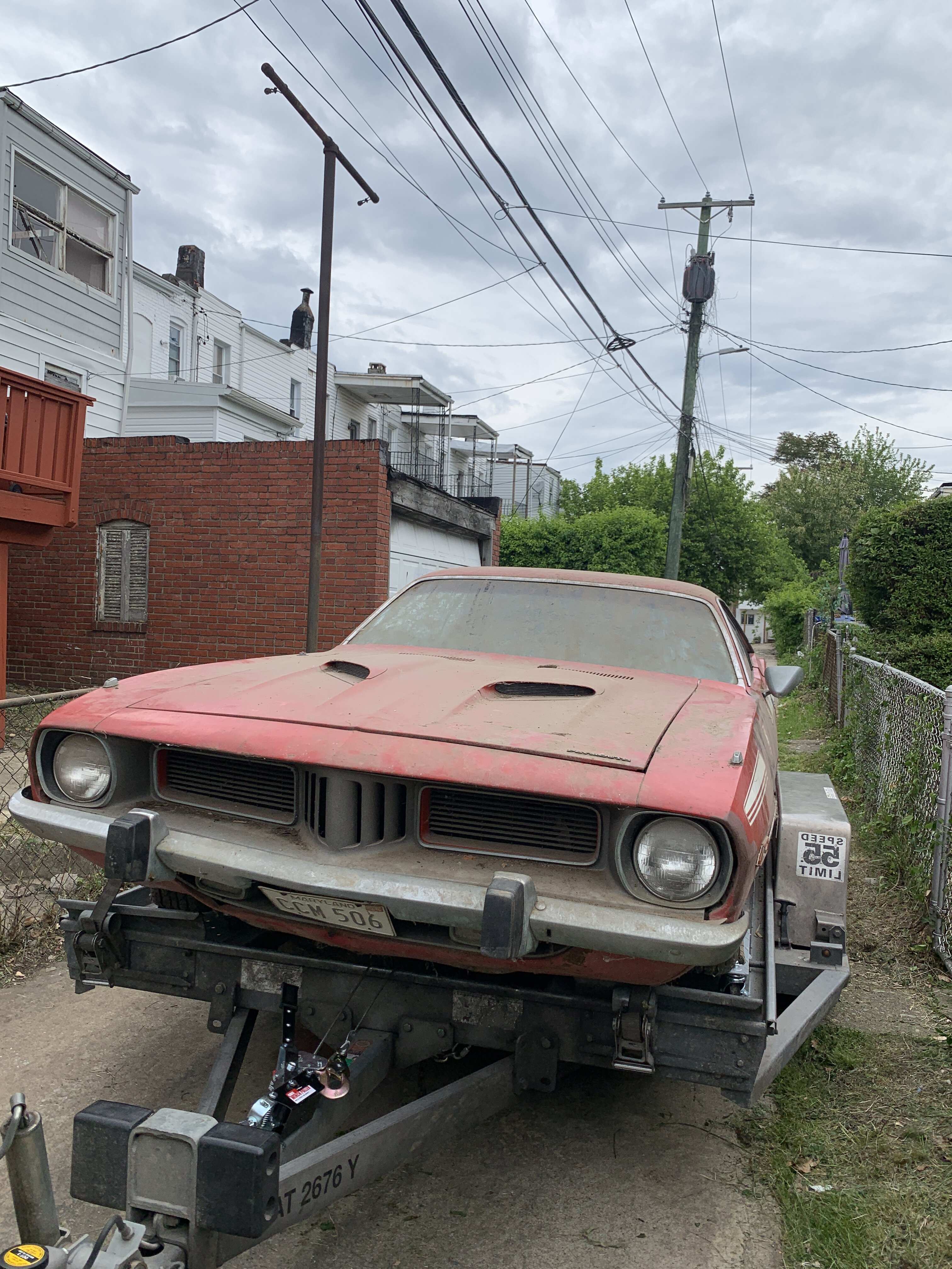

my barracuda came with single exhaust ,would like to go with a double going thru valance cutout ,any idea what would work (brand , model)
any help be good as im very new to Mopar family
thank you
ps. got my hands on this barracuda , been resting in Baltimore garage for last 40 years
