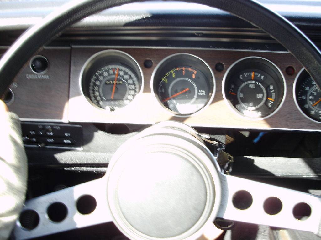

70Hardtop
Dec 28, 2011
124
7
Australia
Yeah DJ, it's only when you have a problem or are modifying something on the car that you start to learn so much in a short time. Just spoke to a fellow a few days ago with a Cuda, said he ordered a gear set from Summit, reckoned it only cost him US$30 for shipping. Seemed a bit too good to be true to me but he was sure about that and he's no dummy. Doctor Diff carry the rebuild kits, so do Mancini Racing I think. I had a 3.23 in my Charger 340 and even that I felt was revving too much at 100km/h. But up to 100km/h it was amazing for all round performance. I think 3.55 would just be too high revving if doing much over 80k's, unless your engine was comfortable sitting over 3500rpm a lot. I did an interstate run in my Chal and for that I put in a 2.6:1. Of course it didn't accelerate very well but it was an amazing cruise ratio, I could sit on 90 mph all day and the engine was only doing about 3300. Good luck with your diff.
