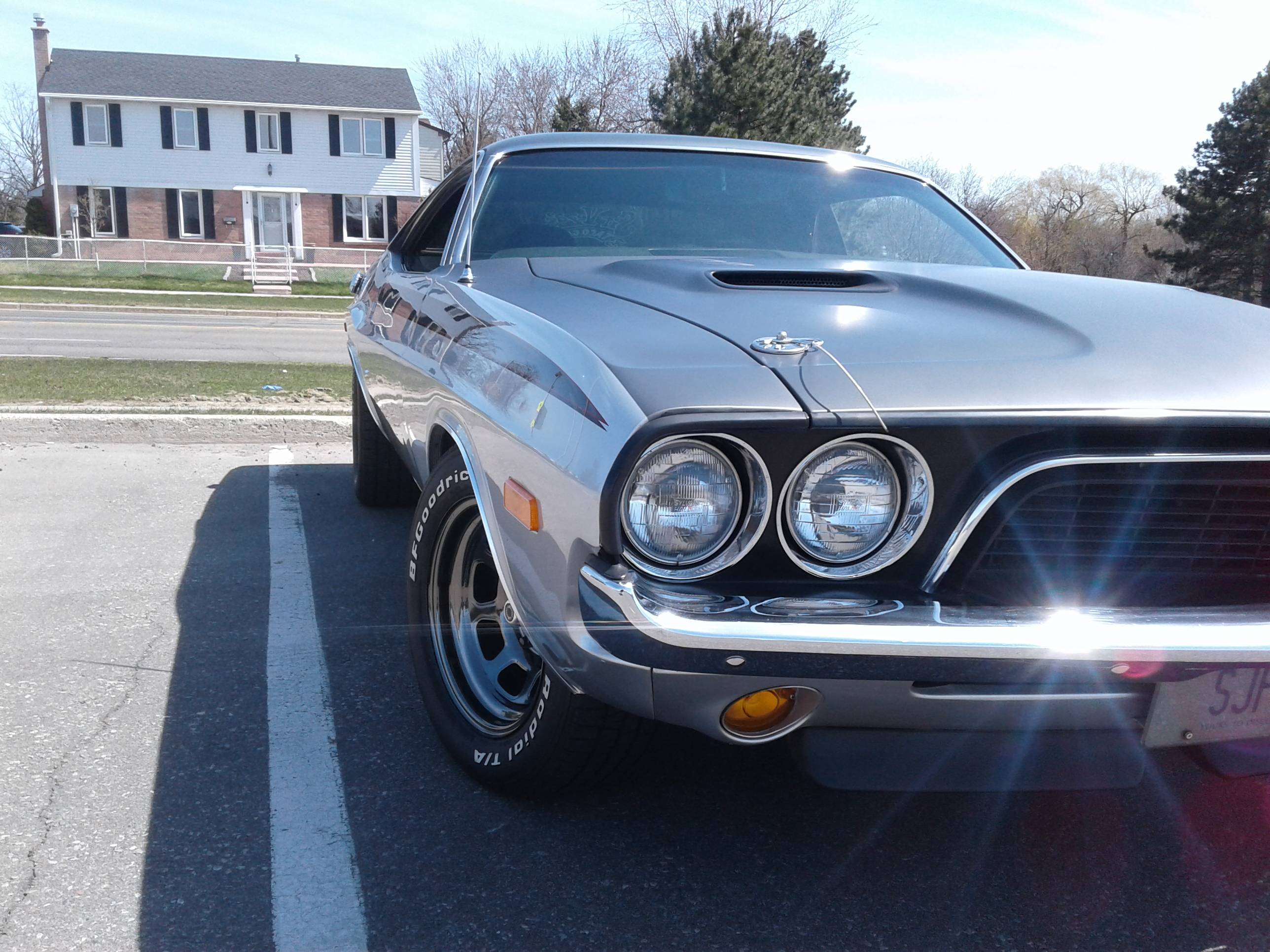

Really appreciate your input. Here's a couple of pics from last summer...
