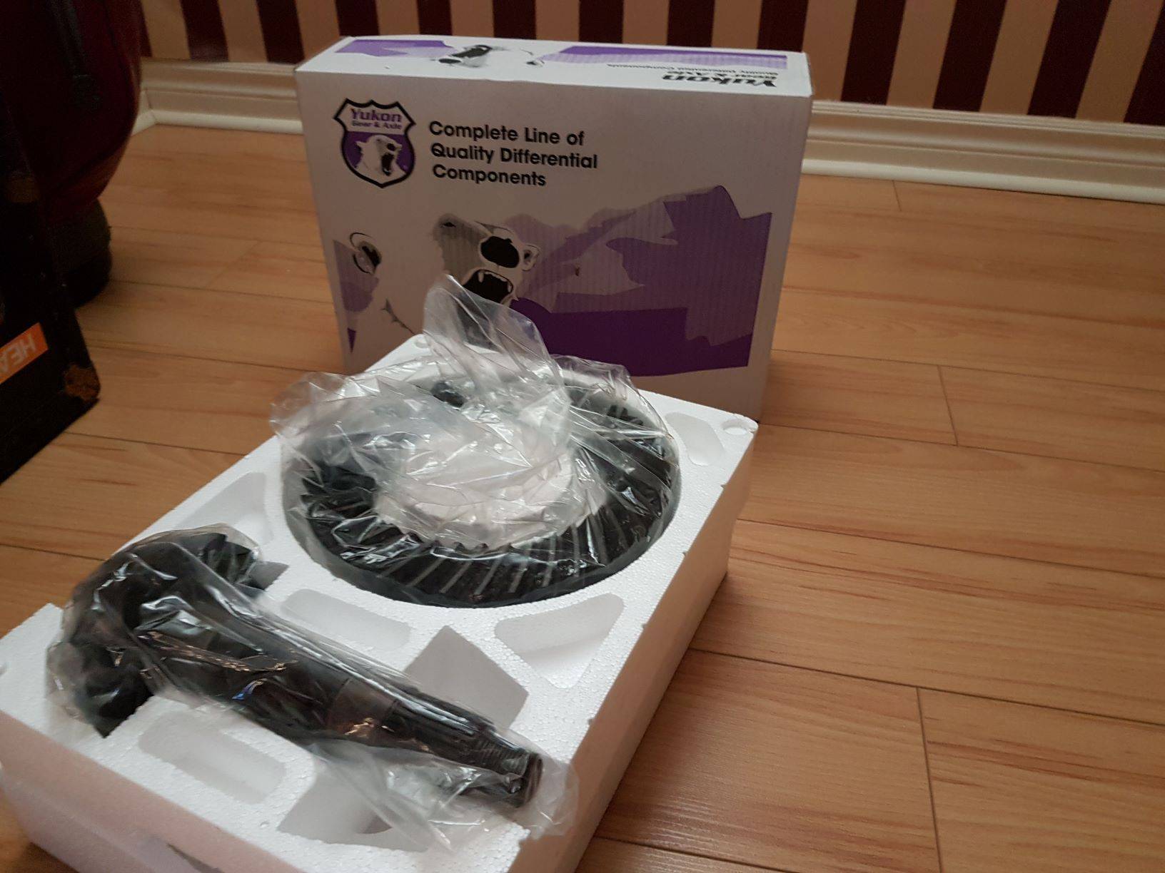

Thanks for all your input guys. Made a decision and ordered 3 55 - Just waiting for the installation kit to arrive.

Hi Steve, Literally got mine on the road this week. Upgraded to a Hurst Competition shifter. With the stroked 360 (408) and the new 3:55 gear set it's like a whole different car. (Already have an Auburn Posi in the rear end). Based on my GPS at 70mph I'm around 3000 RPM in 4th gear but feel plenty of power to do more. I've also been using Klotz 628 in the gas for the last couple of years which also kicks it up. I'm very happy with the result!
