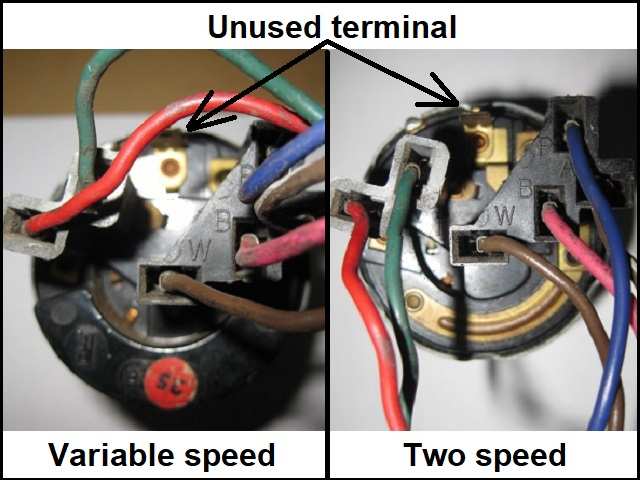

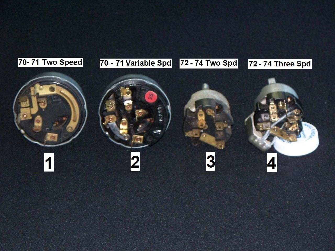

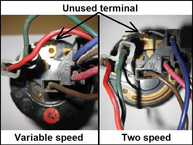

Your existing harness will work just fine. I didn't need to change mine when going from 2 speed. This applies if you have the correct 1971 switch 2770380

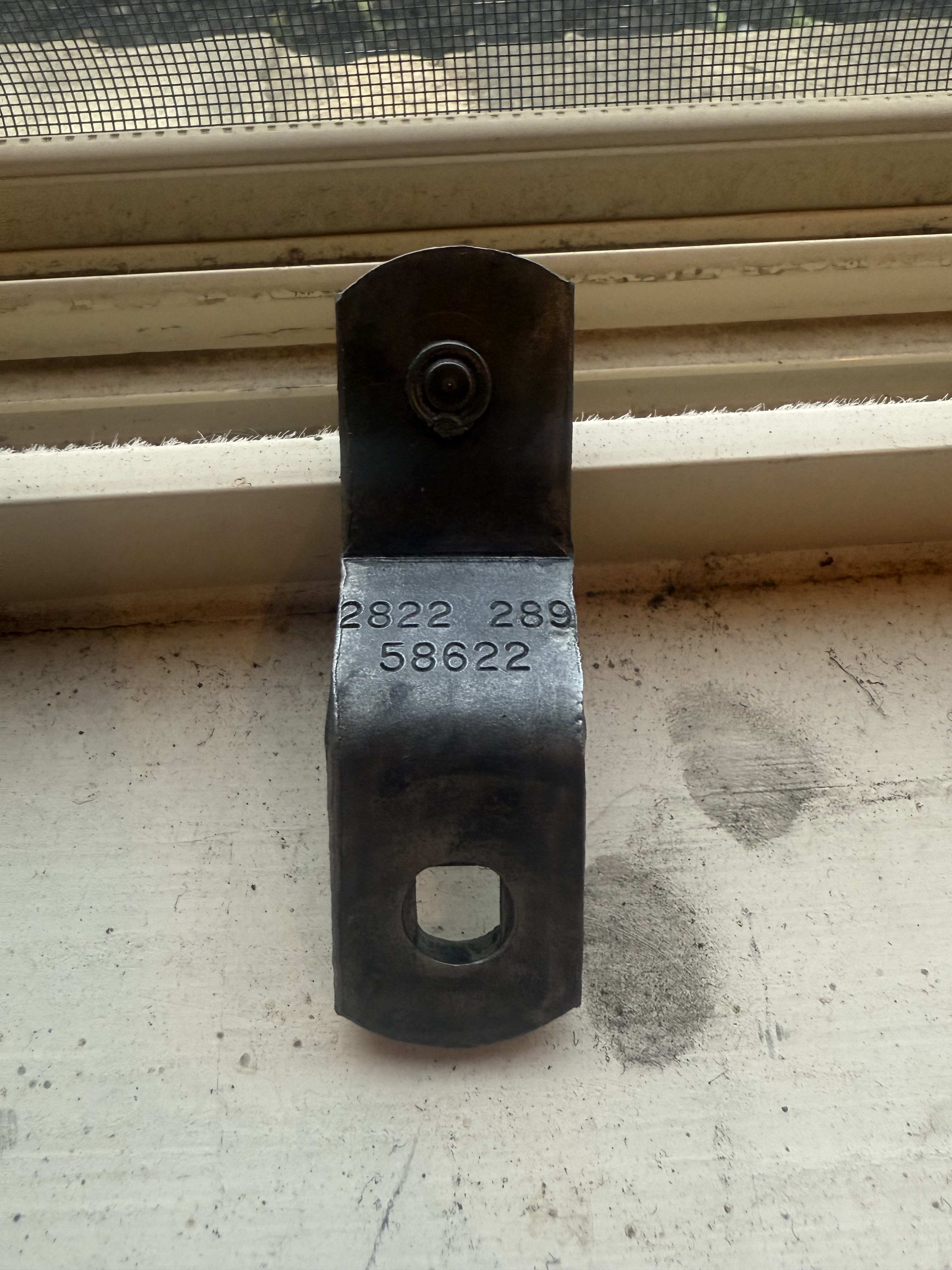

2822 292 is a 2 speed link, not to be used with a variable speed/3 speed set up. 1970/71 used a 2822 293, rare and hard to find.
3431 514 is a 3 speed link for 1972 to 74 3 speed setups. It would work with the correct 72-74 crank.
In 70 & 71 the 3431077 wiper motor used a 2822289 crank.

The crank on my wiper motor (3431665) has part # 3431518 on the crank.

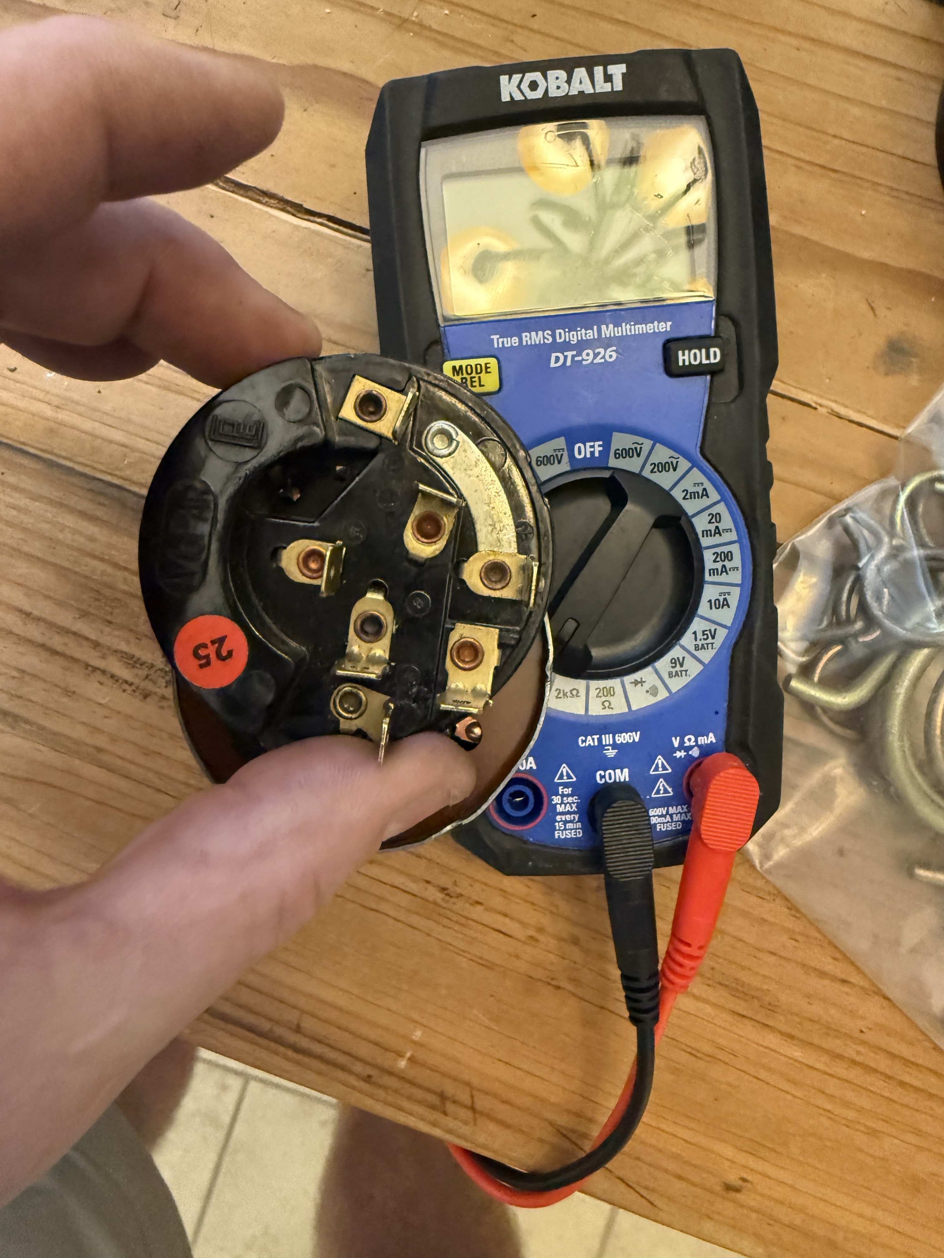

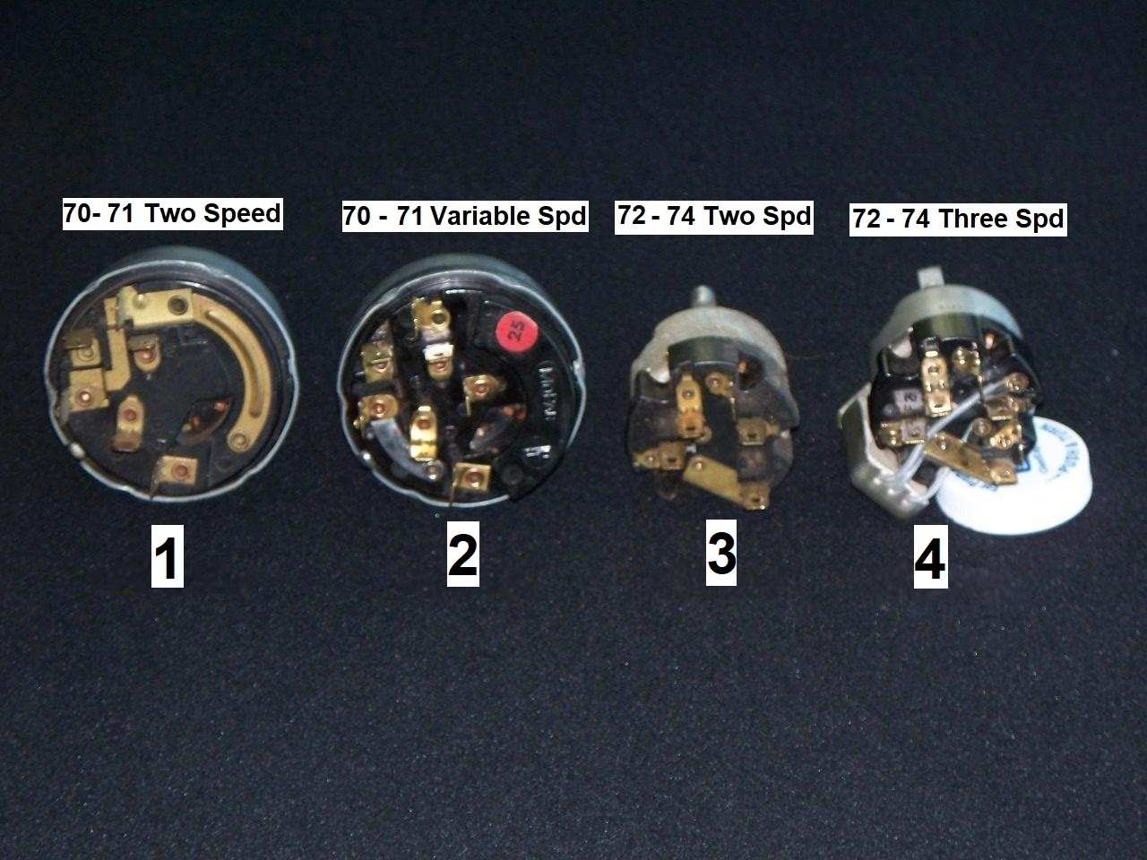

Both those are 1972+ parts. Seems like everything you have is 1972. If your switch is also a 72 and up 3 speed one then you’re right about your first post. You’ll need a different plug for the switch.
Sorry, I thought we were working with ‘70 - ‘71 stuff, your nickname led me down that path. I saw your other thread too, that’s also a 72+ rallye cluster.

If you have switch #4 you'll need a new connector. If you have switch #2 (2770380) your existing harness is fine. Variable switch 2770378 will also work, it looks identical to #2.

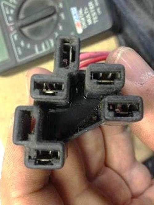

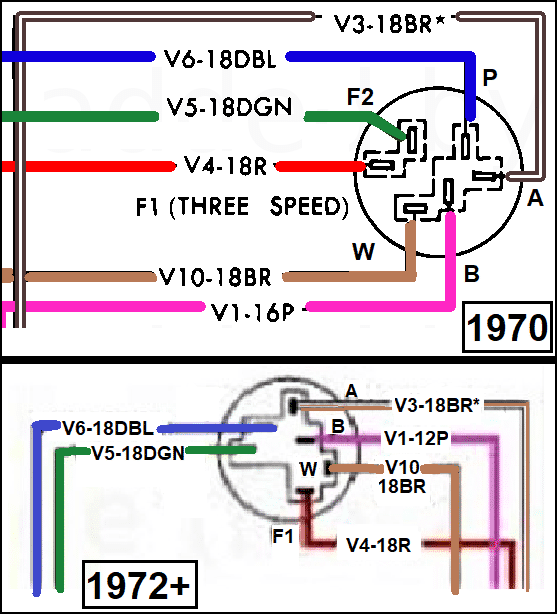

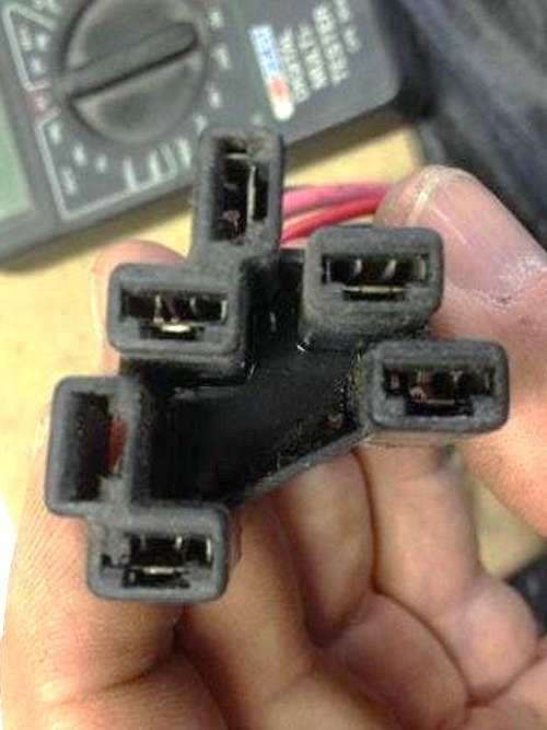

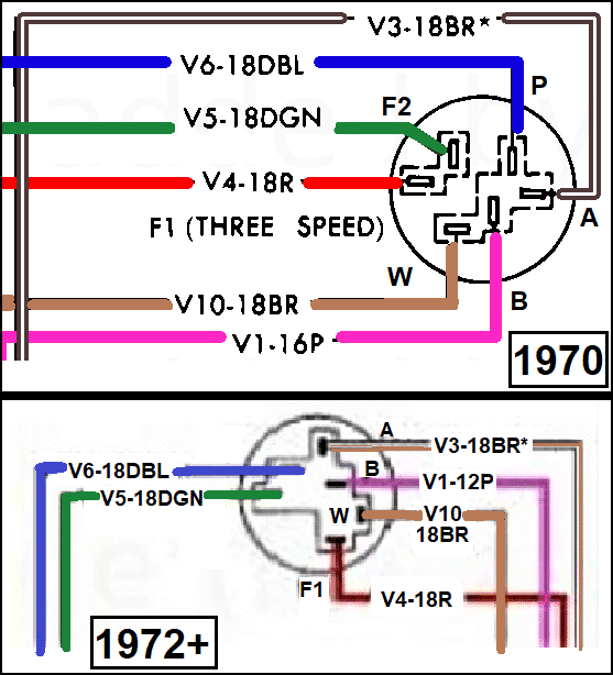

Yup, those are 1972 switches (typo on the second number). Sorry, no I don't. Those would be pricey too, of course, depending on the condition. You might have better luck with a 2770378. Maybe someone has a 72+ donor harness and are willing to part with the plug. Then you can re-pin it according to the schematic in Post#7. Here's what I believe to be a picture of it. Your very welcome too, glad I could be of some help.

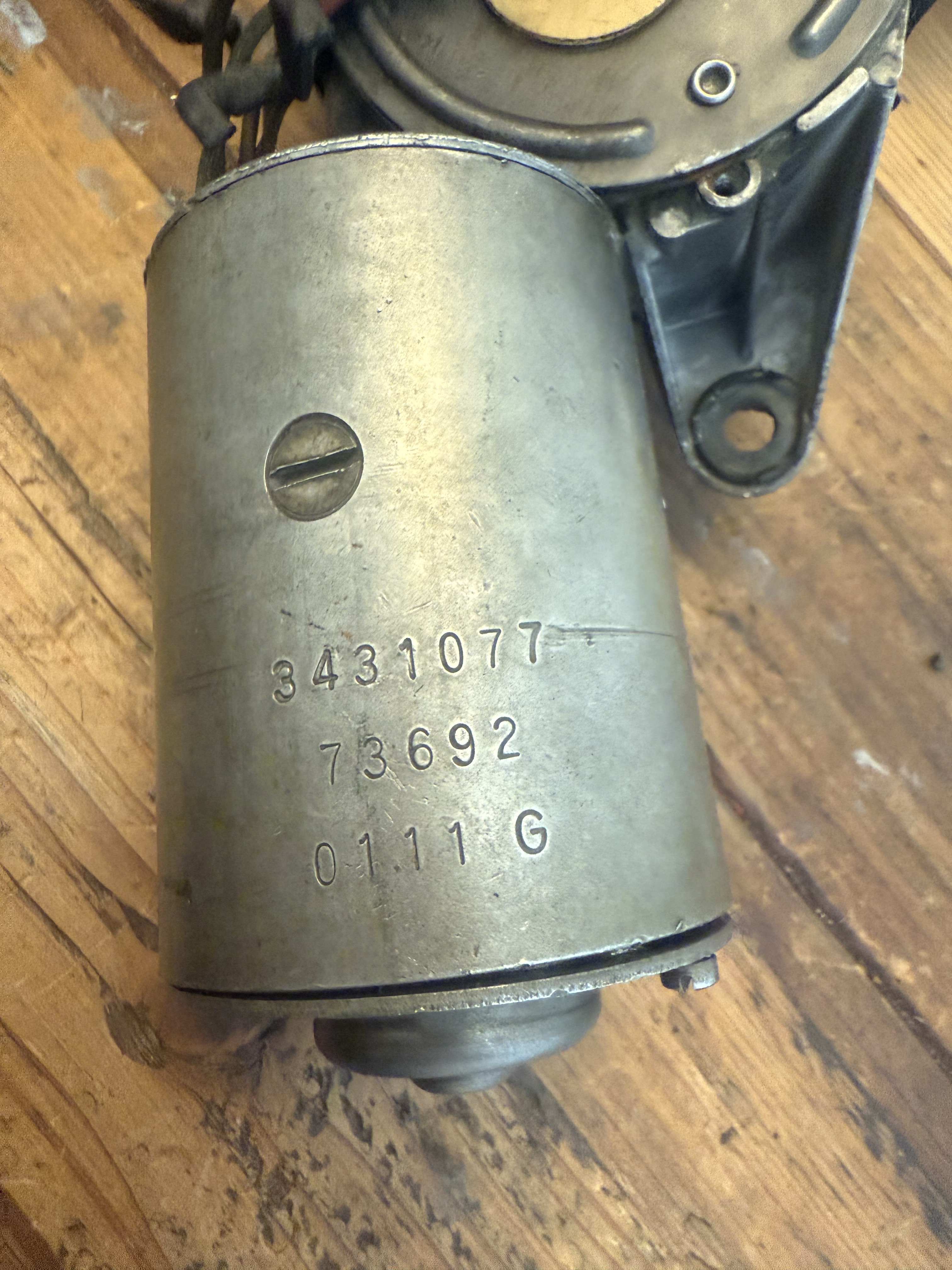

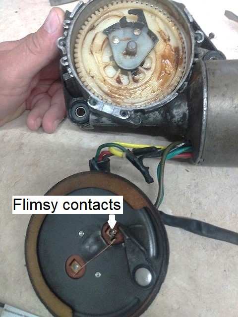

I'm guessing it would. Things I've read in the past said that a 378 is a suitable replacement for a 380 but they were all talking about the 3431077 wiper motor.
The other thing I came to believe was that that big plastic cover on the 3431665 motors merely houses a set of more robust contacts that replaced the flimsy ones under the 3431077 motor's top plate. Sorry, but I'm mostly just familiar with '70/'71 stuff.
Can anyone else please verify that the 3431665 motor is basically the same as the 3431077 one.
