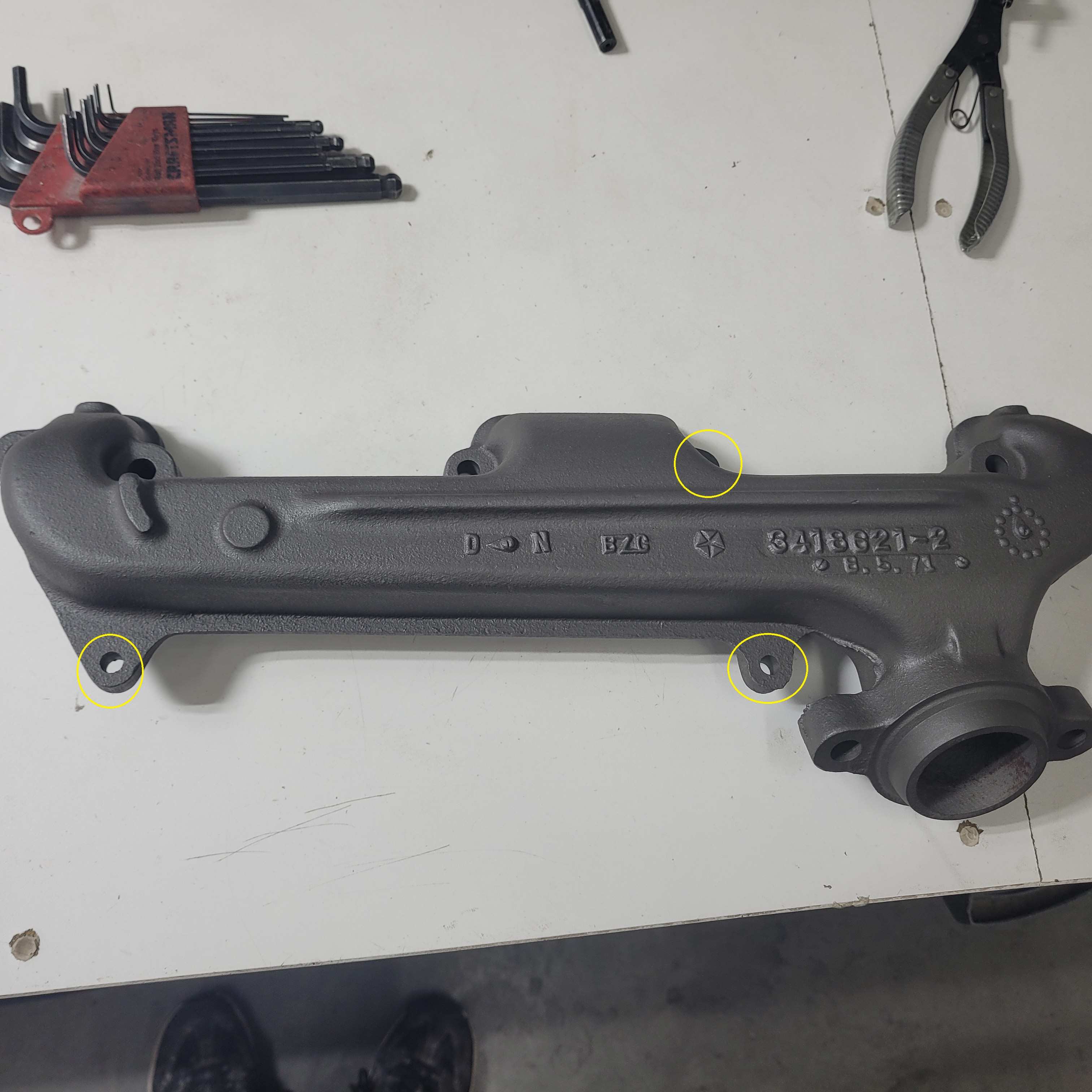

It looks like I need a heater stove that attaches to the 2 holes on the bottom circled tabs and at the cylinder head with a special stud (which I have) on the third circled hole. I am not positive on this third hole. The part number on the manifold is 341862-1. Thank you again!

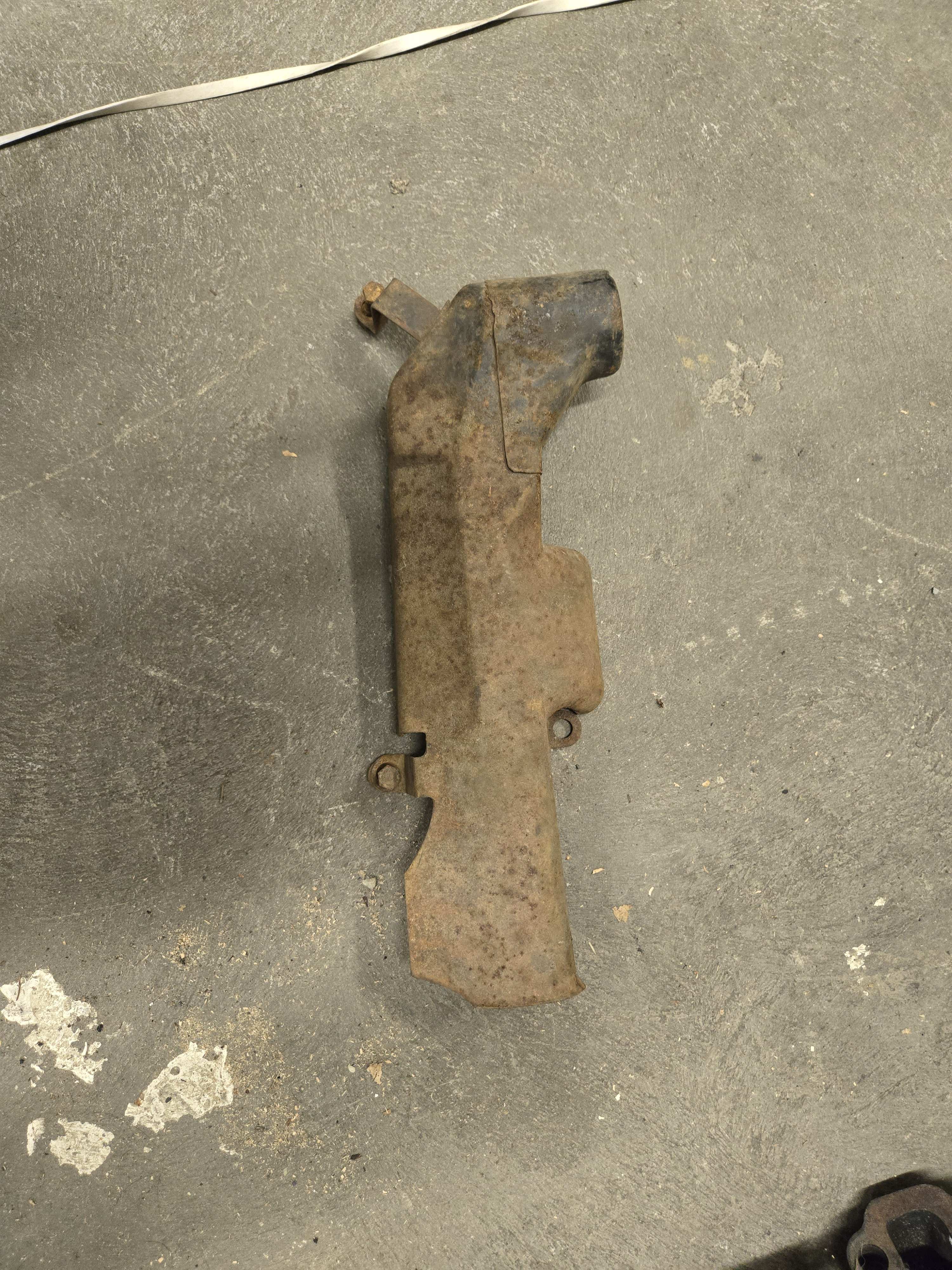

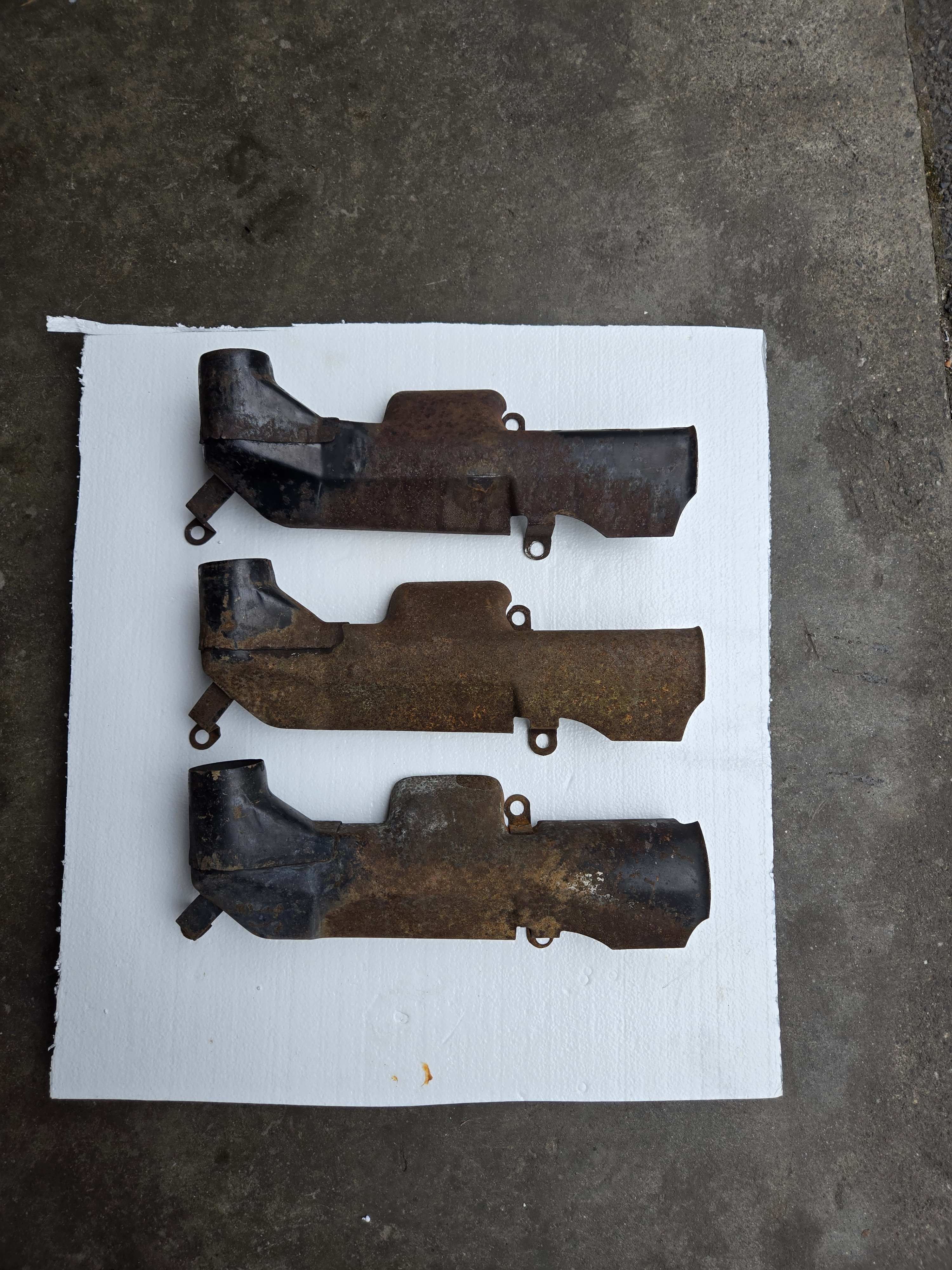

Who knew there was so much minutia with late model 340-360 exhaust manifolds and heat stoves.
318 are different from the 340 by the lack of clearance notch on the center port bolt. (bottom shield)
