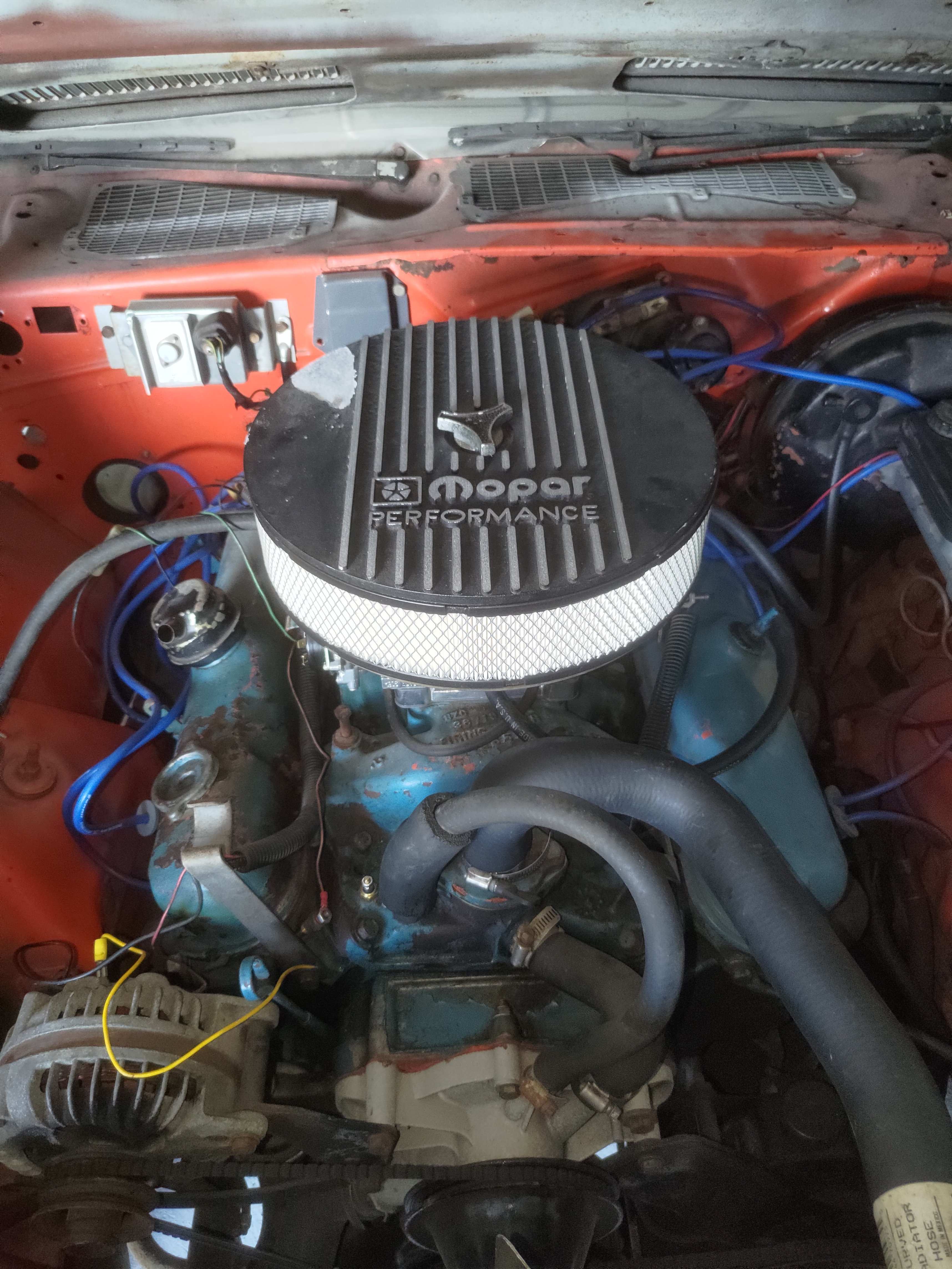

Hello all, I'm preparing to put this 1973 cuda back on the road and just trying to work out as many kinks as I can before I do put it on the road. I don't have a tach on the engine so I don't know how high it's idling but it's definitely idling high. I just replaced the thermoquad for an Edelbrock avs2 but the high idle still persists. I backed the idle screw all the way out but I'd guess it's idling somewhere around 1100-1200rpm but if you rev the engine hard it'll kick itself down to around what I'd guess 600-700. I checked for vacuum leaks and didn't find any. I was going to try tuning the carbuerator and checking timing on the engine but was wondering if anyone had ran into this and had some insight on something I'm overlooking.

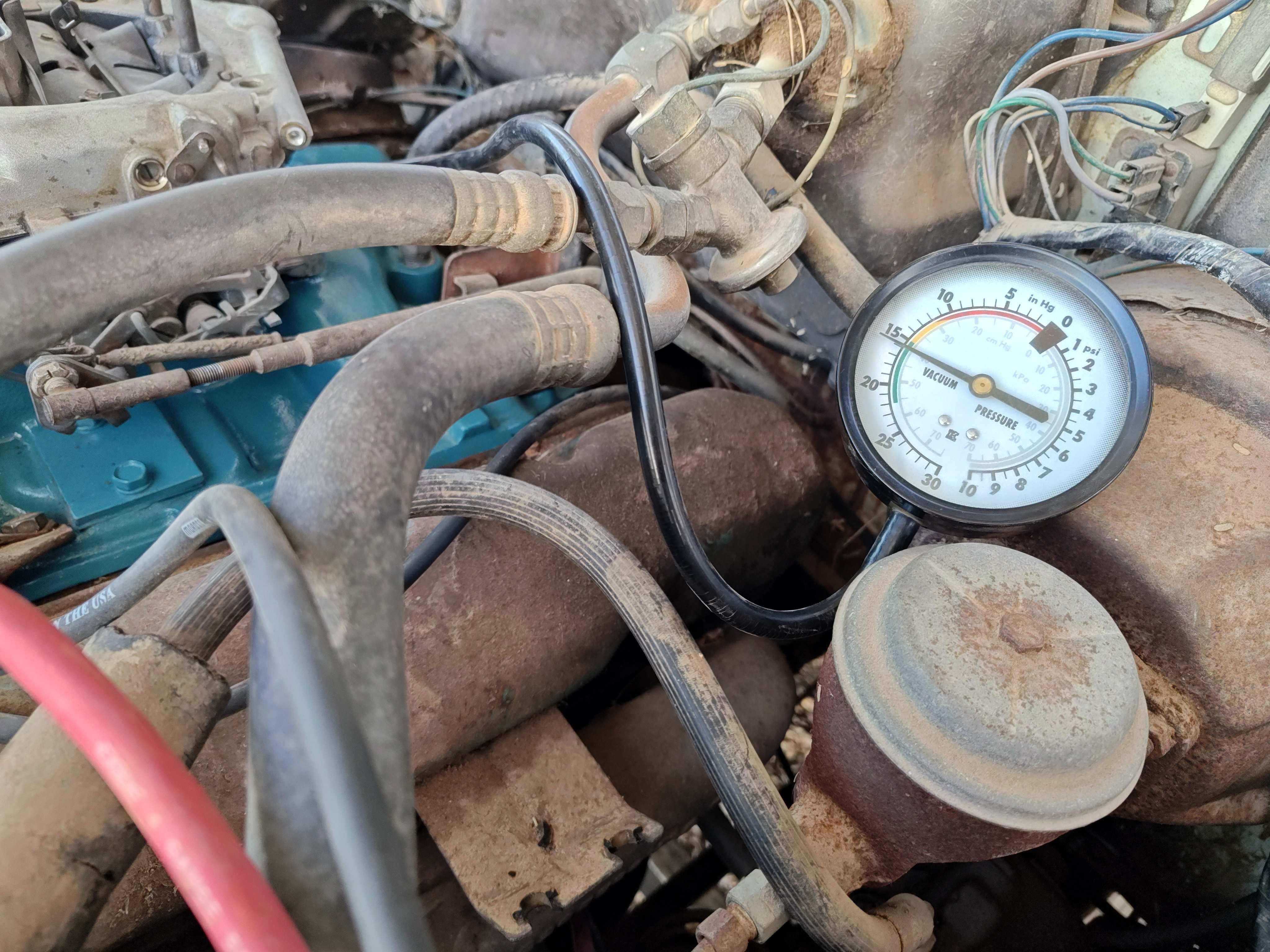

A vacuum gauge is one of the best tools you can buy! Here's my 64 Imperial's vacuum reading when I got it fired up today. I haven't even fine tuned it yet! Unless you have a really big cam, anything less than 14 inHg vacuum is an issue.

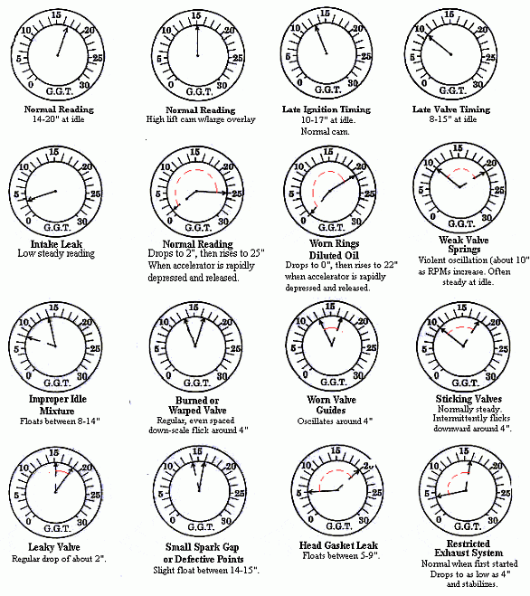

All the above info is good. I would start with that. I the linkage lining up or binding up. Also is the chock closing and opening correctly. Reason I ask is the top chock linkage at same place as the as the other carb. I there a spacer under the carb now or before? Don't know if the there is enough travel in the choke. Vacuum Gauge Readings.

RTA, thanks for posting the vacuum gauge info. Everyone should print that out and stick on the wall of their garage somewhere!!

So I ended up messing with the carb again and stopped being so delicate with the electronic choke which finally popped off so I was able to leave it fully open. That dropped my rpm down and I was able to get it at a lower idle finally. Thank you all for the help
