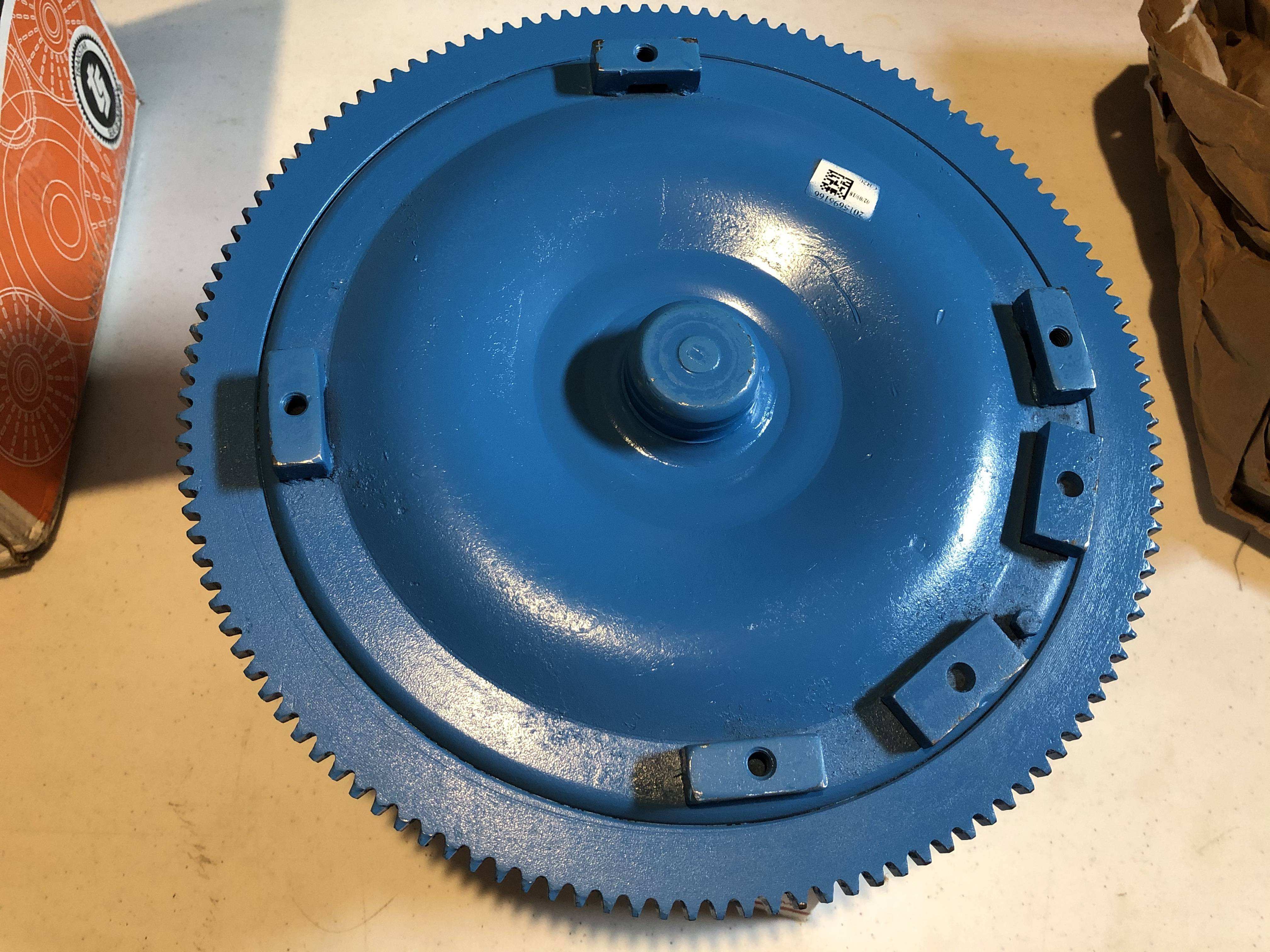

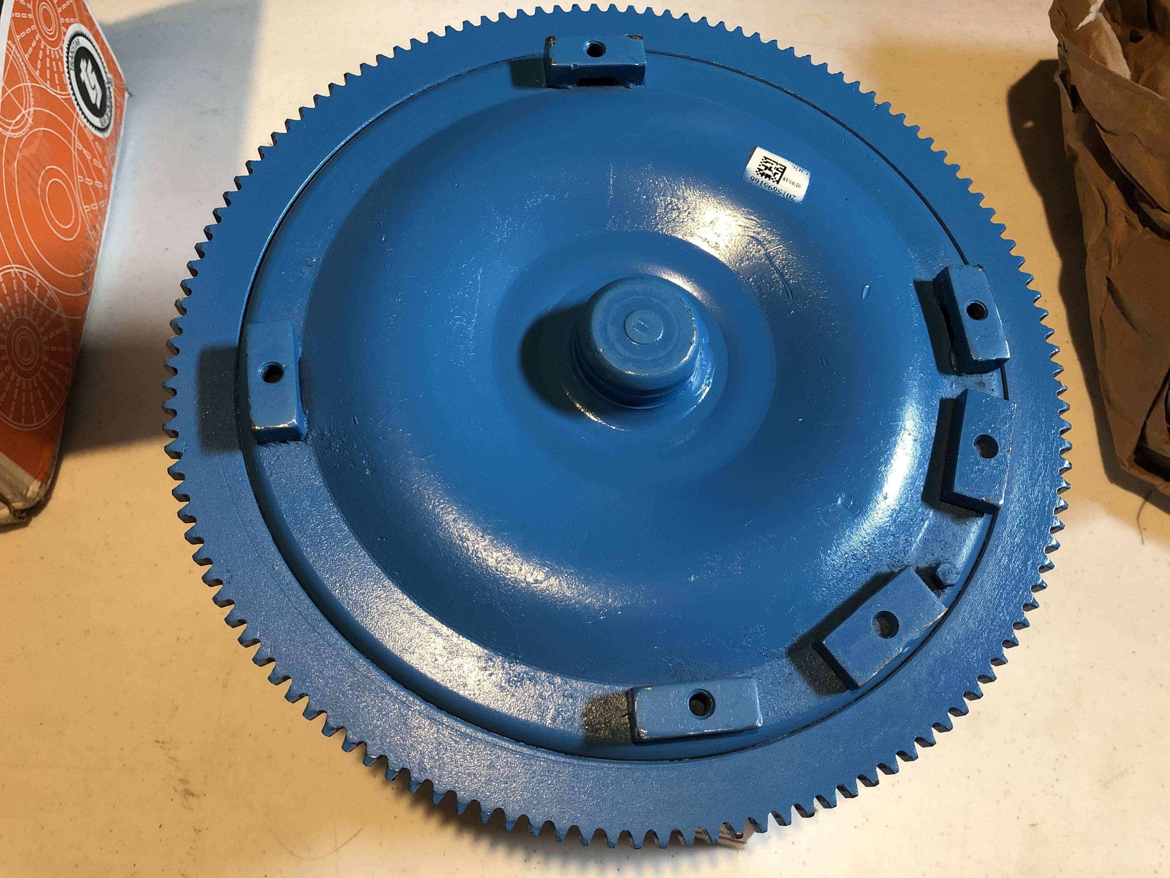

If your flex plate or torque converter where balanced (asymmetrical design or added weight) for an external big block which you had originally and you didn't change to a neutral balance flex plate and/or torque converter going to an internal balanced engine, it will cause shaking! And wear things out much faster! The good thing is if the weight in on the torque converter, you can probably take it off from under the car. If the flex plate was for external balance, you're taking the engine and transmission apart.

As I didn't change either. It sounds like this could be the cause of all my problems. So I need remove any weights from the converter (would they all be on the front which I can access). I will try this first (at the end of the week) and hope that the existing flex is not contributing to the problem. If it is I'll have to get a neutral flex plate and take the transmission off. Good to have something to investigate - thanks.

Yes, the weights are on the front of the torque converter. If present, you'll need to remove the dust cover and you should be able to see the weight(s) similar to the ones in the photo below. I've had the best luck with a really sharp small chisel and BFH. I suppose an air chisel would work too, but I kinda like whacking on the car when I'm doing a necessary rework. Gets rid of frustration! 😁

This is new to me. I remember that my converter had weight(s) on it. To be clear before I start hacking do you mean ALL 6 of the weights in the pic or just the two at 4 and 5 o'clock? Is the "pin" at 4.30 the flexplate locator?

Just the ones that don't have bolts from the flex plate going through them. It will be obvious when you see them. No the "pin" is a drain plug on certain years and models. The weights are on either side of the drain plug in the photo above.

Update. Hacked off 2 x 1 oz weights from converter. Flex plate is a neutral one. Although I'm sure it was the right thing to do there is no noticeable difference in the shake. So, back to the six pack. I've had a couple of backfires and fuel spits when starting so I've taken them off (again!) and checked everything. Power valve is a 7.5 and holds vacuum. My usual idle vacuum is 16 so that should be OK. Centre carb has the correct gasket for the metering block. Re-checked float levels - all just up to the sight hole. Throttle blades all moving freely. To see if there is a fuel leak I put newspaper under the carbs and ran the electric pump - no leaks. Replaced the fuel lines with AN ptfe fittings and braided hose for ease of carb removal and reduced leaks. Anybody know what the inch by half inch plate on the centre carb body is? - and which way up the thing inside goes - it fits either way - I suspect the little round button goes down towards the hole but want to be sure - googled but can't find any reference to it. Not run it yet - out of time. Before doing all this I noticed that the idle increases significantly when the crankcase breather hose is removed. Does this mean it's over fueling? - my wife says the exhaust smells of petrol but it seems OK to me - perhaps I'm immune to it!

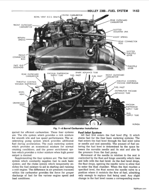

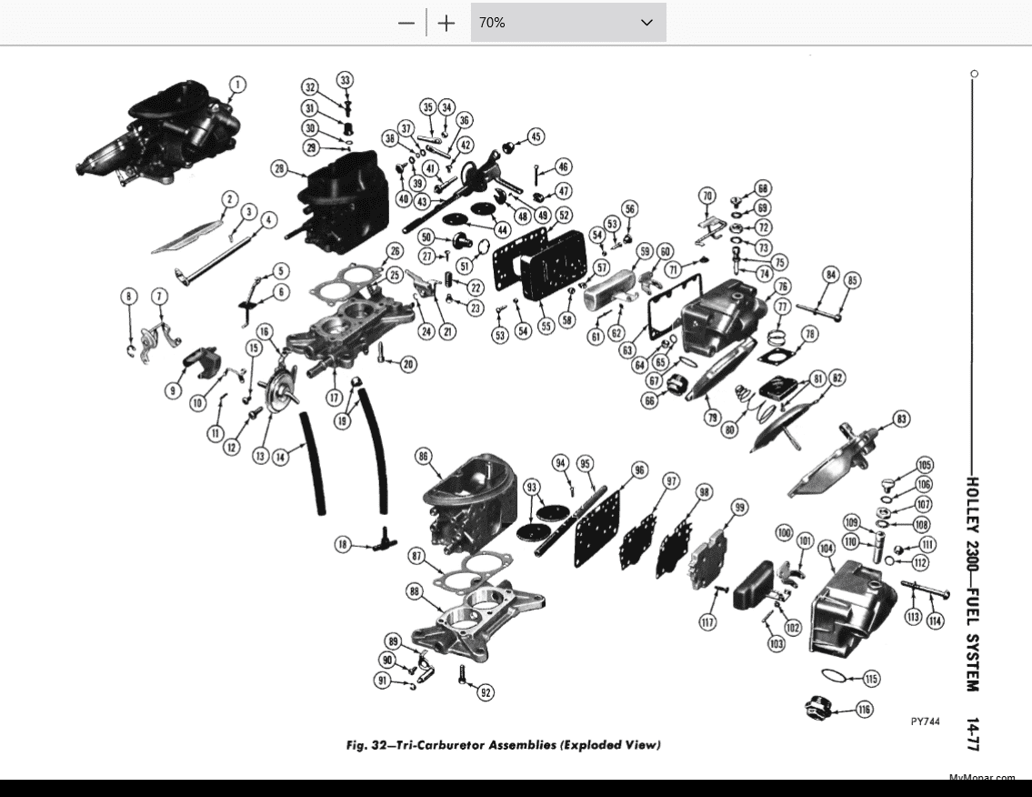

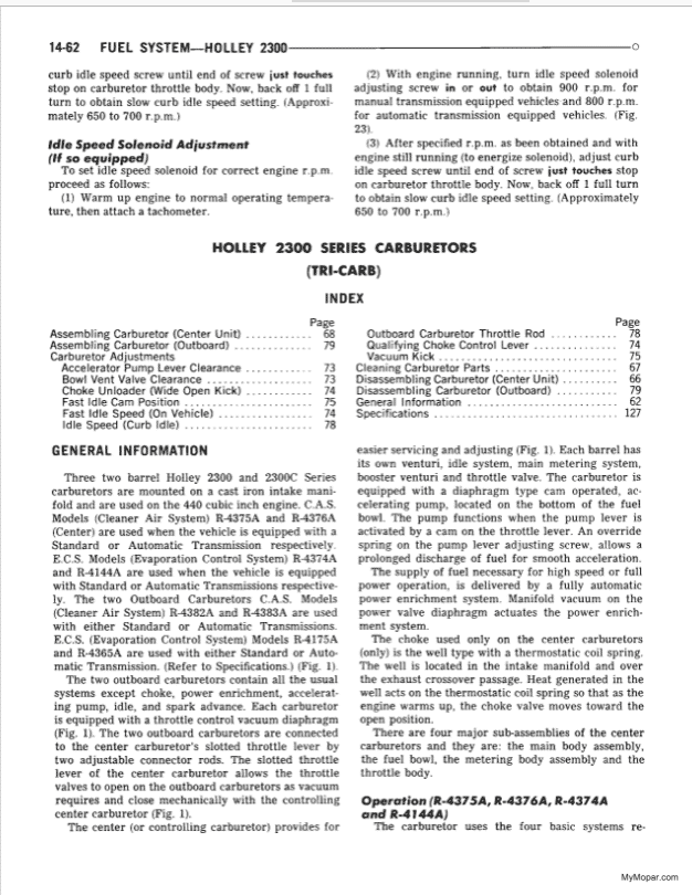

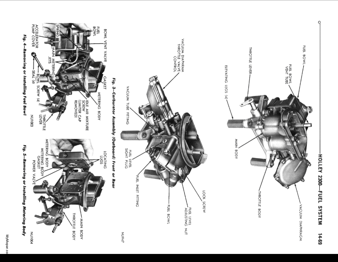

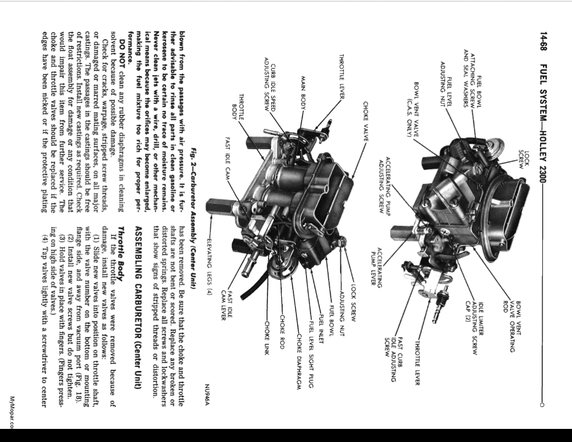

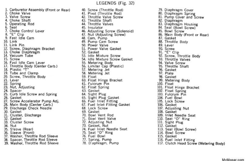

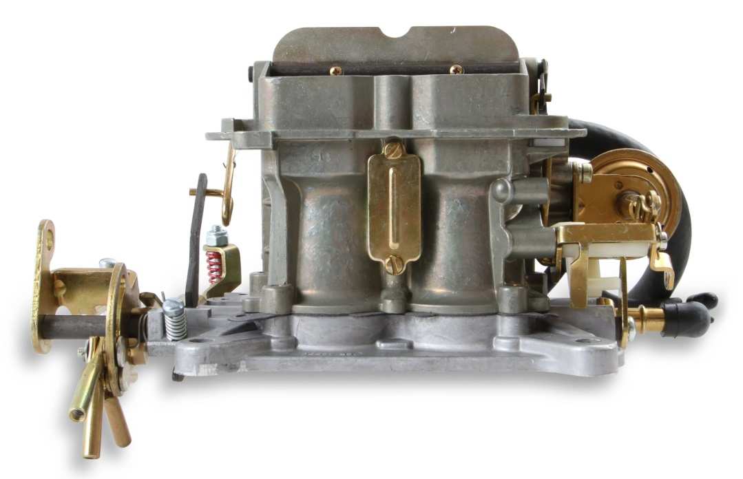

Thanks Challenger RTA. Very useful info. I may have missed it but can't see any ref. to the little plate that is on my centre carb which is a 4144 -see pic from the Holley website. Can't see it in any of the illustrations. No idea what it's called or what it does. The little mechanism under the plate will fit either way up so want to be sure I've got it right.

Carbs back on and no difference. Shakes at idle - sounds great when I punch the throttle. When running (on choke) no fuel is being released above the throttle blades on all carbs at idle. When I stop the engine, disconnect the rods and look down into the manifold it is WET with gas. Confirmed again by running pump and looking down through carbs - no fuel leaks. Where is all that gas coming from ???????
