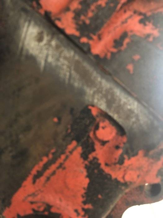

Going to sell my 340 engine. Cleaning it up. Shouldn’t the vin be stamped on block under drivers side head ?

Warranty blocks/engines don't have a vin number.

Check the machined area on the passenger side just above the oil pan rail. That's where it should be. If no stampings, then it's a warranty replacement block.

If it's a 68 block it will have a date stamp but no VIN under the LH head I think they started stamping the partial VIN on the pan rail in 69.

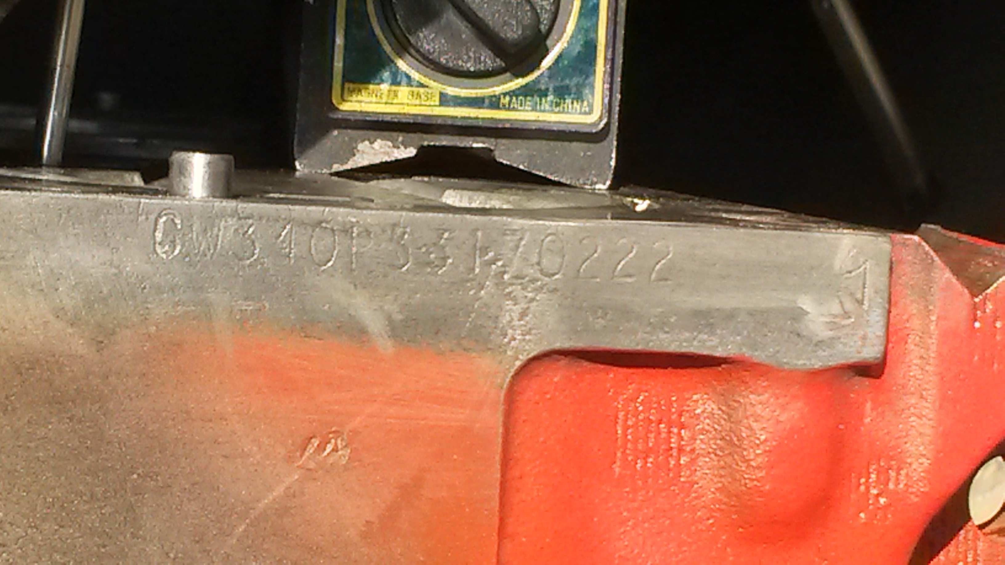

Where are you located. I have a 73 340 long block. Sourced out of New York. Cylinders require sleeving. I am a bit skeptical about sleeving all 8 cylinder bores...
