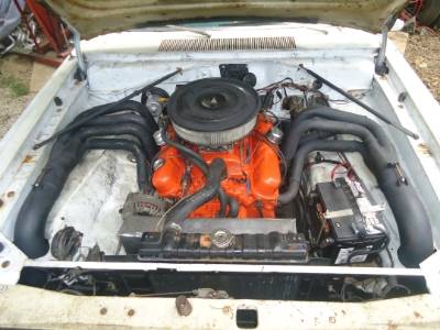

That's an awesome machine I have never seen headers installed like that.
I use the "More door" for a mobile dyno.
design makes the headers easier to remove in less than 15 minutes, to swap engines
