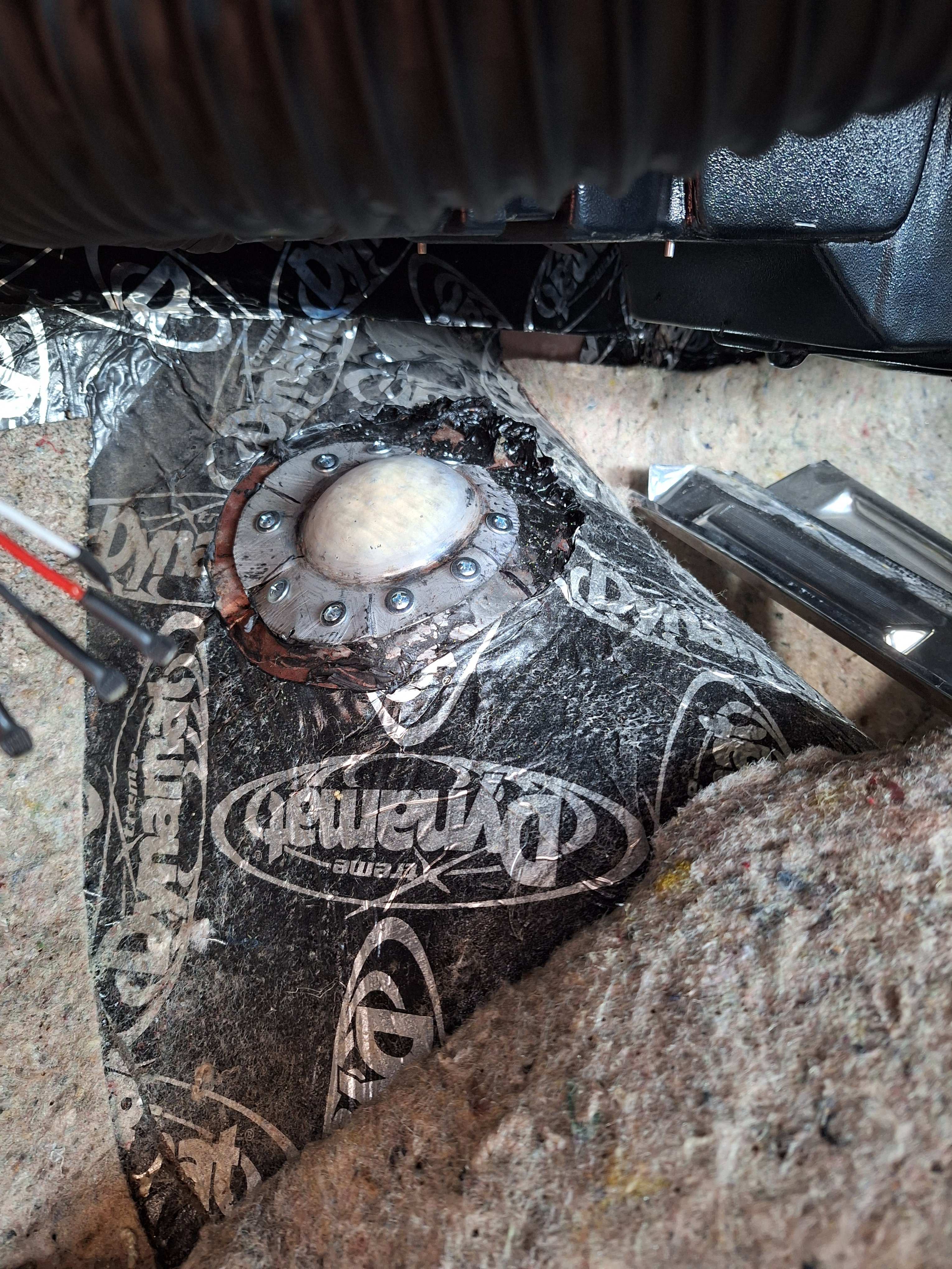

Alot of the Holley products for the Cuda swaps have been discontinued, FYI. I am using some of their products on my 392/8 spd swap and while a decent fit, I did need to make a relief cut in my tunnel and then make a cover for the 8 spd to fit. Thier engine mounts put the vent tube for the trans right on the firewall/tunnel seam and I could not "beat" it in enough. No biggie and minimal cutting of the tunnel. I believe the US Cartool mounts will allow you to move the motor fwd a bit more and not have that issue.
