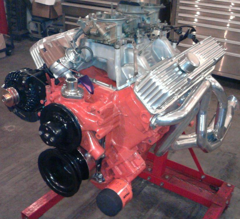

This is mine... Built with a lot of advice from Chryco Psycho.
P.S. Don't look at my oil filter, it's going in the trash. I bought a couple of WIX filters for it.
