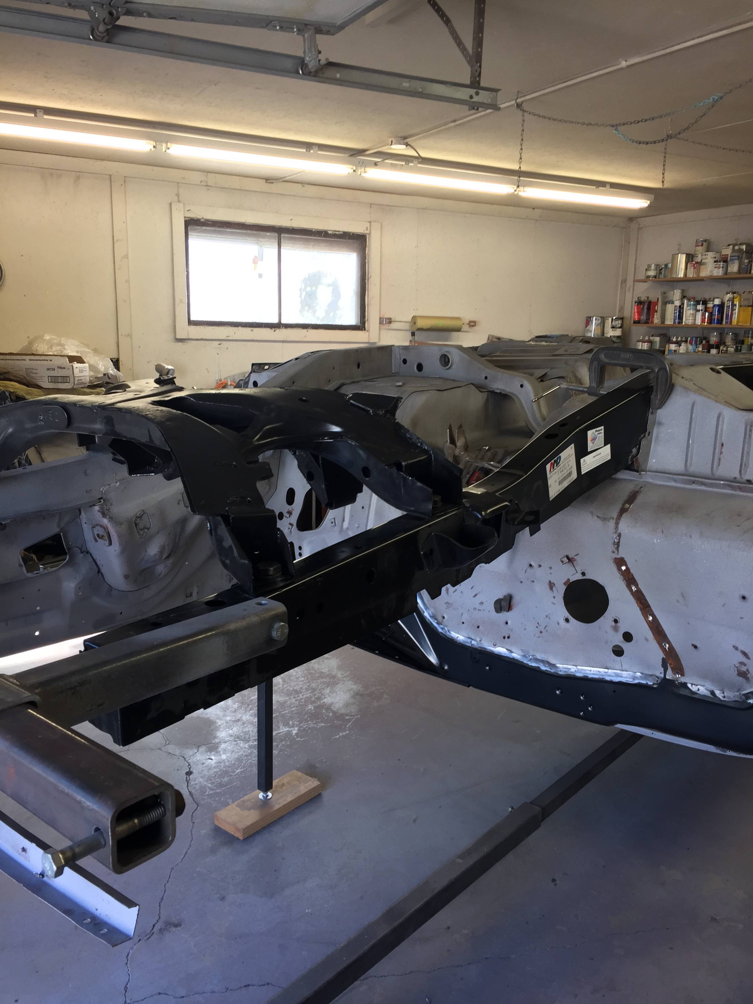

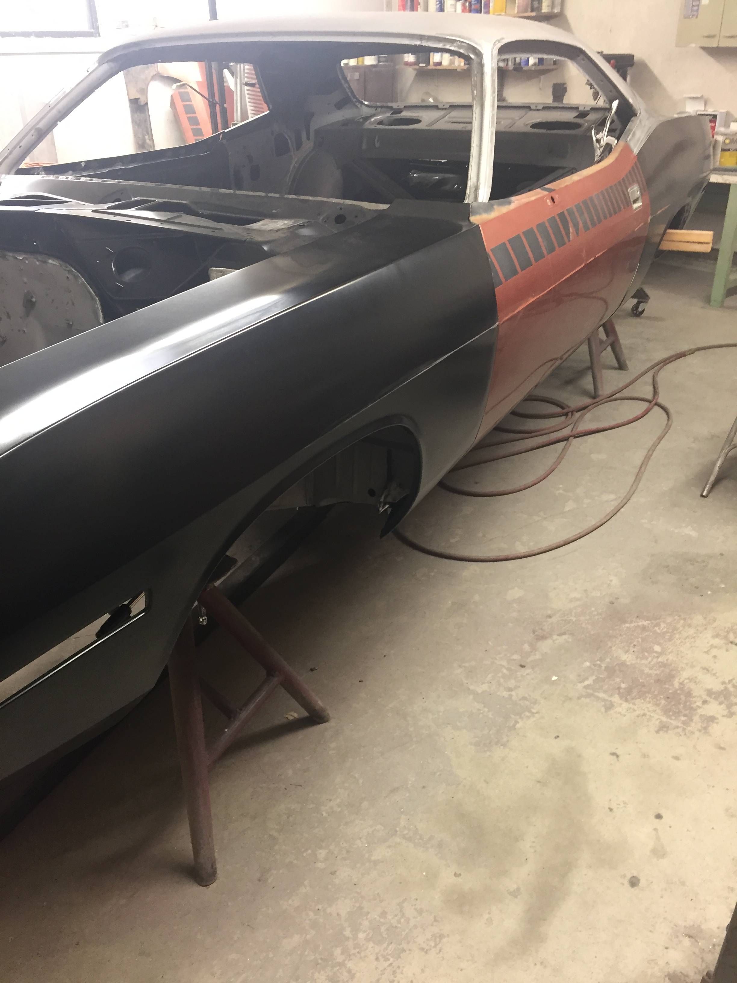

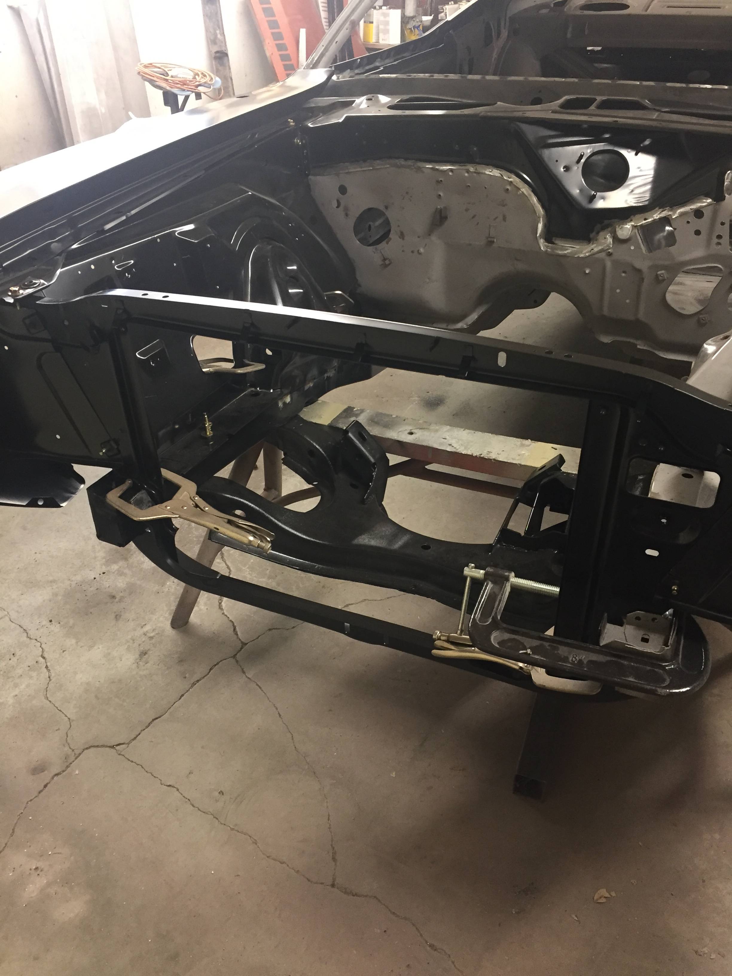

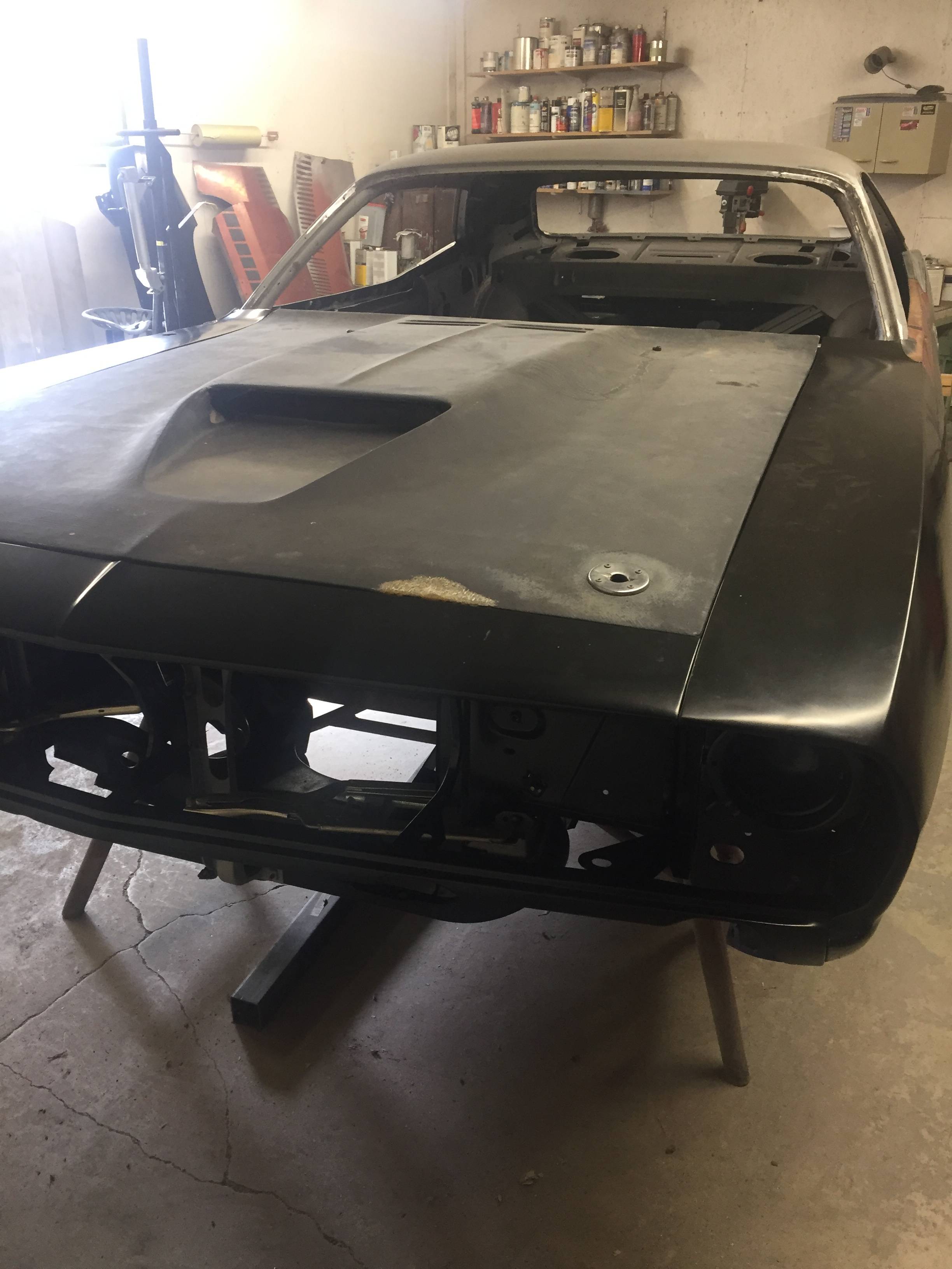

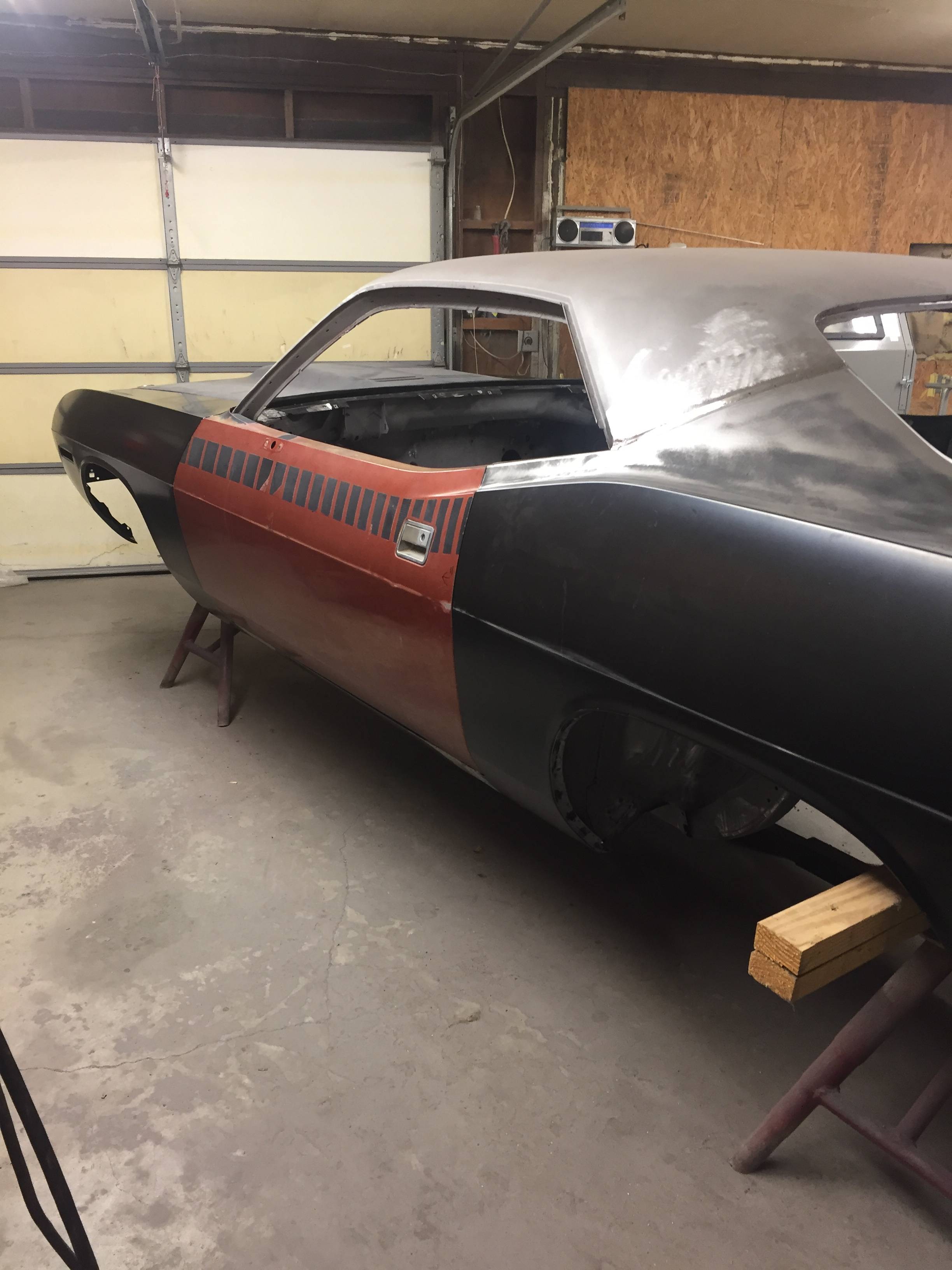

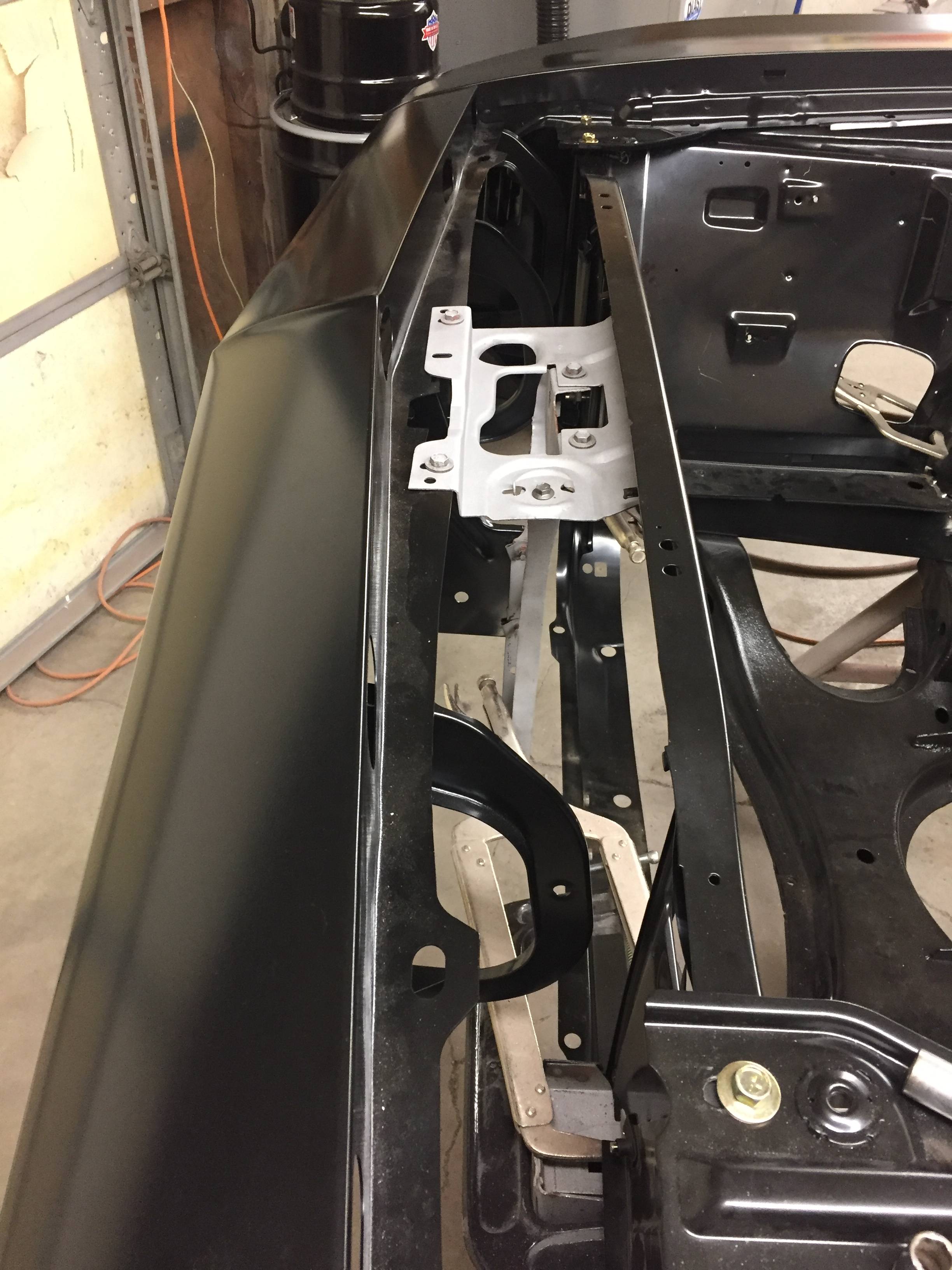

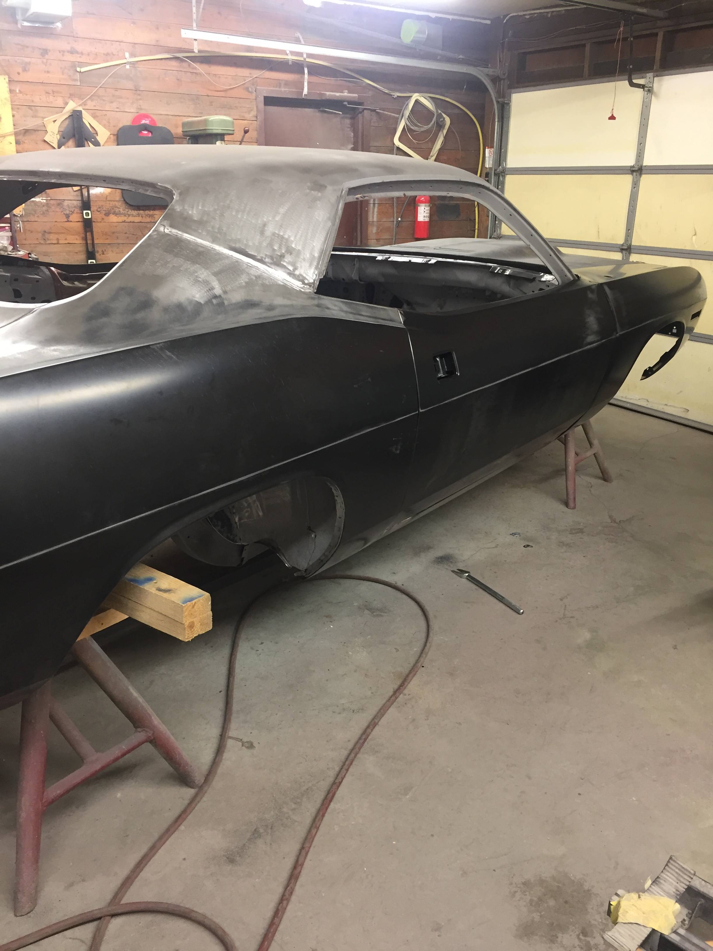

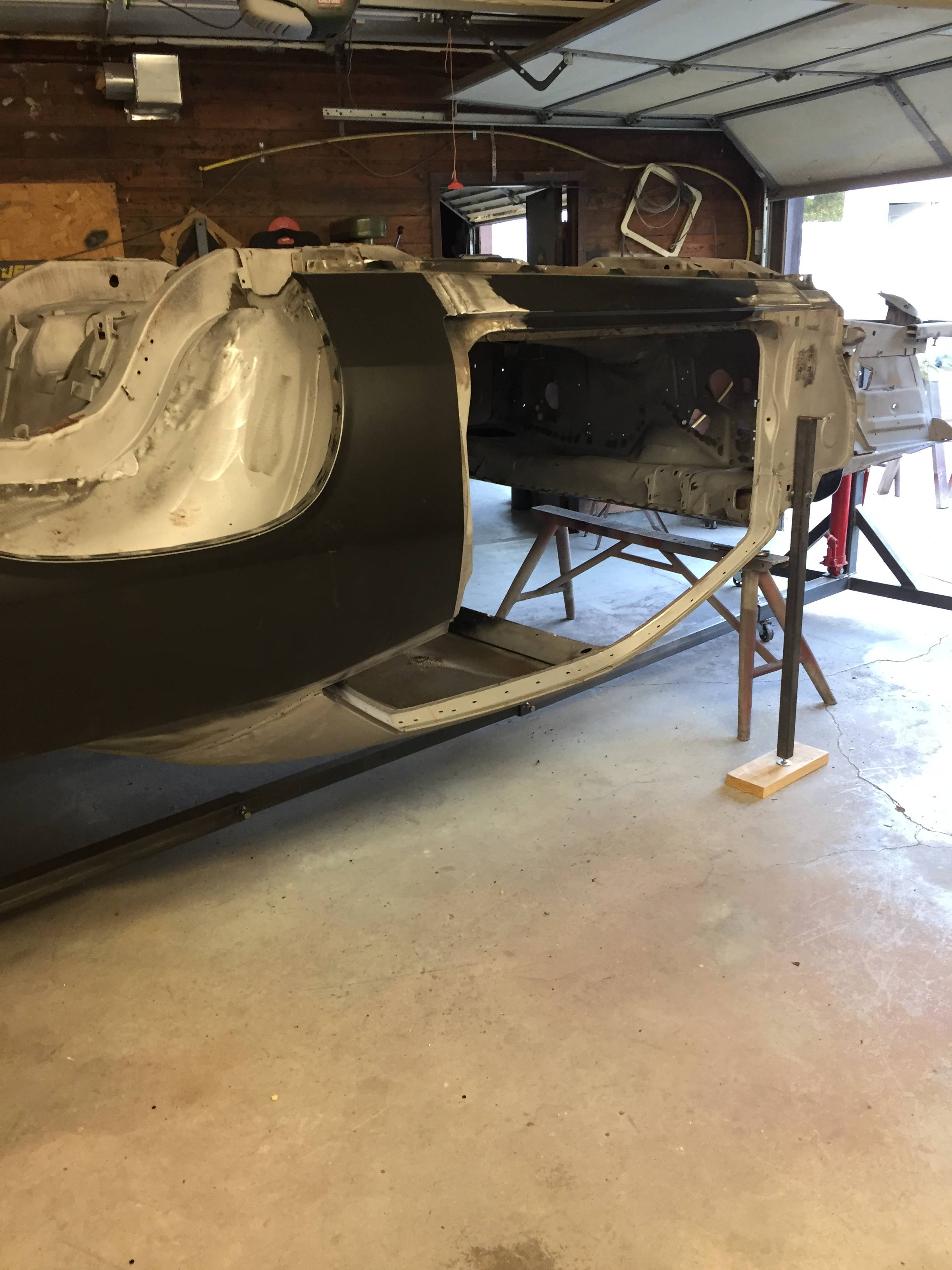

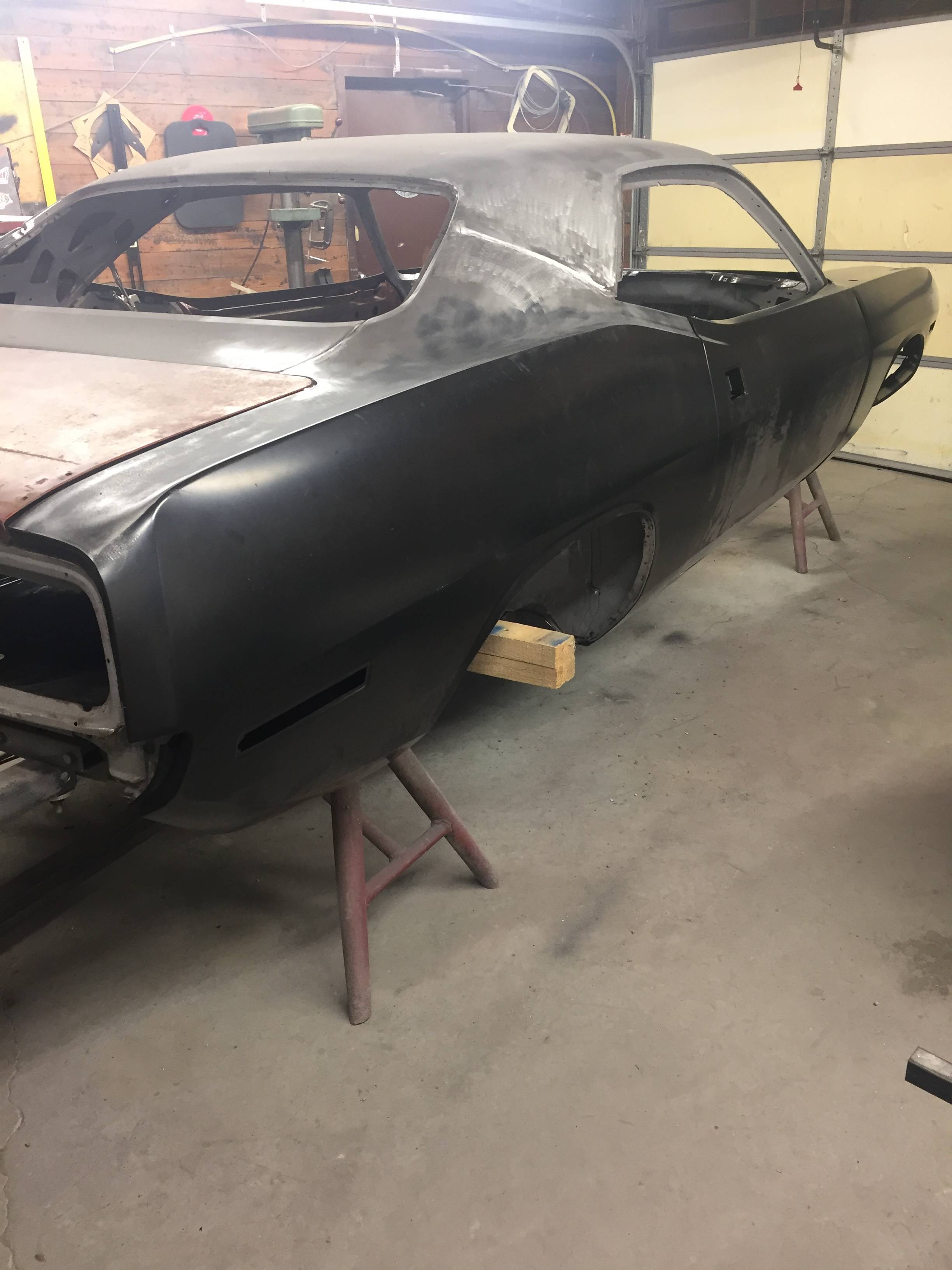

Thanks it takes me awhile to update, lots to do. As you guys know the fitting is very time consuming. Wouldn't have been bad if it would not have had so much structural damage. Building supports to keep stuff from moving while it's on the rottisuere I had to devise some pretty goofy looking stuff. lolBeen following your thread. Excellent workmanship there. All I can say is "WOW". Can't wait to see the rest. Your gonna have a really nice ride there.

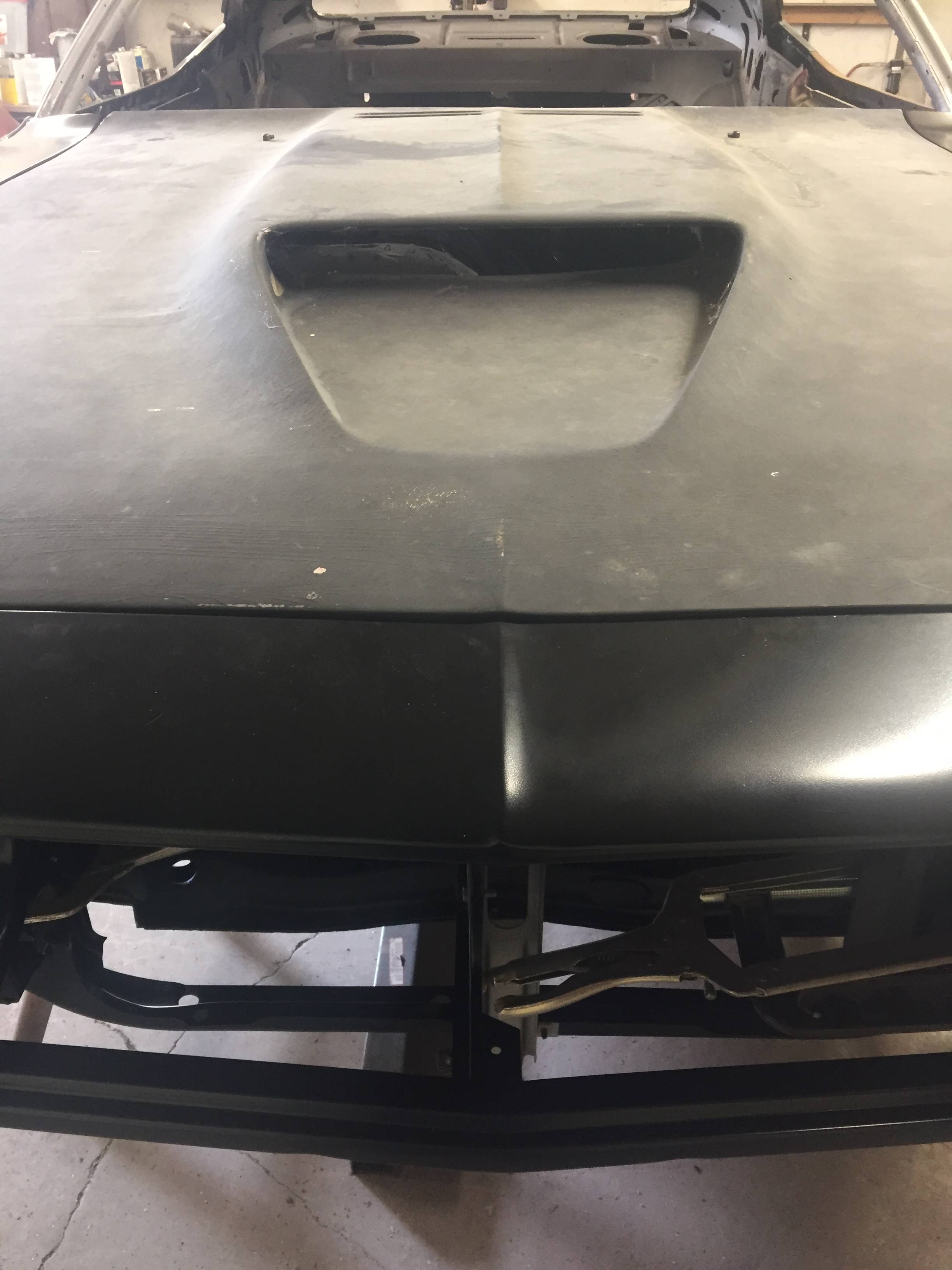

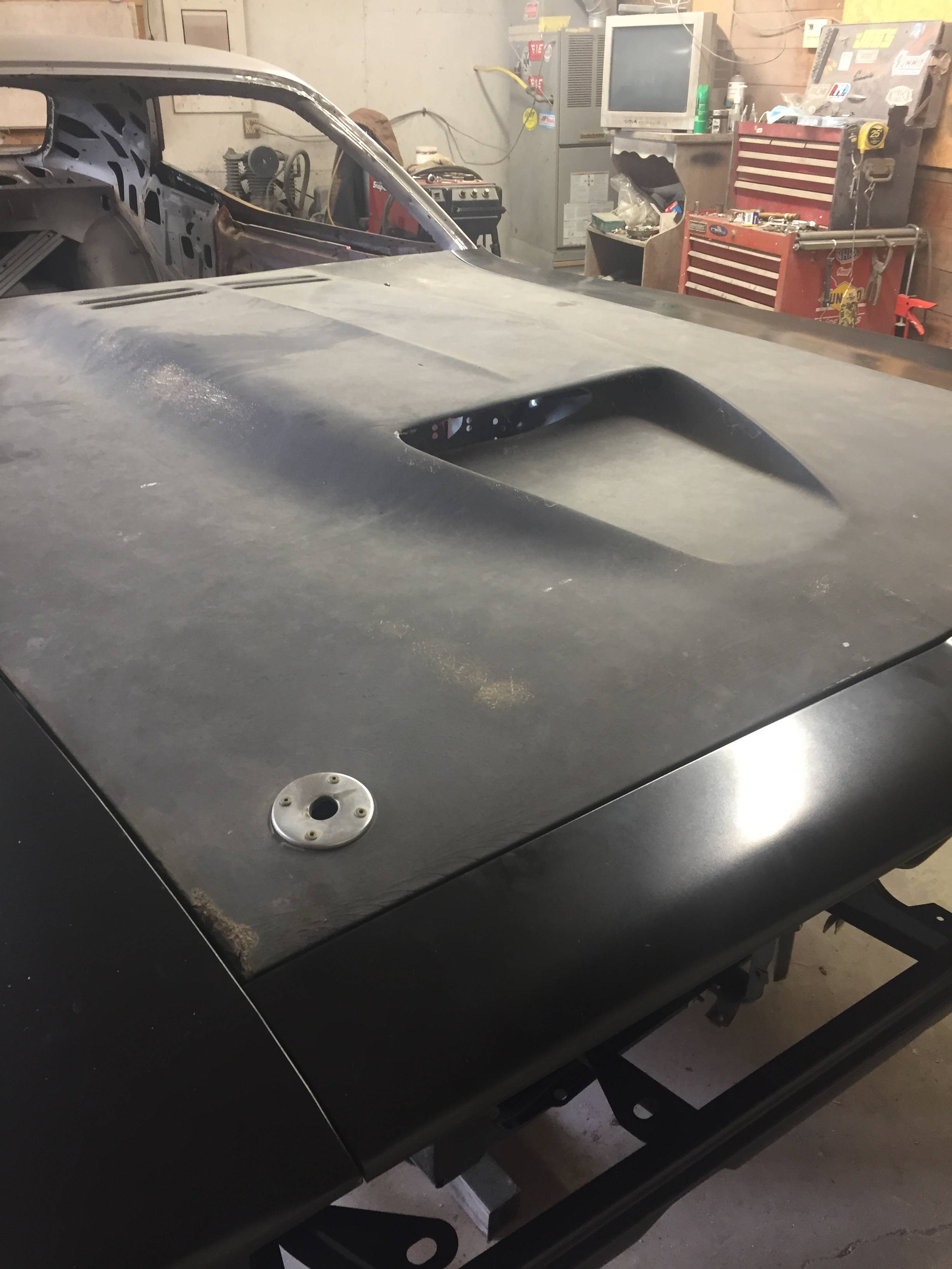

.The quarters were perfect except where they met the filler panel. Had to re-do the curve around the front corners where the trunk lid met the filler panel. No biggie. Rockers were pretty good. I was pretty pleased with the quarters. Cowl piece was excellent. I bought the trunk pan in one piece thinking I could wrangle it in there. No way so I split it in half under the right gas tank bracket, so that hid the seam. At least on the bottom. Right door skin was ok. Left front fender fits ok. Right fender not so good. They welded the fender together wrong in the headlight panel area. The top header fit fine between the fenders but the lower grille section lacked 1 inch of going between the fenders. Because of the headlight bucket area being welded in wrong. Right headlamp was shooting off to the right and pretty messed up. AMD said ok after I sent them picyures of it.I am waiting on another fender to arrive now. Overall AMD stuff seems very good. I have not gotten in to the final fitting completely yet. I may have to do some cutting and welding to finalize everything. Won't know till I have the new fender and get further along.Very nice fab work.
How is the fitment on all that new sheet metal? Did you have to do very much cutting and re-welding?
