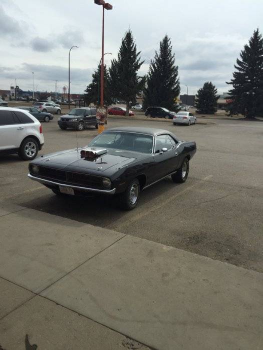

I don't know what I did loading the pics below, just meant to upload the two, none the less, there is my 70 Barracuda...she turns allot of heads here up in Medicine Hat, Alberta, Canada. Arrivederci!
