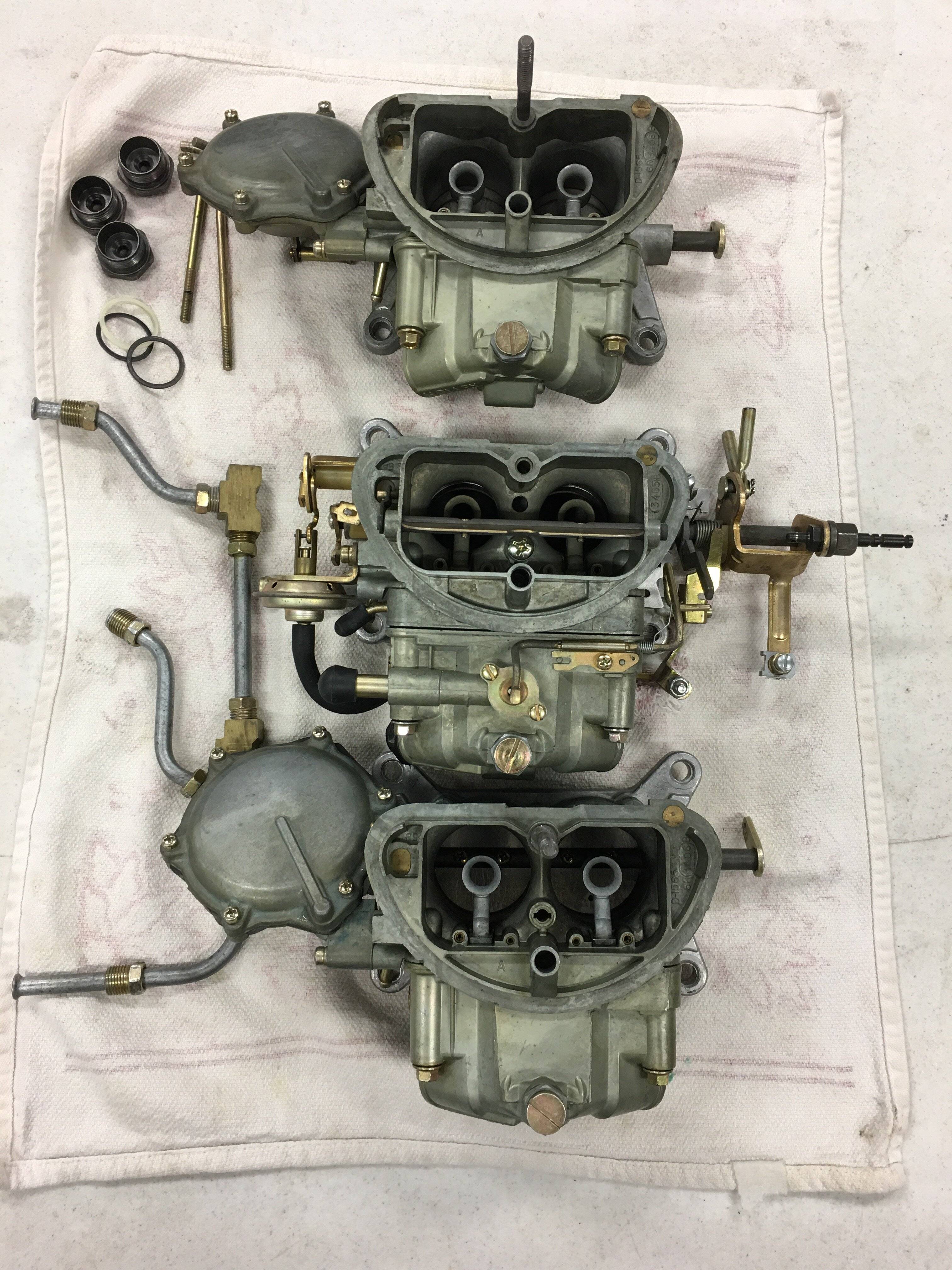

It was frustrating, I believe the main issue was the metering block. I'll post a picture of it if I can get the right resolution, I think the person I worked with at Holley just sent me the wrong part. Too many things did not look right, it would be interesting to get other opinions on the possible application. I put in stock sized jets and a power valve in the old metering block and all is well. It's not the end-state because I want the vacuum advance back, but it runs better than it did before and the valvetrain is quiet.
