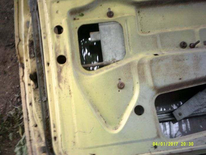

i found the 2 front ones they are phillips head screws that screw into the nylon snaps,... but the rear one is obv a bolt of some kind.. also was there a plastic/fiber like washer between regulator lower arm and glass? i know there was a small rubber insulator inside it ito make sure glass cannot hit the mounting bolt edge... so anyone have an idea on what parts i need? ...pics? thanks
SEE PIC..round hole at lower end rear of regulator is the access hole for the bolt/? i need..

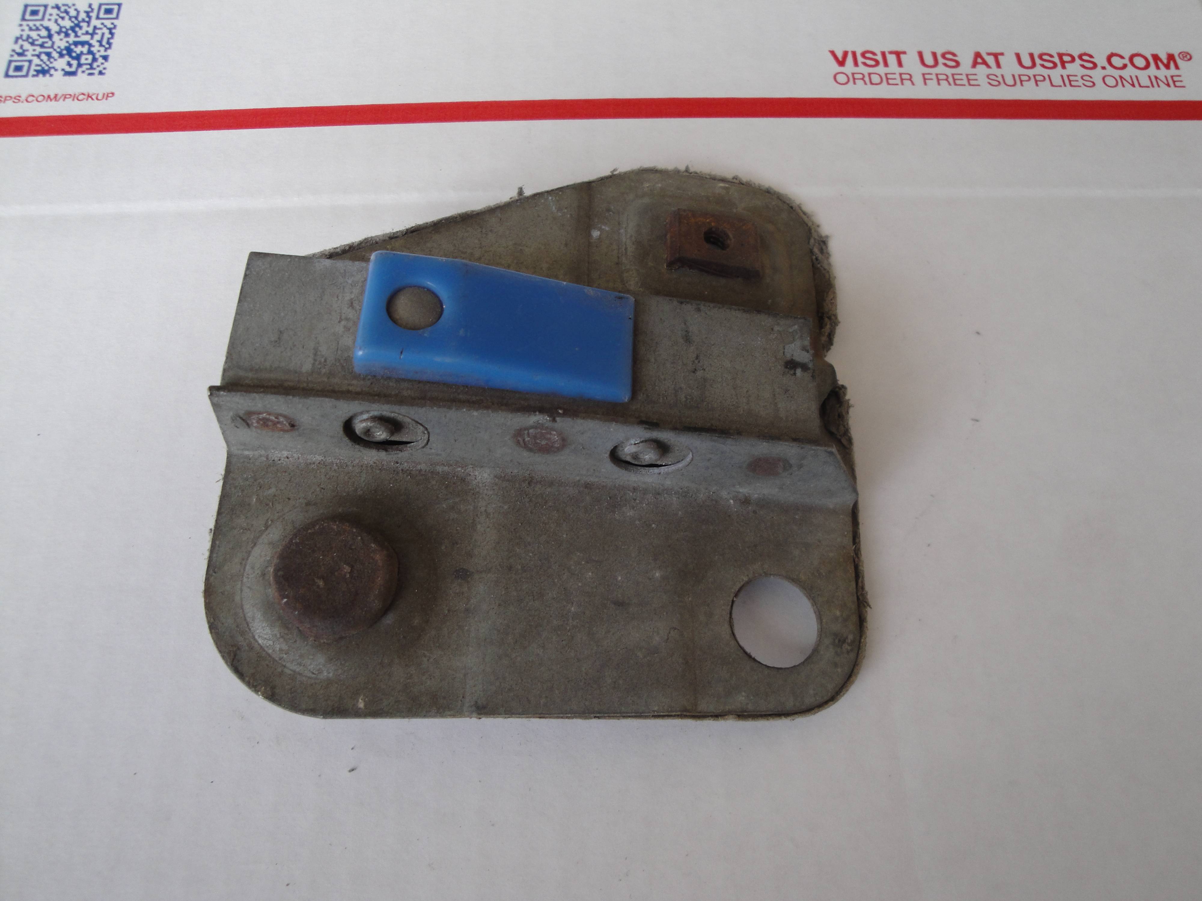

It's been several months since I put my new glass in, but do you have the slides (pictured) I think that's what your after ?

found one original washer sitting inside drivers door... just sude a thicker washer on other side to matc....hjust used 2 bolts that fit and had a washer that was able to go inside lower track... glass is in!
