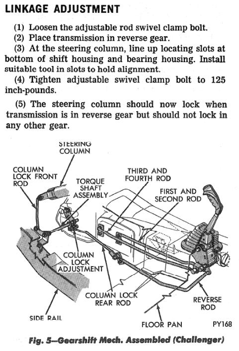

When you put the car in reverse (4 speed on floor), the column turns to lock it and take out the key. How do you adjust it so it dosent slide out if reverse?
Everything works except even after I take out the key, if I move the shifter, it will still come out of reverse. Seems like an adjustment issue.

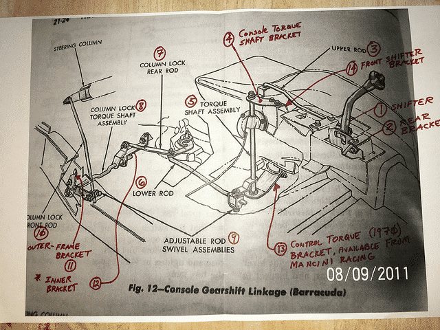

Do you have this rod on your column? 16 This is automatic.
Standard below.

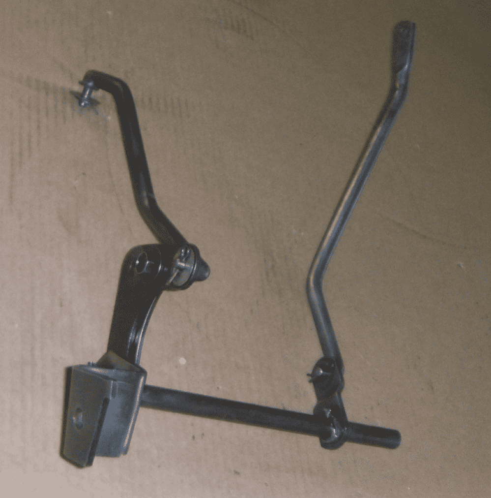

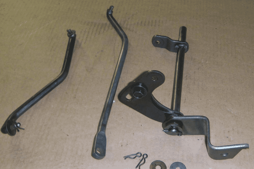

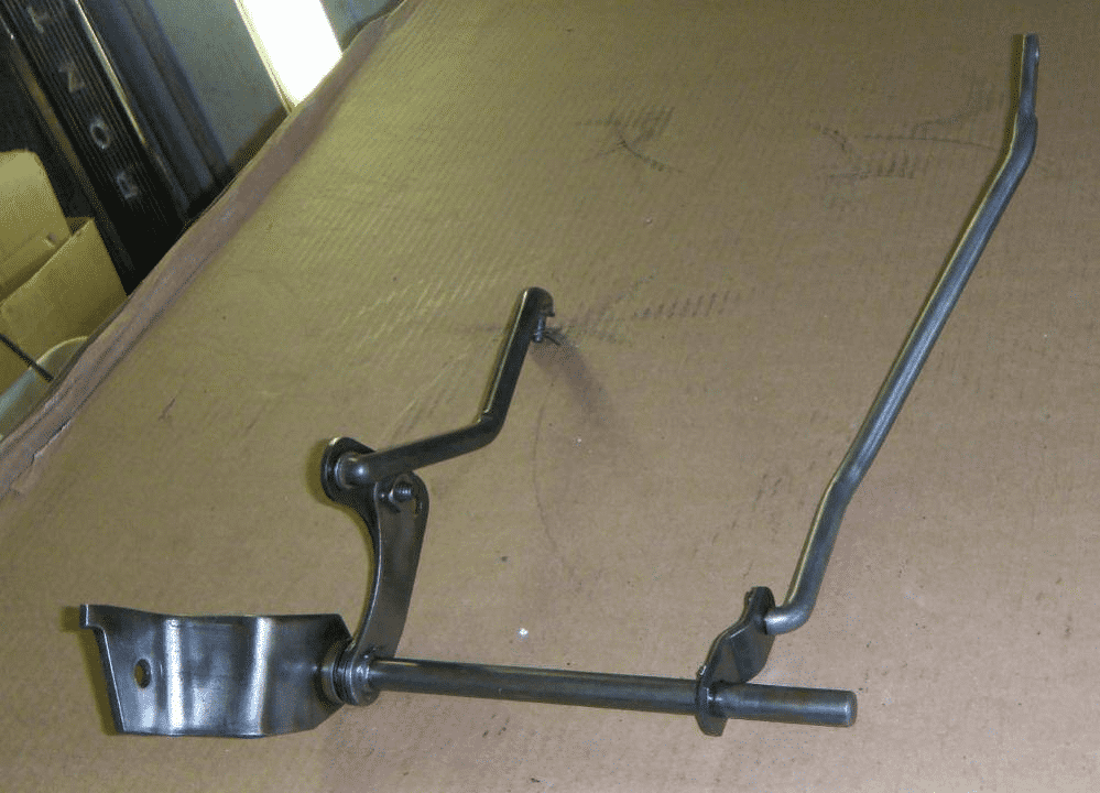

Found this when trying to find out that I am missing, ended up being the "Column Lock Rear Rod"
