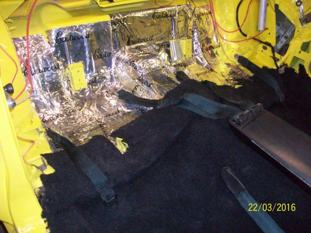

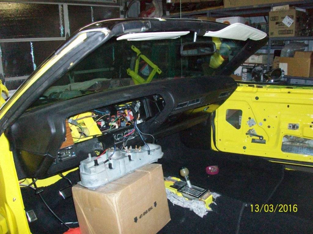

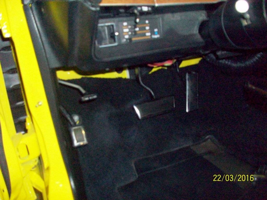

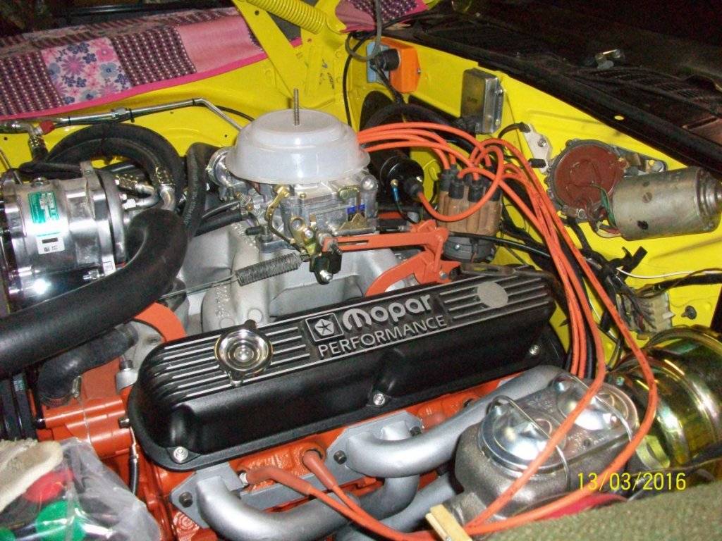

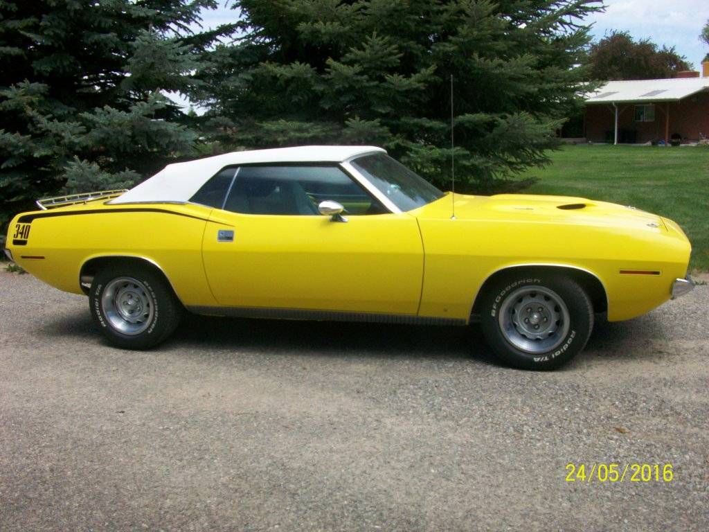

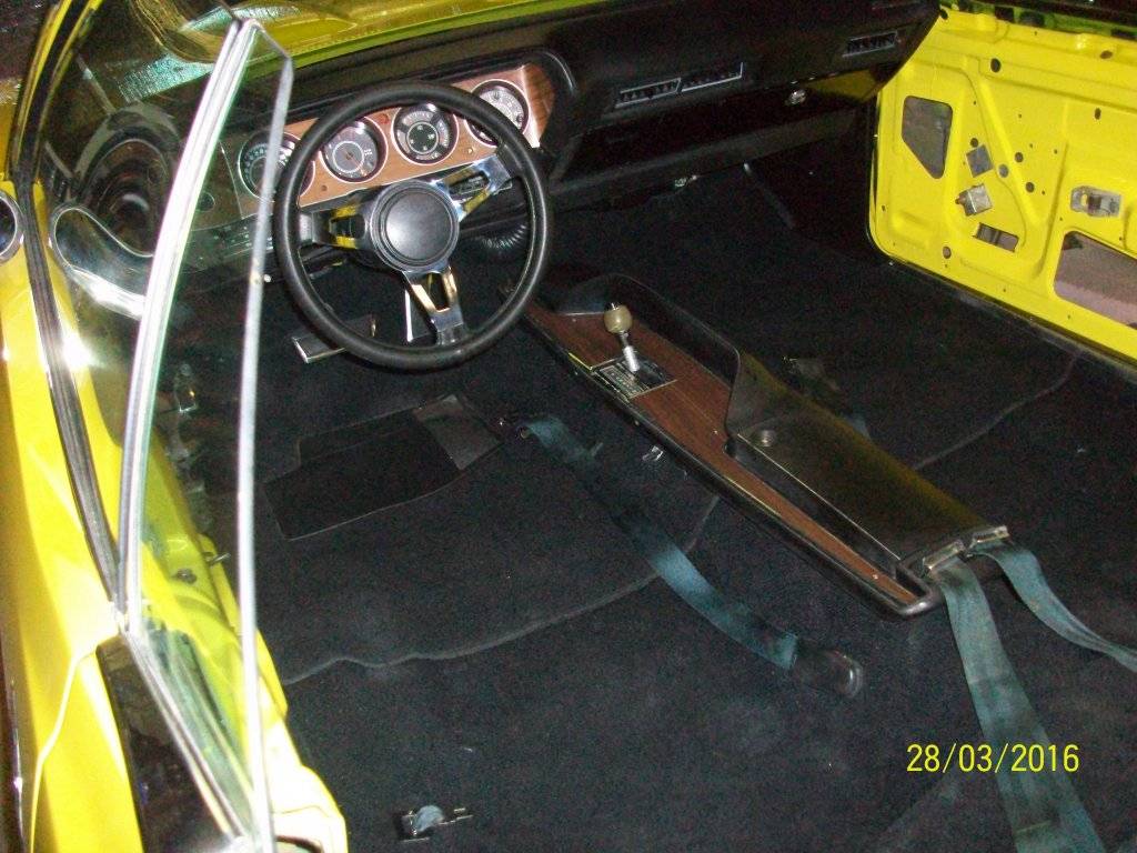

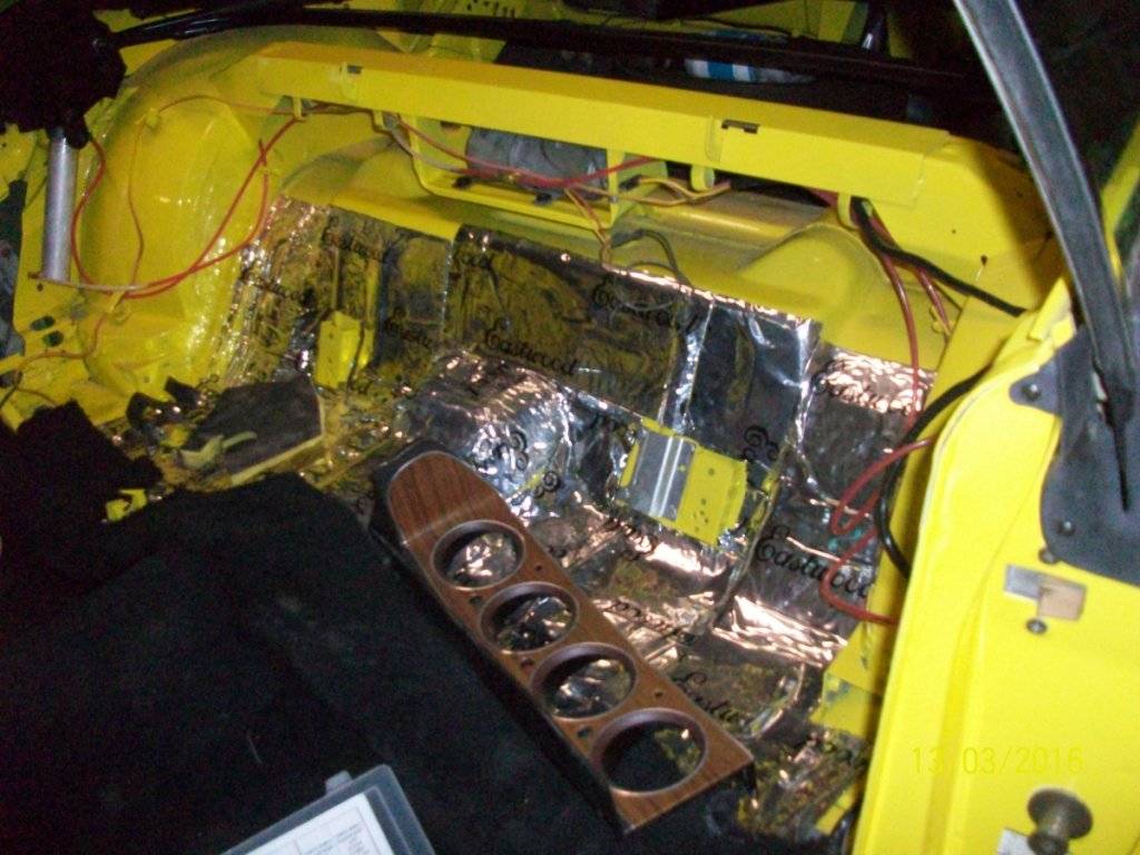

Been a while got more done. Not going to make Vegas though. Windshield and trim in. Dash wiring is down to the main cluster. Vintage air tubes made this a real headache. Sound proofing and heat shield matt in. Seat belts cleaned and ready to go in. Carb linkage modified for the air gap intake. one side of the exhaust is on. will need to go to a shop for the welding and head pipes. top motor primed and working.

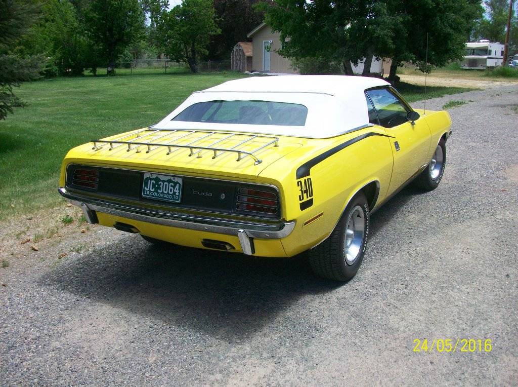

I started out with a well optioned 1970 Barracuda convertible. Painted with optional High impact Lemon twist paint originally with a white power top and white interior, 318 V8, 904 console shift automatic, bucket seats, factory air, luggage rack, dual painted mirrors. Car came with a set of 15” rally’s on the back and 14” rally’s on the front. Top was missing but the seats had been recovered and also came with a new black carpet in a box. It also had a new gas tank and sending unit but the gauge still did not work. An 8¼” open differential rear end. It had the original flat hood on it but came with a sassy grass dual scoop Cuda hood that was set up for hood pins. The fender tag, dash tag and build sheet were all still with the car, although the build sheet was in rough condition.
Drive train: Motor: All new hoses, plug wires, water pump, fuel pump, freeze plugs and filters. The newly rebuilt 1970 340 Engine with a casting date of: 7/7/69 was cleaned and honed, there was no ridge in the bores so it remained Standard Bore 4.040 and will be running Factory OEM 10.5:1 Pistons with NOS MP Moly Rings on OEM 1970 Bushed Rods. New Clevite Cam, Rod and Main bearings and a Stock steel crank which also remained Standard/Standard. Camshaft is a Summit Cam #SUM-1708 .480/.480 Lift Hyd. Cam & Lifters. Heads are rebuilt “X” heads with OEM 340 HP Springs, Proform #66869 1.50 ratio roller rockers, and a set of black Mopar Performance aluminum valve covers. Installed a factory 90 degree oil filter mount. Oiling will be done by a Melling HV/Oil pump & pickup and aided by the factory windage tray. Intake gases will be run thru a Mopar performance 1970 style unsilenced air cleaner with new 340 pie tin to a Edelbrock Performer1406 carburetor (650 CFM , electric Choke) sitting atop an Edelbrock Air Gap Intake. The exhaust system will consist of a set of Headers running thru an all new stock exhaust system of mufflers, heat shields, piping, hangers, resonators and tips out a new dual cutout valance. Spark will be from a standard post 1972 Mopar electronic ignition system.

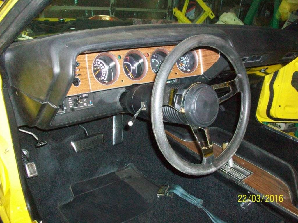

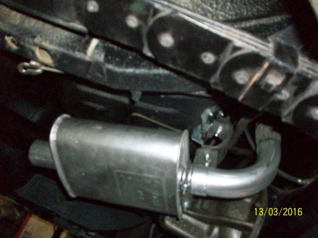

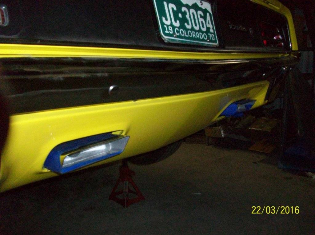

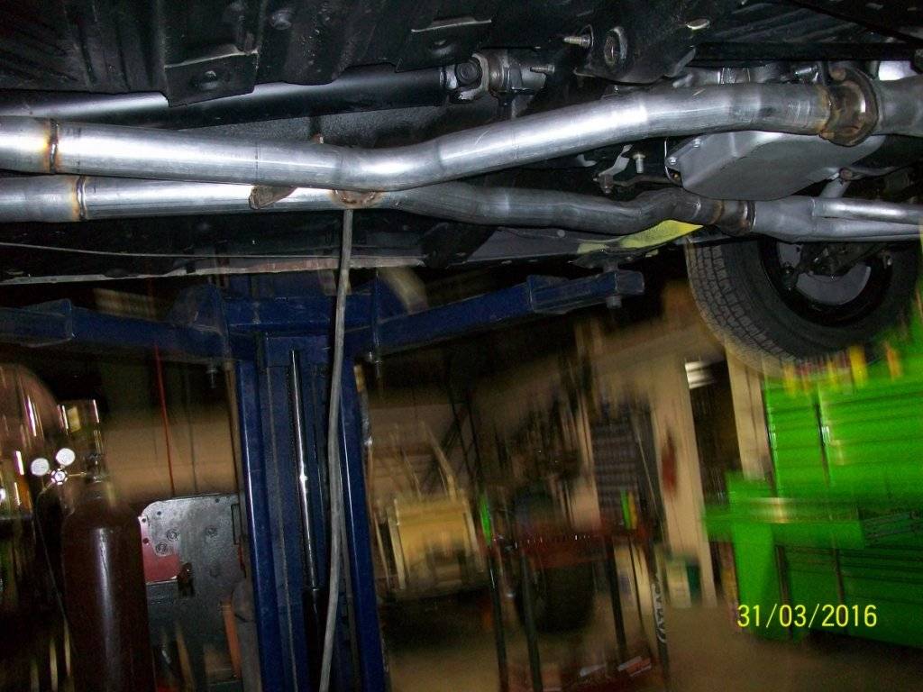

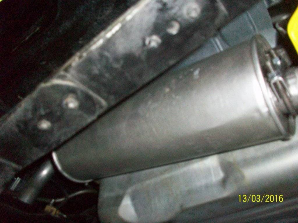

Dash is in, console repaired and in, seatbelts cleaned and in. Rear part of the exhaust hung. Steering column restored and installed. Dash and steering wheel still need detailed after the install hand prints on everything. I guess tomorrow will be cleanup and electric system check day. Fingers crossed there are no big issues. Going to try and get some help getting the hockey sticks and hood back on this week as well. Appt made for muffler head pipes and steering wheel lock cut and weld due to headers next Wed. Then its Time to add fluids and light the thing up next week. Leaving only one big ticket item I need to have done the top installation. I'm beginning to see some top down big ass grin crusin in my future!

After 4 times in and out with the gauges last week I was beginning to wonder. Especially the third time when I looked down and saw the light tubes laying on the floor board.

Off to the exhaust shop tomorrow. Then its time to see if it will make that sweet noise.

Started the car last night for the first time. No leaks but didn't run it long the high temp header paint I used is blistering and coming off so it smoked up the garage. It was all ready dark so it will have to wait till this weekend when I can roll it outside and run it and burn the rest of the paint off the headers. Will need to reset the valves now that the lifters are pumped up too.

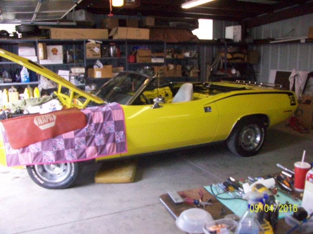

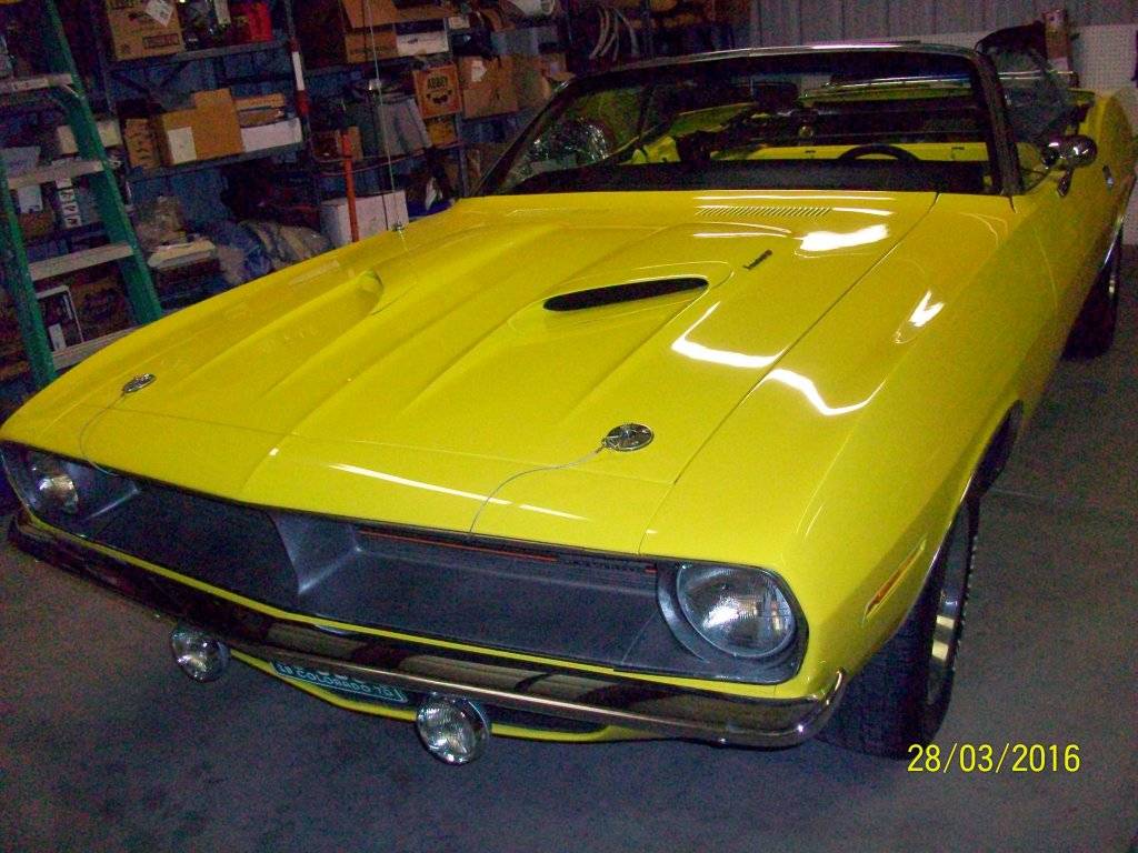

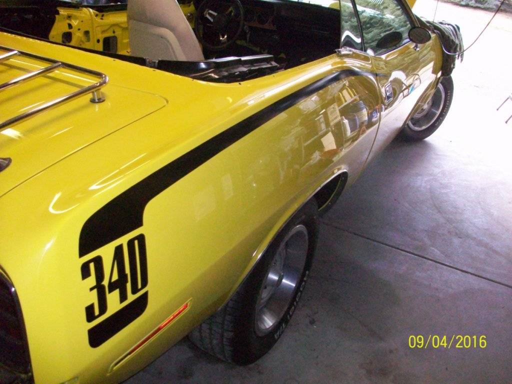

Got the hockey stick stripes on. Ran the valves again, not a fun deal with that cheese cutter fan I've got on there. looks like the dash is going to have to come apart again. Doesn't look like my voltage limiter is any good gauges stay pegged. Also got the brake and one turn signal light mixed up. Clock is working but the hour hand needs reset to match up with the minute hand. appears to be about 20 minutes off. I guess when you do this once every 15 years you lose a little bit knowledge and skills. Motor is sounding real good though and a friend is coming over this evening to give it a fine tune. Got the fluids topped off and set up an appointment for an alignment later this week. Put a deposit down at the upholstry shop so they would order the top and get me in the schedule. all in all a productive but frustrating week.
