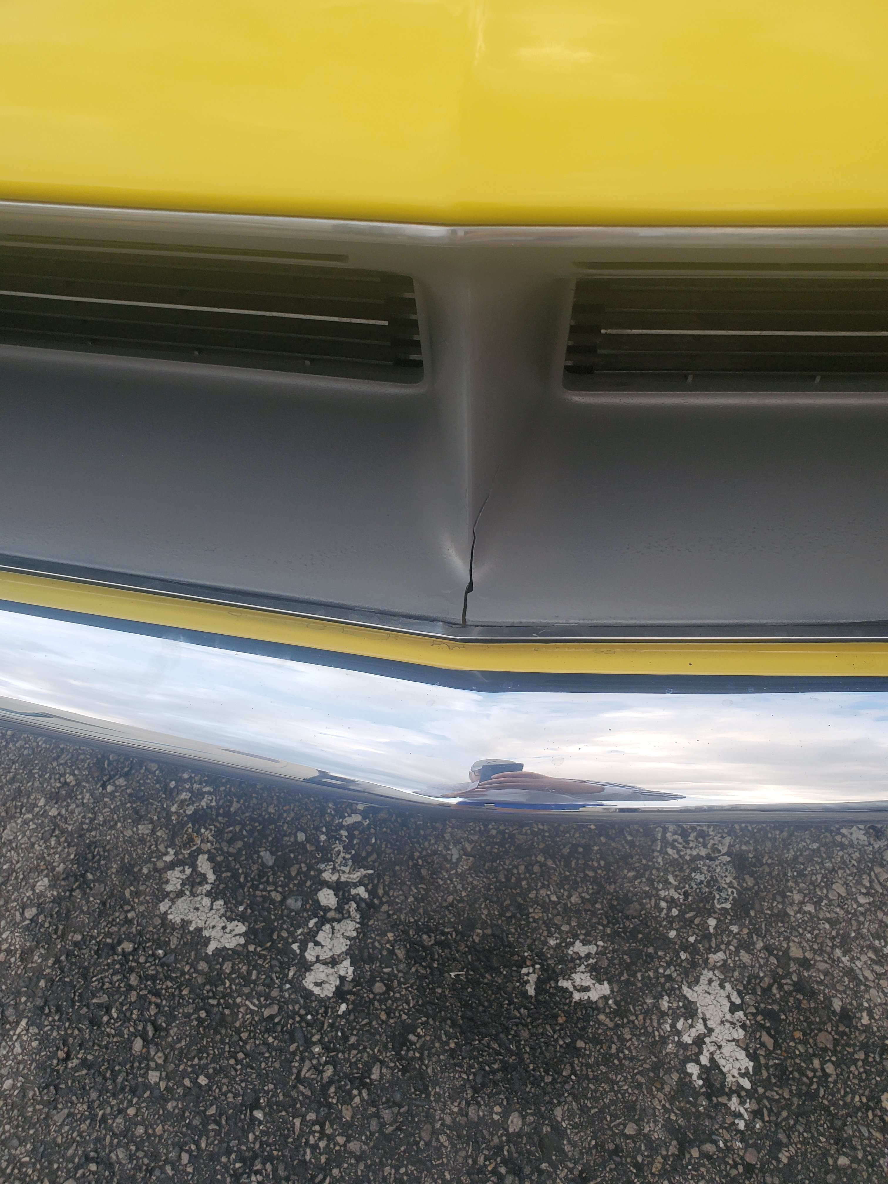

Want to paint it black but has a crack in it any opinions on fixing this .

My grille was cracked also, but in different spots than yours. I used JB weld for plastic and it worked awesome, super strong. I used the JB weld from behind, because it's black. If you want to repaint the grille the factory color go to this site MOPAR Automotive Restoration Paint . I used the grille paint for my grille and it came out nice.
