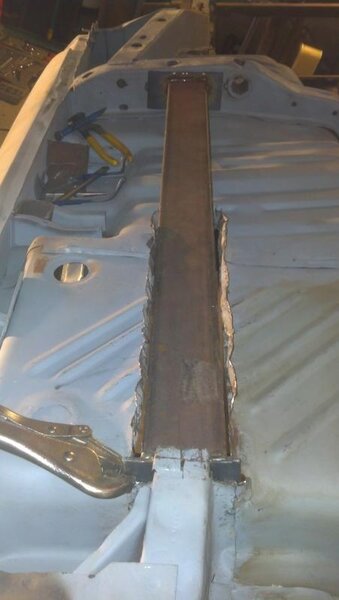

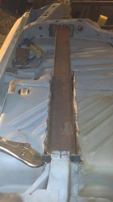

I made mine out of some 1x3 tubing. Cut into the rear floor. I flanged and welded where I cut in to to floor add a little more stiffness. Only sticks into the cabin area 1/2".013.jpg605.jpg011.jpg
