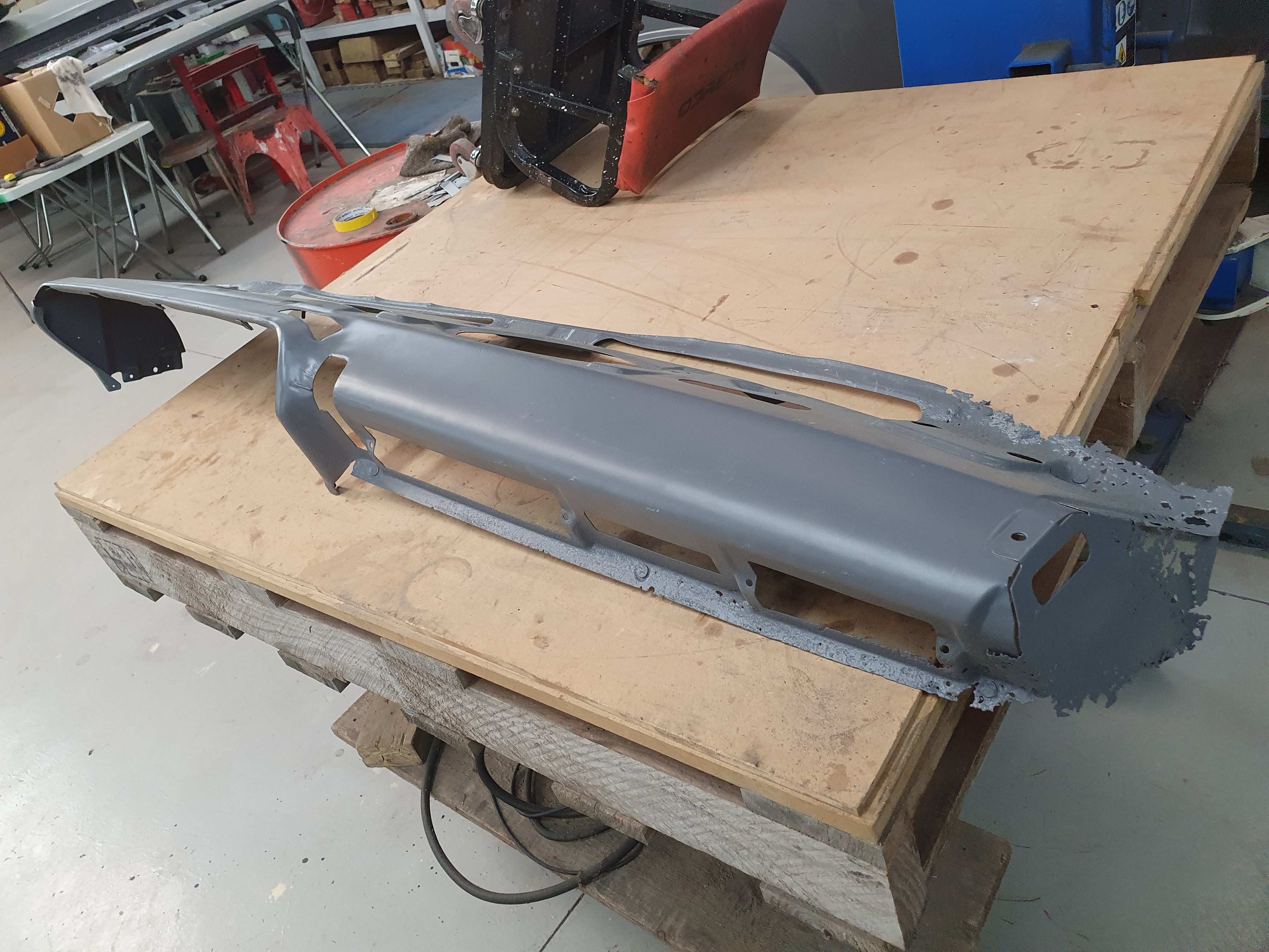

Thanks for that! Just to confirm...... the replacement OEM crash pads you can buy (e.g. Classic # ME5518100 @ $686US) is formed on a separate steel frame and I'd still need to repair or replace my rusted subframe as shown in photo..... OR does the replacement crash pad come formed on this frame so if I got one of those, I wouldn't have to fix mine and could simply throw it away?

What is that from, pretty sure it's not for an E-Body
*** Edit: Thought that was the frame that the dash attaches to, after a 2nd look, you've stripped all the padding off the dash core.
Yes, a new dash would come with the metal core. I didn't look up the PN.
Pulled it out of my 70 Challenger, virtually no vinyl left on it so sandblasted and 2 packed it only. I'm just not sure if I brought a replacement dash pad if it comes molded on this frame, or if I have to repair this as well (will be a pain as it's tricky shapes & can't find any patch panels)

To be clear, those pads through Classic for $700 will NOT have a metal core.
That metal piece shown in your pic will be plastic (ABS) with foam and vinyl molded over it. I wouldn't do that unless you don't plan on having the car out in the sun or heat.
I worked in the electronics industry for many years, the Japanese suppliers had a saying.
"Cheap no good, good no cheap". It's the truth in this case.
Thanks for the clarification, I just figured that out by looking at "year one" and saw they have steel frame rebuild options for $1200US using your good core.
Unfortunately, the problem being for me is I'm on the other side of the world with a bad exchange rate so I'd have to either find a good core in the US and have it shipped to them to start with, or fully restore mine (which as you can see in the photo is not very nice), then ship it to US, pay for the restore, and ship back which would be cost prohibitive.
At least with your assistance I now know what I'm dealing with!
Even though I really like to restore these muscle cars, I'm an old hot rodder so may end up doing something custom as I don't have a back seat, some internal trims, complete console, carpet or a hood lining either :)

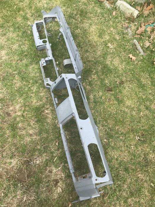

I have a nice 1974 Challenger dash frame available if needed.
