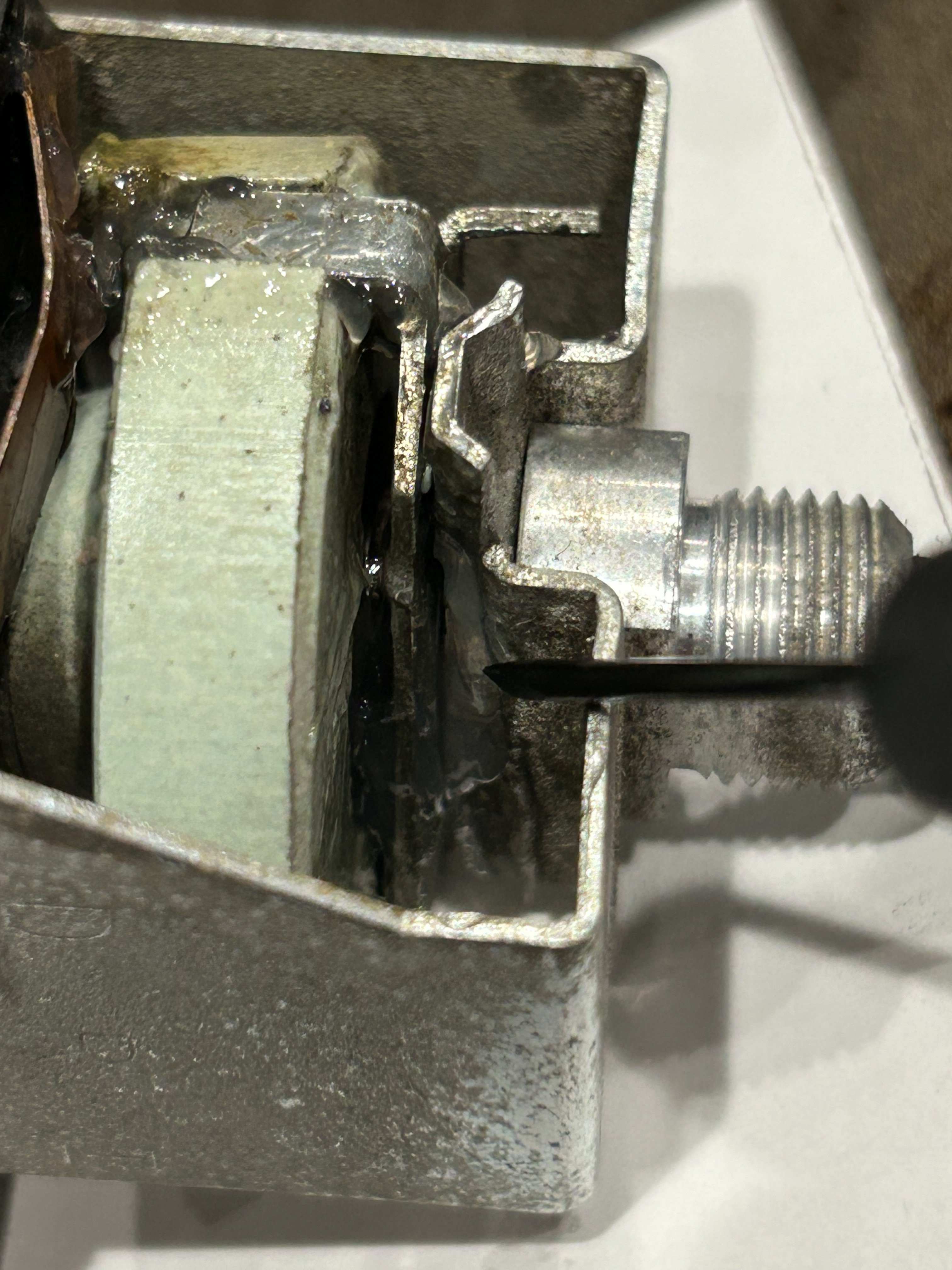

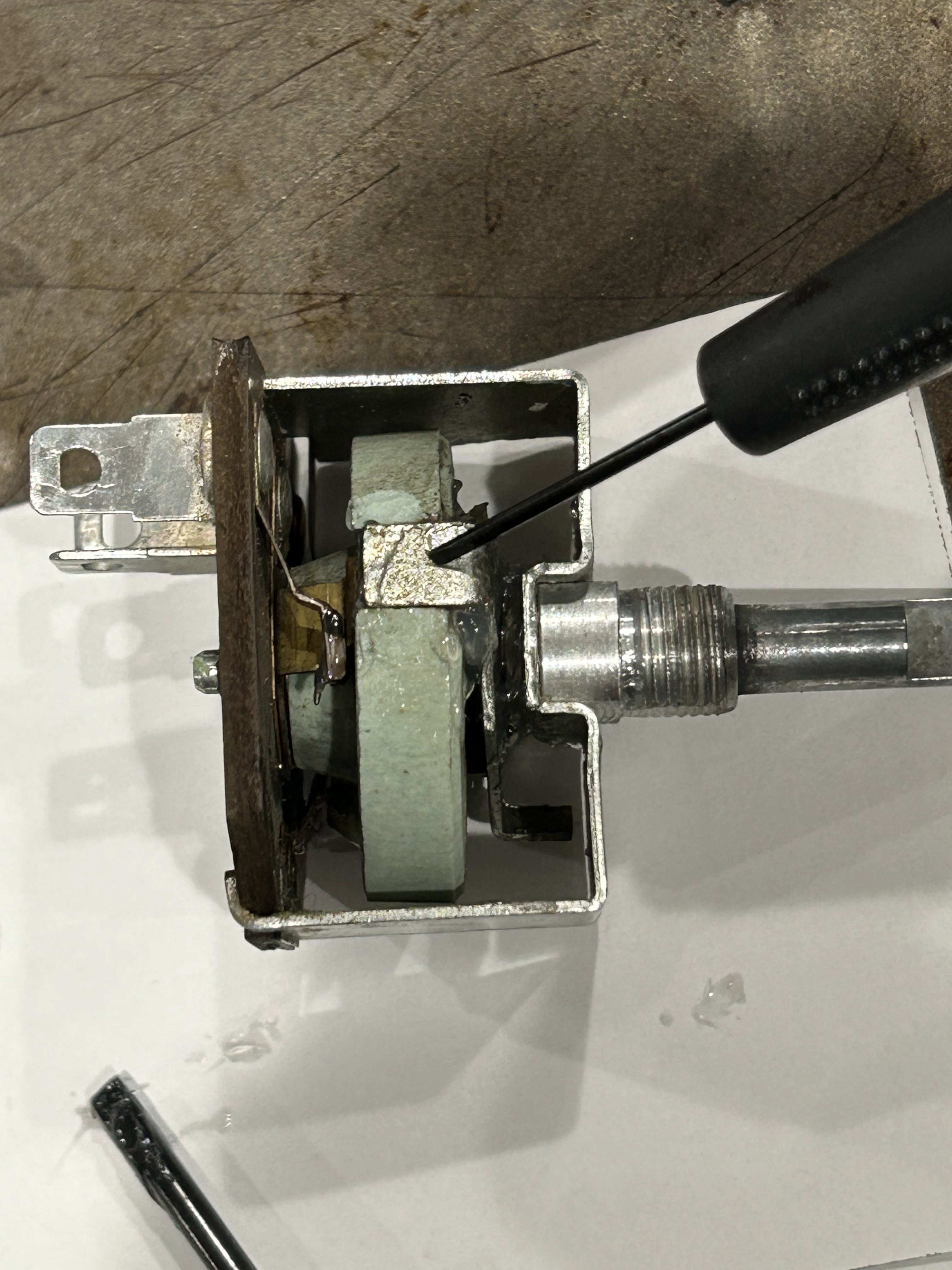

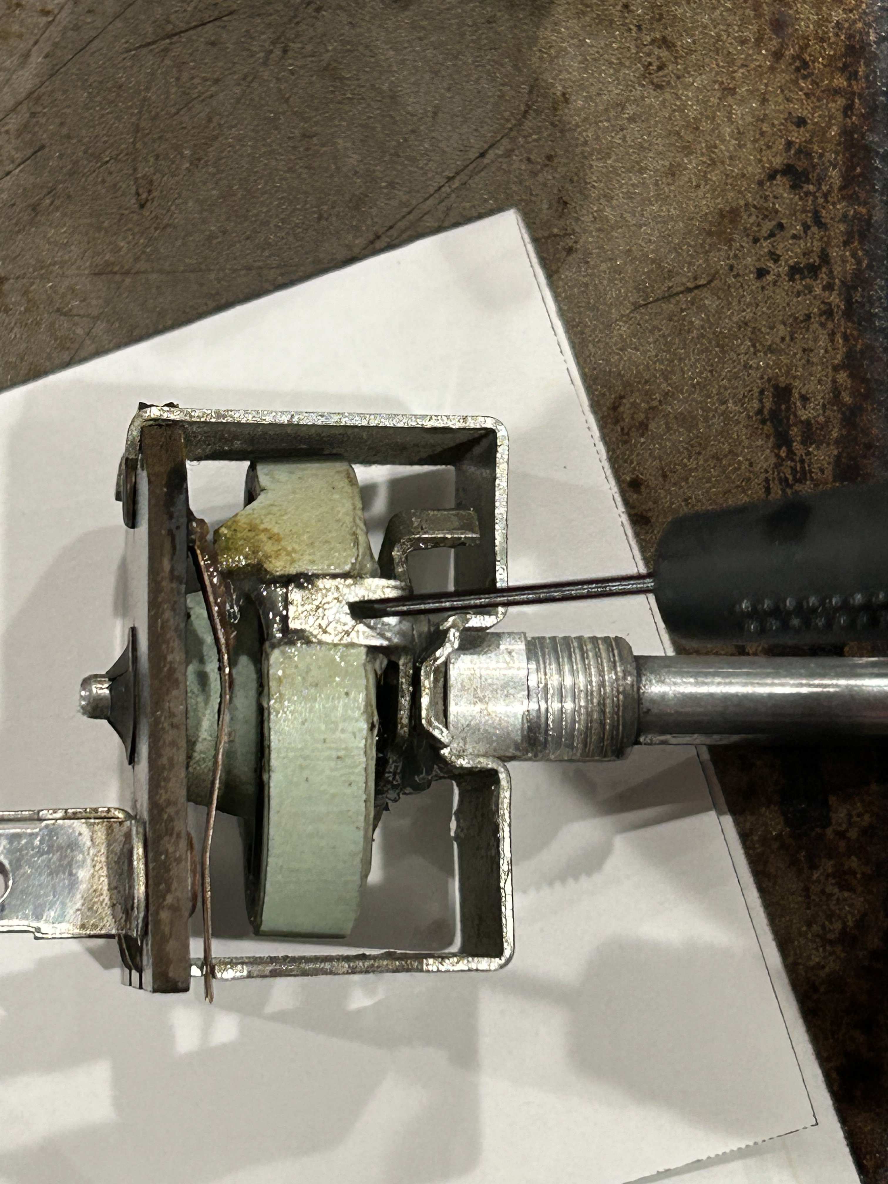

So, I pulled the dimmer switch apart again to look at it with fresh eyes. When I first put it together i tried to do it with the minimal amount of dielectric grease. I probably didn’t apply enough. I put more under these two tangs that move on the mint green ceramic wheel. I also spread it under the plate those tangs are attached to so it would push grease down under the tangs as it moves. Tangs are indicated with my screwdriver. I also greased the shaft where that plate with the tangs rides, also indicated with my screwdriver.
It is now much easier to get into that CCW position. Posting in case someone else attempts to clean up their dimmer switch. I’ll post results once installed.

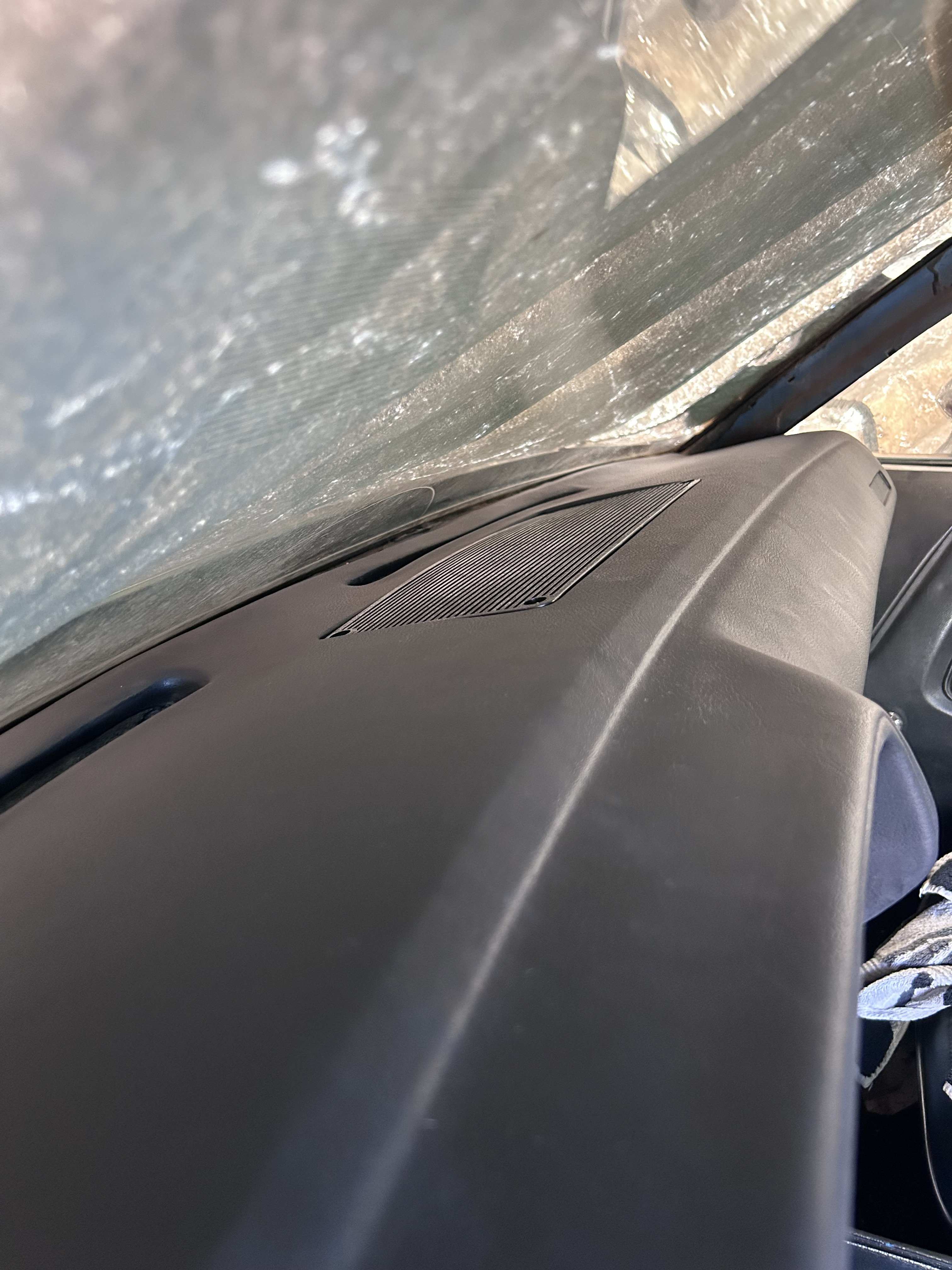

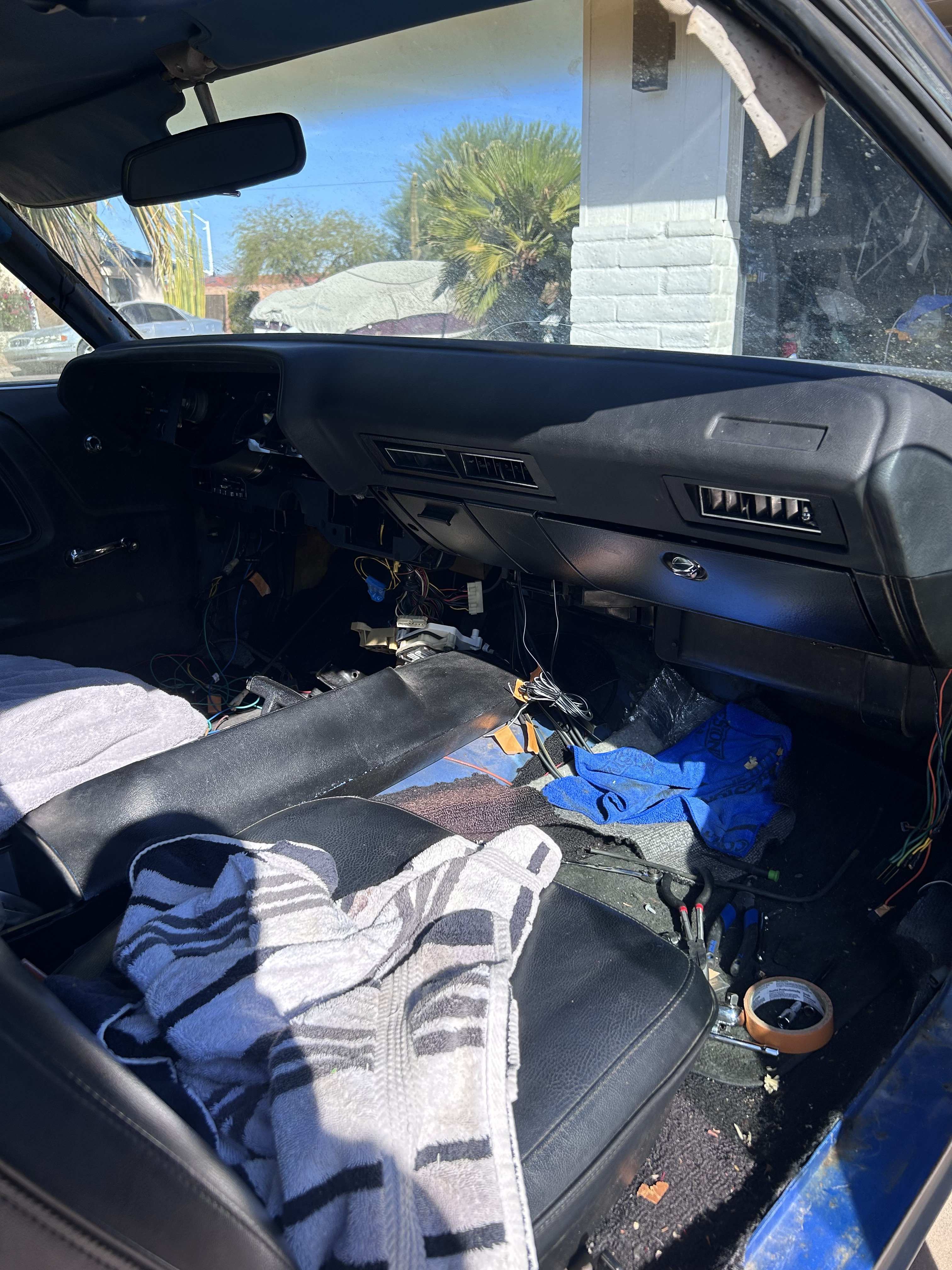

After nearly a year of being on a jig in my garage, my dash is fully restored and finally back in my car! A tip I wish I’d had before starting the install would be to trim the foam in the defroster ducts away from the screw holes that secure the dash. The foam would prevent the screws from going in straight and they would miss their clips. Total pain in the ass to trim once it’s in the car resting on your lap lol. Also, bending the clips just a bit so they were loose on the steel dash helped the screws thread in way easier. Figured that out on my fourth try to get this thing in snug.
Oh yeah, and don’t forget to install your defroster duct before you put your dash in. Figured that out on my third try 🤣. Luckily I only had one bolt in by the time I realized i forgot to put that duct in.
Still need to put the challenger emblem on and install the bezel and trim… I’ll get to that once I’m done wiring the Dakota digital gauges.

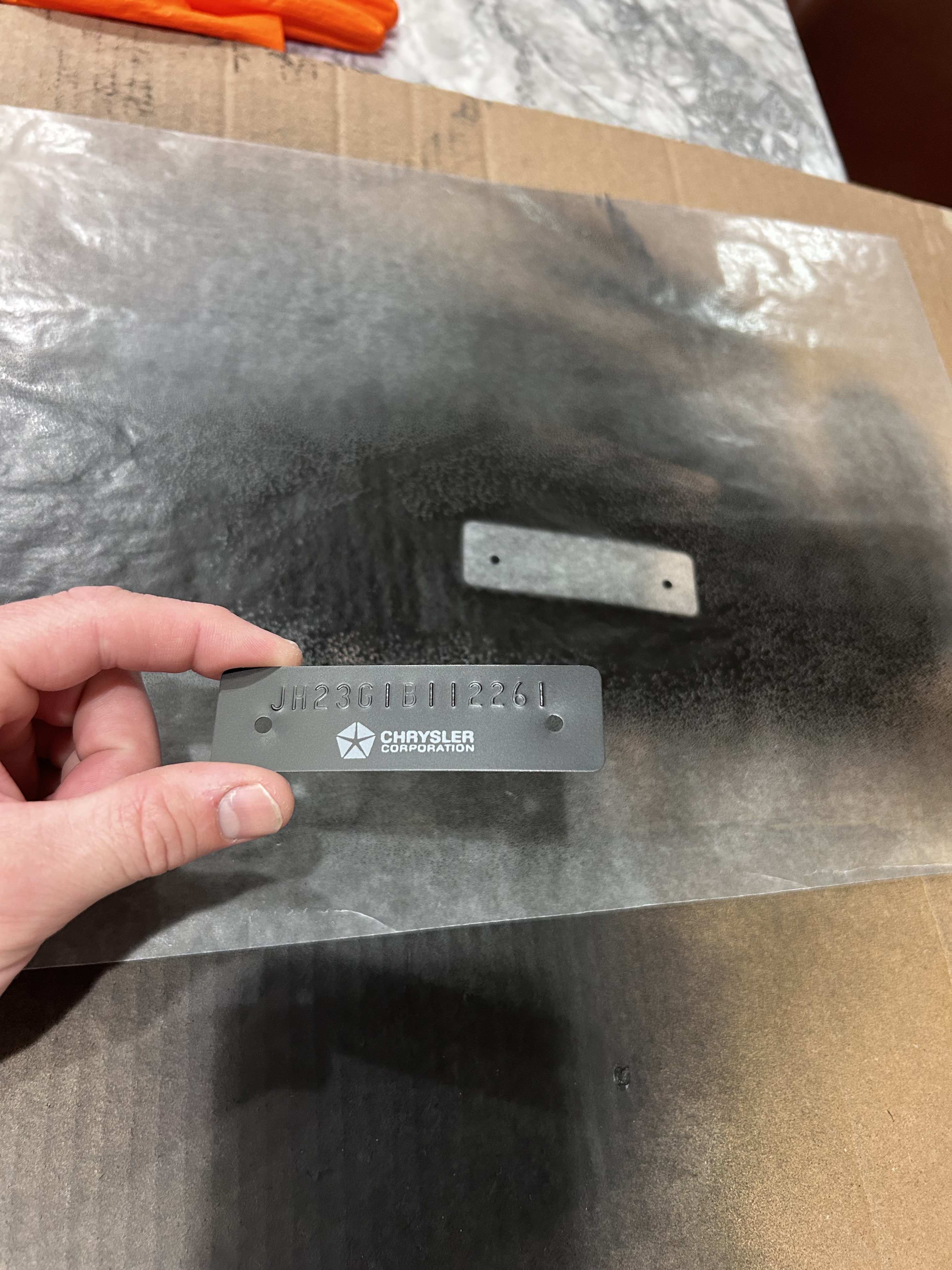

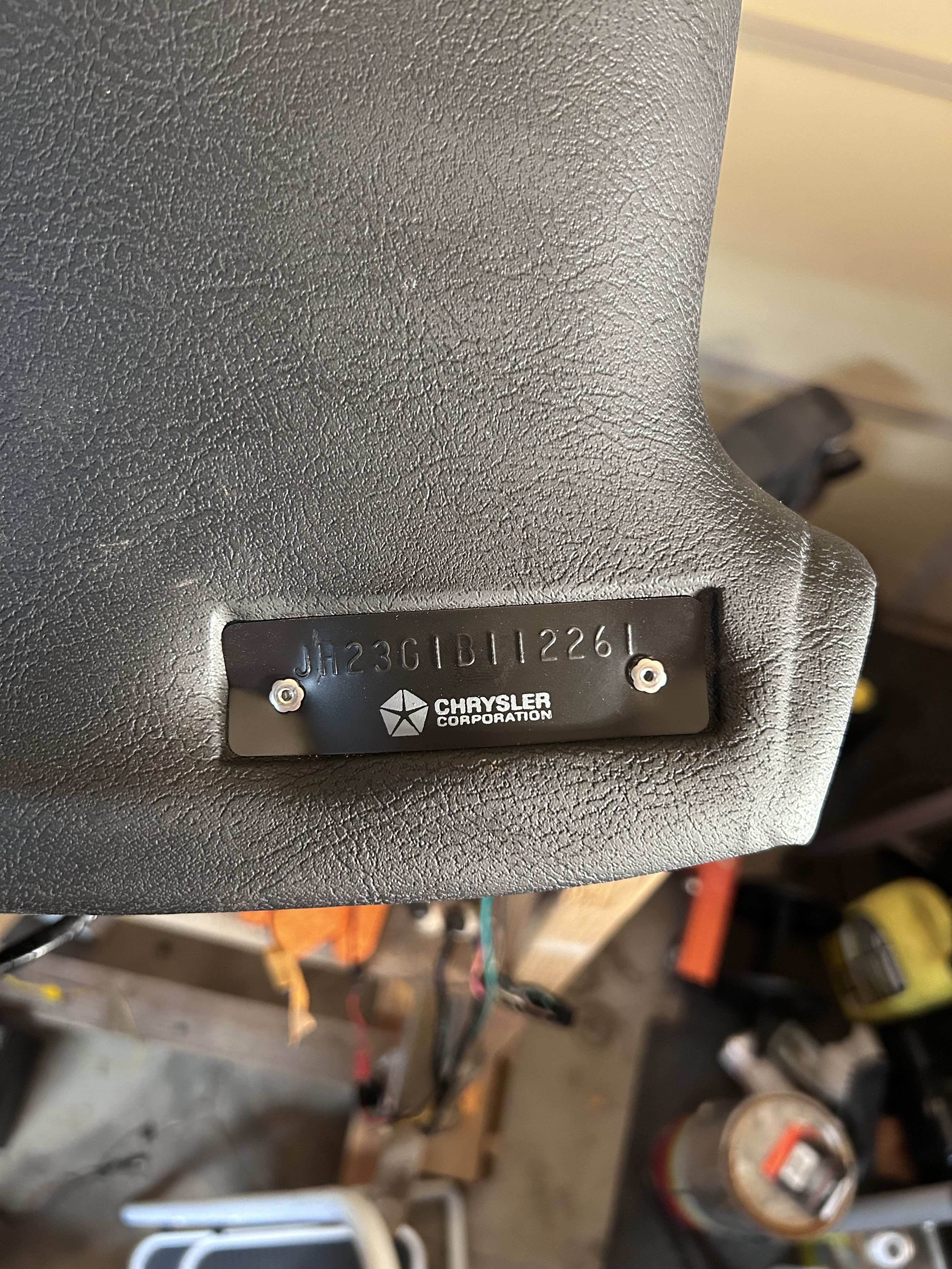

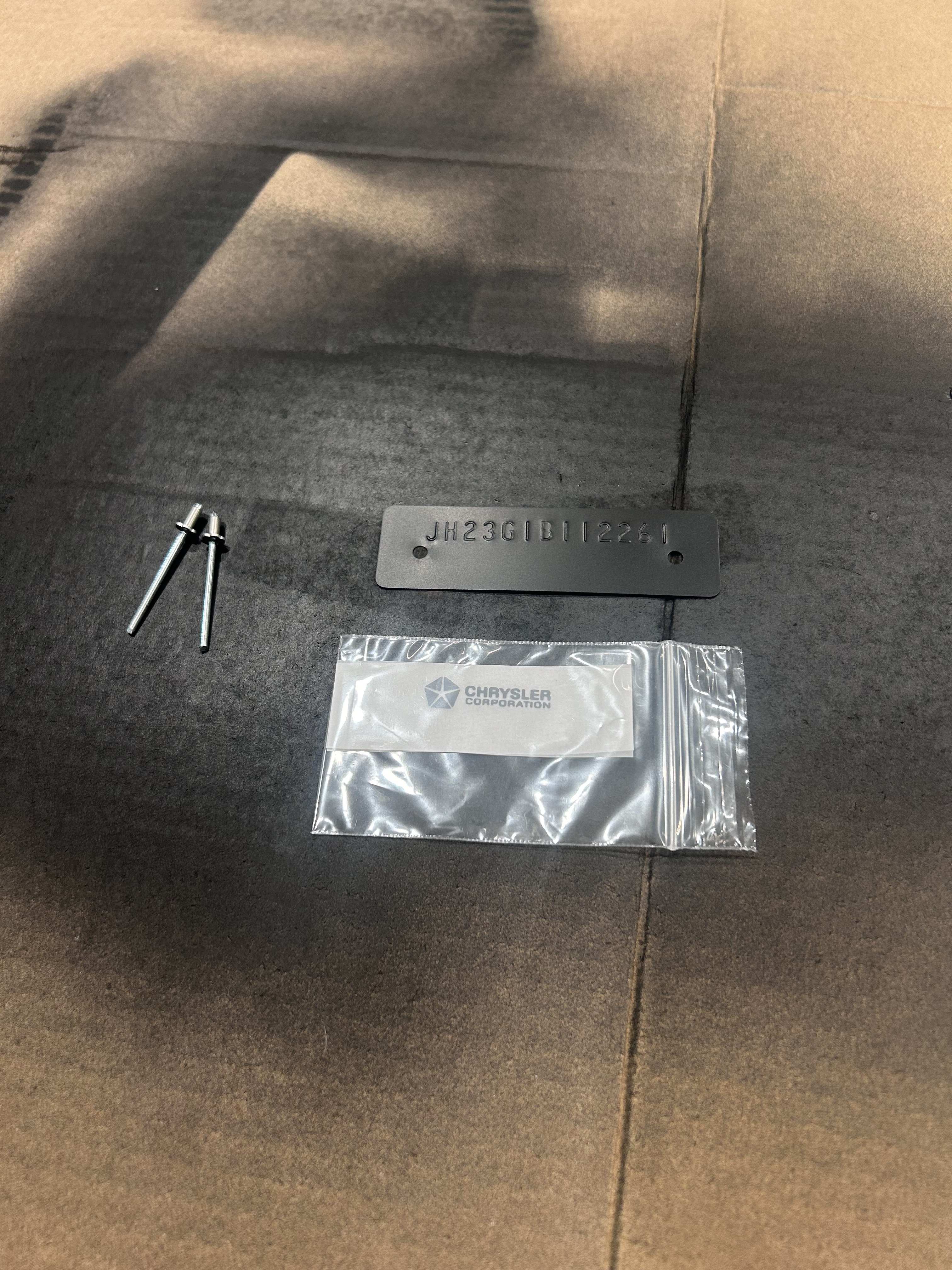

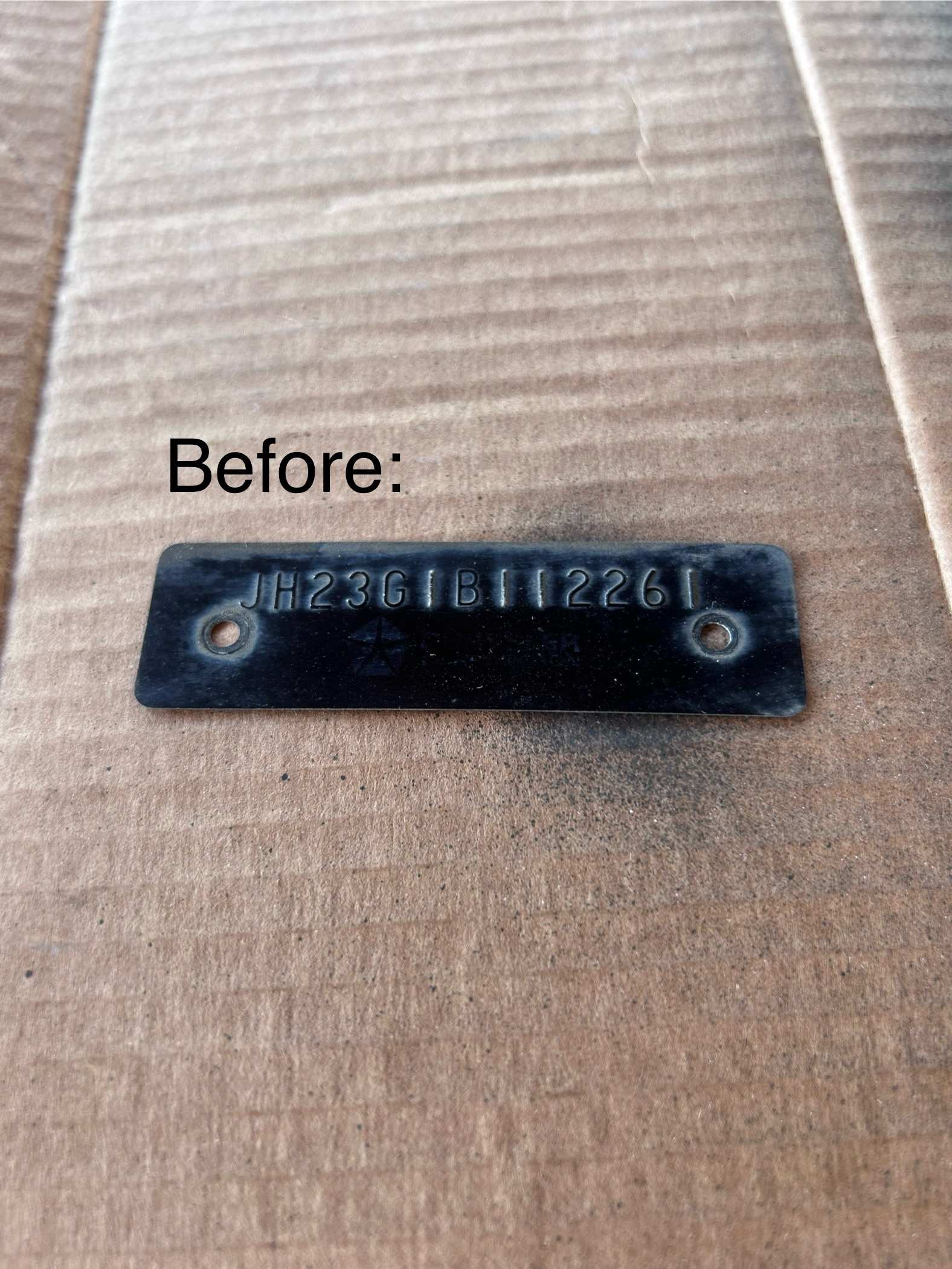

One thing I finished but I’m not completely satisfied with was my vin installation. The vin restoration itself came out great, but when I mounted it, the plush foam below it prevented it from laying flat. I tried twice to get it flat and decided to leave it because I was out of floret rivets and I doubt many people will notice.
Has anyone else had this issue? Should I have trimmed the foam below the vin tag? I think I am going to move on and chalk this up to a learning experience… but I’d be lying to you all if I told you this doesn’t cross my mind when I lay down at night 🫠

No, I didn’t reach out about it because I figure it’s water under the bridge. If I were to do it again, I might slice a X in the vinyl material under where the vin goes so I could cut out the foam beneath it, but still have the vinyl material under the vin. I think that would reduce the bend in the vin tag.
I also thought maybe leaving a wood working clamp tight on that area to compress the foam overnight might allow you to get the vin on flat.
